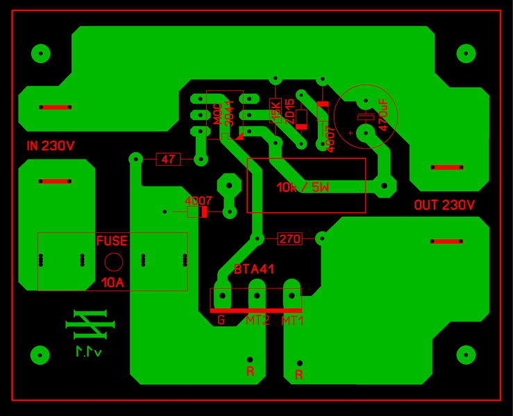

Triac soft start
PSU for FX100 include all this exept soft start. Use this soft start circuit.
Gooday all. Have anybody build this circuit and used it succesfully? I have read it is not a good idea to switch a transformer at at zero current crossing. I have a BTA40-600A triac and would want to use it for a softstart. Do one get a suitable opto that will switch the triac at peak power to reduce inrush current. Post 6095 🙂
