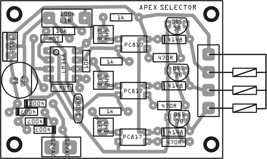

Hey Guys,
I finished the P30.
P30, MM3, TB3, Shunt Regs and A Class PSU.
I added a volume control/channel switcher with remote. Pretty cool setup.

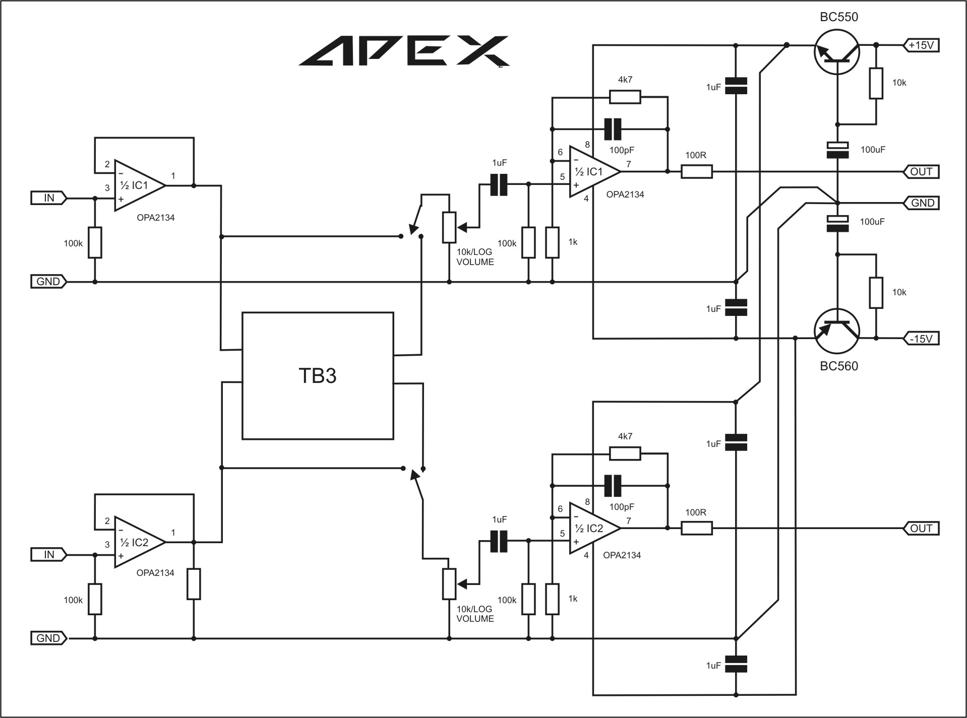

Hi Mile,
I would like to install a switch to take the tone controls out of circuit. Can I just switch the input from the tone control board to the input of the volume control? Will it matter if the tone control circuit has an open input if the output stays connected?
Thanks, Terry
Thanks, Terry
Hi Mile,
Thanks, Terry
You must disconnect tone control output, tone control input can stay connect and output must be open.

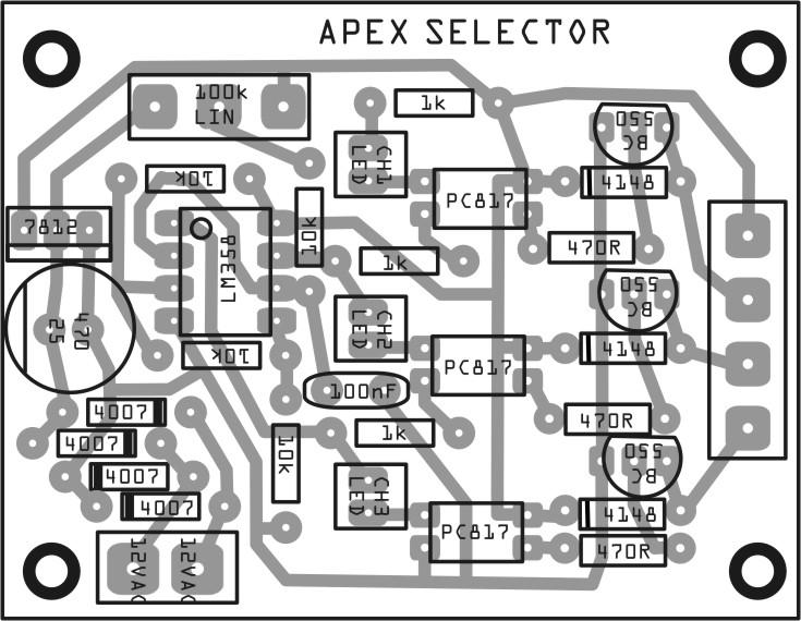

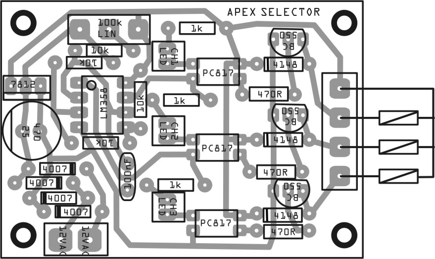

The P30 layout is from Alex. The others are from Mile and I just copied them in Sprint. I'm attaching the Sprint file with all of the circuits I used.
Hope this helps.
