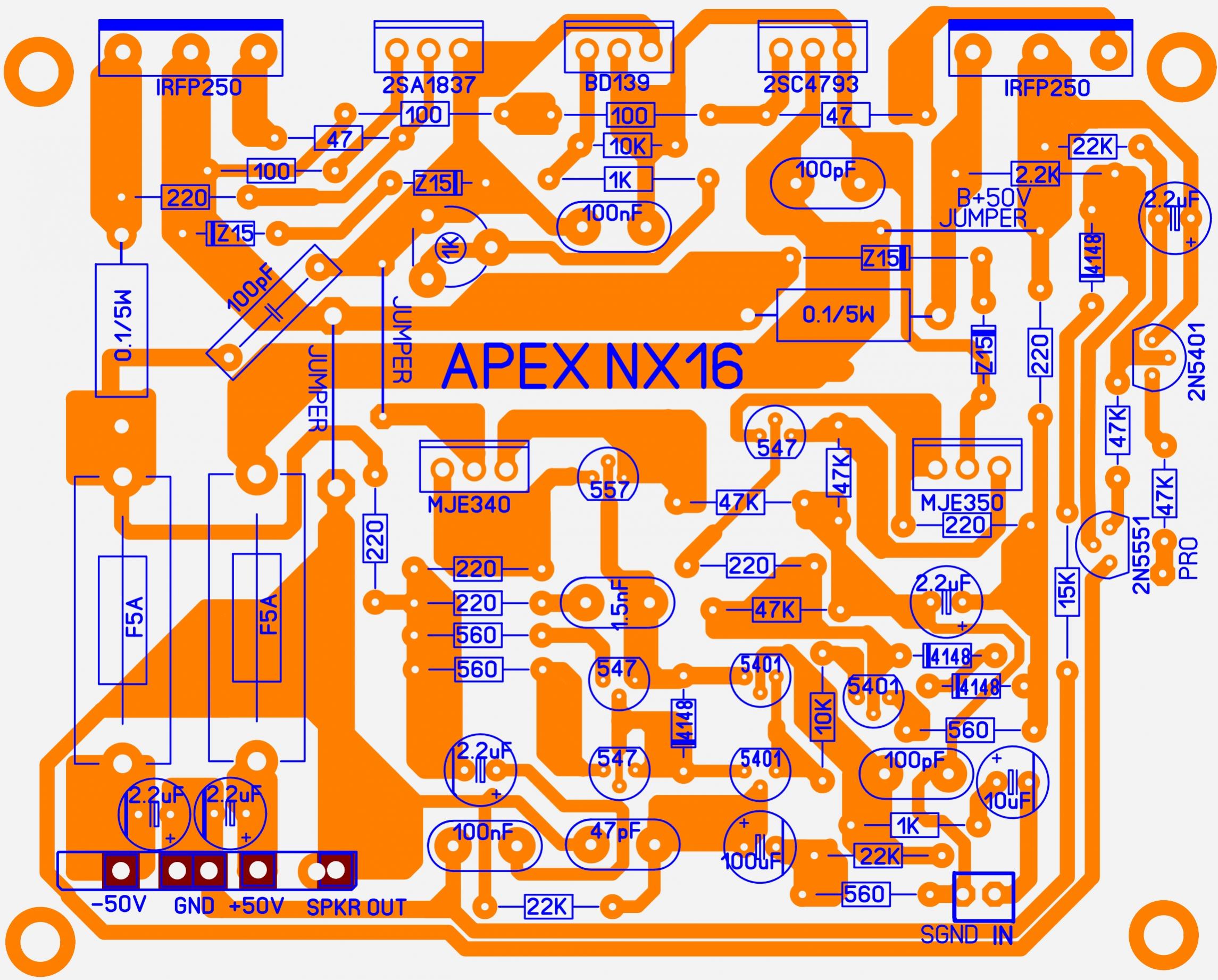

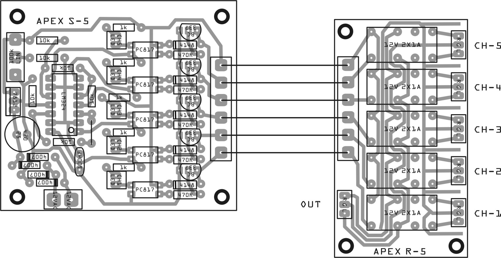

.hello sir apex have a good day to you i have trying to layout your NX16 amp please kindly correct my PCB before i build it,and if this is correct what would be my speaker protect circuit to be use so that i can attach it this circuit
regards.... Adamart

protec for NX16 amp apex

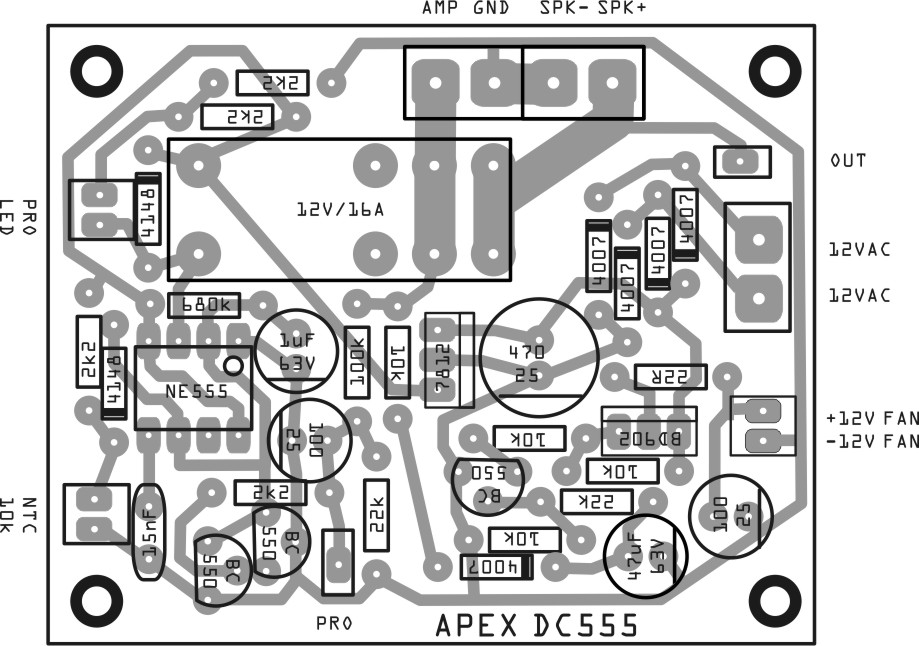

hi sir apex audio thanks for a kind reply to my post NX16 apex amp

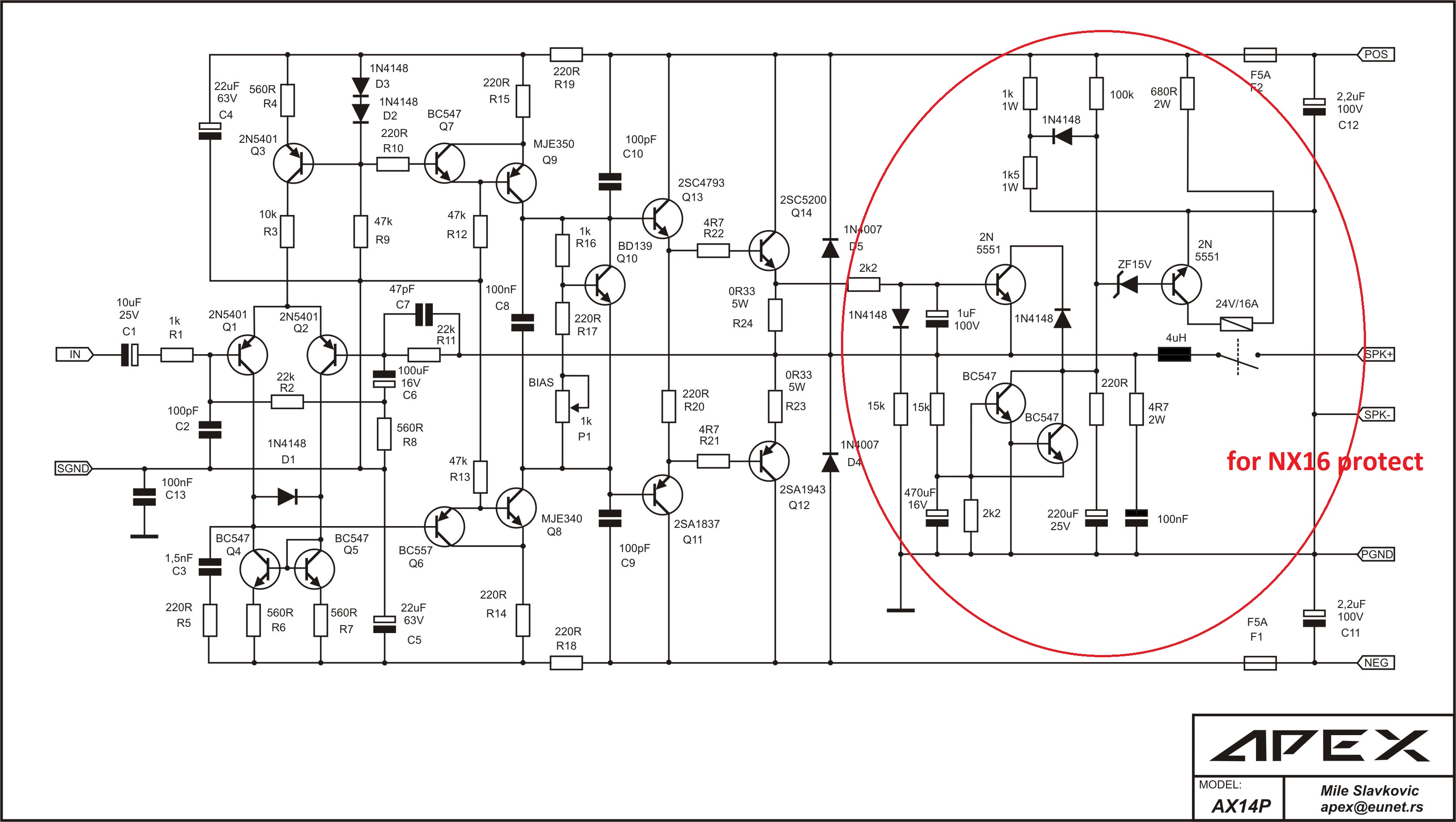

sir you give me a layout of protect base on IC NE555 with NTC i appreciate that circuit sir but i need simple circuit like this... i attach here your schematic base on your AX14P is it possible to use it to this amp NX16 as speaker protect instead of that one you given me? i mean whats the difference between them is it a click of sound during powering on?
Yes protect on AX14P can be use for any amp.
Regards
..... corrected now .....🙂
Alex

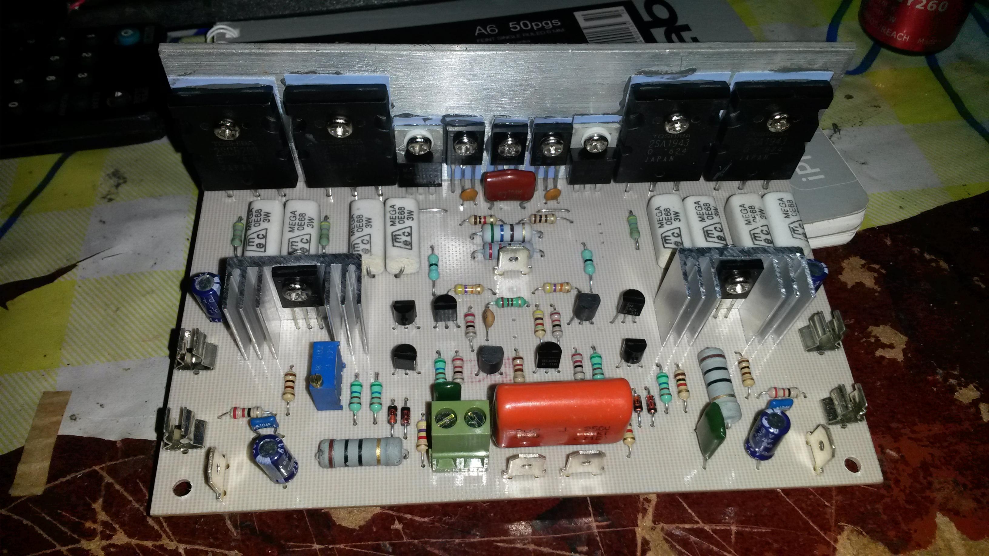

Underbiased amp distorted at low volume... do you connect input gnd to psu gnd?

..... or with 2 pairs OP transistors 🙂
Regards , Alex
Hello Sir,
I made this amplifier with same layout you posted. I am new and I have very poor knowledge about BIAS and other adjustments. I checked the amplifier with +/-45VDC and it sounded nice but as i increased the volume it starts to get distorted. is it something to do with BIAS and other adjustments. I checked it with a SANSUI PM-C50 baffle. Please tell me how to adjust the 1K and 220ohm VRs. Please help. I checked it with a NE5532 pre-amplifier. I have used the same pre-amplifier with K1058/J162 RAS100 amplifier and it worked perfect but with this amplifier the hi is not very crisp.

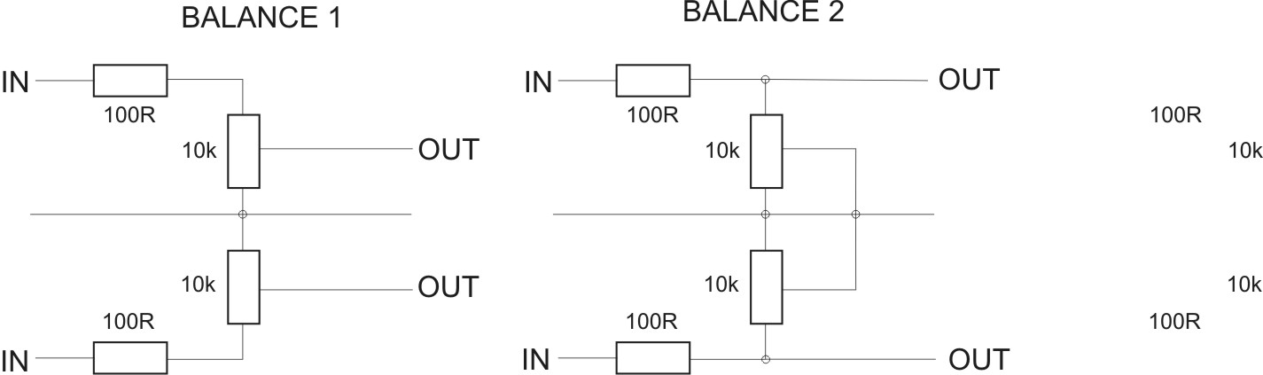

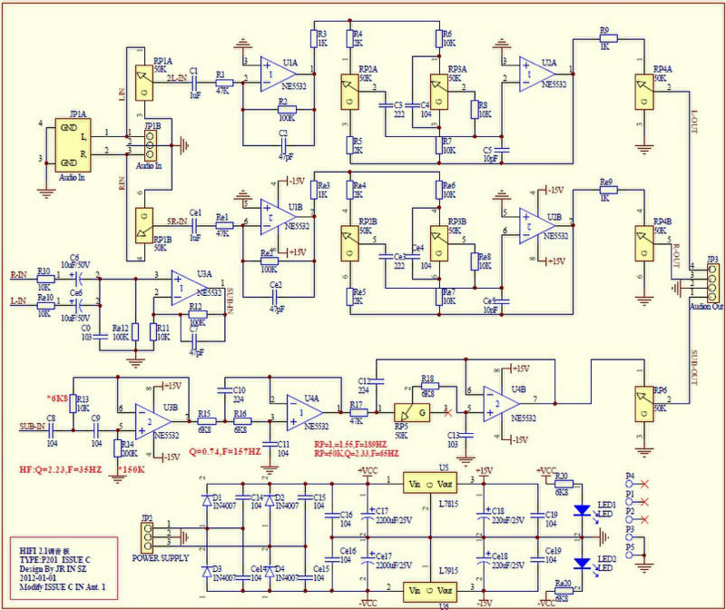

I finished up the A40 today and hooked it up to the P30. Something is not right about the P30. I sounds like I have a phase issue. With the balance control set to either left or right, it sounds perfect but when the balance control is in the center the volume drops and the vocals are in the distance. Can you please check the schematic and check to see that the balance control is not inverting something?
Thanks, Terry
Hi Mile,
Thanks, Terry
What is value of your volume pot, can you post volume circuit... you can change balance circuit from balance 1 to balance 2 if you nee low output impedance from tone control output.
Regards
