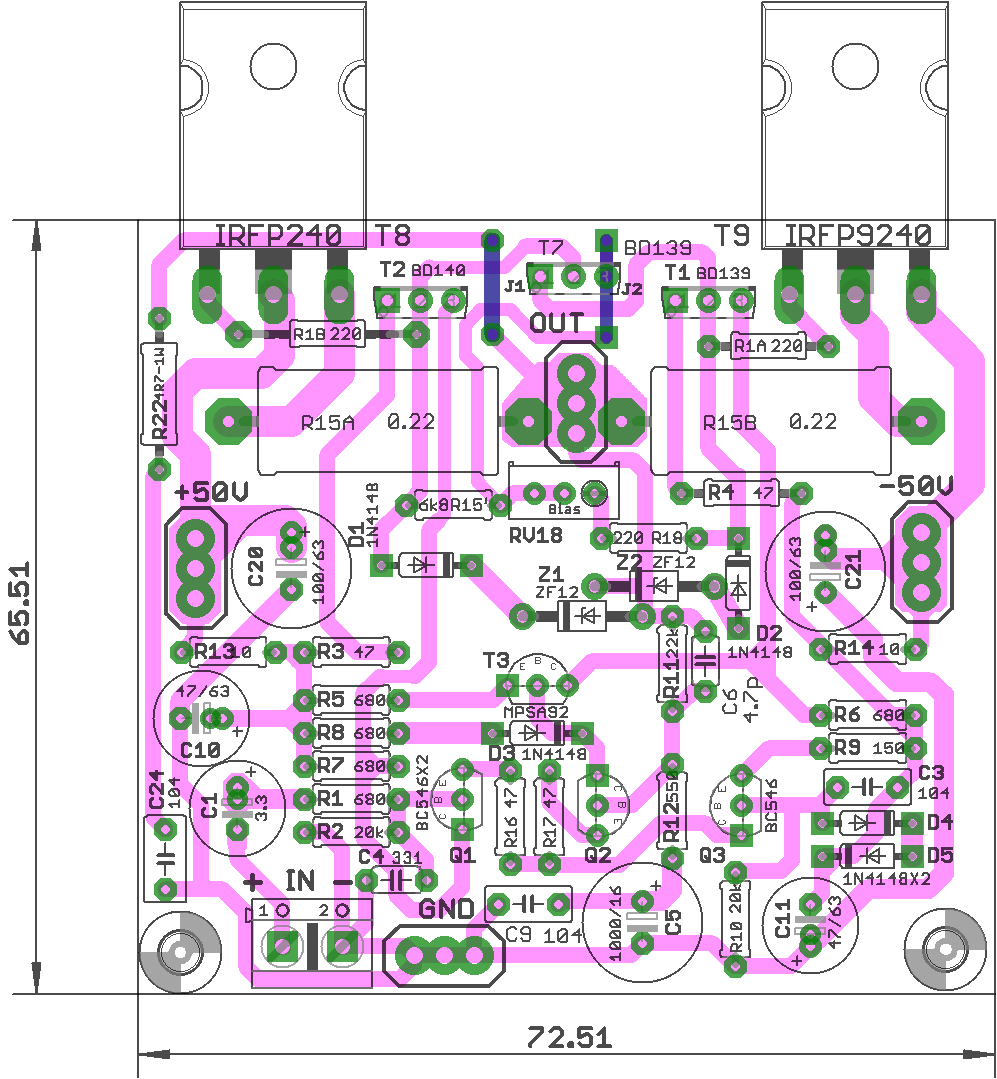

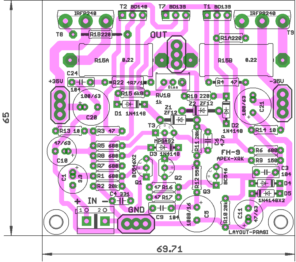

Here is an idea for quick layout of FH9 modified from Fx-8.
pl see for connection error. further optimization can be done,.
Thanks Prasi.
1. Can you move all BD139/140's close to end so all can be mounted on heatsink?
2. Can Q1&Q2 be adjacent so thermally tied together face to face and shrink tubed?
3. Yes, please check gate source and drain pin outs on IRFP240/9240.
4. I have not tested at 50v yet - I know several folks have mentioned that 50v may be too much?
Otherwise it looks great. Thanks

You are right and I was trying to get higher power out of them vs the lateral FETs. AndrewT did say that de rating to 75w (or 1/4 theoretical max) is best way to run them for higher reliability. 75w with 8ohms is only 25v - so how does one calculate what rail voltages are needed for a class AB? I currently have 35v rails - will that be enough? What is the calculation that is done and what assumptions are needed? 50% efficiency? So rails need to provide 150w? That would be 35v I think.

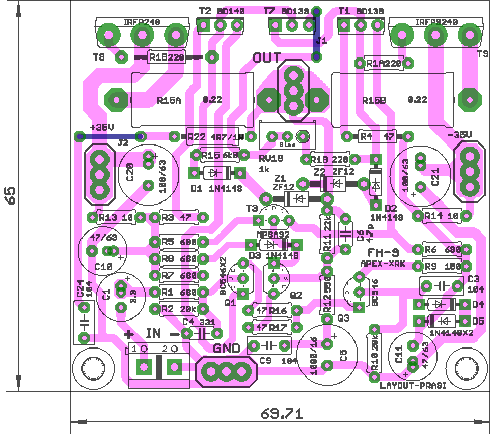

Ok, incorporated above changes. also supply to +/- 35V.
Why are you trying to run a single pair at 50v? Do you really believe you will hear the extra dB or two? All you're going to get is stressed devices for very little gain.
In fact one pair of lateral MOSFETs can easily run on +/-50V or even more. Elliott's P101 with one pair of lateral MOSFETs is designed to work at +/-56V (dual 40V secondaries transformer). P101 with two pairs is designed to work at +/-65-70V. Lateral MOSFETs are that robust! They have unique resilience to thermal runaway. Companies from UK are using them for 40 years exactly because that robustness and in most cases they even do not even require protection. It's very difficult to burn them even with prolonged hard work. But, of course, lower working voltages will provide almost absolute reliability in FX8 circuit.

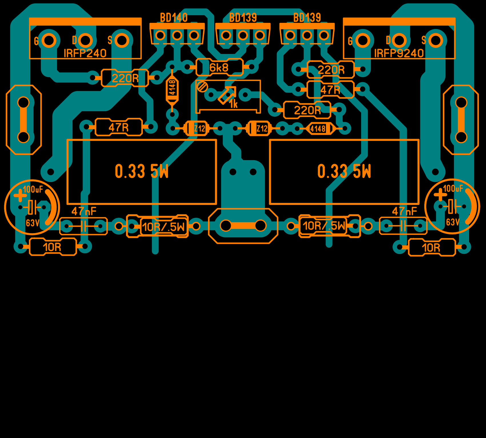

Hi Prasi, you can make this layout without jumper.
I have attached picture of components placement for upper side of your pcb.
Hi Sonal,
Looking good!🙂. Pl go ahead and make the rest of the layout too, will be useful for builders.
here is a jumper-less version based on my earlier version. I am not able to find time😱.
reg
Prasi
