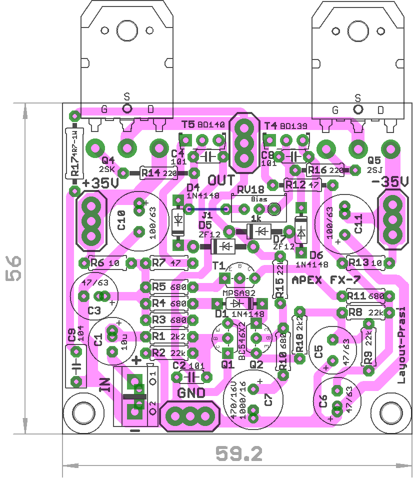

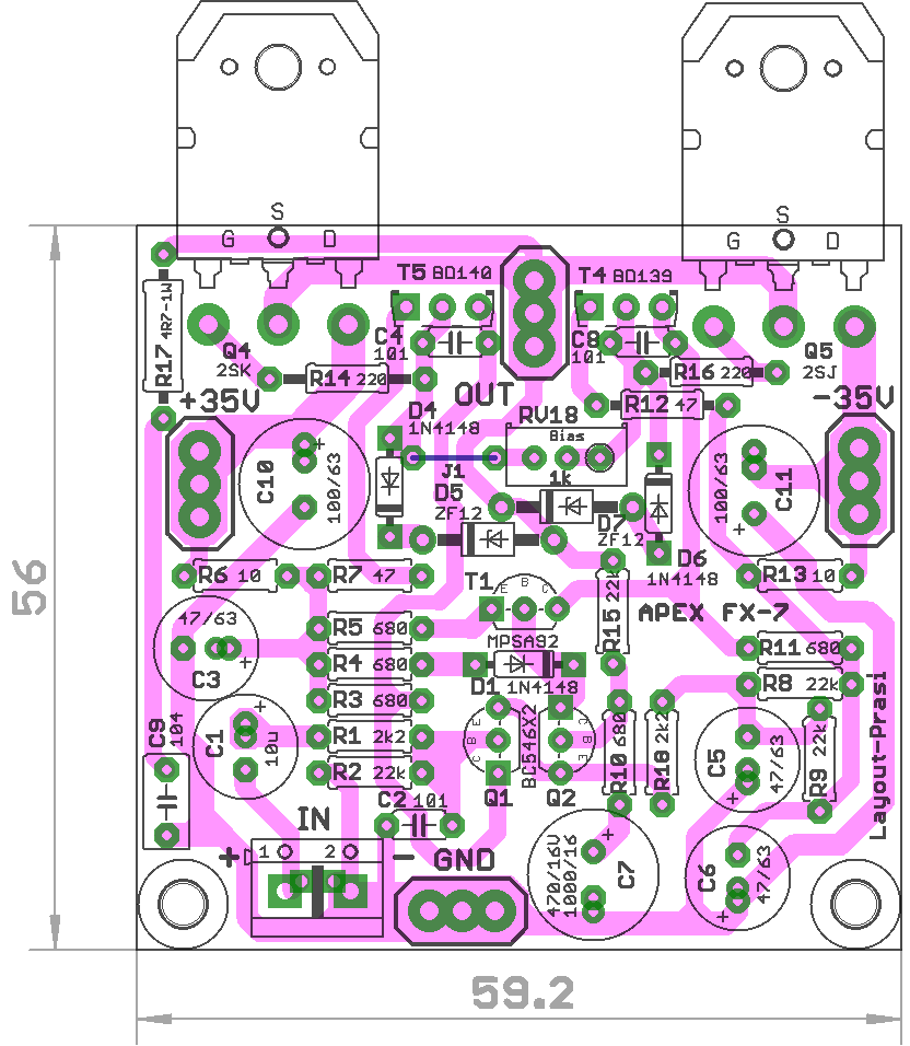

Nice layout Prasi. Just a question on the philosphy behind removal of the CSS for FX8? Is that not a step backwards as the CSS helps reduce distortion?
One comment, can you move the 1000uF cap and the GND spade to the right a bit so that the signal input screw terminal can be rotated 90deg to face the front rather than sideways input? Otherwise looks great - I like that the VAS BD139/140 are now moved up to mount on the same heatsink.
BD on main heat sink was my original layout of FX-8. I just modified that layout slightly to make a layout for FX-7. Regarding CCS, Mr. Miles can answer better, but some are happy without it and plus 1 active device less🙂. If you are interested in 50mmx 50mm layout, may be Sonal can make it.

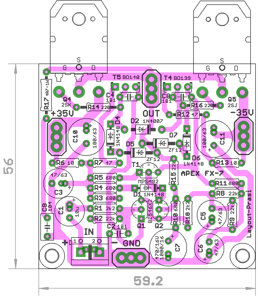

Prasi,
Thanks for moving stuff around - looks perfect. I don't mind slightly larger format as the BD's get heatsink space and larger caps can be used. My Dx amp does not have CCS and it sounds fine - I agree sometimes do not really need it and simpler is sometimes better. I wonder if using LEDs to form bias setting voltage may be something we should try.
Prasi,
One more thing here, you can use BC640/639 as per the sch. Just turn by 180 deg. Only thing is, if it gets too hot, one may have to use to-92 clip-on heat sinks I had seen somewhere and then monitor the temp. something like this...
