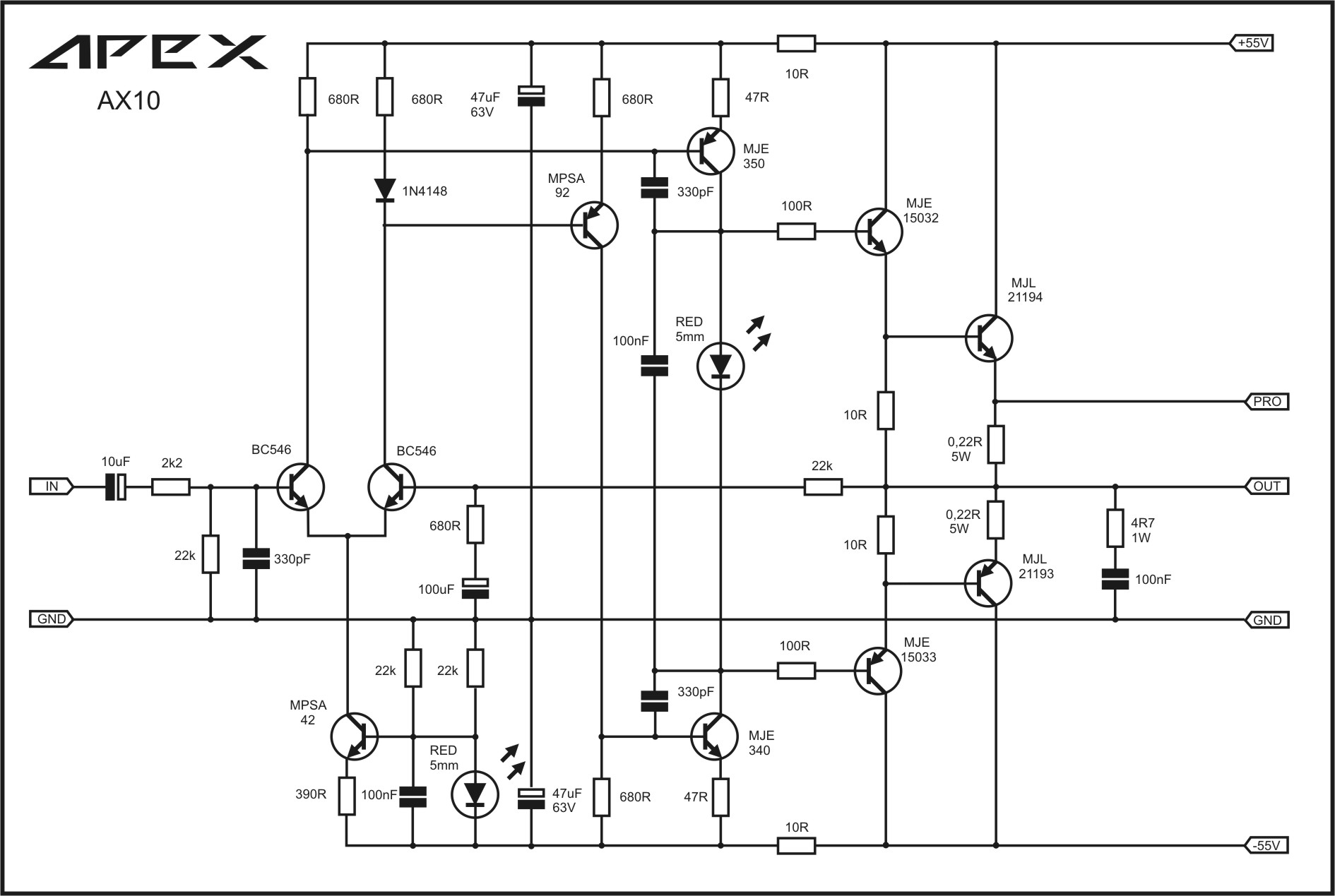

MJL's are BJTs' not lateral MOSFETs. You will need another drive stage to get enough current to drive the BJT's then it's not an FX8 anymore. I was able to modify circuit to accept vertical MOSFET (IRFP240/9240) with addition of a single Vbe multiplier (so technically an FX9 hexFET). MOSFET's are voltage drive not current drive.
I have a lot mjl21194 and mjl21193 transistor.
Can I use instead 2sk1058 & 2sj162
Thank You ...
You can use it for AX10
Regards

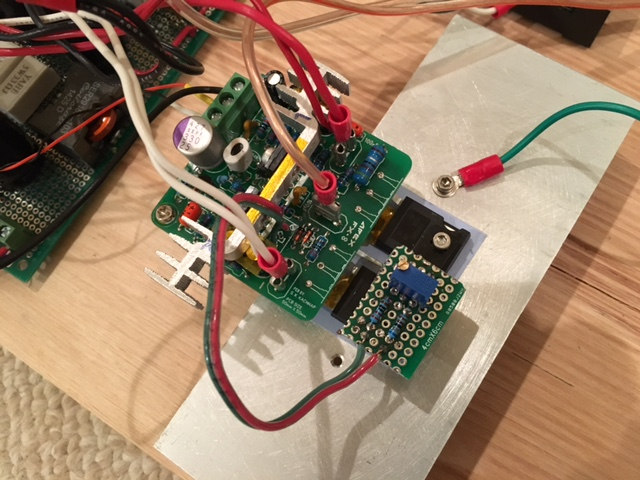

FX8 with hexFET and BD139 Vbe multiplier
I got rid of the flying leads on the main output hexFETs by crossing the Drain and Source pins so that they could be connected directly to the board as made for GSD pinout. I also switched the MPSA42 for a BD139 Vbe multiplier so that it was easy to bolt to the top of one of the hexFETs. I set the bias initially at 250mA and then reduced it to 150mA and it sounds great. The bias is stable with this setup. Much more compact now without the flying leads. Other changes include putting the LTP in thermal contact and binding them together with shrink tubing.

Nice work,
