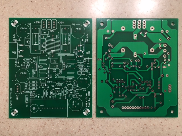

Hi Sonal,
Looking good!🙂. Pl go ahead and make the rest of the layout too, will be useful for builders.
here is a jumper-less version based on my earlier version. I am not able to find time😱.
reg
Prasi

Ok, Here are the pdf's for FH-9 by APEX-XRK 971 for anyone doing DIY. Sch is in previous pages by XRK.
reg
Prasi

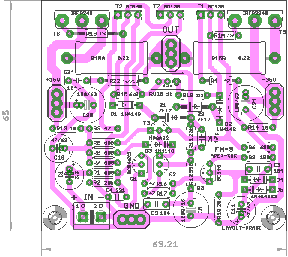

Nice work, can you move VAS transistors closer to BIAS transistor?
Regards
Regards
Done, Mr. Mile.
regards
Prasi

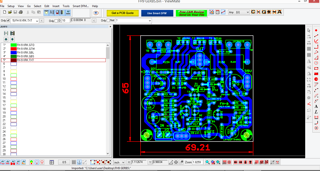

Gerbers.
Hi Prasi,
Can you post the Gerbers for your FH-9 board?
Thanks...

Hi Prasi,
Thanks...
Thank you for the nice layout Prasi. Yes, Gerbers would be nice - it probably has been reviewed and refined enough at this point especially if the last comment from Apex was just to move the VAS over to the middle. 🙂

Pl find attached the gerbers for FH-9. I had already put a label on silk, "FH-9 APEX-XRK"
Do you want me to put something else?
