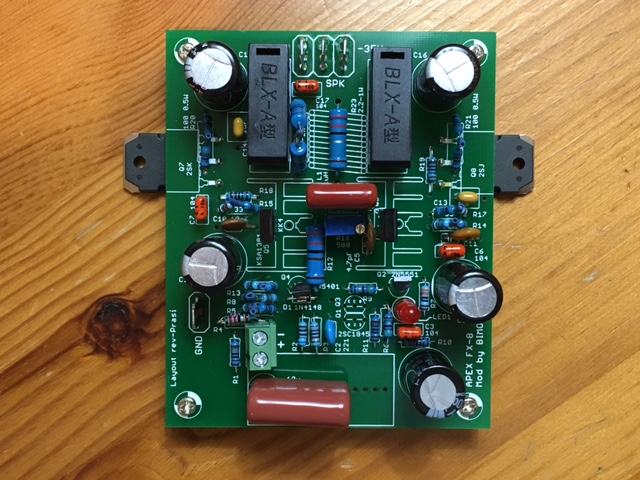

Just got these back from Seeedstudio. 🙂
Looks very good🙂! All the best for the build... instead of the fuses, you can instal safety resistors for initial start-up.

What kind of an input terminal block does this board use for audio signal in? The hole spacing is smaller than my typical 5mm screw terminal block. There's plenty of room on the board for a larger one. I actually got fuse holders and the special VAS transistors (KSA1381 and KSC3503) the same time the boards arrived so I am good there. Good idea about safety resistors in place of fuses to get started though.

Input terminal raster is 2,54mm

Yes, it is. I use this http://www.molex.com/pdm_docs/sd/022232021_sd.pdf
Ahh. Same as a small PCB header connector for a small fan. I guess I could make some of those but would have been nice to have same connector as all my other amps.

I will opt for the one posted by Miles. I myself prefer direct soldering. I have a feeling that ALUMINUM (such as in the "female" socket), no matter short, shouldn't be used for audio.

2.54mm pitch headers as posted by Mr. Mile is "generally" very commonly used for Small signals. or if you use shielded cable in your build, you can directly solder the wires, depends on your preferences. the one posted by bimo, is what had used previously in my builds.

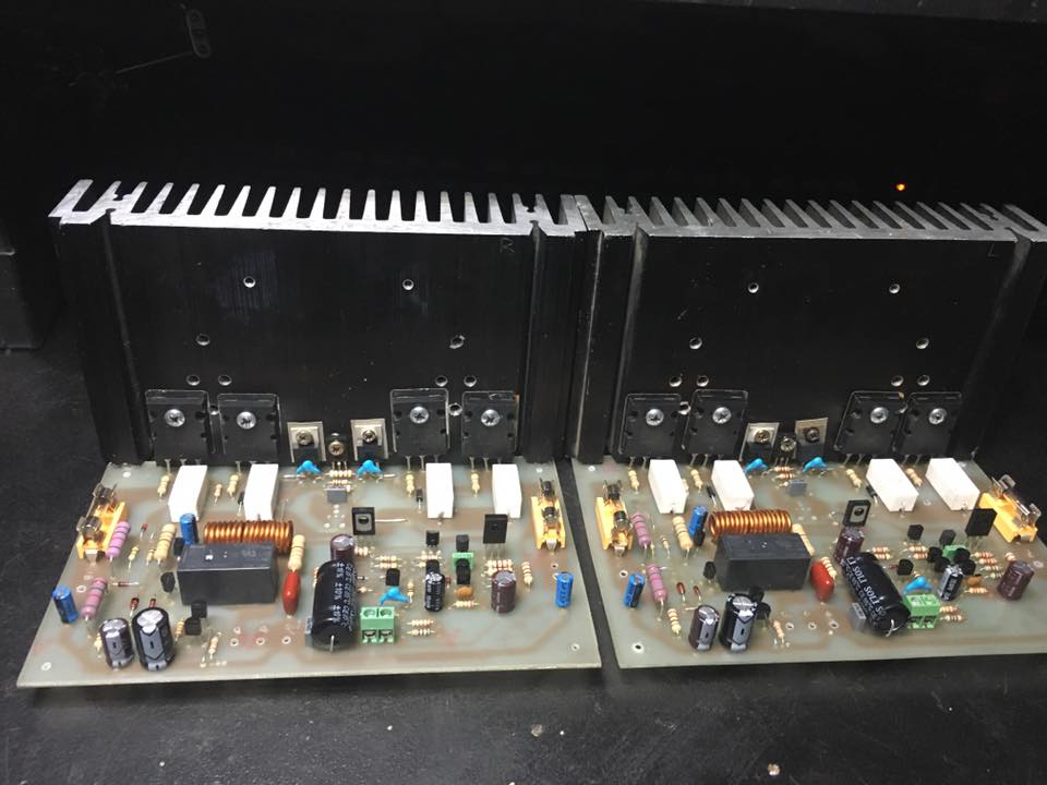

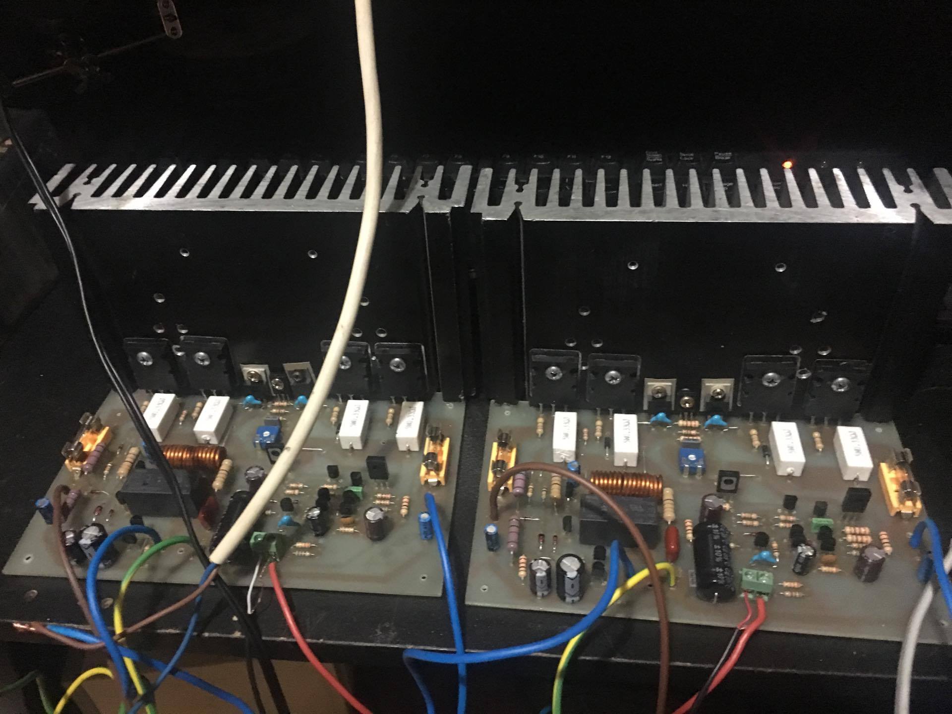

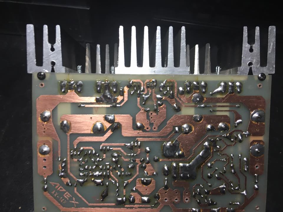

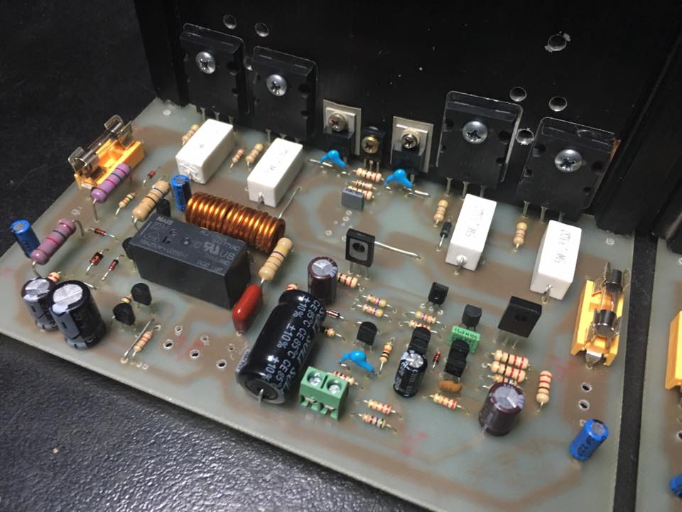

Hi Guys.. Here is another Apex AX14P with two pairs outputs .. working Great, with lot of power .. massive and huge sound .. Thank's to Mr. Mile Slavkovic for schematic and Mr. Juan Vargas for drawing PCB..

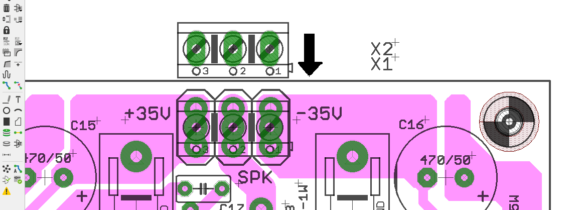

I realized that after playing around with a terminal block but the spacing on the top 3 is all right next to each other so too tight. Not a big deal as I have the spade connectors and prefer them for the power supply in and speaker outs (rugged reliable simple and low profile). I see why they are used on all serious amps now 🙂

Attached image shows the fitment of standard 3 pin termi block with 0.2" pitch. If your termi block is too big, then it wont fit. Just posting here so that its more clear.

Ok - I get it now. I was having temporary senior moment there. I was thinking an independent 2 pin block per connector - totally forgot one could put a single 3 position block for all 3 🙂
Good option to have.
