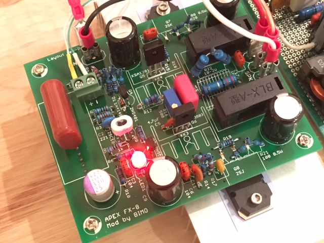

FX8 Bimo Mod with matched 2SC1845's LTP
The 2SC1845's arrived today. Using a transistor tester, I found a pair with an exact Hfe match of 623 each. I installed them and bound them with shrink tube to be one thermal unit. I switched out R11 from 1k to 680R to get the same gain as my other amps. The new transistors are under the white shrink tube near the LED.
Listening to it now - sounds very very good. More time needed and some measurements of the speaker distortion will be in order but I will spend some time with different tracks to get sense. I am really enjoying its sound so far though.
Oh, and btw, the matched 2SC1845's now give me only a 1mV offset! (it was 60mV before with the randomly selected BC546's)

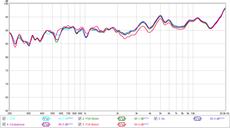

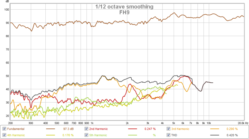

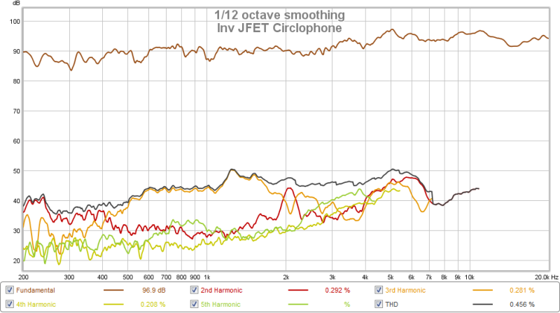

So far, the FX8 Bimo mod appears to measure the best with my speakers in terms of lowest harmonic distortion (as measured with a microphone). The FX8 Bimo mod seems to have a slight 1.5dB depression in the response though from 2kHz to 5-7kHz as compared to the other amps which all track identically through that region. I wonder what can be causing this?
Measurements made with calibrated UMIK-1 (Cross Spectrum Labs calibrated), GRS Research XL-S speaker, all at 0.5m distance on tweeter axis with speaker on a 30in tall stand for tweeter 42in above floor. All amps used same Dx PSU with 35v rails and 250VA transformer.
Amps tested include: FX8 (5cm x 5cm version), FH9 (FX8 5cm modified with vertical FETs), Dx amp, and Inv JFET Circlophone.
Here is measured frequency response of speaker with different amps (FX8 Bimo is red curve):
548864d1463144224-100w-ultimate-fidelity-amplifier-comparison-fx8-fx8bimo-fh9-dx-circlophone.png

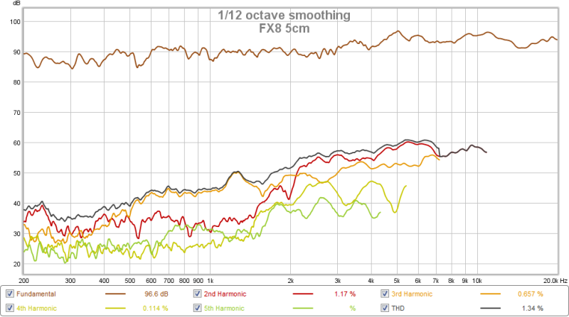

Here is measured HD of speaker with FX8 5cm (note rising HD above 1kHz) - all values in legend are with cursor at 5kHz mark:

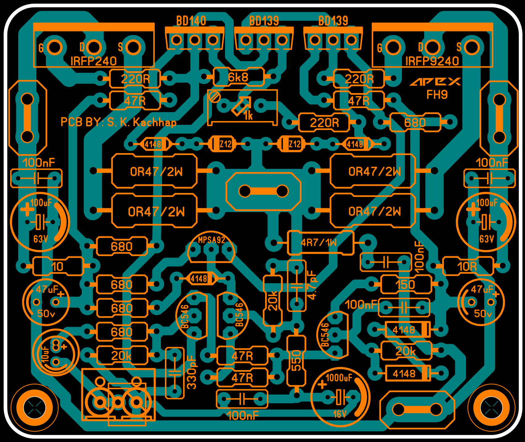

Here is measured HD of speaker with FH9 - the simple switch to vertical FETs with source/collector resistors and Vbe multiplier fixed the rising distortion problem seen above (same exact board):

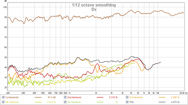

Here is measured HD of speaker with Dx amp:
Here is measured HD of speaker with Inv JFET Circlophone amp:

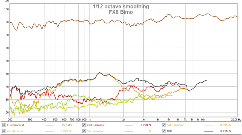

Here is measured HD of speaker with FX8 Bimo mod - and in case you are wondering if something was amiss with the lateral FETs used in the FX8 5cm above that may be causing the rising distortion, the same exact later FETs from that amp were used in this amp:
Note that all the amps sound very good, excellent even. The Circlophone had the edge all along but now I think the FX8 Bimo may be close or better once I figure what is causing that mild -1.5dB depression in the response from 2kHz to 7kHz.
"So far, the FX8 Bimo mod appears to measure the best with my speakers in terms of lowest harmonic distortion (as measured with a microphone). The FX8 Bimo mod seems to have a slight 1.5dB depression in the response though from 2kHz to 5-7kHz as compared to the other amps which all track identically through that region. I wonder what can be causing this?"
Because THD lower at that frequency?
