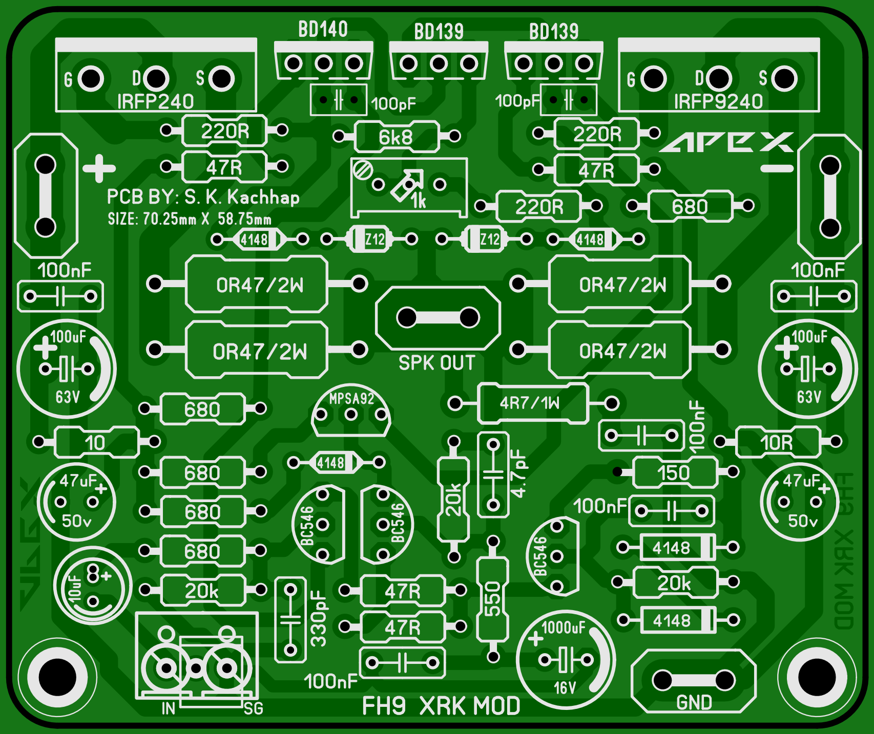

Here is my FH-9 one channel finished and powered with SMPS.
The amp is silent,no noise without signal. It play very well for such simple design. I like it.
regards

Hi congratulations on your FH-9 build. So the layout is working flawlessly. Thanks for sharing. Like Terry said, if you get a chance to power it up with a big fat linear PSU, do share your impressions.
Reg
Prasi
Edit. If I guess correctly, those are processor heat sinks. How hot do they get at full power and 1/2 hour and what's your bias setting?

Yes, the heatsinks are for processor and they are to small for normal use.This is only for testing ,I will replace it with bigger one.When the second channel is build,then i will try with linear PSU and will see the difference.

A small 50mm fan running at partial speed should keep it cool if you wish to make it compact like my stereo FX8 setup. A 5R or 10R resistor on 12v fan lead should reduce speed so not noisy. I like the looks of that heatsink though. I have run it with 175mA all the way to 500mA and there wasn't much to be gained running it hot.

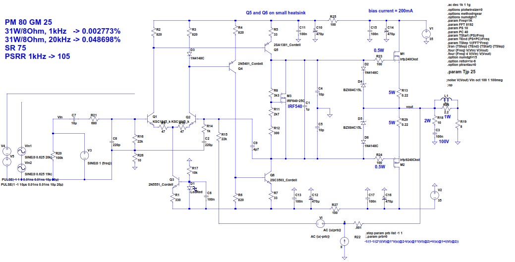

I was thinking something along this line and could adapt my current FX8 Bimo mod board to try. I had considered the IRF540 (I have those) but thought the smaller BD139 would react to temperature changes faster. If there was a convenient way to mount an MPSA92 as the Vbe temp compensator that would be even better.
The 2SC1845's are harder to get but ok if patient as 3wks from China is my normal route now for most transistors. I get the IRFP's from Digikey though.

That's why I was asking for FH9 Gerbers from Sonal Kunal (still have not seen the files yet) - to order boards. The boards are so inexpensive (circa $20 to $30 depending on size for 10, and only $10 for qnty 10 x 50mm boards) that group buys are not necessary if you have the Gerbers.

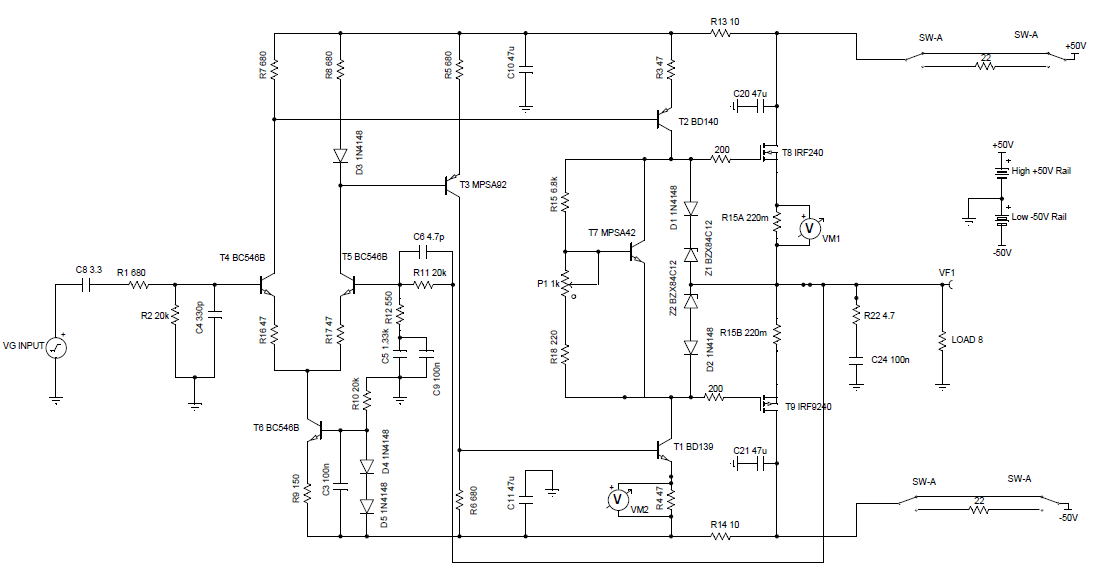

Add 100pF from base to colector on VAS transistors BD139/140.
Regards
Revised layout with 100pF added to VAS transistors.
