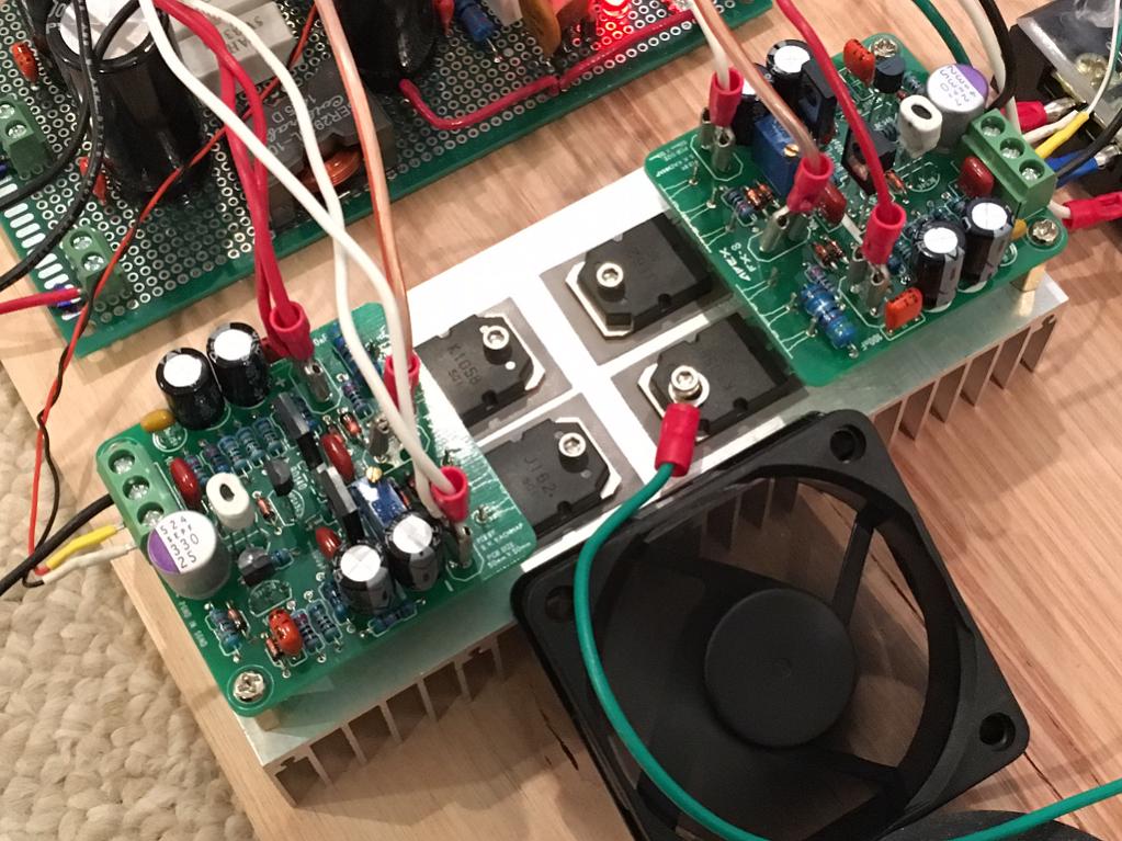

So first, here is a photo of the working amp. I am using four 220R resistors in parallel to drop the cooling fan speed to inaudible but cooling is still very effective (barely above ambient).

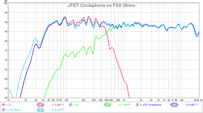

Here is the comparison of the FX8 50mm vs the JFET input Circlophone with the 10F/RS225 FAST speaker showing the cross over response. FX8 is the light blue line and note the deeper bass extension. You will notice that the combined response is a bit lower than the woofer only - that is normal and evidence that the Harsch XO is setup properly:

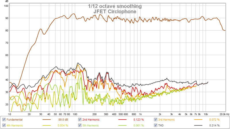

Here is the HD for the JFET input Circlophone (cursor is at 1kHz):

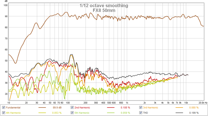

Here is the HD for the FX8 (cursor is at 1kHz), note slightly lower HD here, and the peak near 120Hz might be ambient noise:

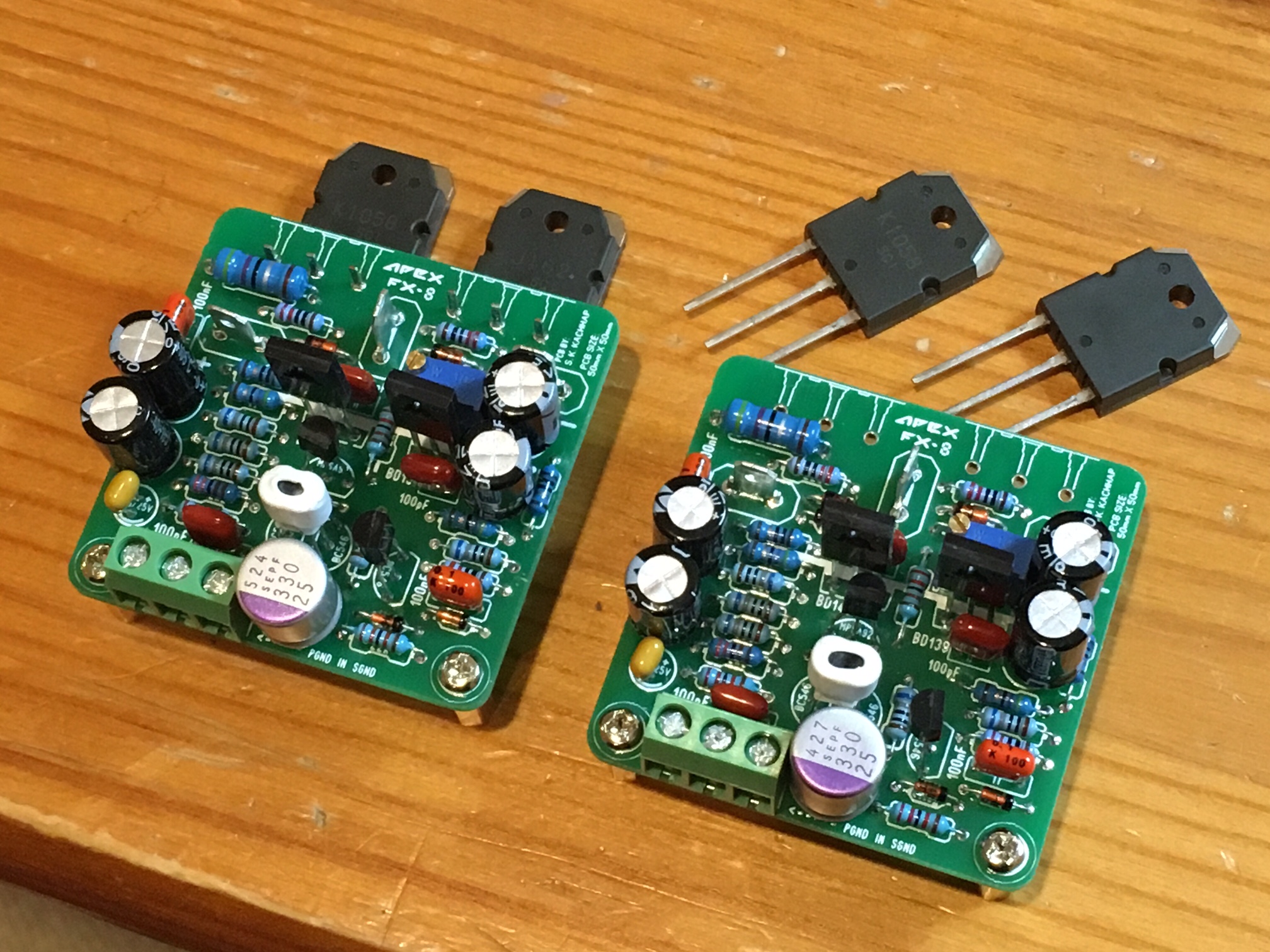

Here is a closeup of the boards so you can see the components better.

The nice thing about the layout of the FX8 Bimo board is the roomy provision for large input caps. I could put an axial polypropylene cylinder 10uF 450v cap if I wanted to. With this 50mm board, compactness was the main driver. So choices of caps that fit are limited. Certainly a small 0.1uF film bypass cap could be added and probably might help. I may try that next. I think a 4.7uF 63v MKP Wima will fit in that spot though. The thru hole there is extremely small so caps with thick pins won't work.

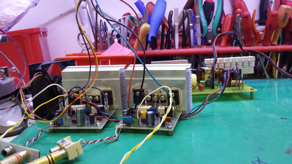

Second channel builded and tested with stabilized PSU. On my cheap speaker I can not hear the difference between linear PSU and SMPS. Will test more next week when i have more time.
About SMPS ,yes its a diy proyect from elitesecurity.org. Most parts are from old computer PSU,the transformer is revinded to nedeed voltage.The language on elitesecurity is not english so you may have problems to undestand that site.
