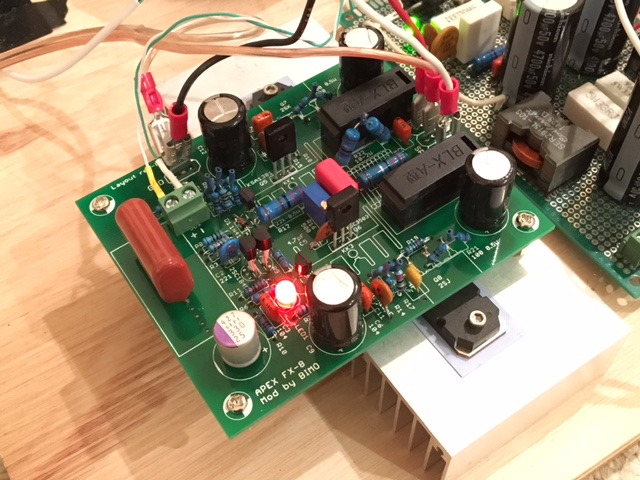

The small 1 uF caps that you are using appear to have very small footprint. what kind of film caps are those and their voltage rating? generally i use something similar to these BFC237011105. - VISHAY - Film Capacitor, MKT370 Series, 1 µF, ± 10%, PET (Polyester), 63 V | element14 India .
Also the one in the middle appears to be too big, it may create problem for heat sink fitment.
Thanks for noticing and I actually wasn't quite sure what type of cap to use. The ones on the side appear to be power supply bypass caps so I am using 50v ceramics (hence small). The one in the middle appears to be connected to the bias trimpot so may have more of an effect on audio signal path so I used a nice MKP 250v film cap (big). I will have to order some more smaller 1uF 63v film caps if that is what you think is best for the ones near the sides.
Finally, is it Ok to use a larger value than 220uF for the one on the bottom? As I recall, this one is the bigger the better.
It will be a few days before those 2SC1845's show up so I still have time to make changes. Although I don't think the 1uF ceramic bypass caps will matter much vs film caps from SQ standpoint?

Ok. I dont think it (1uf rail bypass) will matter much, I thought they were of some different value/lower voltage.
The most important components and Bimo's recommendations are in http://www.diyaudio.com/forums/soli...imate-fidelity-amplifier-711.html#post4682946 (post 7109).
regarding 220uF cap, I feel it is better to stick to schematic as intended by designer and only change if testing reveals some other value is better.

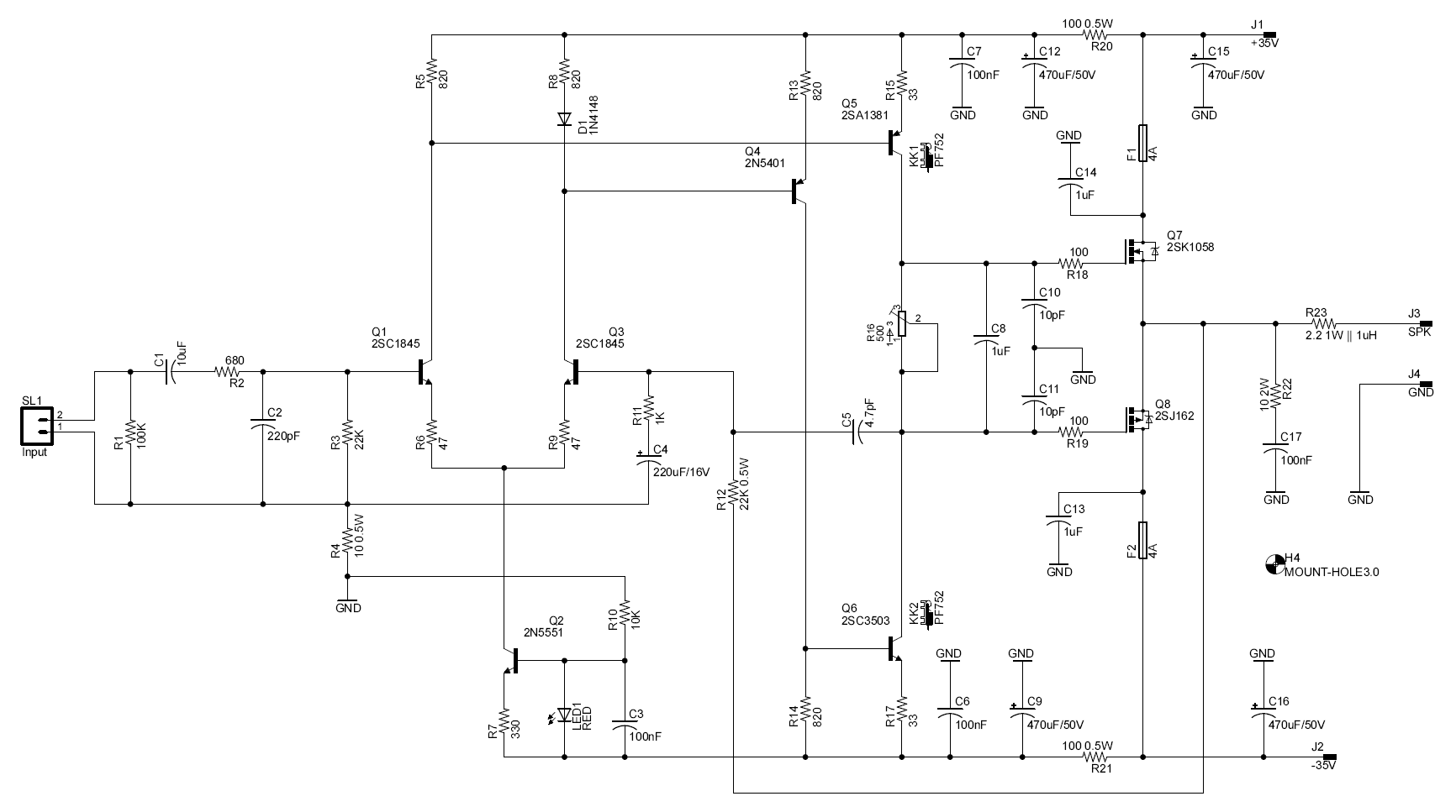

Thanks for the tips guys - before I saw Still4given's recommendation for BC550's I decided to test the amp out with BC546's with twisted legs. No matching or anything like that just stuck it in and set bias current to 175mA using external 10ohm safety resistors on the power supply leads. It plays music and sounds OK but the gain is very low compared to my other FX8 or FH9. I think at least it confirms that the PCB is good and no errors as it plays music. The VAS transistors get hot so I did not want to play too long. I am still waiting for the heatsinks to get in. In meantime I will check out Mouser or Digikey for KSC1845.
Is the lower gain simply a function of the feedback resistors or is it the much lower Hfe of the BC546 vs the 600 Hfe of the 2SC1845's? It sounds like maybe 20dB vs 31 dB which is where my other FH9 is at.
Here it is playing music with a pair of BC546's.

So looking at the schematic shows that the gain is set by R12 over R11 or 22k/1k=22 or about 27dB. Maybe that is the difference I am hearing - 4 dB difference?
Edit: Ok, bonehead mistake on my part. I had a mislabeled bag of 2.2k 1w resistors labeled as 22k. So gain was only 2.2 😛
Just replaced with a pair of 47k 1/4w in parallel for 23.5k 1/2w. Sounds great now 🙂
Nice sounding amp!

It was pretty late here when I finished so could only listen to like 2 tracks and not very loudly at that. However, what I did hear was excellent. Nothing anomalous and highs were very clear, mids were smooth, bass was authoritative and deep. I want to set the gain resistors to match my other amp. I think I am using 20k and 550R. Or change the other amp to match this one so I can do AB test. Although don't I need to wait for the 2SC1845's to arrive to truly realize the potential of this mod as it seems to be a critical part change for the IPS?
I think 2SC1845 will make S/N ratio slightly better. But the noise is not the most important in the power amplifier. I suggest you to choose highest hFE and matching them. It will make the distortion and DC Offset lower.
