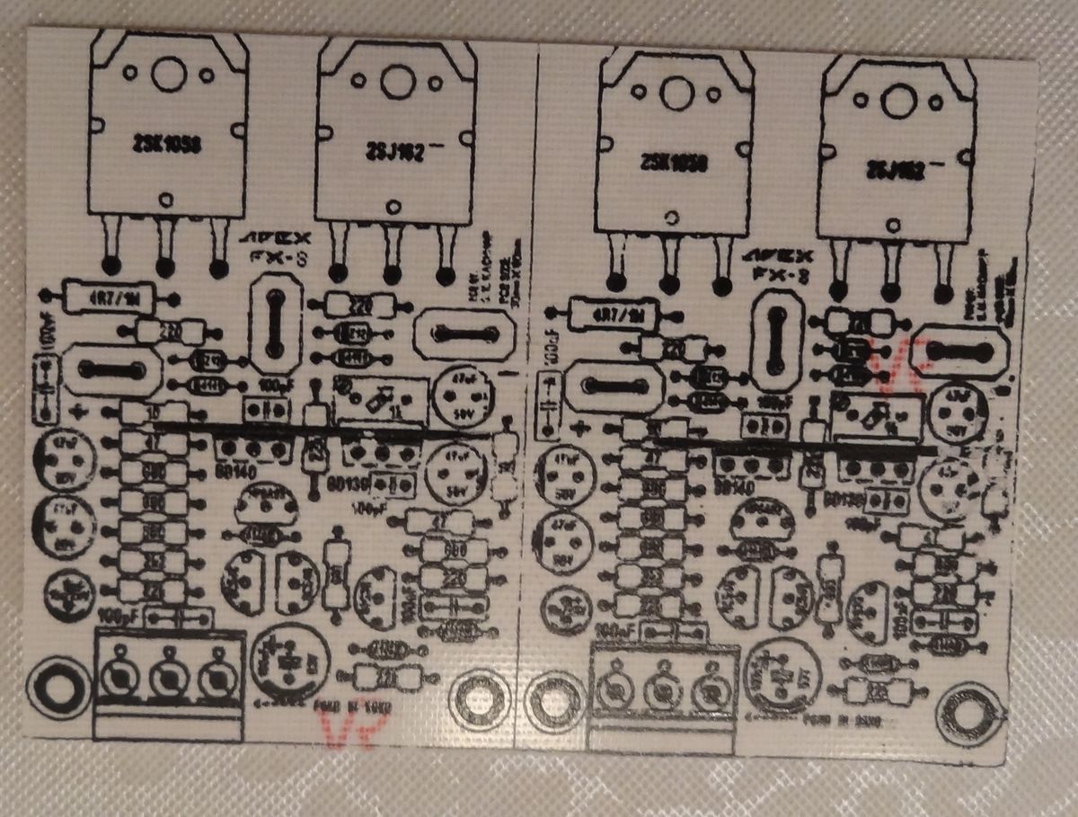

Layout is OK.![]()
Thanks - good thing too as I ordered the boards already
Is the photo above of the 5cm x 5cm layout? Any tricks to building this amp or pretty straightforward? Is the heatsink for the TO220's needed?
Looking for a datasheet for those. All I've found are motor controllers under BD639... Also searched diyAudio. Only found one mention and it was a typo... If BD639 is correct, could you point me to a datasheet, please?quite detailed, nice. But please check again. Just had a cursory look and here are my comments.
1. item 24,25 should be BD's.
Correct. I should have consolidated those two entries. I was using this spreadsheet to create my PCB layout library.2. item 22 and 22A, should be same. just bend it where you require depending upon pitch. no need to order separate part nos.
Changed to UES1E100MDM.3. item1. C1. 25V is enough. I used nichicon muse NP here (I like it). since it is in signal path, should be of good quality.
Correct. My entry is wrong. I figured that out as I laid out the board and I overlooked that correction.4. item 11. the PCB is meant for an ordinary terminal block with 5.08mm pitch. 3 pin terminal block on Sonal's layout. Not too sure how to you would fit a RCA phono connector, unless you are panel mounting it somewhere and running wires directly to PCB.
. Changed to Bourns 3296W-1-102LF5. R18, I used ordinary bourns 3296W 1k Multi Turn. It is set at 270ohm on 1 ch and 285ohm on another. It may still be fine with your proposed 500R
Will do! Thanks for your help.P.S. Please check the diameters and ratings again as per Sonal's layout

Use Nichicon 47uF/63V and Panasonic 1000uF/16V or other same size capacitor for my layout other.
100uF/63V will not fit use 47uF/63V instead. Other capacitor from benz2 BOM will fit.

In addition to above, for the terminal block something like this would be suitable 1546216-3 TE Connectivity | Mouser

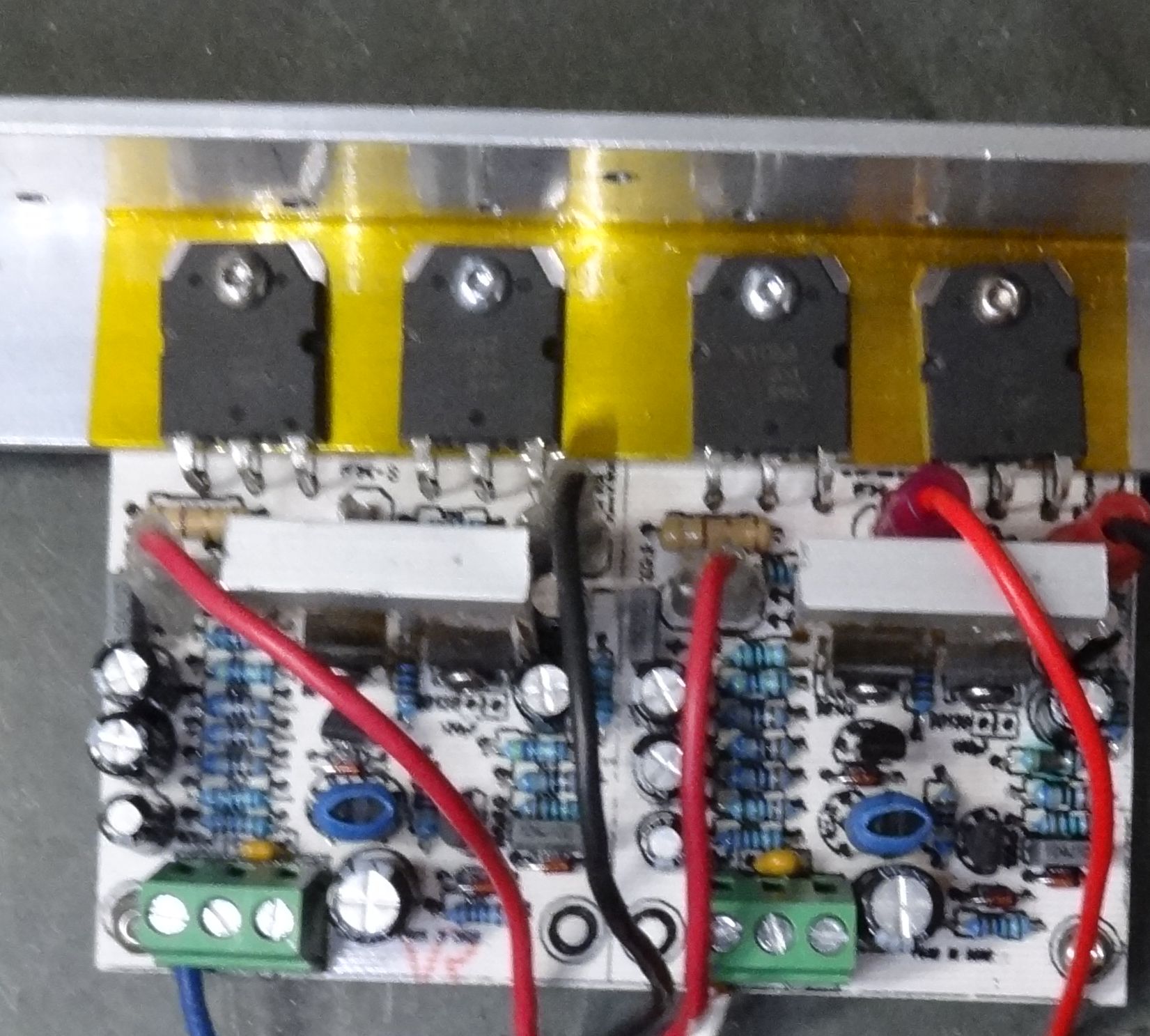

I have had if playing music all day today. It's a really sweet amp. You can probably do without the little heatsink on the VAS. It only runs at about 10mA with the bias set at 100mA. The little sheet metal sink I have on it get only warm. I will leave it in case it helps with thermal stability. There are no issues that I have found. You can simply follow the silk and have no problem. There is still a slight overshoot on the square waves but it sounds lovely so I'm not sure I would mess around any further.
Blessings, Terry

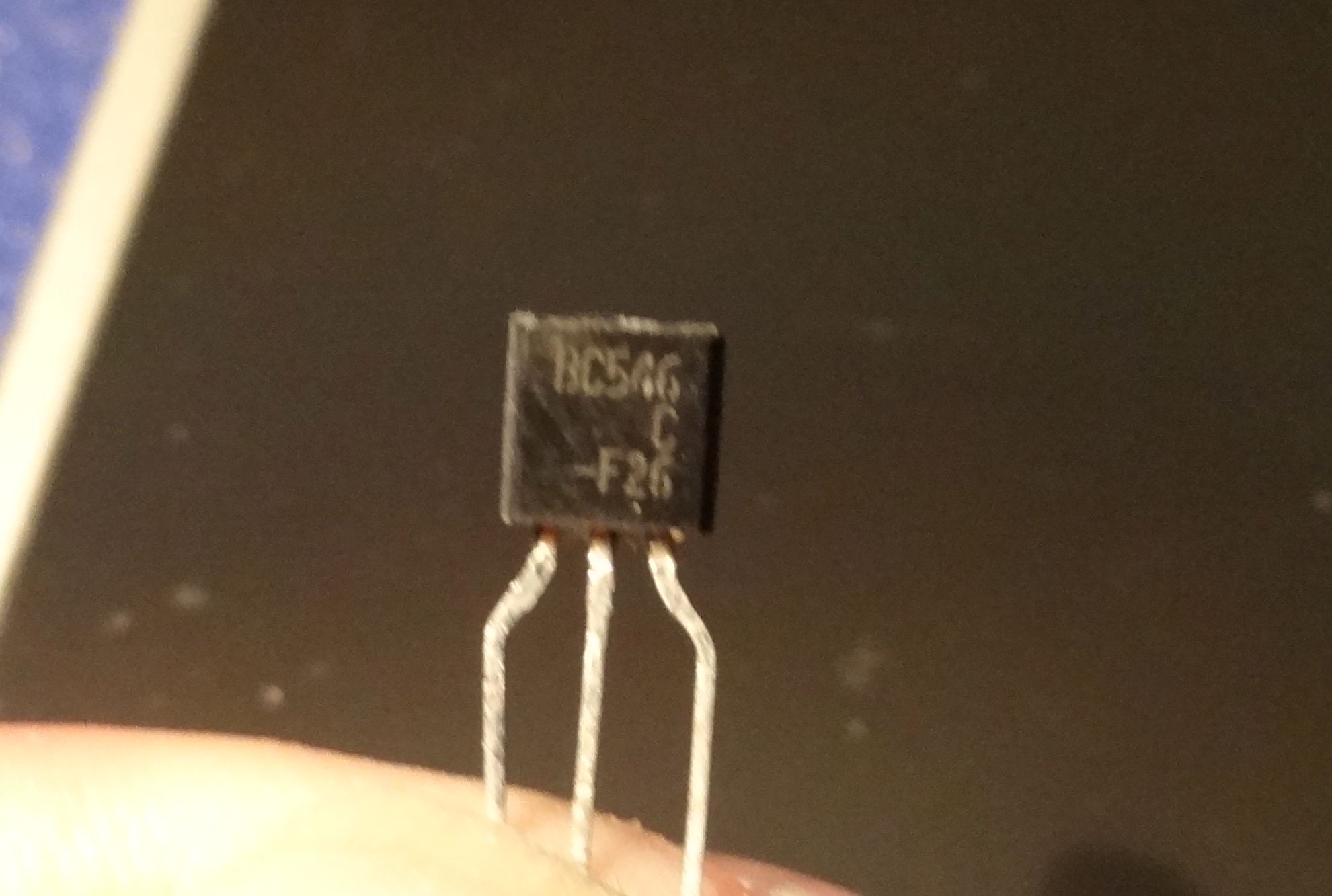

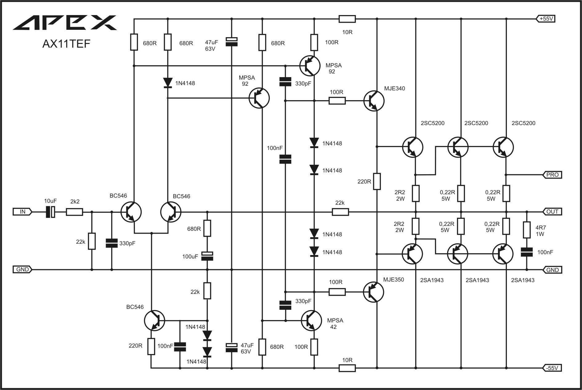

Terry, can you please measure the voltage across R2 in this schematic:
http://www.diyaudio.com/forums/soli...imate-fidelity-amplifier-131.html#post4641883
Also, who made the BC546 you put there? I just want a datapoint for this transistor...
I read 56mV across R2. I'm not sure who made the BC546C transistors. They were a gift from BobEllis. I was building the SKA and needed the C grade and couldn't find them. He was kind enough to send me some. Here is a picture if that will help.
