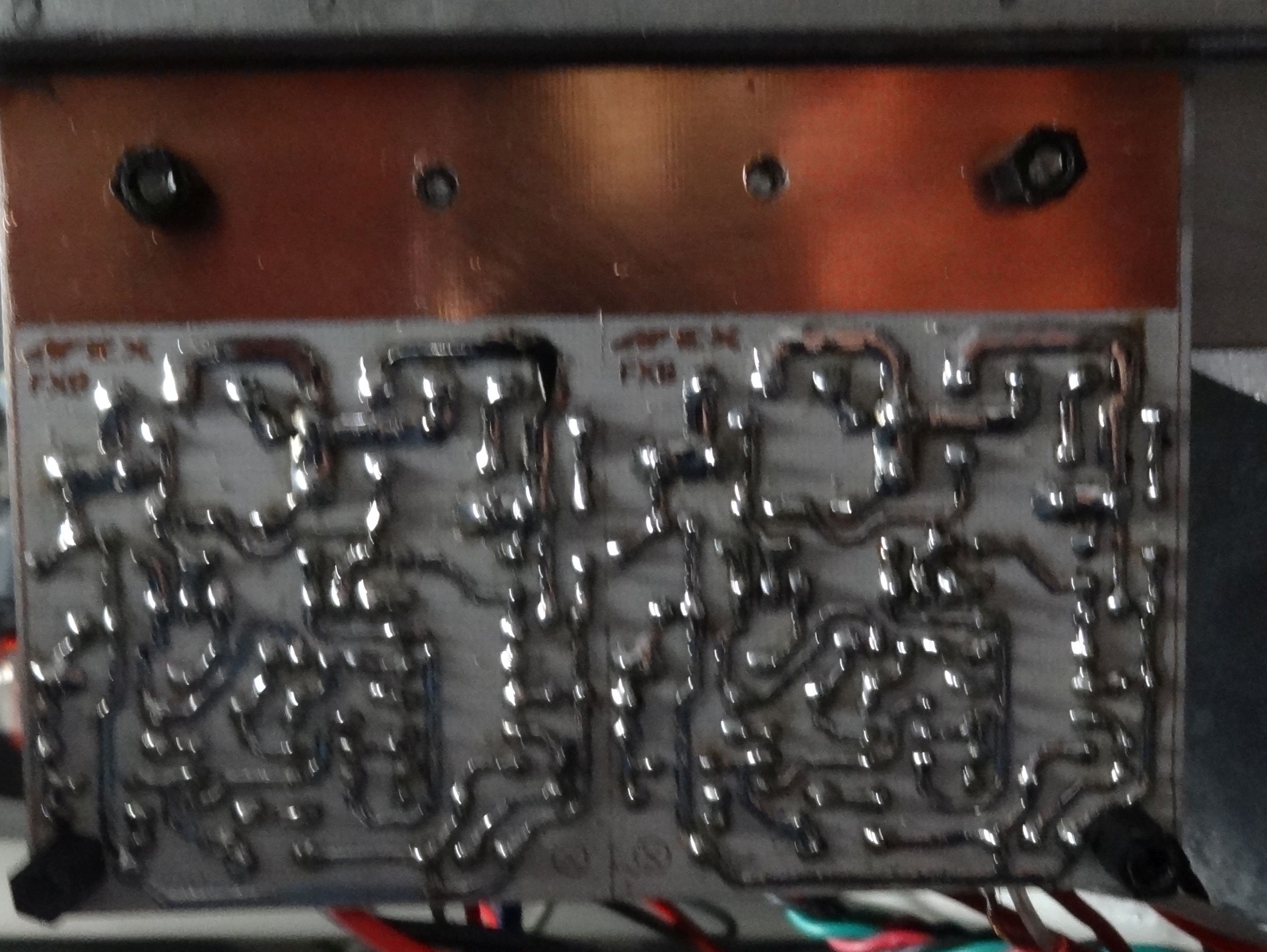

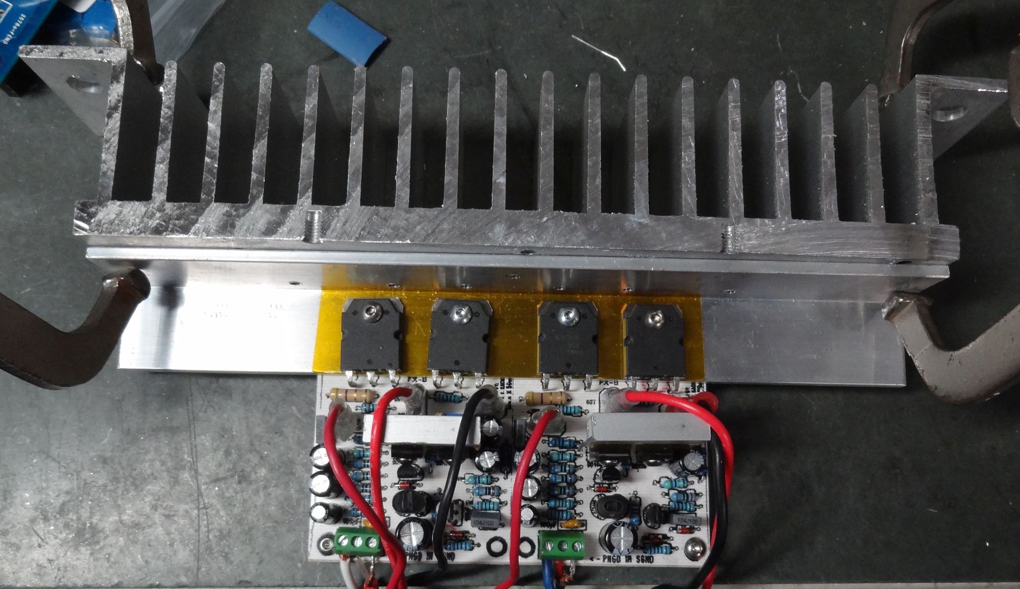

I have had if playing music all day today. It's a really sweet amp. You can probably do without the little heatsink on the VAS. It only runs at about 10mA with the bias set at 100mA. The little sheet metal sink I have on it get only warm. I will leave it in case it helps with thermal stability. There are no issues that I have found. You can simply follow the silk and have no problem. There is still a slight overshoot on the square waves but it sounds lovely so I'm not sure I would mess around any further.
Blessings, Terry
Thanks for the feedback. Your scope screenshots of the squarewave looked pretty good - there was overshoot? Did not look that visible from what I saw. Anyhow, glad you have time to listen to them. What speakers are they driving?
It really fits on 2 inches square? Amazing...
Didn't Mr. Mile suggest you could set the bias at only 70mA?
Have you tried it at that level?
If I can leave the heatsink(s) off the BD139/140, that would simplify the build even more.
Tomorrow I will unbolt the VAS heatsink and see how hot they get.
The overshoot is no big deal. It just looks like a high pass tone control is added. The highs and mids are sweet and the bass is to die for. I have been a VSSA fan but I think I like this one better.
I fit both channels on a 2-3/4" x 4" board and that includes the area beneath the outputs.
It sounds just fine on 70mA. I actually set it at 70mA with +-36V rails. Then I bumped it up to +-42V rails because someone had asked about higher rails. That raised the current to 100mA. Even at that they are fine on the smallish heatsink I have clamped to it. That heatsink is only 8" x 1-3/4" with 1-1/2" fins. Handles it fine.

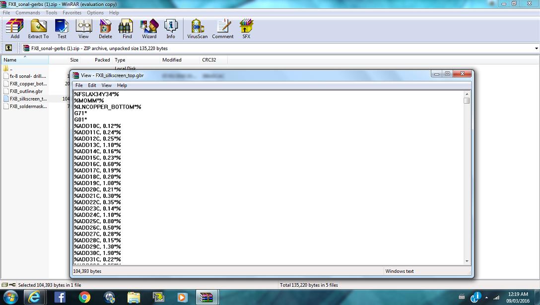

Hi
I'm unable to open any of your attached file for some reason.
I have WinRAR 64bite version..
Does anyone has the same issue?
Thanks 🙂
Greetings
zipped and in excel 97-2003 for the ods file as posted by Ben. hope this solves all problems🙂. better to open it with default winzip!
Hi
I could open these one
I would love to get your layout, silkscreen
Are U using Sprint because I own that and I can open Sprint files to
To be honest I'm confused usually I'm able to open the layout and silkscreen from zipped to. Is these your layout, I mean your design?
First time I got these problem
Thank you any way

Thank you for the reply, Terry.
I bet you go through quite a bit of solder looking at the bottom of your board.🙂
I'm going to have some boards manufactured using the earlier Sprint file you posted where the 139/140s are at the rear of the board, instead of near the middle like on the board you've shown here.
Things are a little too crowded for my liking on the 5cm x 5cm boards someone posted, so I'll stick with my 55mm x 62mm boards.
If you are using that layout then the VAS is not an issue because you can just attach the to the main heatsink since they are all in line with each other.
Hi
Thank you any way
Greetings
Layout of 50mmx50mm size is done by Sonal Kunal and he has posted sprint file in http://www.diyaudio.com/forums/soli...imate-fidelity-amplifier-649.html#post4635579 no. 6484 (only correction in decoupling cap orientation[ 2 nos. of 47uF to be reversed] on positive rail, other than that, its been tested by Terry-no problems). I only posted gerbers as it was requested by a member.
Hope its clear now.
