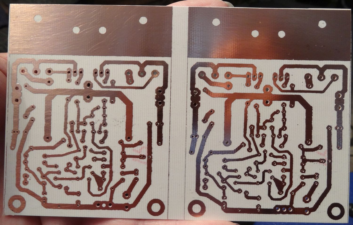

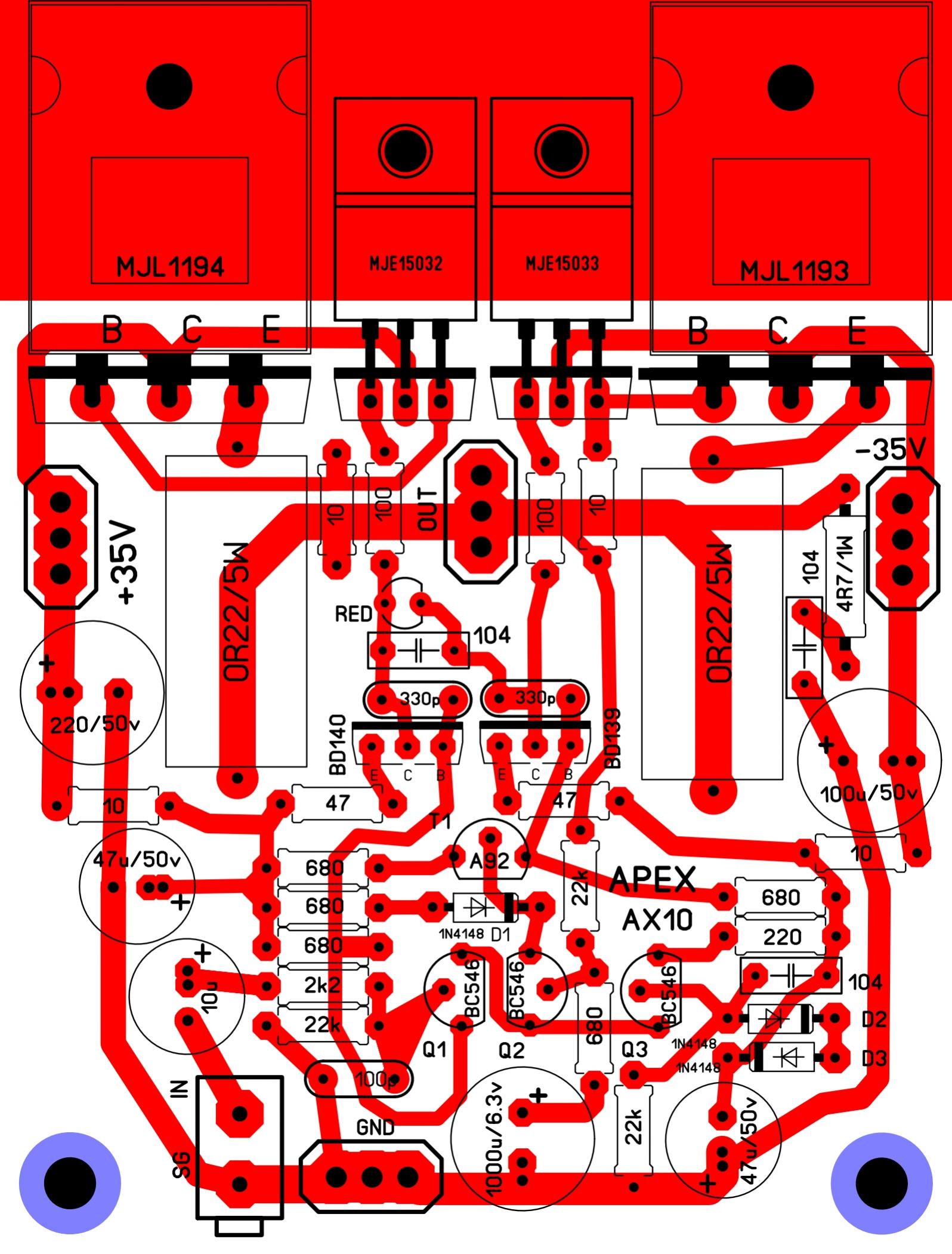

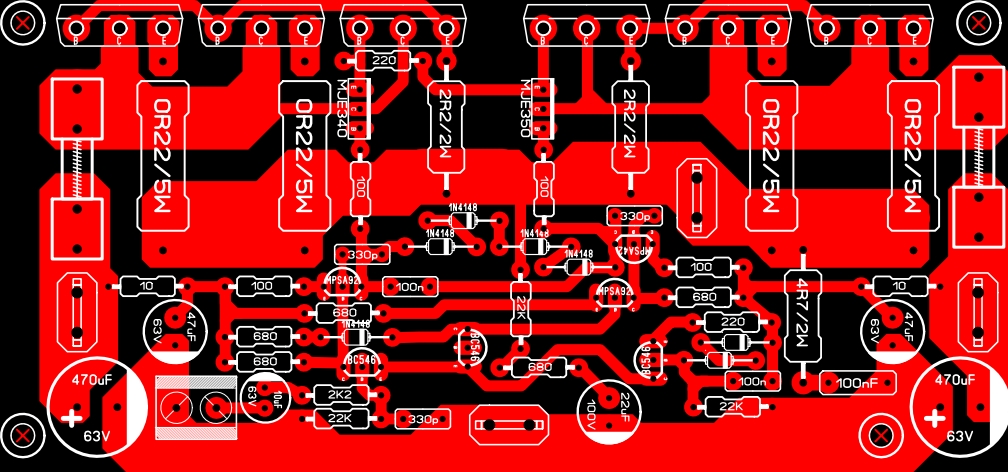

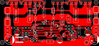

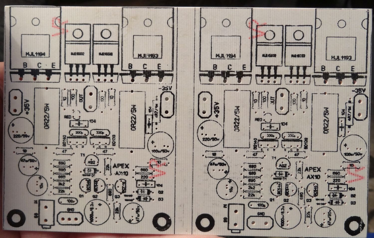

I played around with the AX10. Can one or more of you check my layout for errors before I etch a pair?
Thanks, Terry

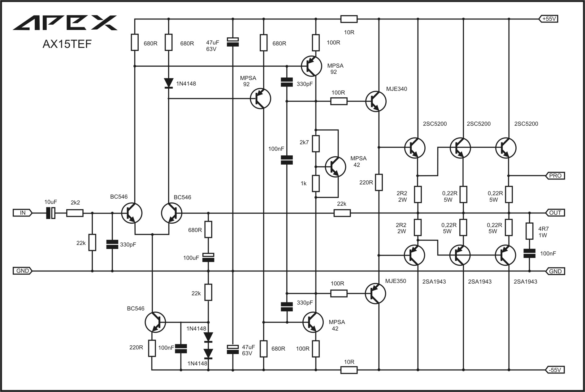

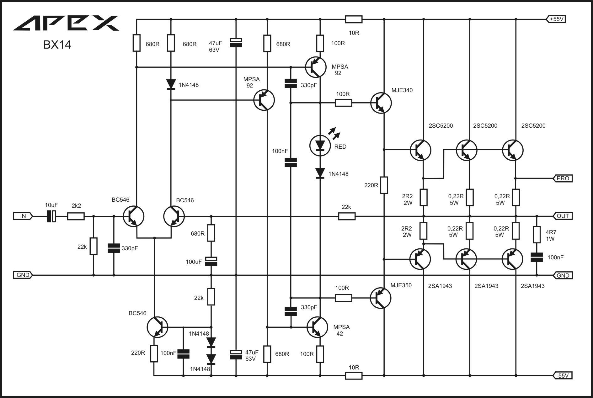

Hi Mile, can I use MJE 340-350 used instead of MPSA42-92, 2SC4793, 2SA1837 instead of MJE 340-350 and add Vbe multiplier instead of IN4148 in AX11TEF.
AX11TEF work without Vbe multiplier only 2SC5200 and 2SA1943 must be on heatsink.

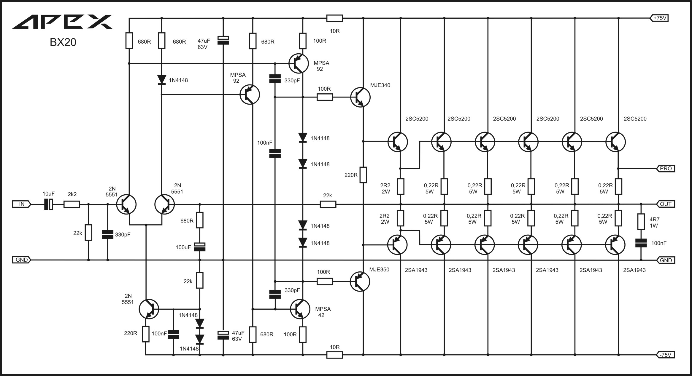

You can use MJE340/350 instead MPSA42/92 and 2SC4793/2SA1837 instead MJE340/350, I suggest to add 3 more pairs of outputs and replace BC546 with 2N5551 to get 500W amp.
Looks ok electrically except ofcourse as pointed by Mr. Mile.
reg
Prasi
PS: trace widths around power and o/p section needs some work. o/p appear to have unequal widths.
I added the cap and made some changes. I have etched a pair and will report back after I have had time to populate and test.

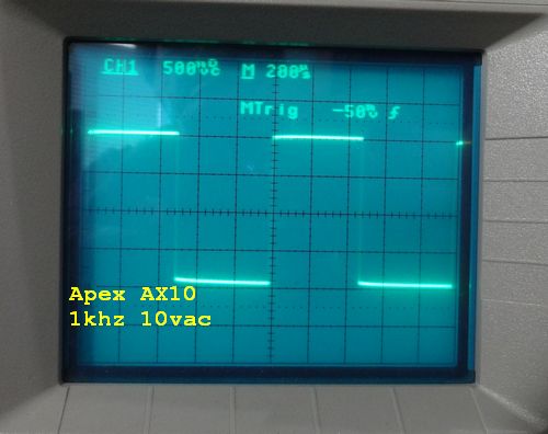

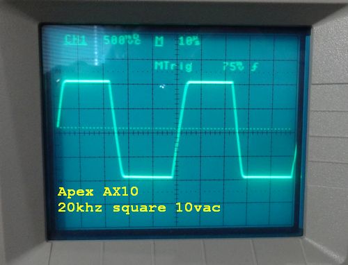

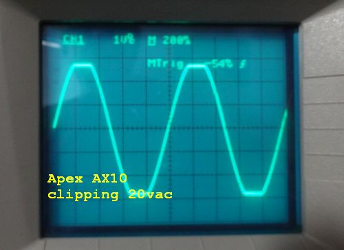

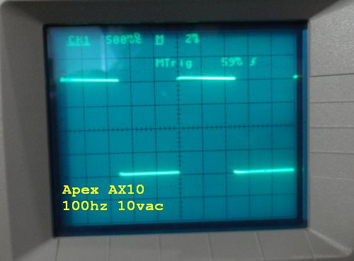

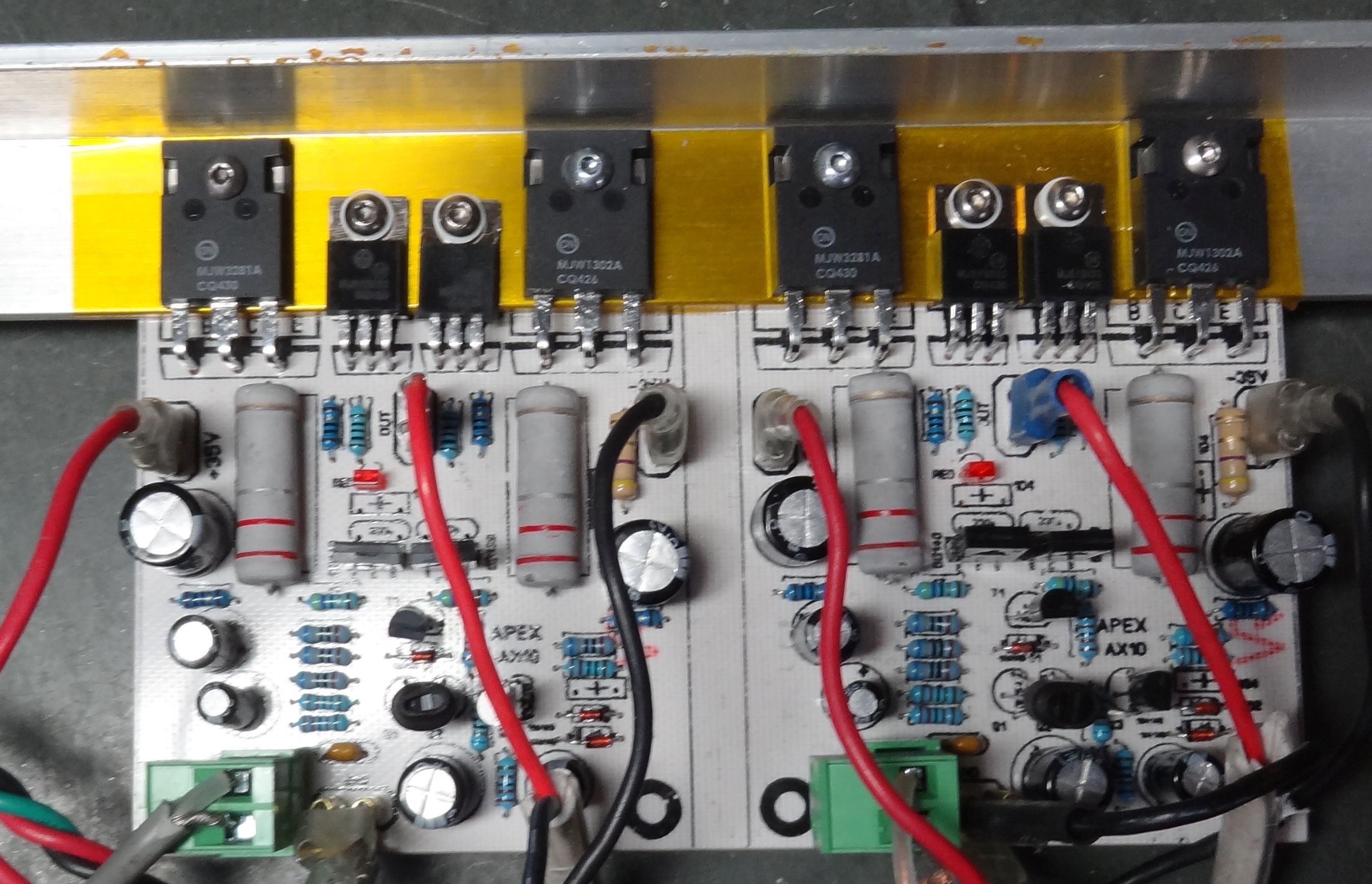

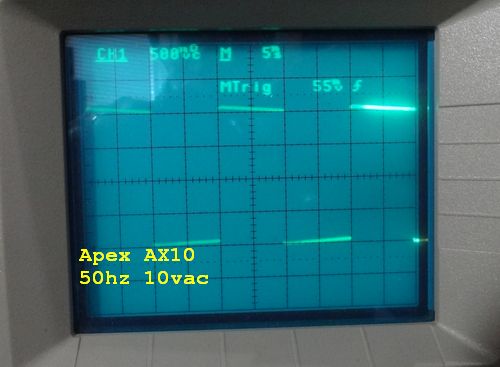

Here is is singing.
Sounds really good. I was surprised. I see 48mA on the rails and virtually 1mV across the emitter resistors yet I don't see or hear any crossover distortion. Runs fairly cool.
I also don't see any overshoot like on the FX8. Strange since they have the same front end. Clips right at 20vac / 8R so about 50W. Nice little amp.
Blessings, Terry

Nice work, idle current go thru drivers not thru outputs... measure voltage on drivers emitter resistors (10R)
Regards
