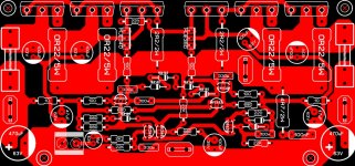

100W Ultimate Fidelity Amplifier

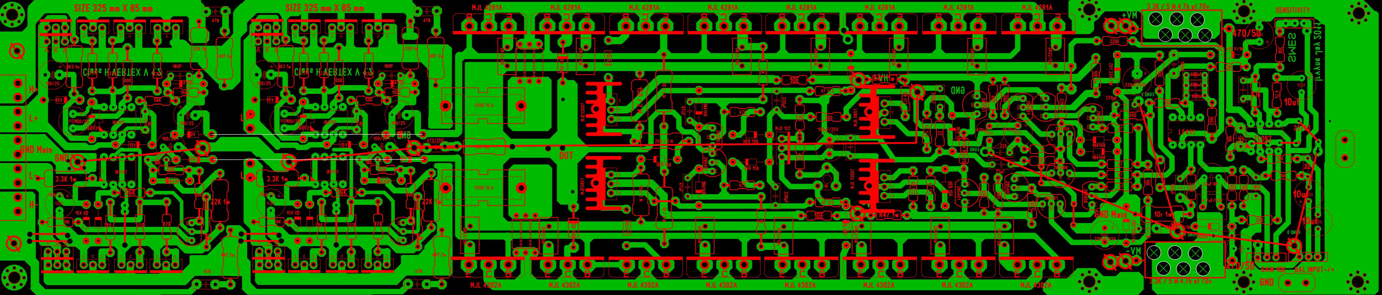

I've made suggested changes, and i was planning to layout 5 pairs too.
Unfortunately I have to work on something else.
Sprint file attached, maybe someone else could improve and go on with this one.

The 64 million dollar question!😉. I am betting on fx8. 😀

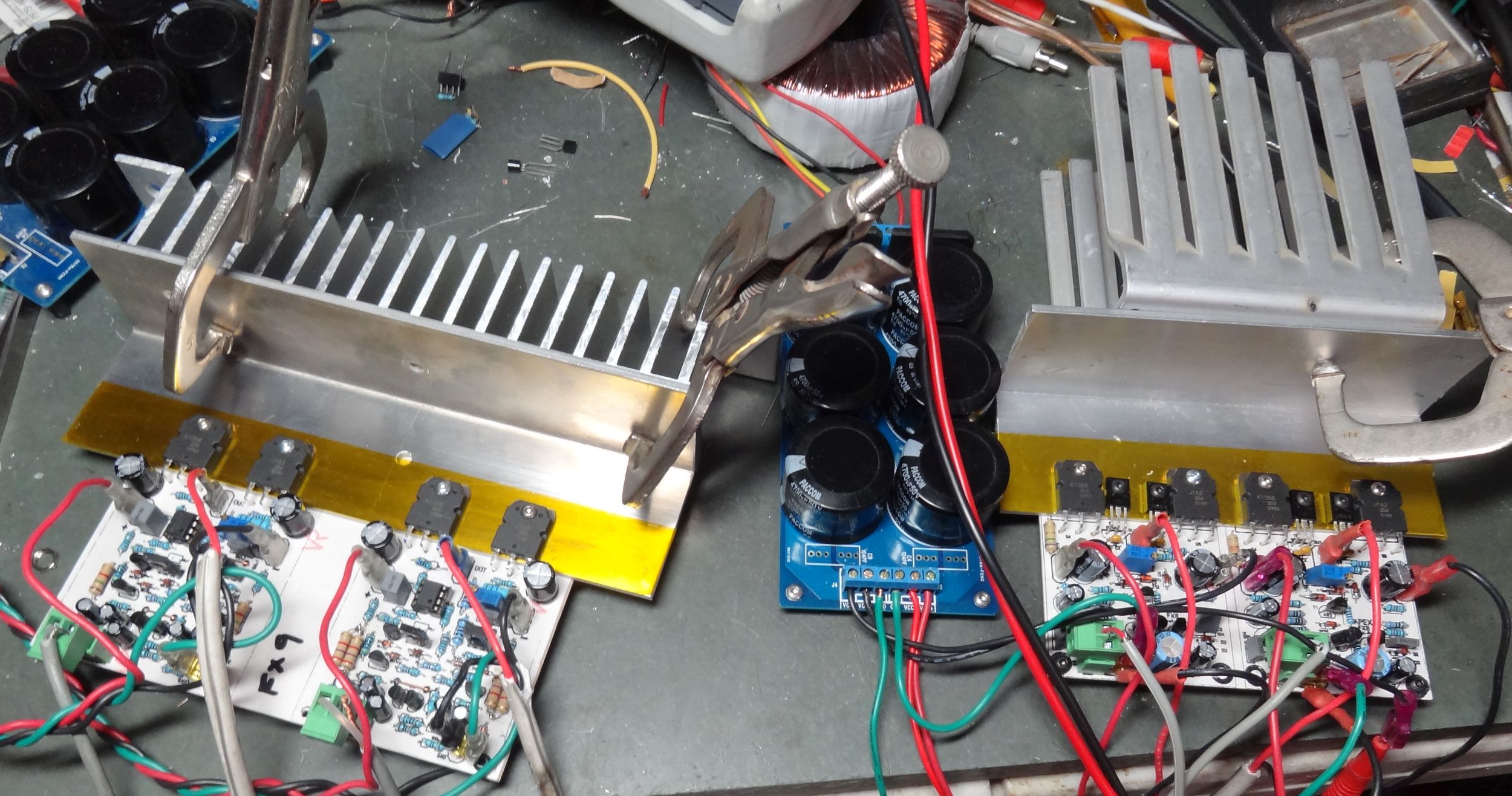

Hi Guys,
I finally got a chance to hook up both amps. Each are running on their own PSU consisting of a 30-0-30vac 160VA transformer and a bank of 6-4700uF caps. The variac is turned down so they are providing +-36vdc to each amp. They are hooked up to my A/B setup which uses two, 15k DACT Type 21 Stepped Attenuator Potentiometers for independent volume adjustment, a speaker switch and being fed by a Technics CD player. I played some Larry Carlton, Ella, Techno and blues through them. I know you guys were hoping for a clear winner, but both of them are so true I just can't find a difference between them. I say take your pick. You will be more than pleased with either.
A couple of things to take into consideration. The FX8 has fewer parts but the outputs are more expensive so I think the cost ia about the same. The AX10 runs cooler unless you push both of them and then they seem to run about the same temperature.
Sorry I couldn't be more help.

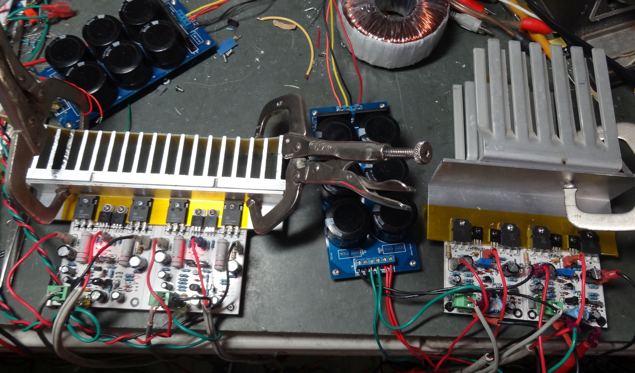

Well, as suspected, they are both perfect. Beautiful!
The differences that I see.
FX9 needs to warm up for the offset to settle to +-2vdc. For the first minute or so it runs about 45mV. Once it warms up the servo will hold it very close to zero volts.
FX8 holds right around 10mV offstet or less.
The FX9 has a little higher gain. I have to run the volume control higher on the FX8 to make them equal. Once they are equalized there is no noticeable change when switching from amp to amp.
I already displayed the square waves of each amp earlier in the thread.
Blessings, Terry

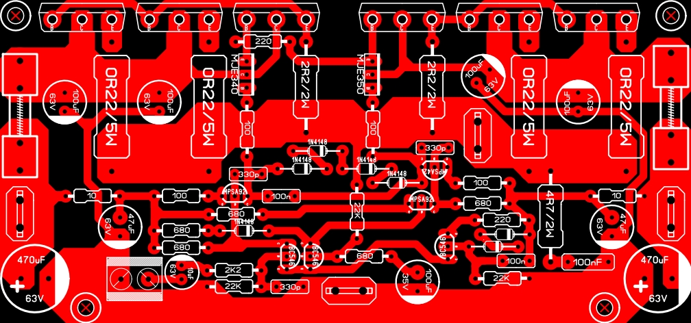

Also, can you please post your Sprint file for the AX8?
Thanks...
I used to have a B1 Mezmerize in front of the attenuators but a few guys thought it may be affecting the results so I bypassed it. The goal of the A/B setup is to compare amps so really the attenuators are all that is needed to equalize the outputs. I have built a few different line stages as well as preamps. Some of them "change" the sound of the music. Some add gain some don't. I like the little line stage that Mile posted earlier. I may add those to some of the amps once I get around to building some cases.
I'm attaching my sprint file for the FX8 you see in the pictures. It is basically a clone of Prasi's layout. Sonal uploaded his sprint file for the smaller layout he designed.
Blessings, Terry
