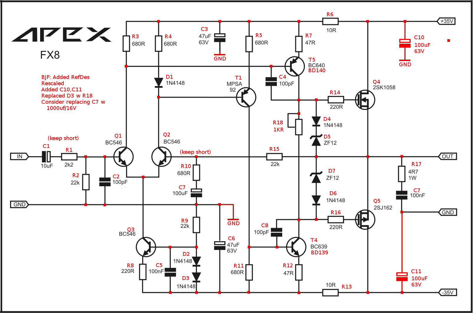

+- 53v is a little high for a single pair of outputs. If you assure that you will not go lower than 8 ohm speakers that may be OK.
+ one has to consider trafo regulation+ mains variation. In my place, sometimes its 230V and other times its more than 240V
I remember reading in VSSA thread that 45V is max for 1 pair latfets.

That was not related to Lafet but to BC550/560 input pair => Vceo=45V limitation.

I put one together, but I didn't have Prasi's recent recommendations. I also added Prasi's ref des to the schematic, and tightened it up a little graphically.

quite detailed, nice. But please check again. Just had a cursory look and here are my comments.
1. item 24,25 should be BD's.
2. item 22 and 22A, should be same. just bend it where you require depending upon pitch. no need to order separate part nos.
3. item1. C1. 25V is enough. I used nichicon muse NP here (I like it). since it is in signal path, should be of good quality.
4. item 11. the PCB is meant for an ordinary terminal block with 5.08mm pitch. 3 pin terminal block on Sonal's layout. Not too sure how to you would fit a RCA phono connector, unless you are panel mounting it somewhere and running wires directly to PCB.
5. R18, I used ordinary bourns 3296W 1k Multi Turn. It is set at 270ohm on 1 ch and 285ohm on another. It may still be fine with your proposed 500R
