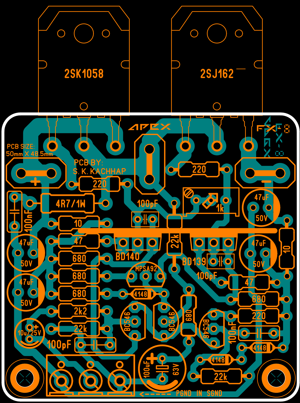

Beautiful work guys. I knew that something had to give, but didn't know enough to know that the real-estate-eating caps could be downsized, I simply noticed that dragging all the tracks to T1 and T2 up to the heatsink was using a lot of area....
Also, while I fully understood that T1 and T2 still NEEDED heatsinks, I was probably overly-optimistic to think that the heatsink(s) wouldn't need real estate of their own. Nice to put them together. Do they need to be thermally-coupled?

47uF/50V used instead of 22uF/63V, some manufactures have 56uF/50V with 6.3mm diameter and 2.5mm lead spacing.
1000uF/16V can be used instead of 100/63V as Mr. Miles suggested but only 1000uF/16V with 8mm diameter and 3.5mm lead spacing will fit.

Nice compact design. Are the two 47uF's on left flipped polarity as drawn? Does this system not need emitter resistors?
Oops, I missed that.
Since only sprint files are shared every one can correct it.
Sonal Kunal
On this latest FX8 compact 50mm square layout - I am trying to follow this but how is DC offset handled? I don't see the servo op amp or a trimmer pot?
If you match the hfe of i/p pair (both are same sex, so should be very easy), and thermally couple them , there would not be any issues with DC offset. If I remember correctly, I measured around 5mV . And I tested this at different times.

You mean the two BC546's sitting next to each other? My DMM's also have the hfe measurement holes on the top deck. How closely does it need to be matched? Should be easy as you say as they are made in the same batch probably when delivered (especially if bought on tape reel). I am new at making my own PCB's - for fabricating the PCB's with typical low cost Chinese suppliers (10 5cmx5cm boards for $10), do they accept the Sprint file directly? I have mostly heard that they want Gerber files.
