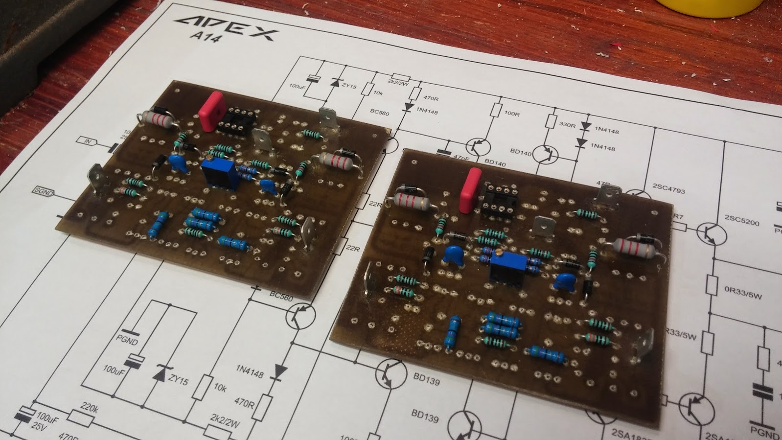

This is my AX14 with TEF OPS 7 pairs of output
I assembled this last January 2012 running on +/- 90 VDC

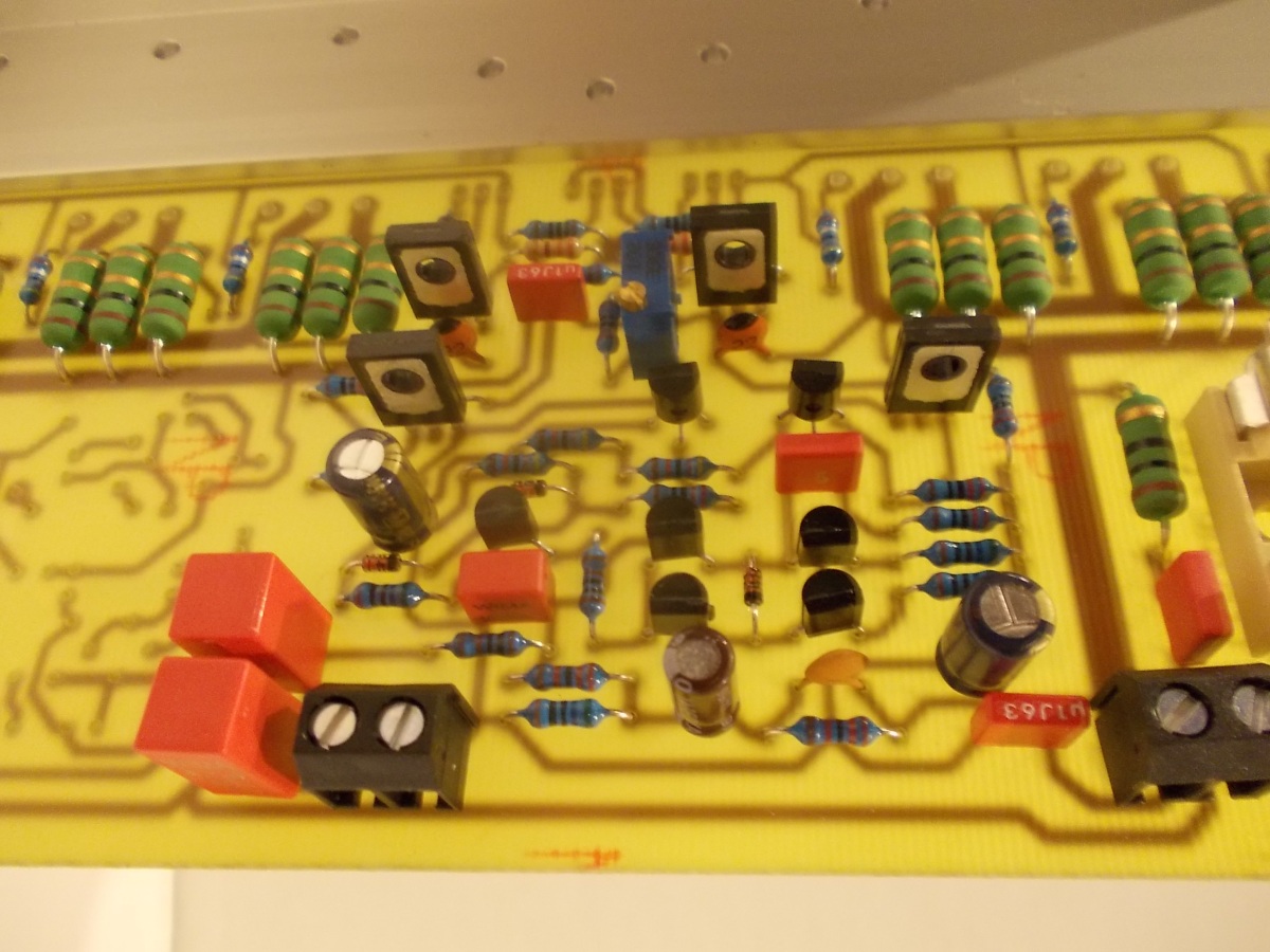

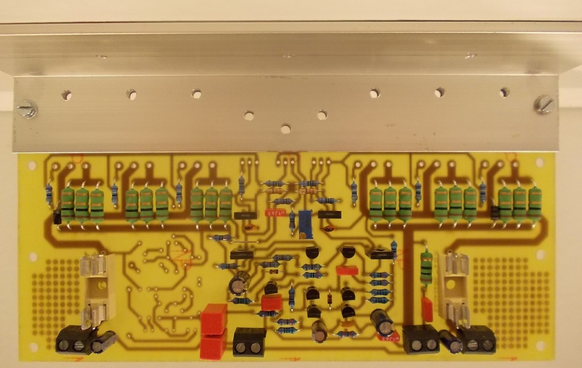

Nice one remle, can you share your driver board?
Sorry sir willy this s a 3 year old project and i lost all my files because my hard disk failed a year ago
Its Ok sis... thanks anyway i'll pm you.

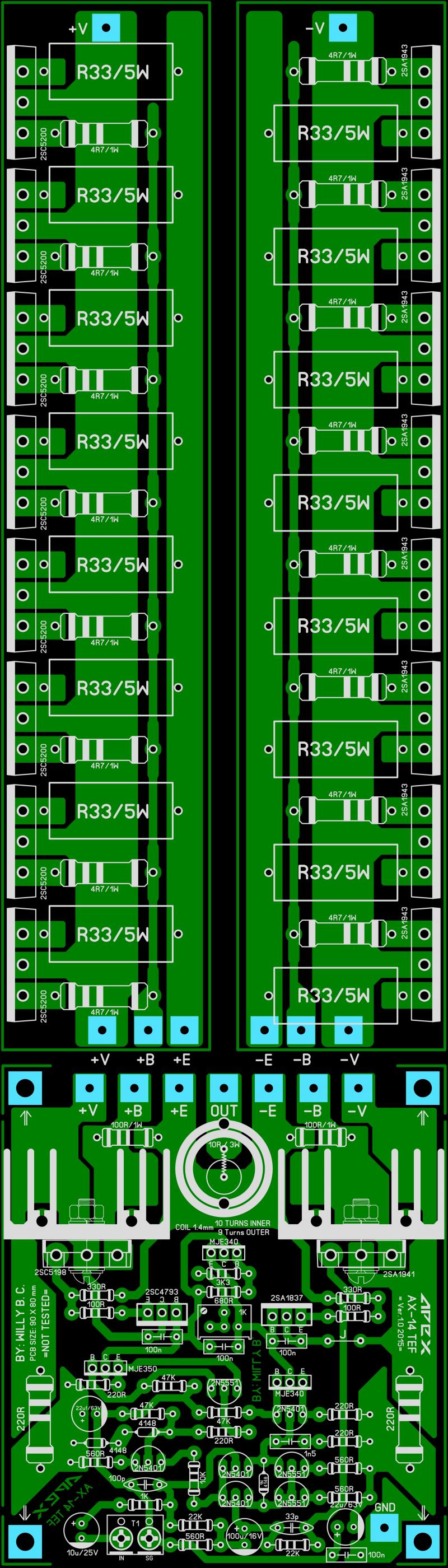

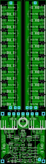

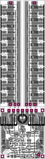

maybe this would help?
(in first Zip i´d say it was Ardrew Lebon´s work,all the other files are from OlafK)
