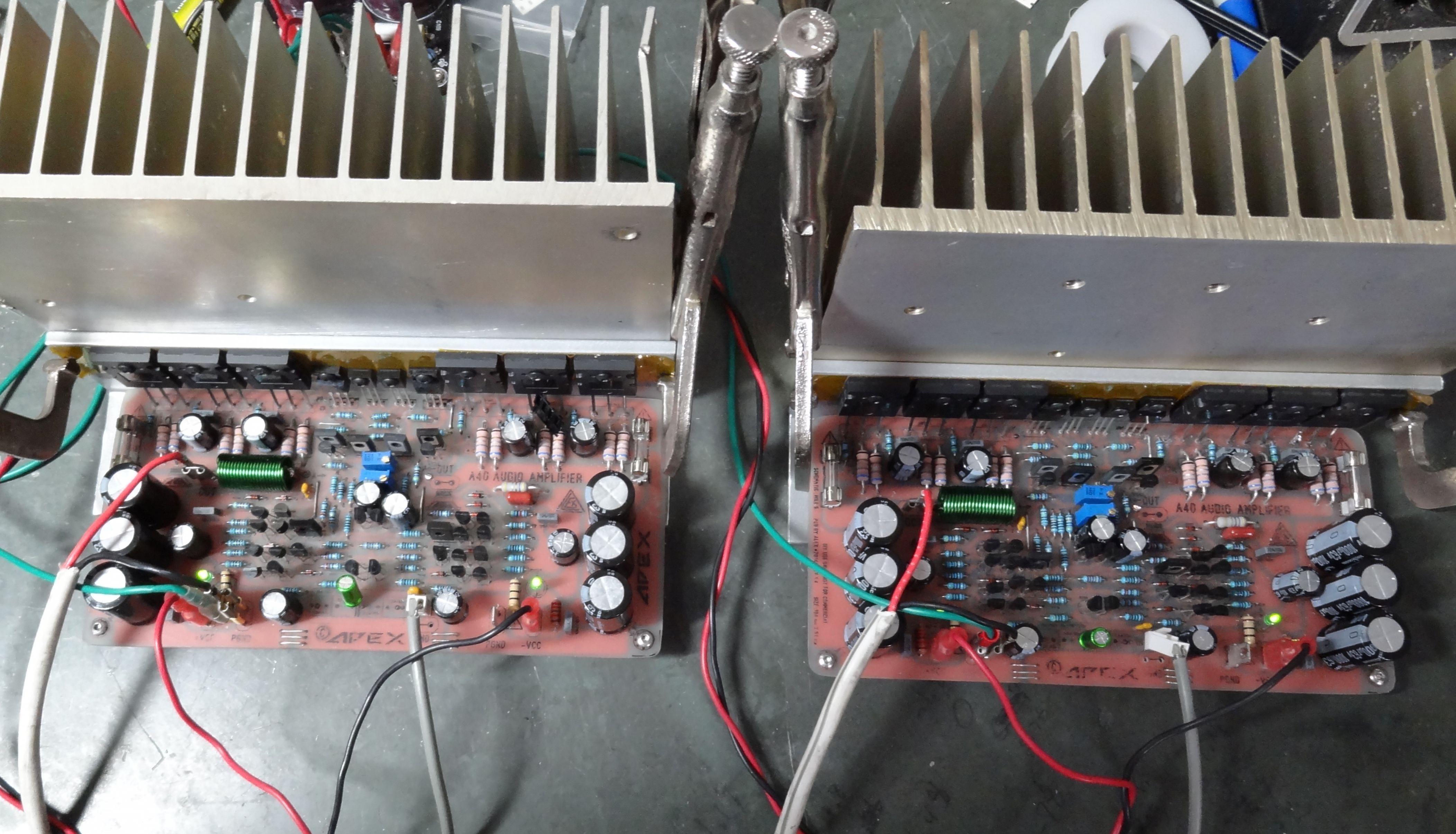

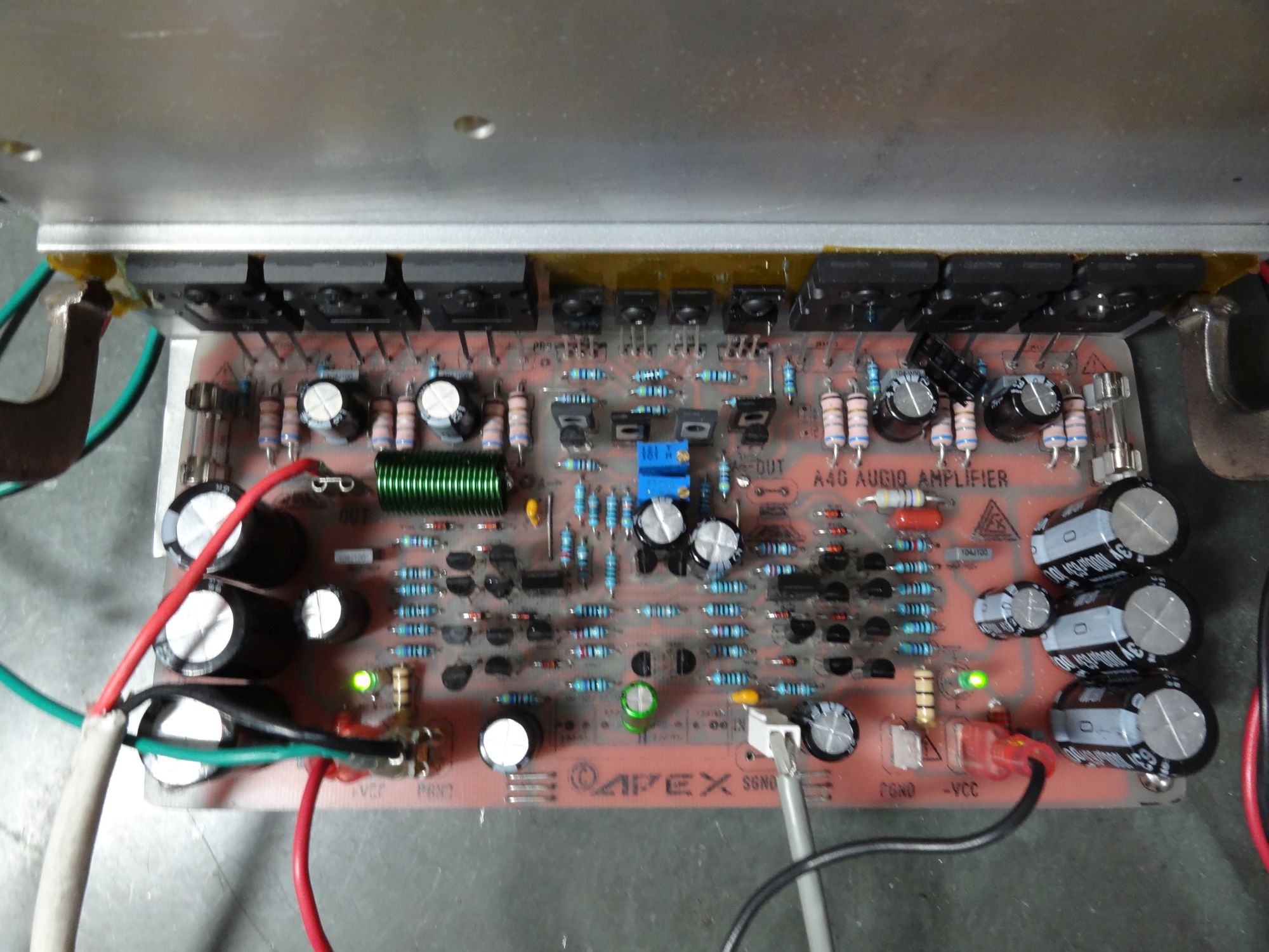

Well I finally finished my A40. I had initially Used 2SA1320-Y/C3423-Y for the VAS and I just couldn't get it working. I got in some more MJE340/350 so I changed those out and now the amp plays perfectly as one would expect. Listening to it all morning. Another winner!

I'm glad to hear it's working , sound it's perfect even without ton correction I hope you understand why I added at offset ,one more capacitor .....
Have you change 470 ohm resistor to 470K in offset adjust circuit?

Hi Alex,
Yes I did see Mile's post about the 470K change. The board is set up per the silk except I used those 2SA1360/C3423 for the thermal transistors. I will probably change those too because the bias takes a long time to settle and I think thy maybe to blame. I also used MJL4281/4302 for the outputs. I running it on +-60V rails and it isn't breaking a sweat.
I figured the back opposite facing polar caps on the NFB were to take the place of a non-polar. Cheaper option.

The high Cob of the slow transistors may be adding compensation that ends up just about right............... I had initially Used 2SA1320-Y/C3423-Y for the VAS and I just couldn't get it working. I got in some more MJE340/350 so I changed those out and now the amp plays perfectly................

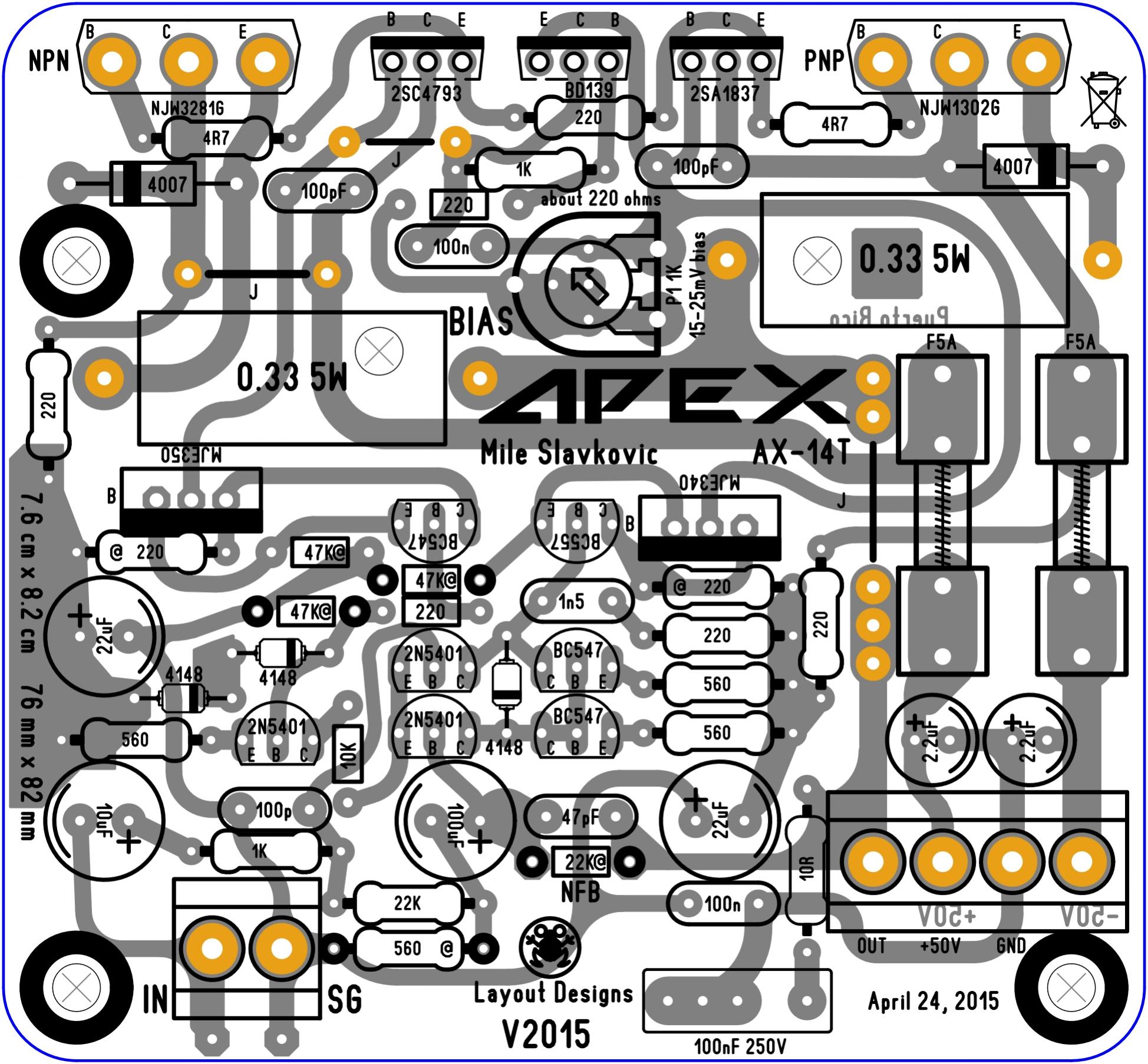

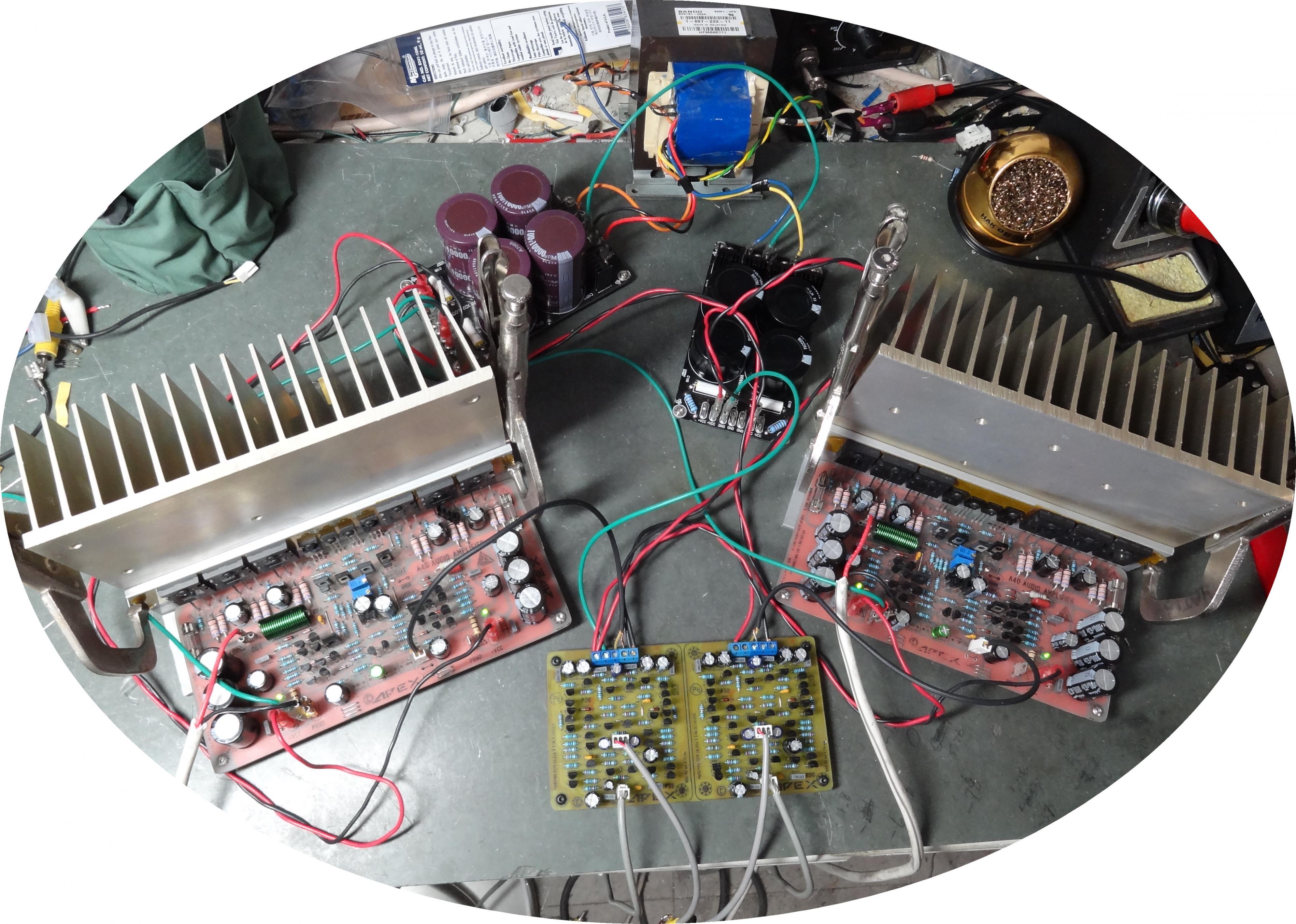

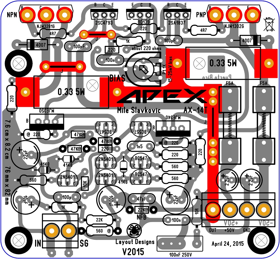

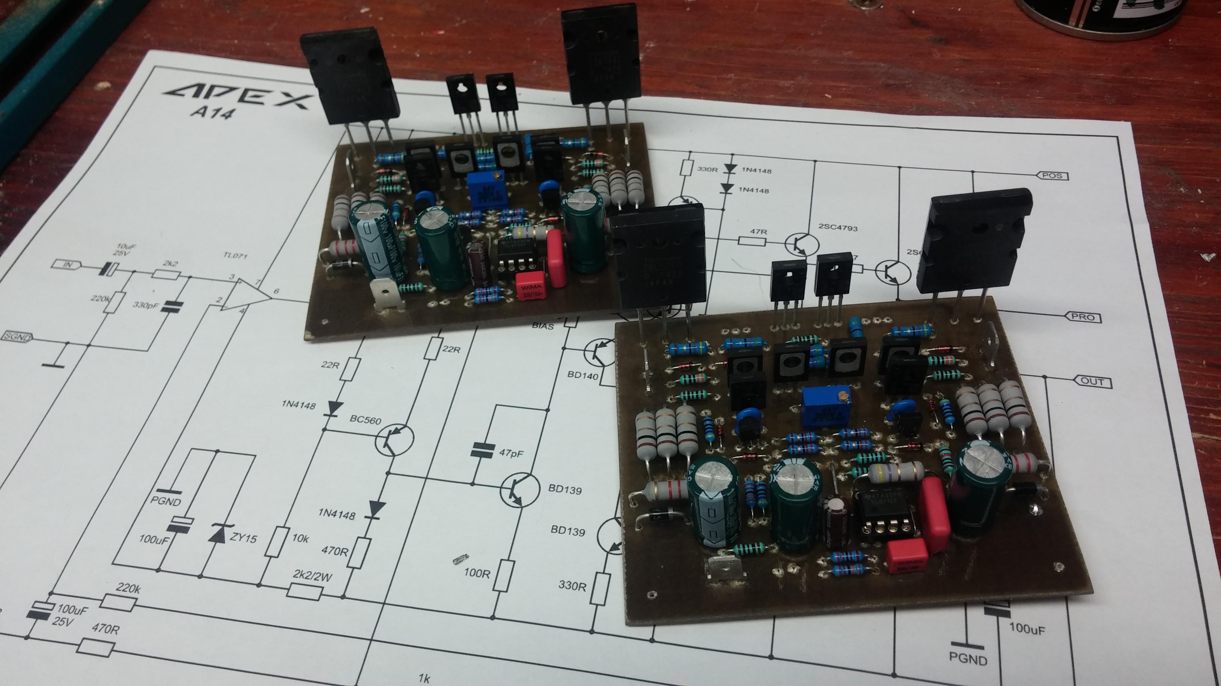

Hello guys here is AX-14 that I did and just change the size of some 1/4W resistor macros so the can fit better also I will share Sprint file so you guys can used as reference for other projects please used only for diy I do this because I do love this hobby
have fun with it
Regards
Juan

Hi Terry and all,
did you try using ksa1381/ksc3503 for the drivers?
I find in sims that they usually give an amp slightly better performance.

Hi Rick,
I did not try the KSA1381/KSC3503. I suppose I could try them now that I have it working. I can't be sure that the 2SA/2SC were the problem. I changed them out on one of the boards because the board wasn't working and the MJE's were what was called out on the screen print. After I changed them and there was still issues so I went over the board again with a diode tester and discovered I had one diode reversed on both boards. When I flipped the diode the board with the MJE340/350 worked and the other one didn't. At that point I changed out the pre-drivers to MJE and at the same time I reflowed all of the solder joints on the whole board. After that the board worked but I don't know for sure if it was the transistor change or the reflow. I won't have time today but tomorrow I will change them back or even install the KSA/C devices and see how that goes. I would hate for someone to go to a lot of trouble finding a certain device if it is not necessary.
I don't have distortion testing equipment. The guy to go to is Thimios. He is a much better tester and builder than I am.

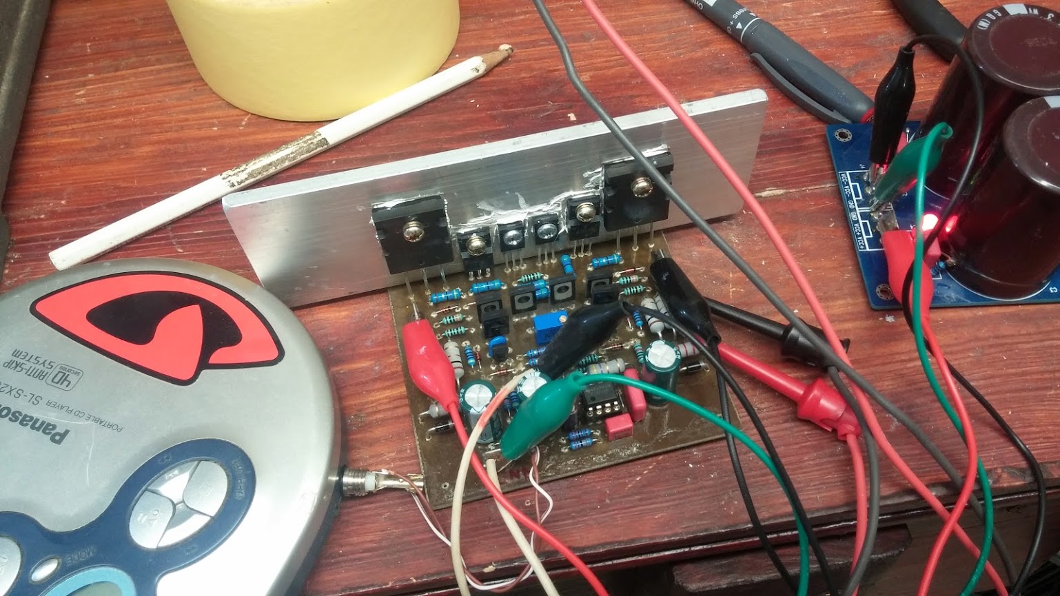

Just finished ...after few my mistakes is running.... Offset is OK, but bias still no OK. When I set bias 50mA, after On/Off procedure is 100 mA and slowly decreasing back to 50mA...maybe some temperature compensation, or something totally different I have to check it tomorrow..
Andrew said it right,slower transistor acts as faster with added compensation. as i have read (not much to be sincerely) that is most common thing happening when output transistors from vintage amplifiers were replaced with newer that have lower parasit capacitance - an amplifier starts to oscilate - and problem is most commonly solved by adding some compensation to those newer transistors,to make them slower.
faster transistor on wrong place can make troubles...

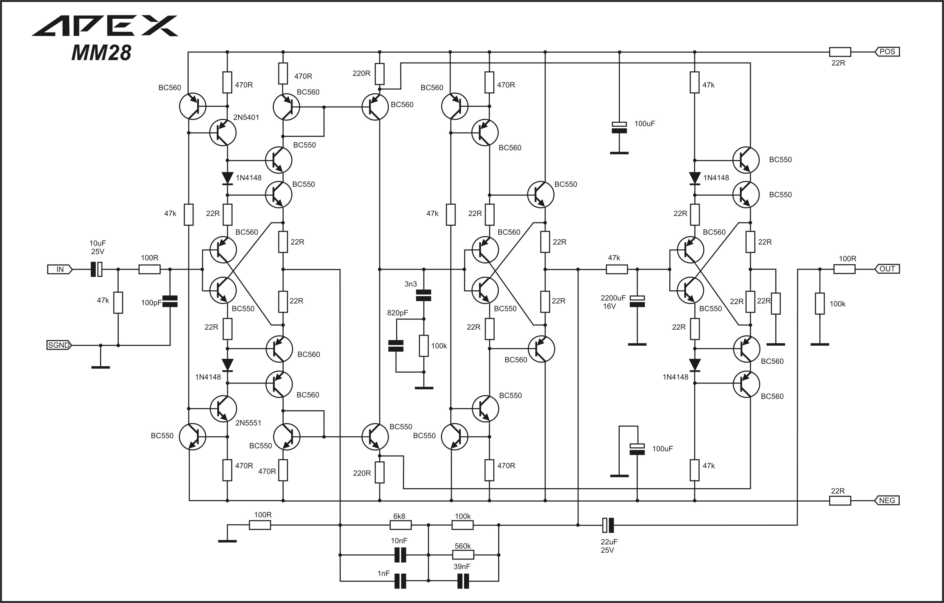

P30 meets A40. Ooo-la-la! Pure Apex/Alex blend.
A40, +- 60v rails
P30 +- 22v rails.
Highly recommended.
With MM28 it will be pure CFA pre/amp amplification.
