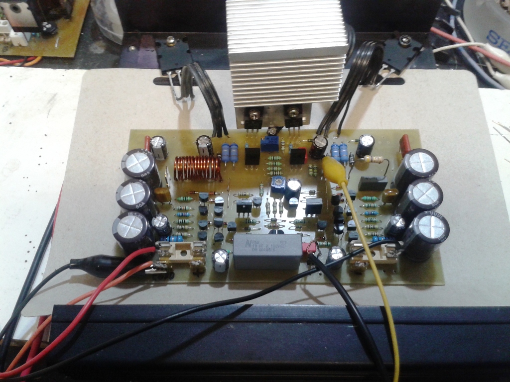

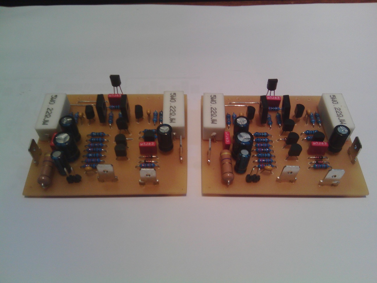

My A33 ready and singing 😉 . It was a welcoming lesson for me building this amp I had a lot of troubleshooting to do till i realized that it caused by the offset trimmer (one turn) and that make me learn more. Now is playing and I must say that this amp is very clear in voices and instruments especially in classic guitar and saxophone , beautiful bass very clear high !! I will do more listening when I complete my second channel . I don't have any measurements to show you because I don't have the equipment to do this. Only my ears and I love what I hear!😀

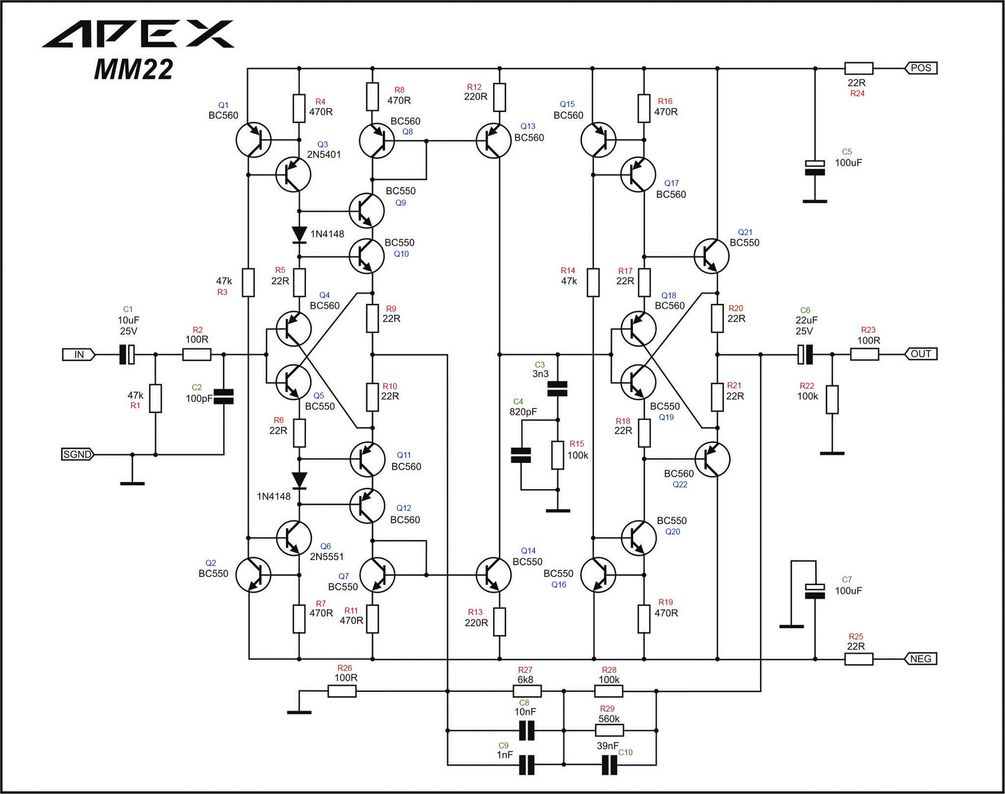

MM22
Apex Hello!
I am interested in your MM22 preamplifier. I designed a circuit that is not yet checked but I have some questions.
What is the output voltage of the MM22?
What is the difference between the MM22 and MM28?
Thank you!

MM22 is phono MM RIAA preamp with 300mV output, on MM28 add circuit for beter simetry (DC offset before output cap)

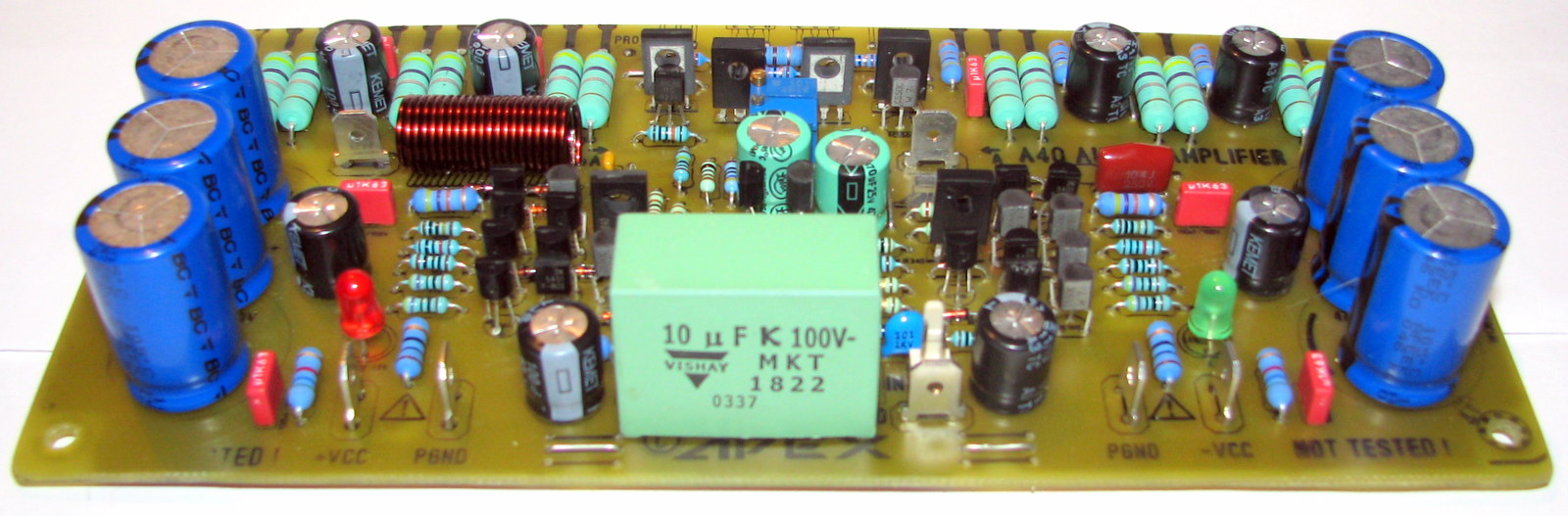

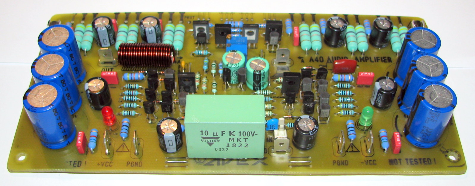

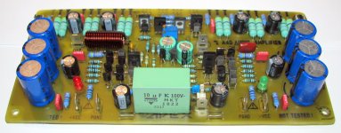

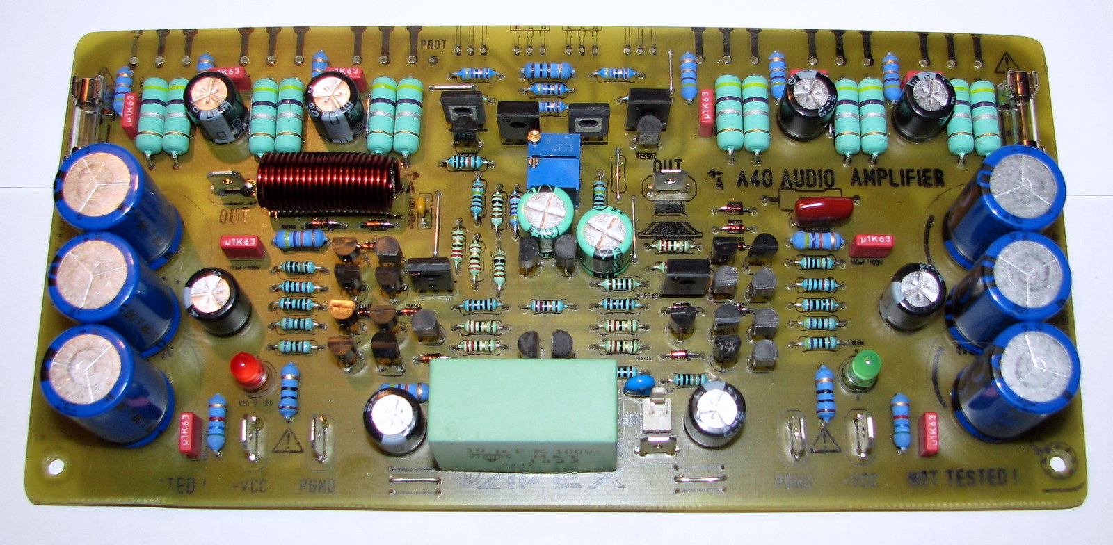

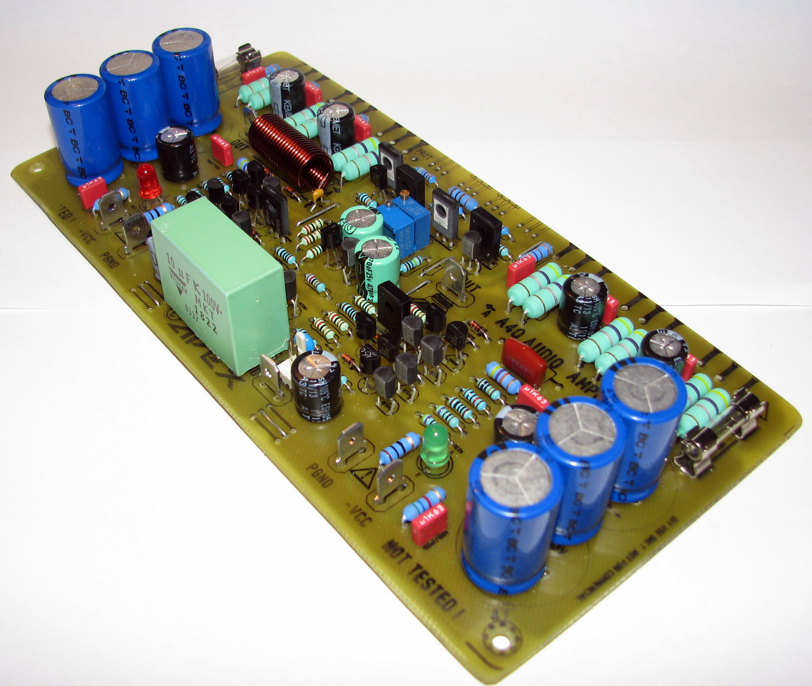

A40 audio amplifier
A40 audio amplifier ,one channel in progress 🙂 ,soon will be tested 😉
Regards,Alex
