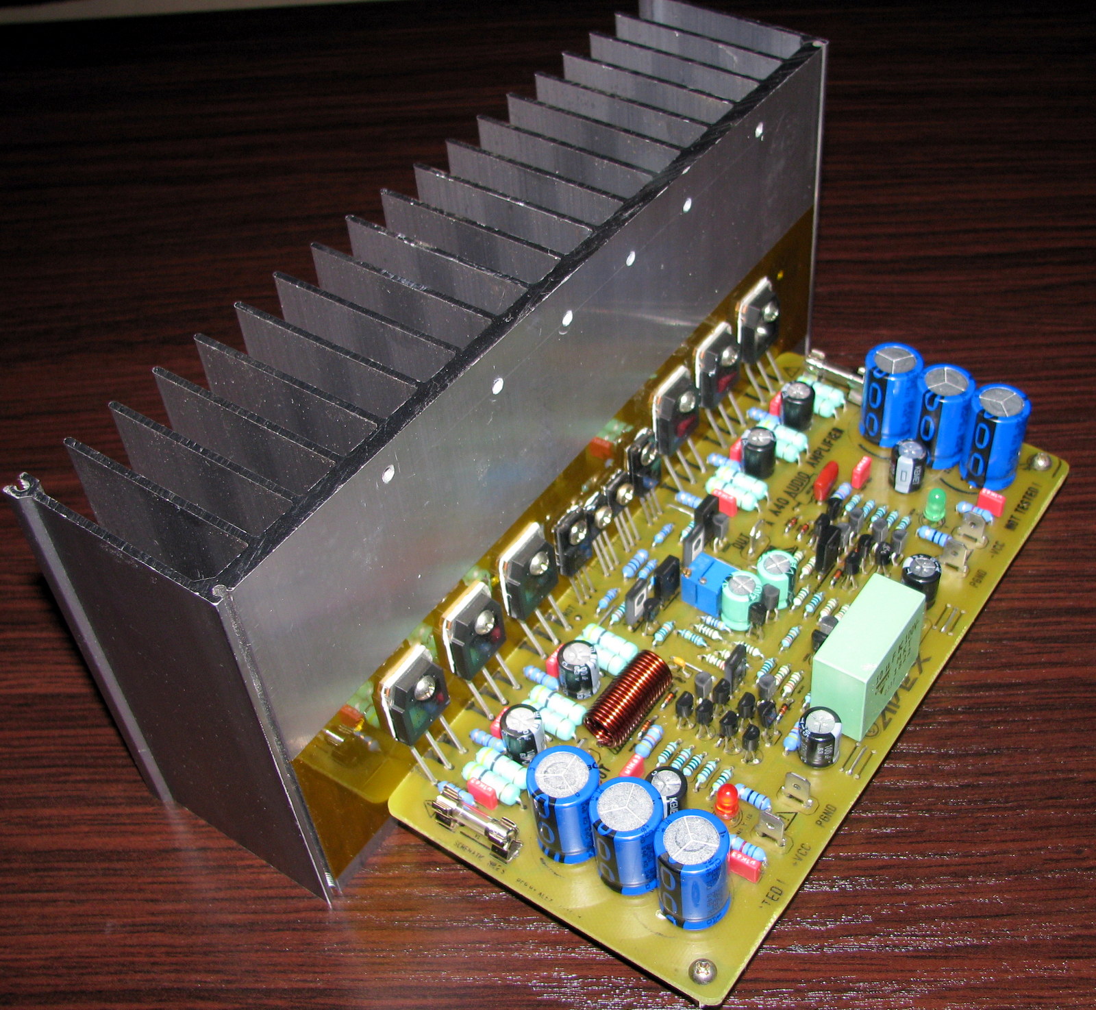

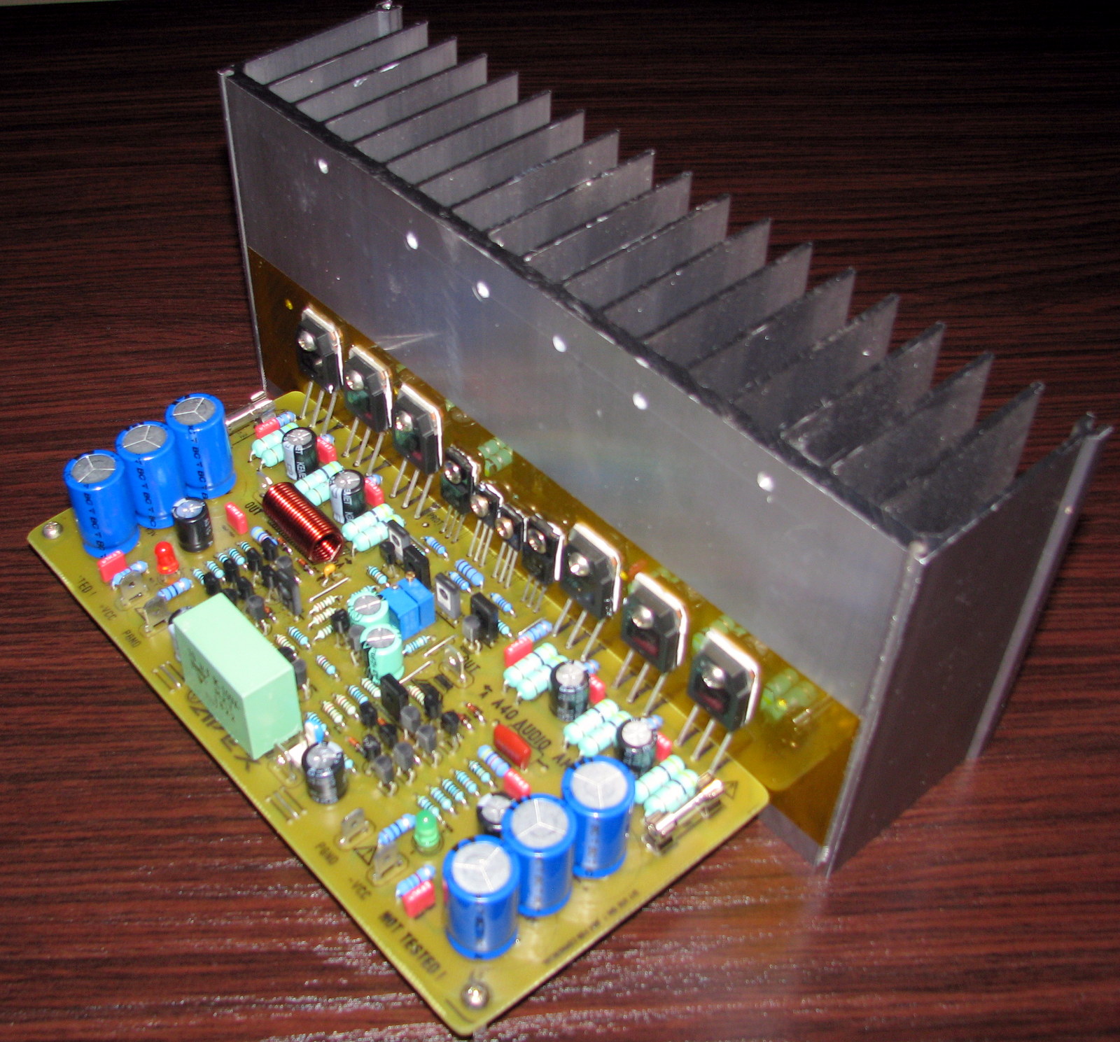

A40 audio amplifier ,one channel in progress ,soon will be tested
Regards,Alex
Nice work, and nice pictures,
Regards

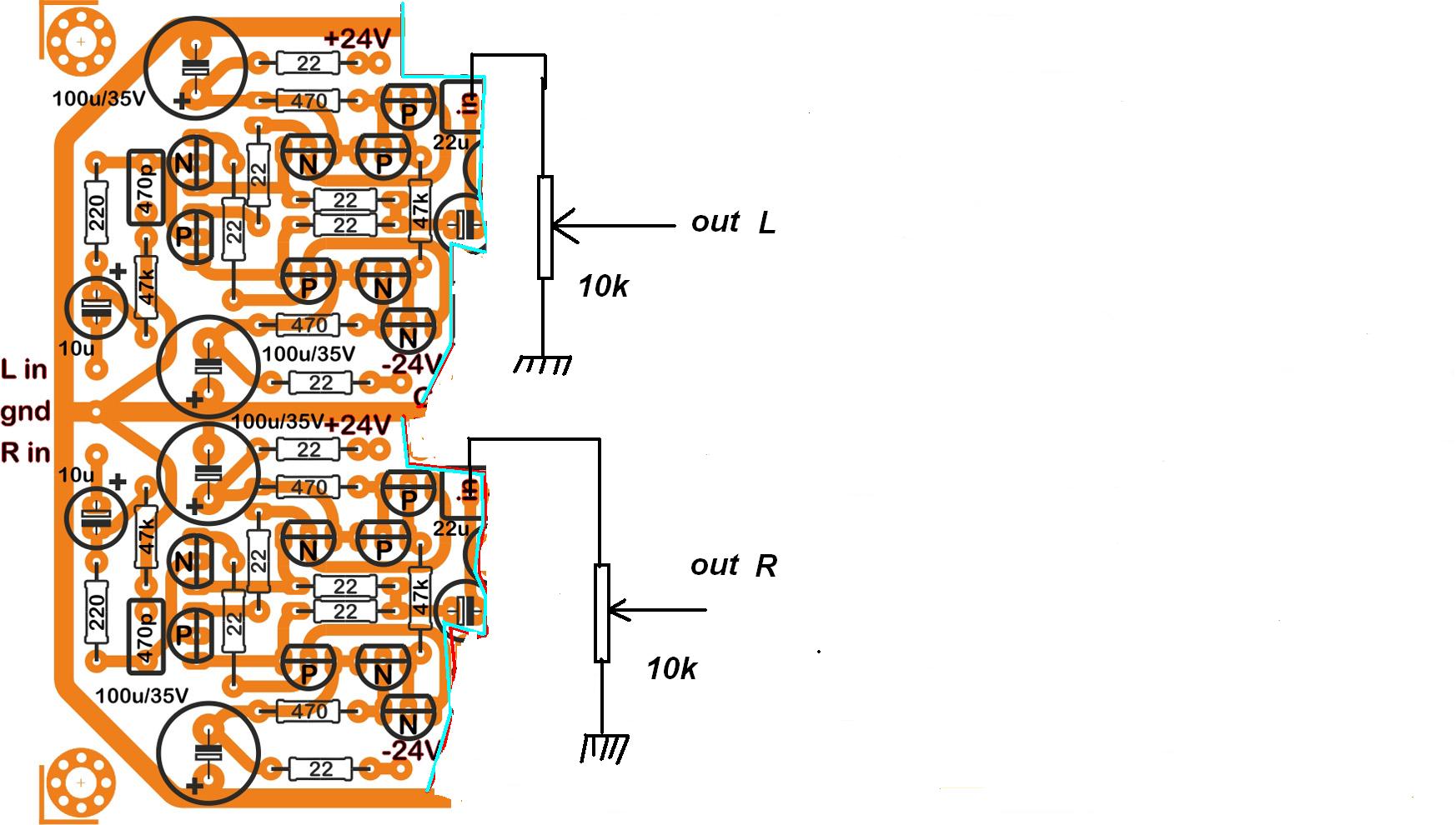

If amp no need gain only buffer can be use.
Is there any pcb for these pream and buffer?CFA Preamplifier

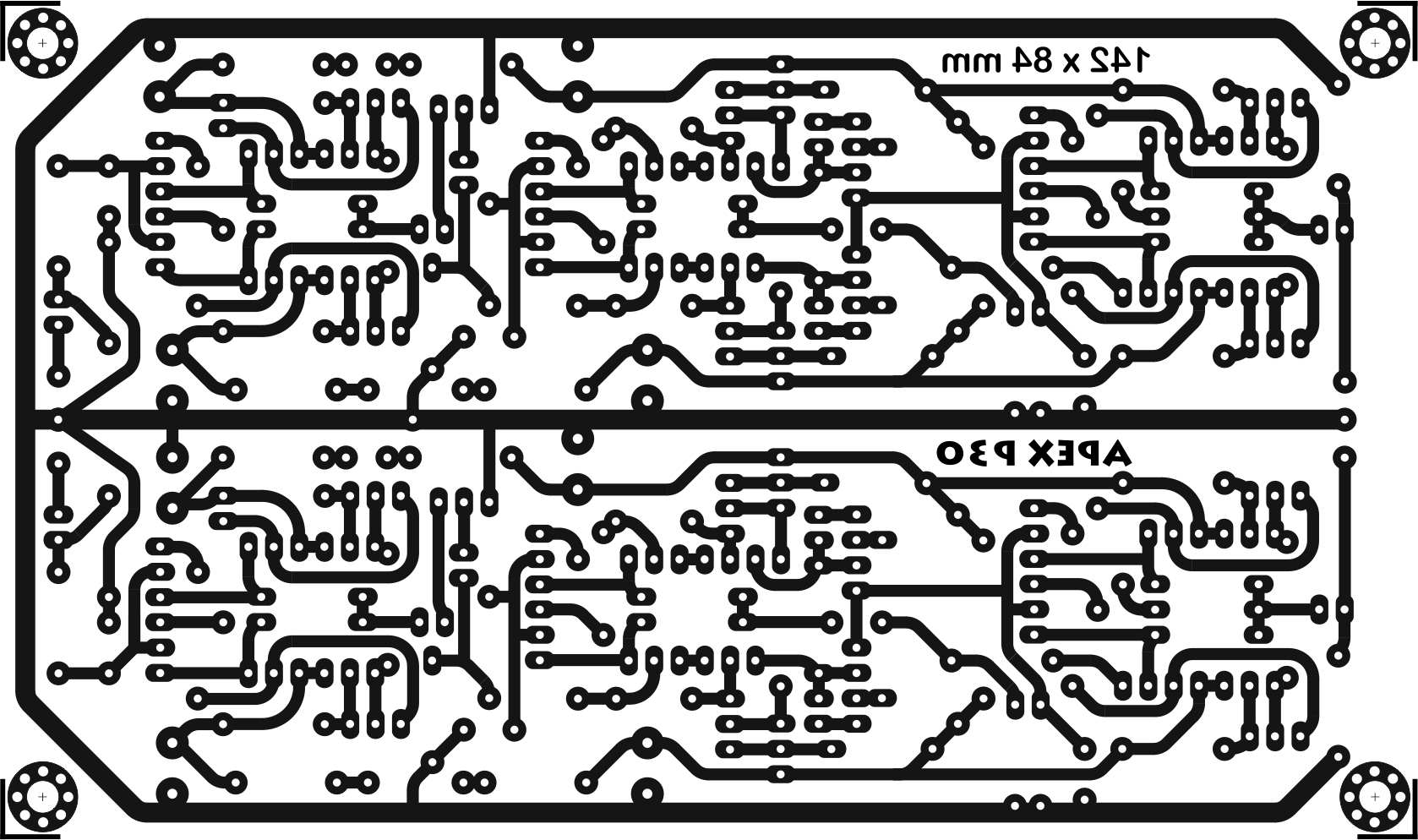

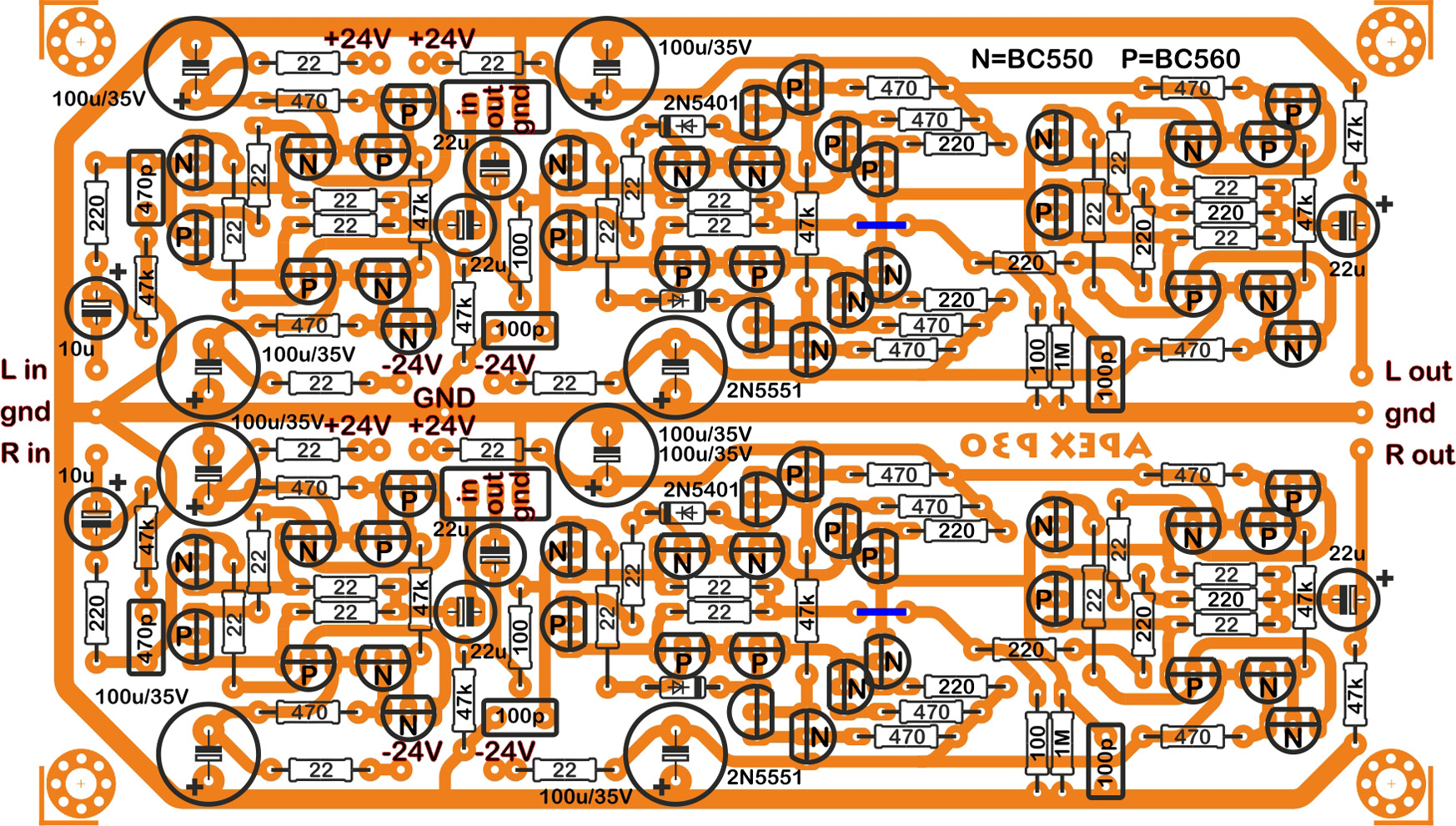

Apex P30 from post #4047. Dim 142 x 84 mm. Not tested.
Very nice pcb, thank you.
Regards

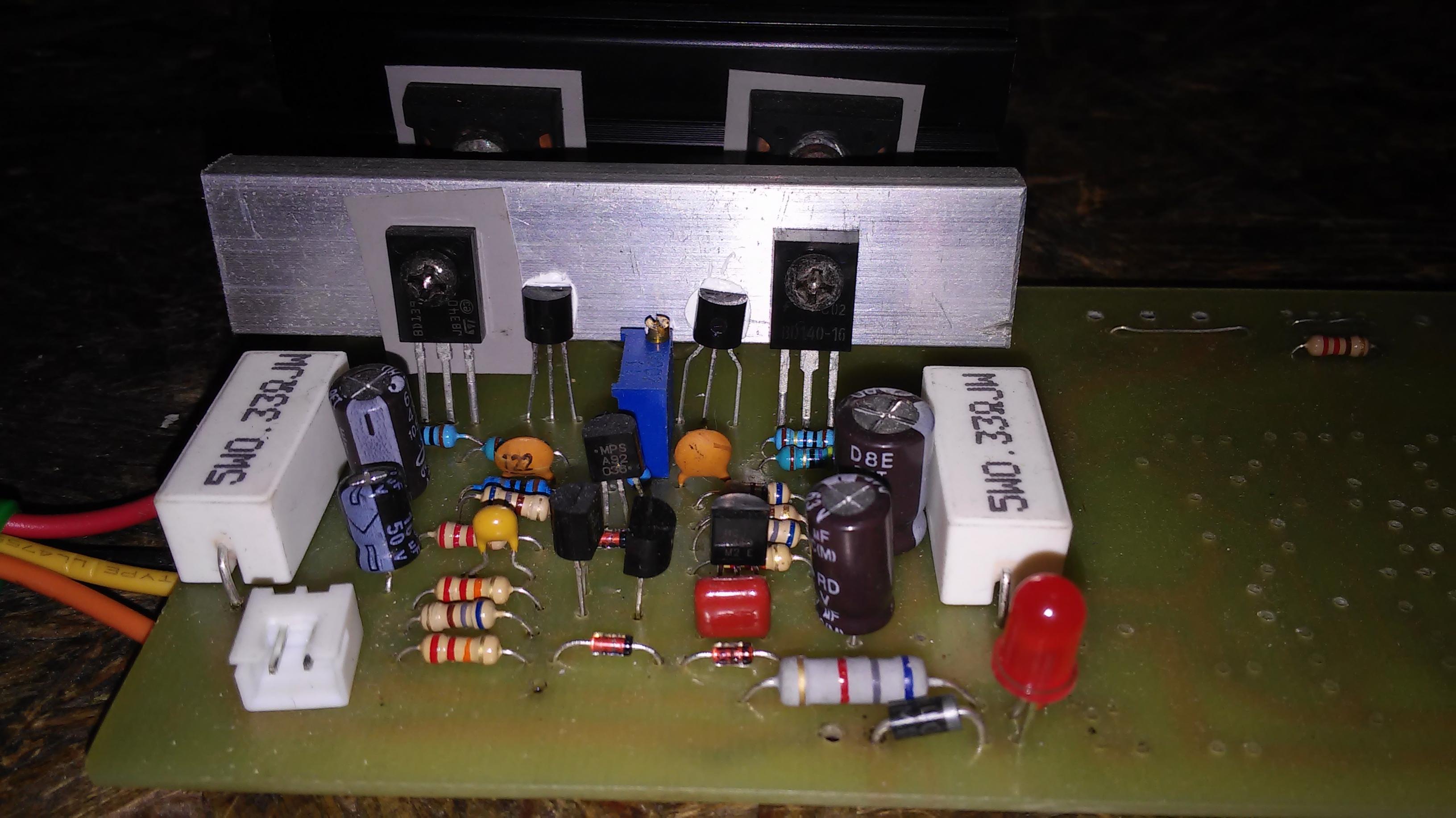

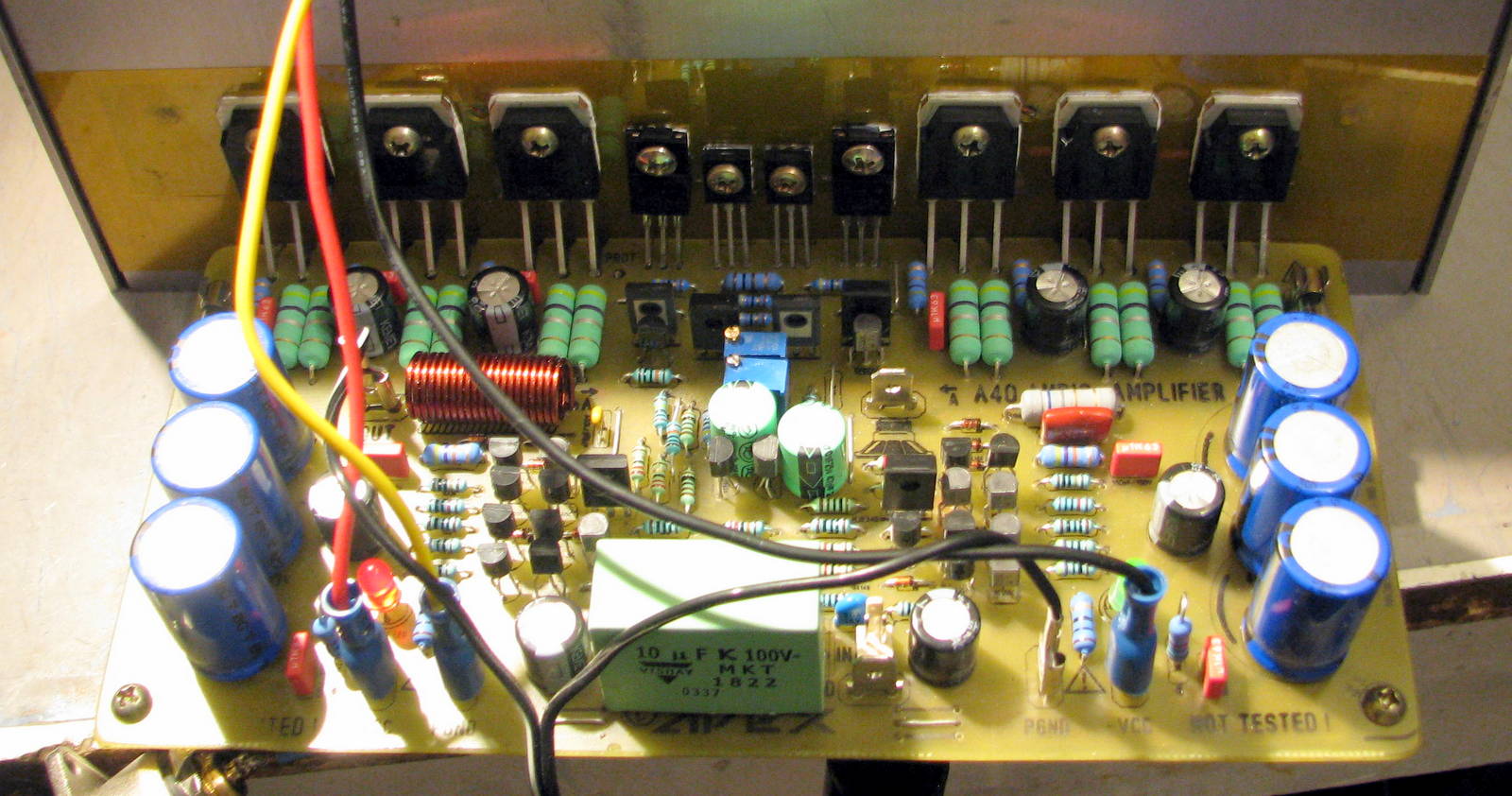

That looks really nice! Can you say a bit more about sound?
Congratulation, very cool!
regards Olaf

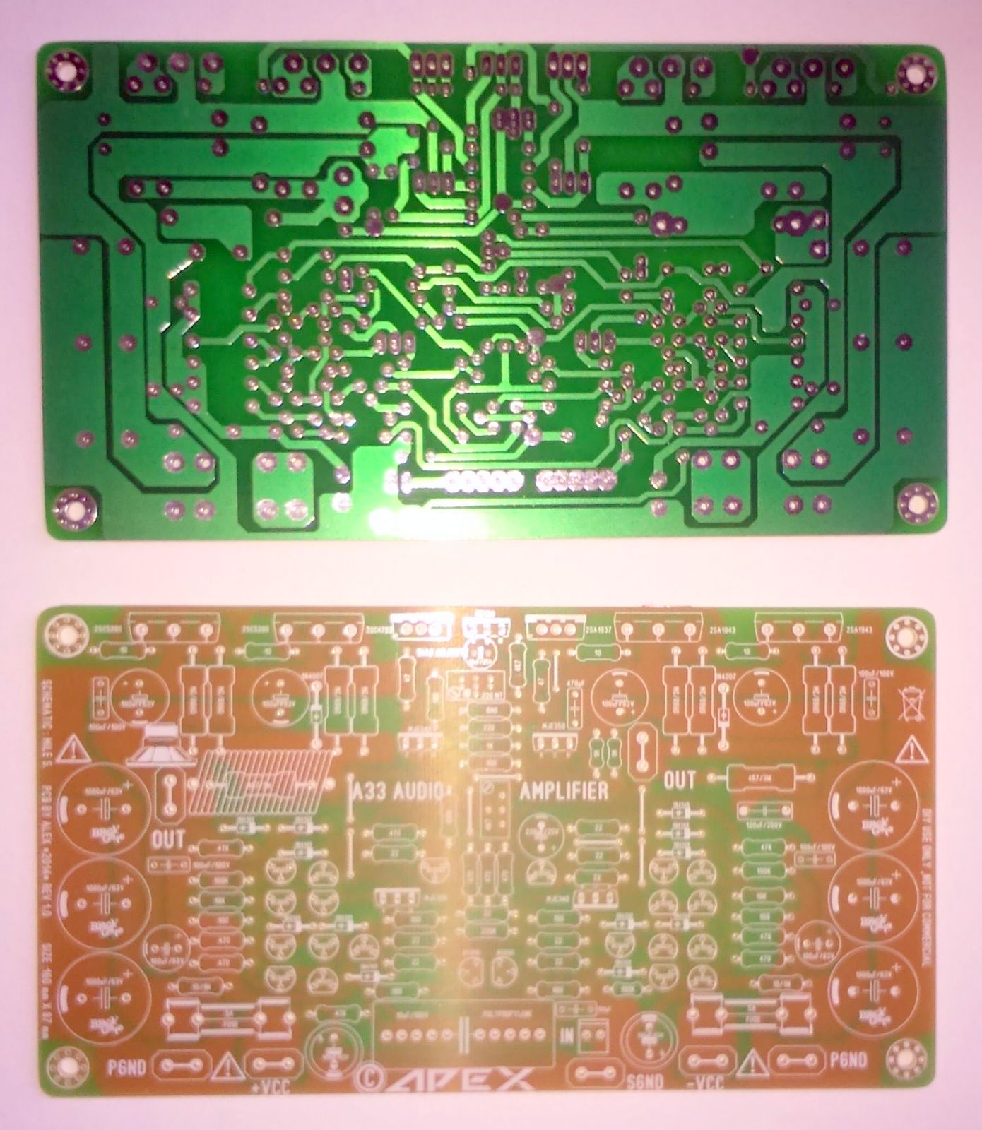

Thank you , sound it's similar to A33 but , more powerful .I will test tomorrow with +/-55V rail voltage,
and factory PCB for A33 .
Regards,Alex
