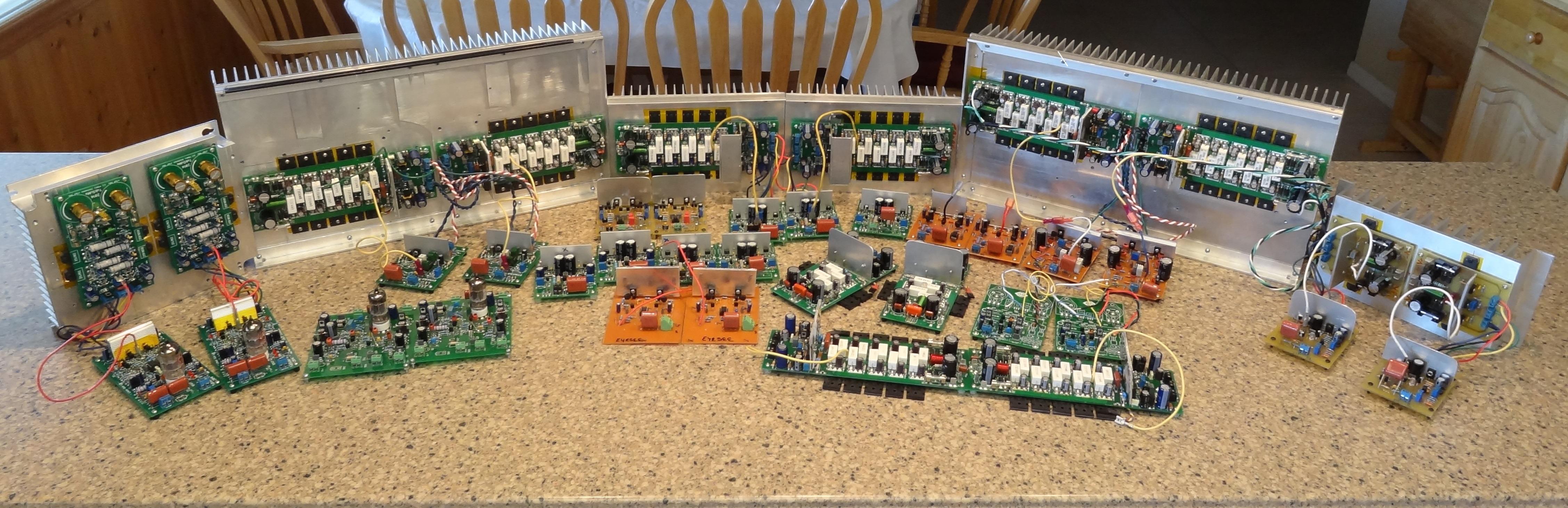

Here is a picture of some of my Slewmaster projects. The heatsinks hold OPS sections that connect to different IPS boards you see sitting on the counter in front of them. Various CFA, VFA and some tube hybrid units as well. The large heatsinks hold a pair of identical 5P OPS so I can do A/B stereo tests with any two IPS topologies.

Hey Terry I envy you 🙂 what a collection !!

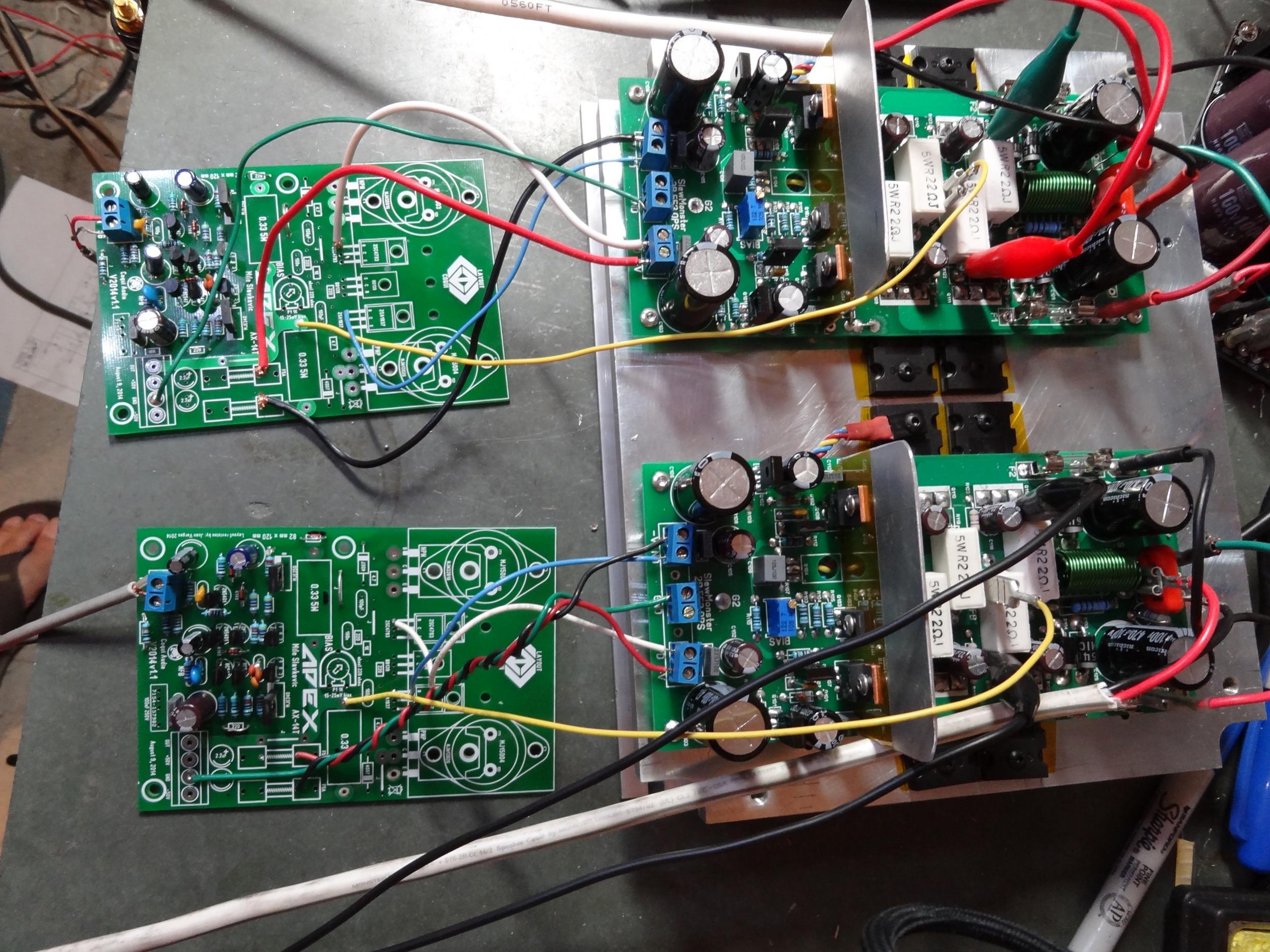

Yeah, I built an AX-14 as an IPS and hooked it up to the Slewmaster OPS. Sounds lovely.
