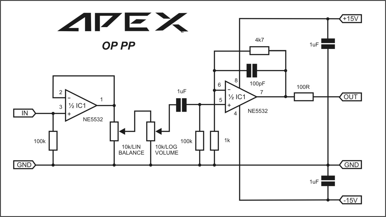

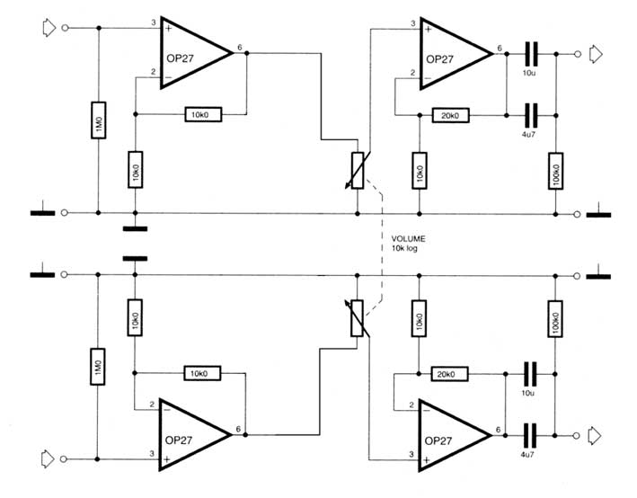

If amp no need gain only buffer can be use.
That can be good idea. And if You use low impedance source (CD player, or same), you can put the volume control 1st, followed by the unity gain buffer. That is nice combination!
Sajti
It sounds great, if You use carefully selected parts. If not, only one OPA2134 will easily outperform it...
Sajti
OP for preamp is not fun
I agree with You. I don't like to use opamps. But I discussed about the sound quality, not the fun. It's very disappointing, if You build a very complicated amplifier, with bad sound quality, because of the bad parts You used...
Sajti
