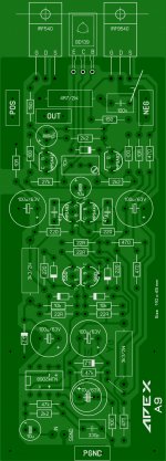

Gain is pretty low. I tried lowering R24 to 50R and that brought up the gain but raised the THD quite a bit. Maybe there is a better way to raise the gain.
😀 It's a trade-off, Terry. Many people do not understand about the effect of feedback. There's debate about the importance of feedback. Those who debate do not understand. If they understand, they will put the right amount of feedback into the circuit. People tried to lower the THD as low as possible, not knowing what they throw away with the bath water.
A preamp doesn't raise the gain, it only raises the input voltage. I don't know yet with the real amp because I haven't found my problem yet but on the spice file, 3vac on input only outputs 45vac on the output. I think that is a gain of 15x. Lower than any amp I've built so far.
This is a tough amp to troubleshoot with 33 transistors. They all measure good with a diode test so I must have a solder bridge somewhere. I'll stay after it. If I can't find it I'll post up a schematic with voltages for some fresh eyes. The good thing is that we know the board will work because Alex has already proven it.

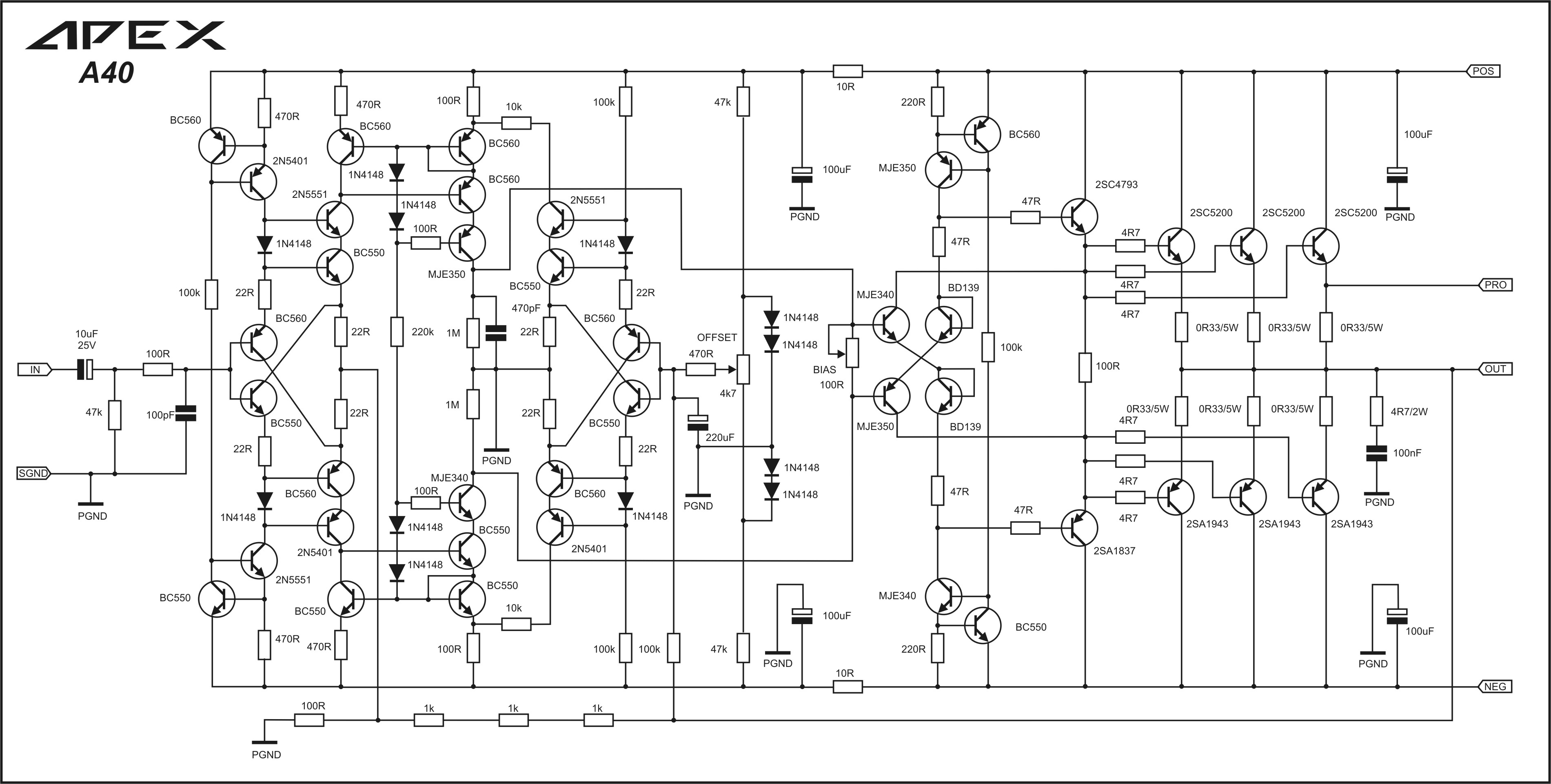

Only 45vac on the output is over 500W/4R. Replace R25, R26 and R27 with 1k instead 470R, gain will increase to 30x.
Regards
A40
CFA amplifier with advance output stage.
Regards

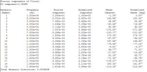

Yes, I understand it is a lot of power but 3v input is higher than most preamps will output. I changed the three 470R to 1K each and as you said I see 30vac with a 1V input.
I'm attaching the error report from Ltspice.
Blessings, Terry

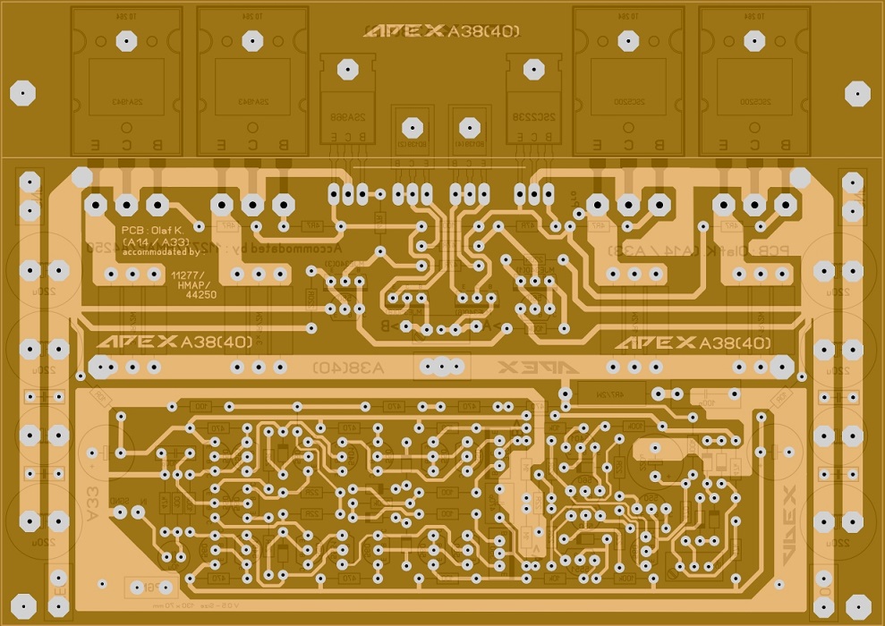

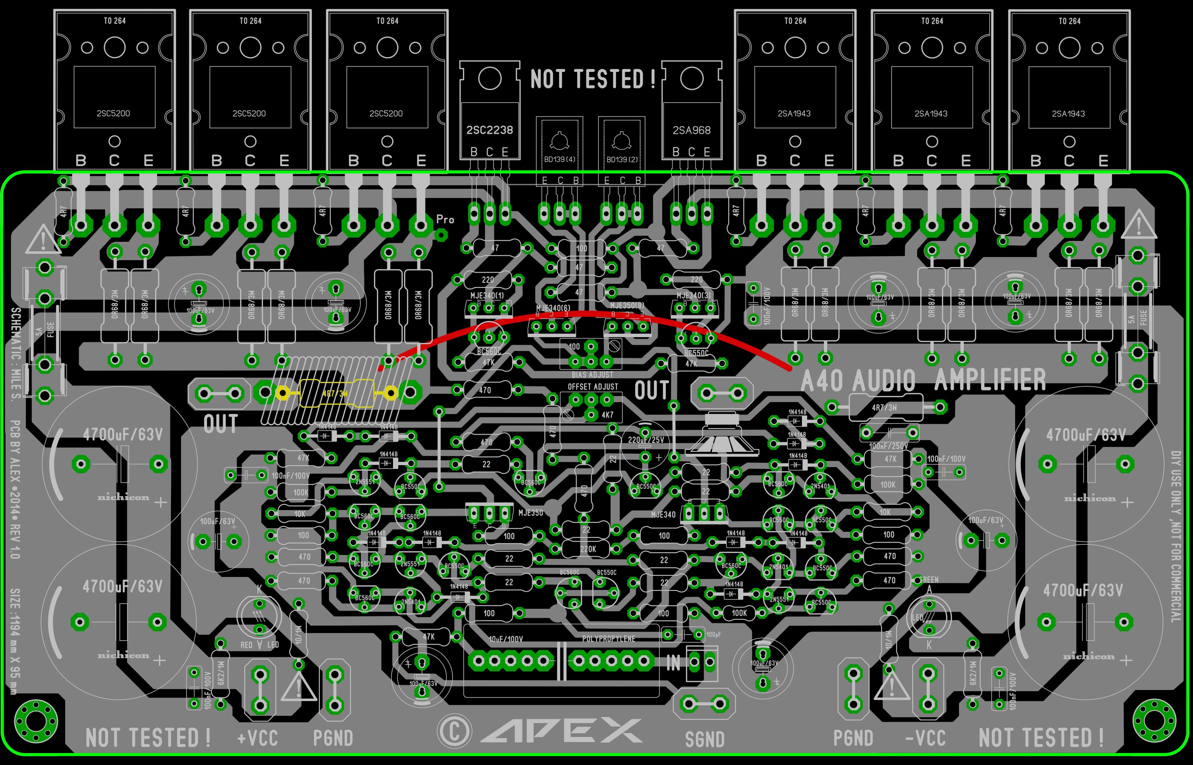

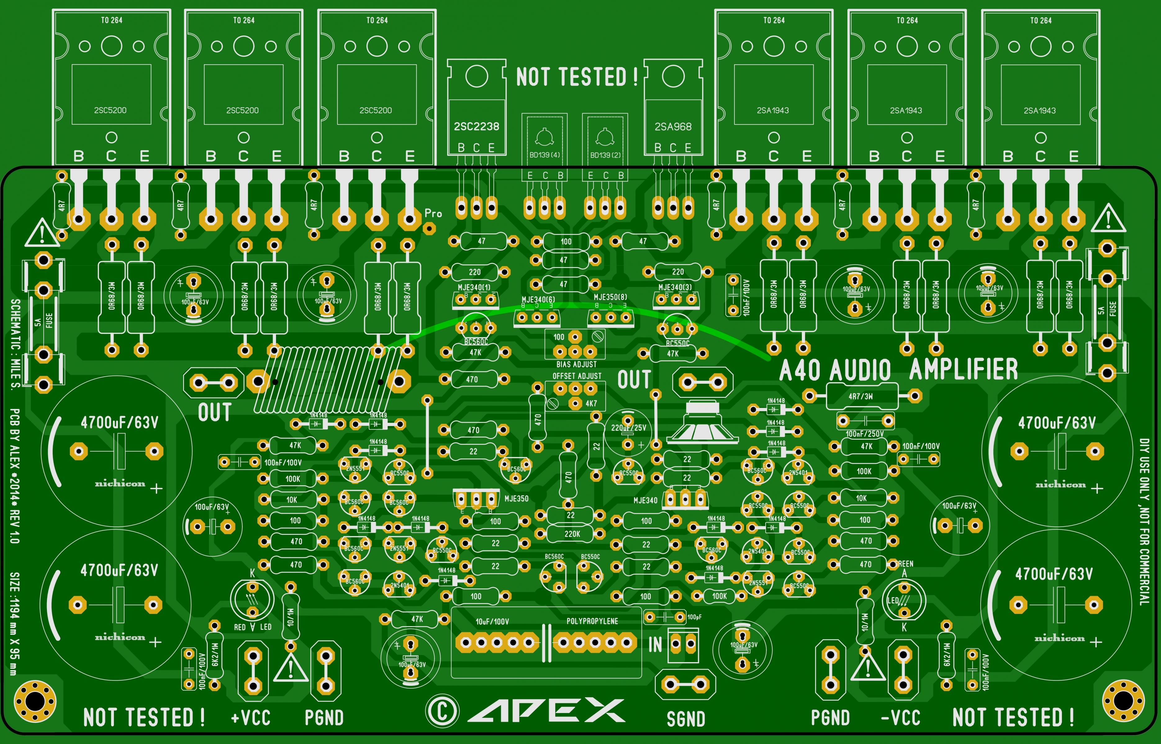

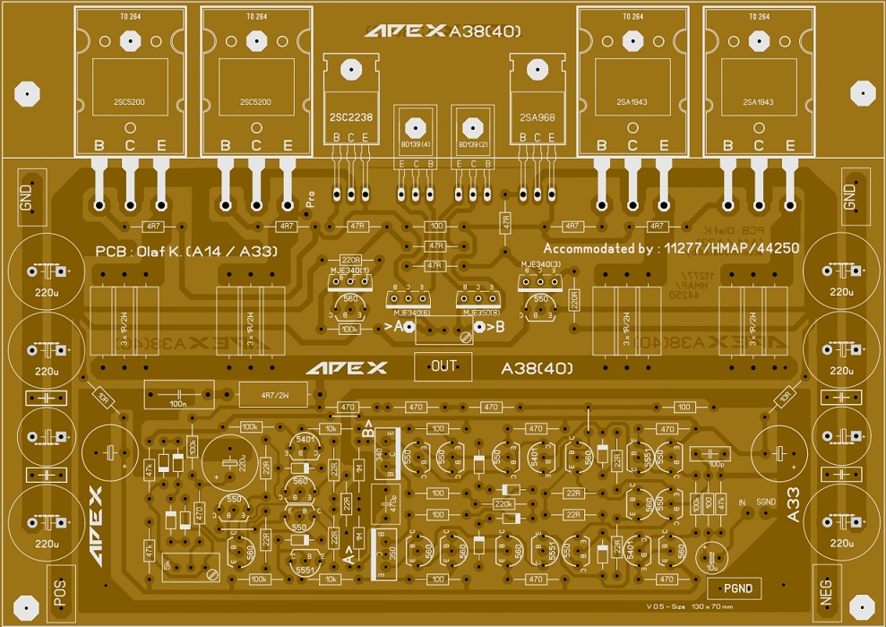

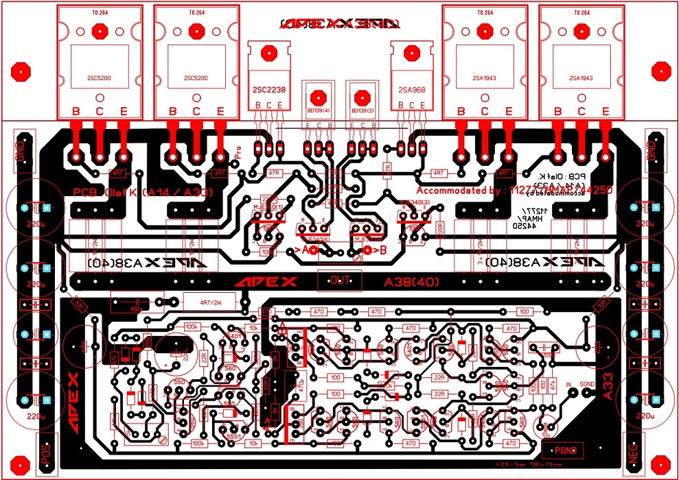

reduced by two transistors and now it is A38 - used Olaf´s files from earlier done A14 and A33 - so it has all rights to be called Olaf´s and accommodated by me:
(!!!IT MUST BE CHECKED!!!)
  • A40.zip
    A40.zip
Hi Olaf,
Can you Please post the foils for this.i would like to make a pair.
Thank you.
Rick.
Hi, here are all the necessary files (zip includes the Sprint-File).
Regards Olaf
