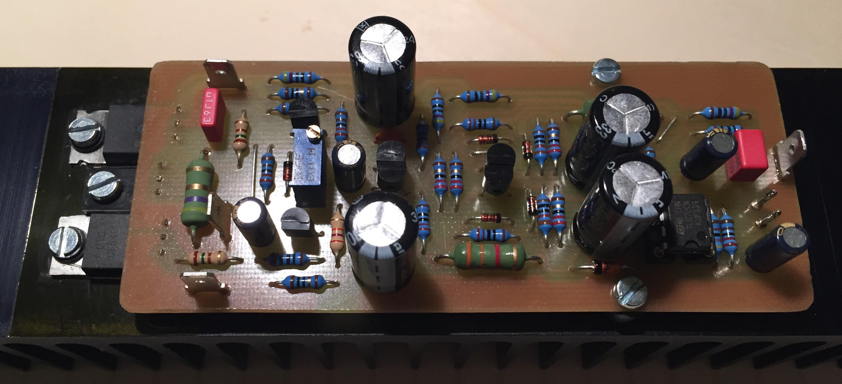

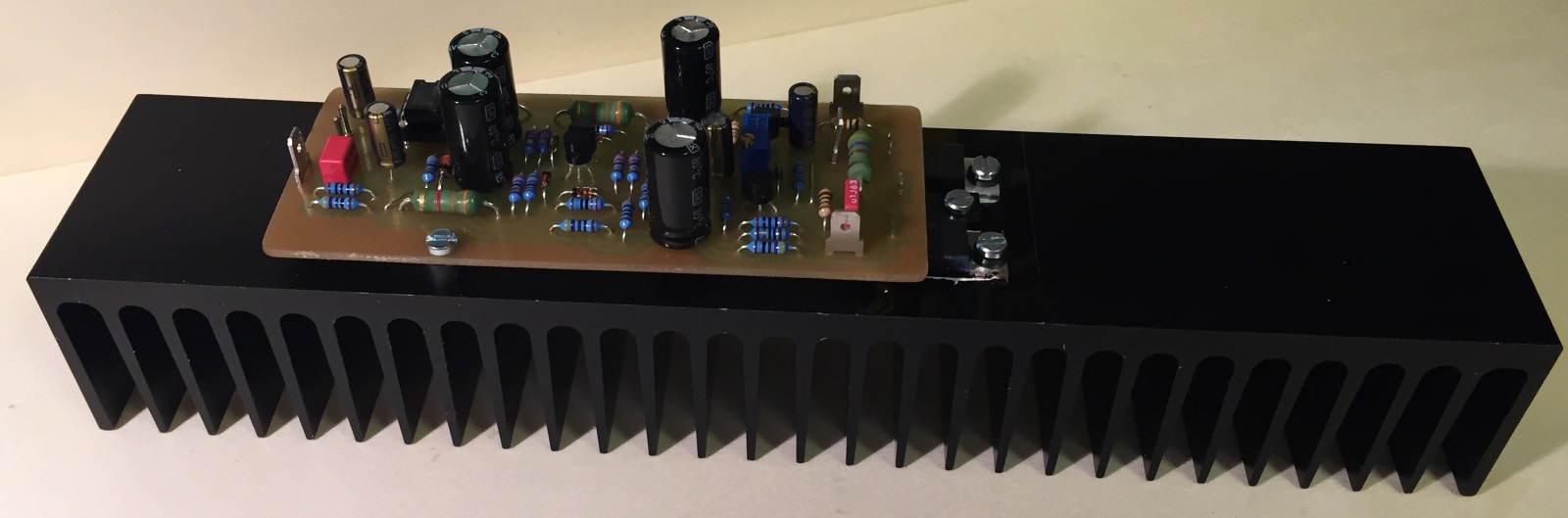

Hi, I started with the modules for my A9-Amplifier. Because of the ease installation I have changed the layout, so that a BD139 can be mounted on the heatsink. If anyone needs the layout, I can post it.
I have tested with + -36V DC. The BC and first MPSA be quite warm.
Mile, at which max. voltage the A9 can be save operated?
regards Olaf

Nice work, +/-36V is safe, +/-40V is maximum rail voltage
Regards
Thank you.Nice work, +/-36V is safe, +/-40V is maximum rail voltage
Regards
regards Olaf

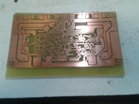

Nice pcb,
Regards

Nice pcb,
Regards

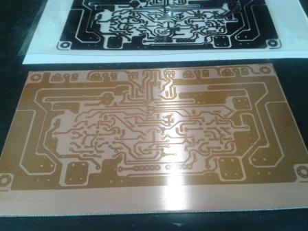

Thanks Mr Mile and here some more !!
Nice progress
