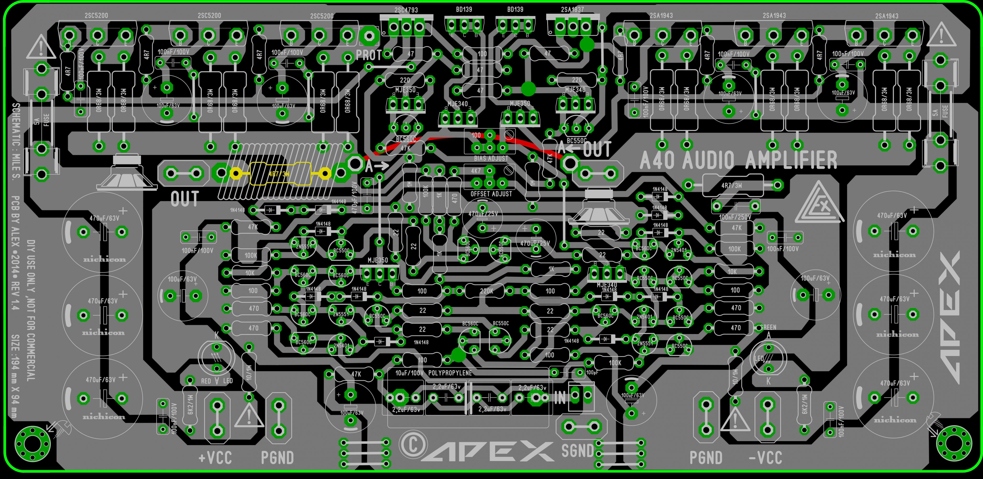

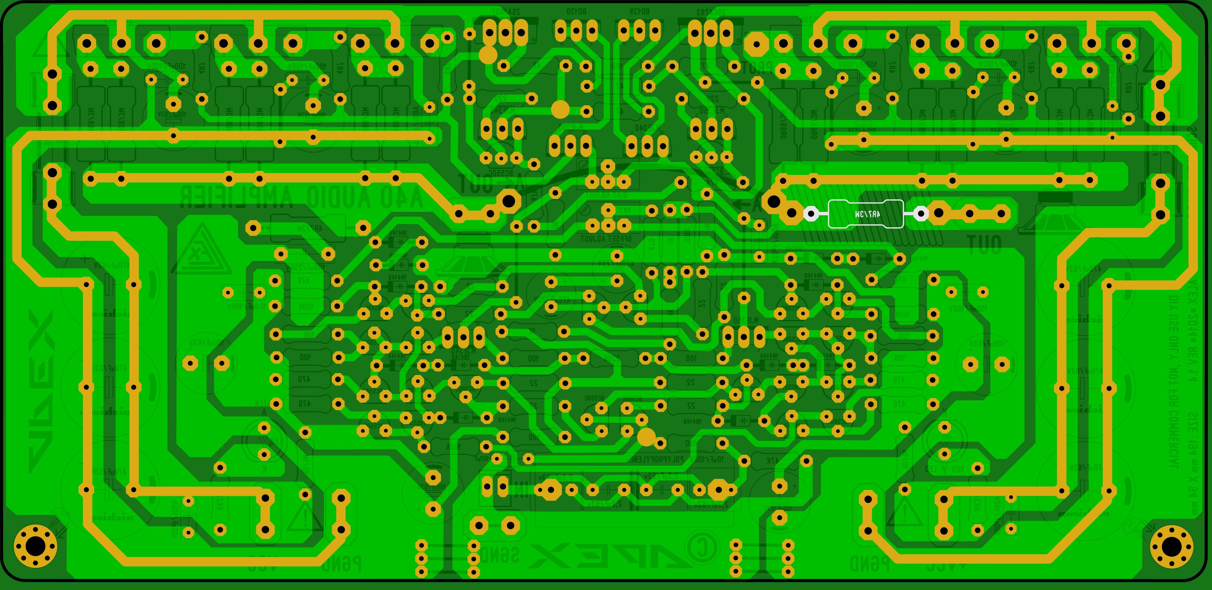

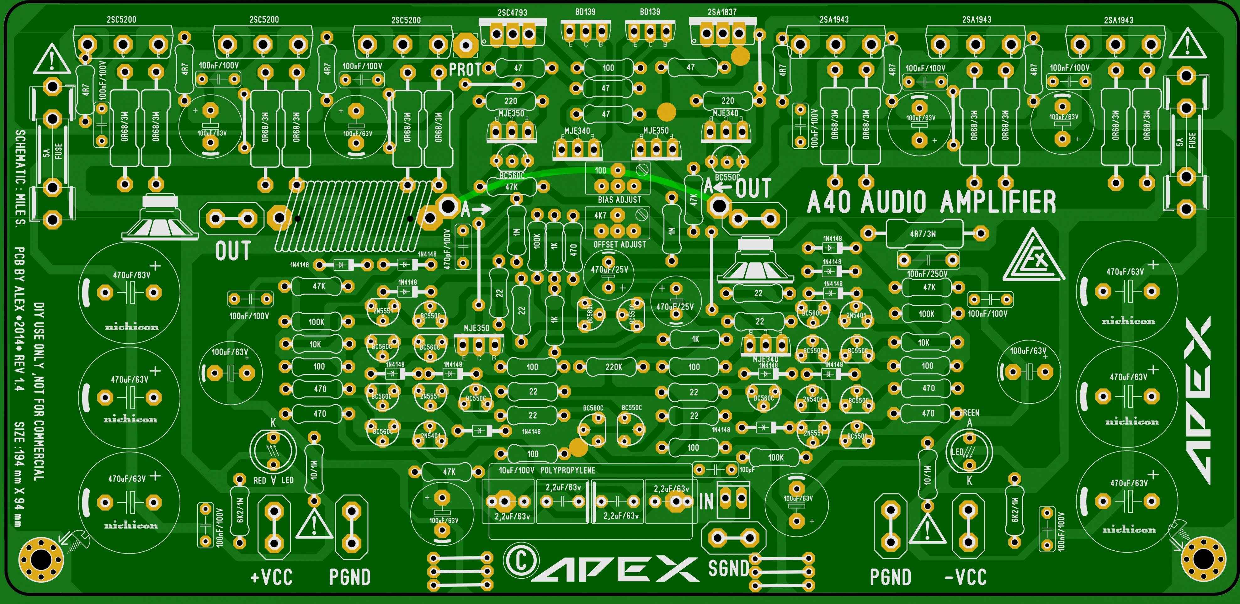

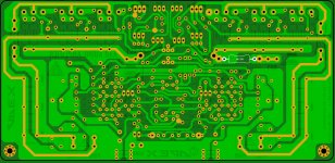

A40 pcb files attachedNow it is a tested pcb!
Please share this in pdf for home etching
Regards,Alex
Apex A40
All in one.
Thanks Alex!
Thanks Mr.Mile!
All in one.
Thanks Alex!
Thanks Mr.Mile!

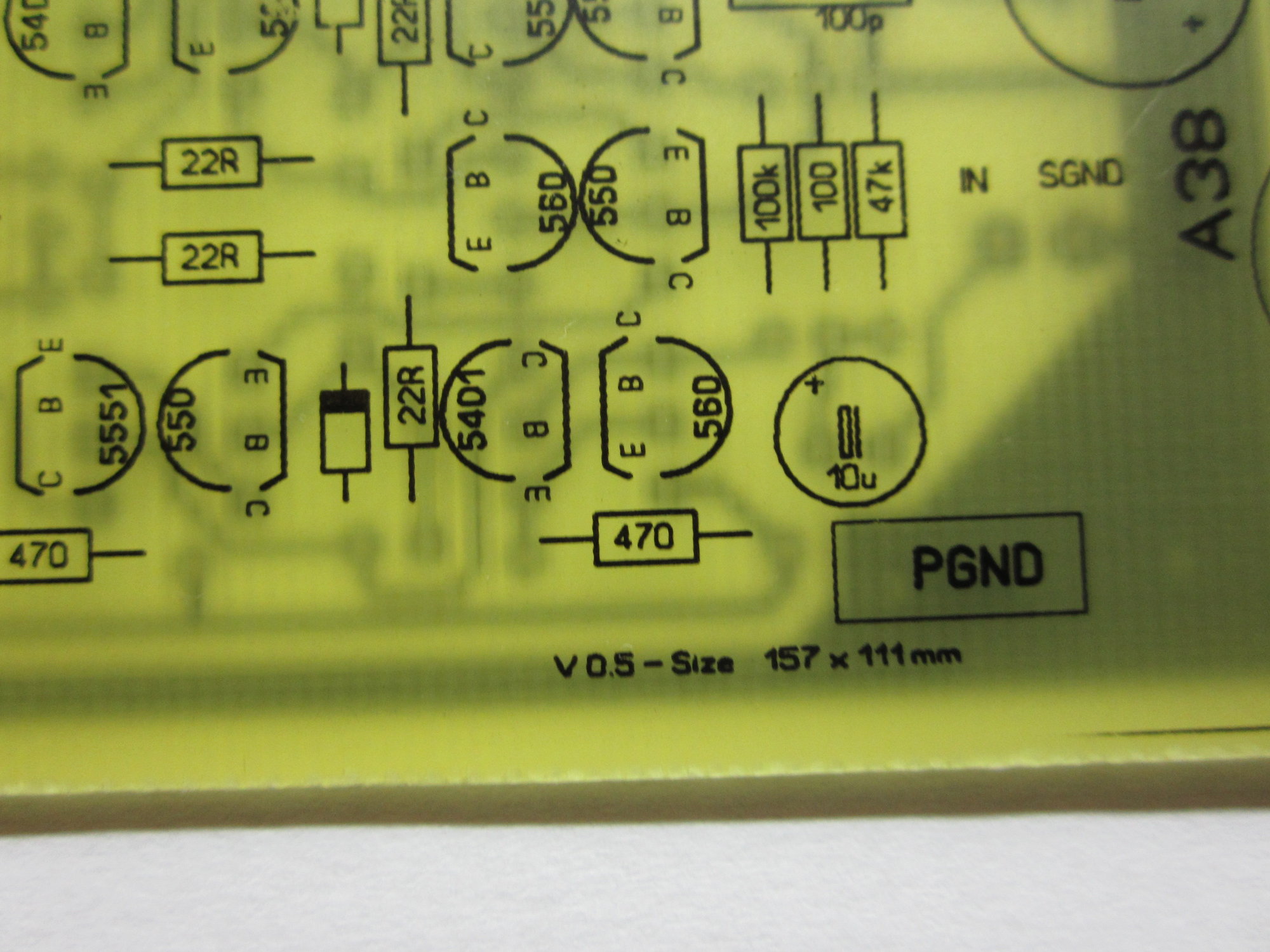

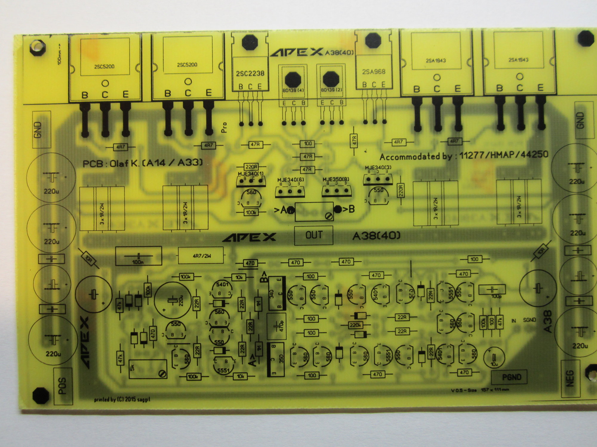

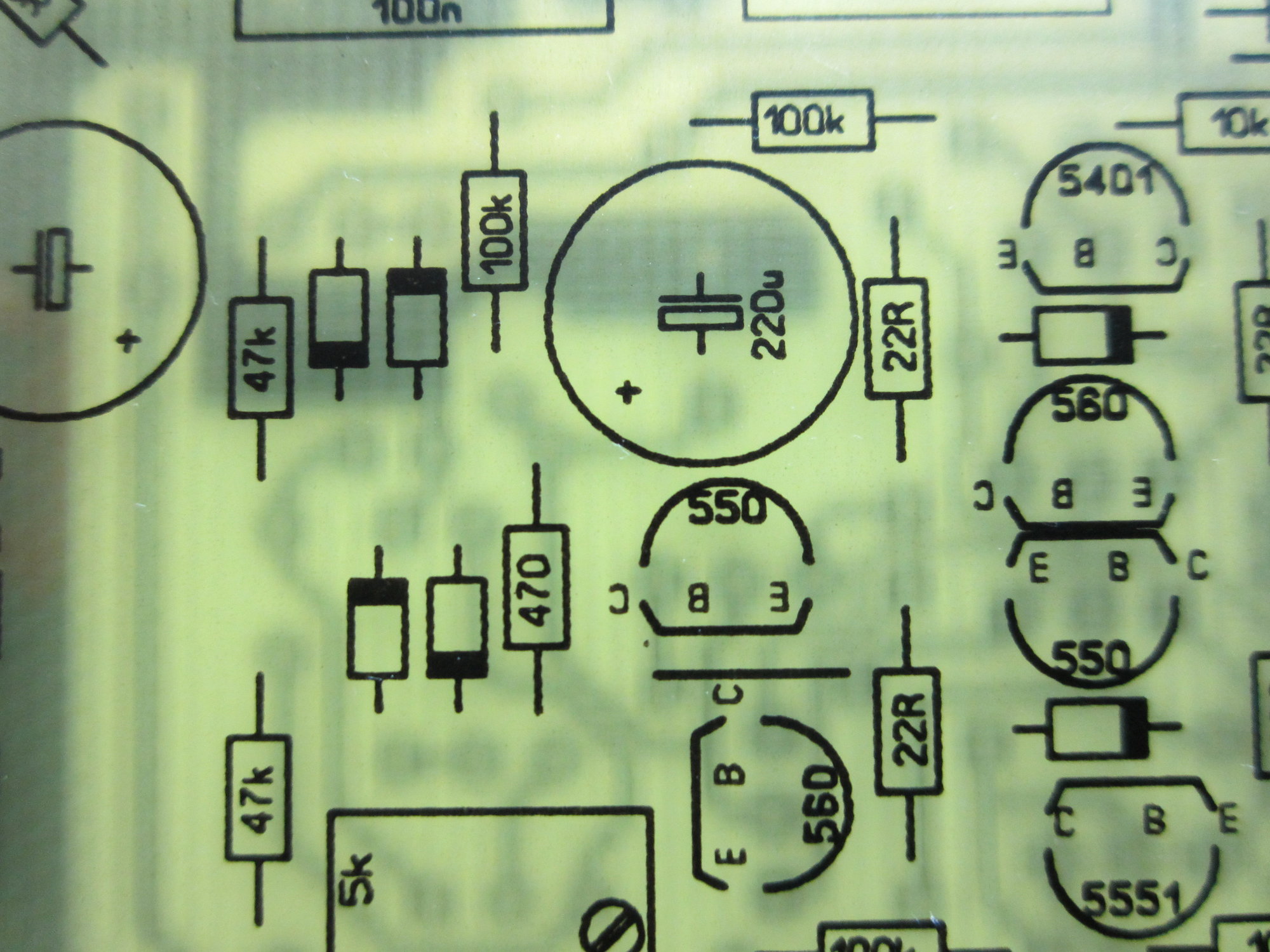

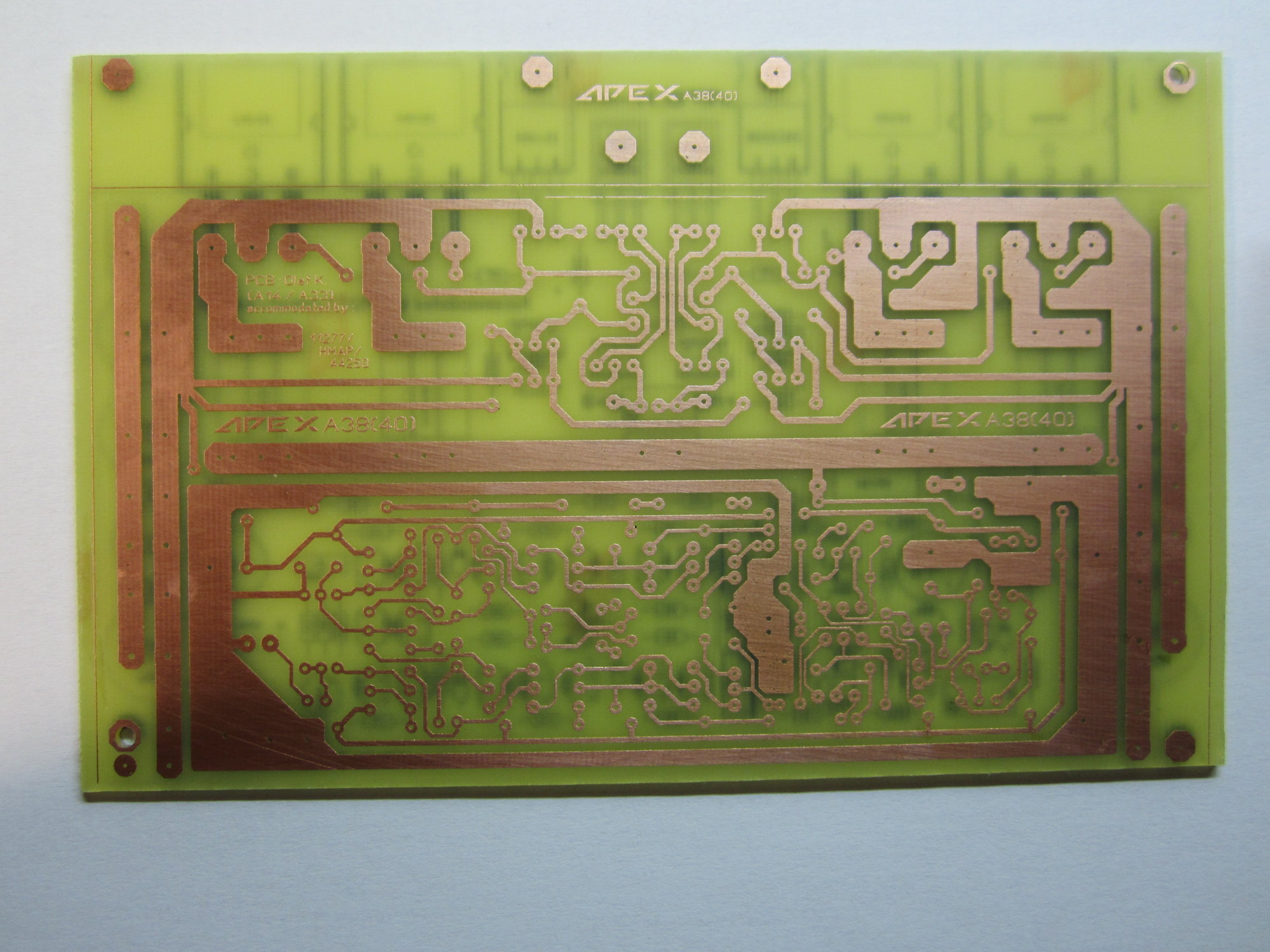

one friend has done A40(38) pcb´s for me - and now i must do it!
(Olaf,thanks again for 99% of pcb-work!)

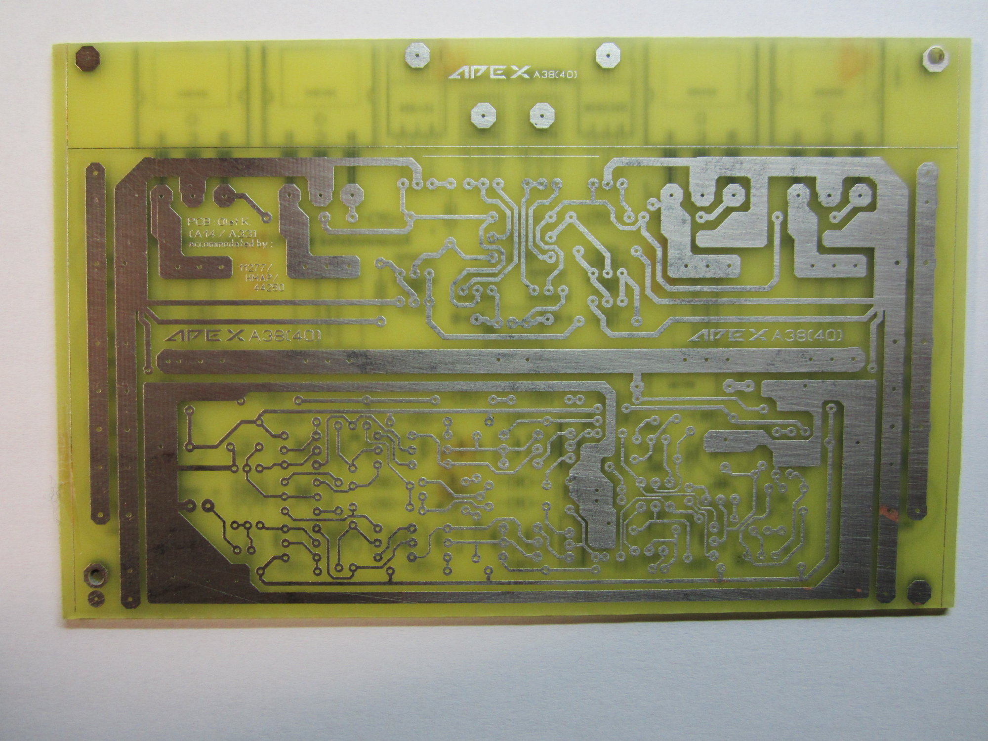

May I ask what you use to tin the copper?
Soft solder paste No. 30 - 0987130
or similar (sorry if this is a comercial but i don´t know how else to describe this product)
it is used for soft soldering of copper tubes. a friend showed me today,it is really easy : use brush to apply paste in about 1mm layer over whole copper side of pcb,than use heat gun // pistol grip hot air gun and heat the paste to about 300°C - if it starts to bubble that is a sign that temperature is too hot. you will see how the surface of paste is getting smoother,apply heat to about one minute (depending on how big is pcb) and than rinse in watter. it takes a try or two to get it right but you have seen the result - it looks great and it is really really easy to do!
i will do a YouTube video as soon as possible to show how it is done - one picture as thousand words,one video as thousand pictures...
