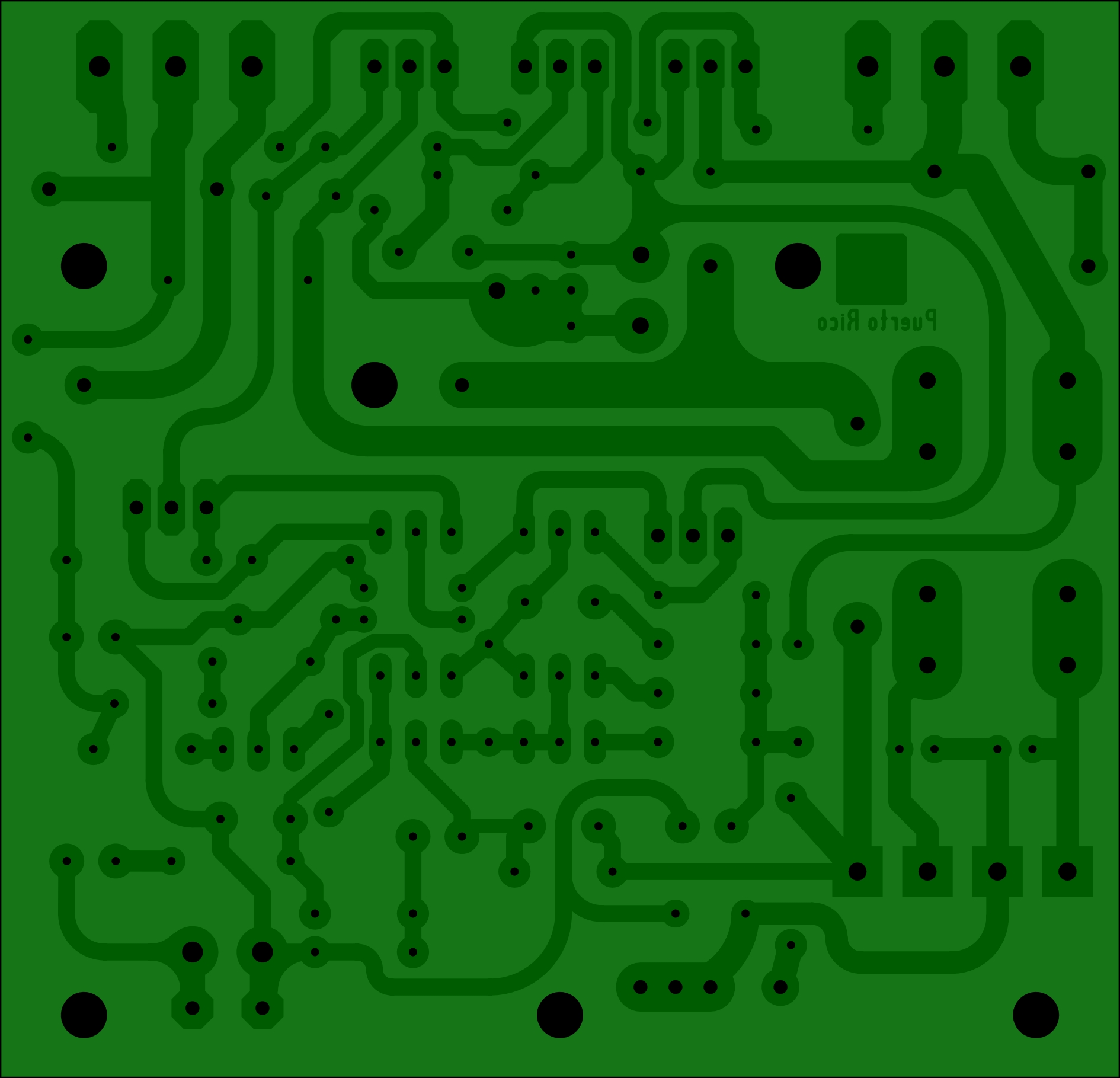

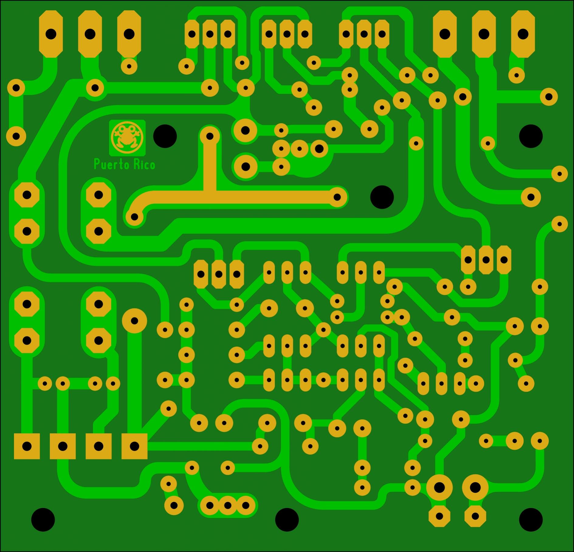

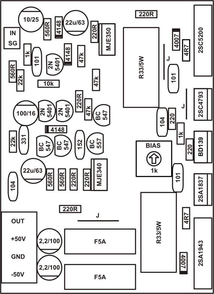

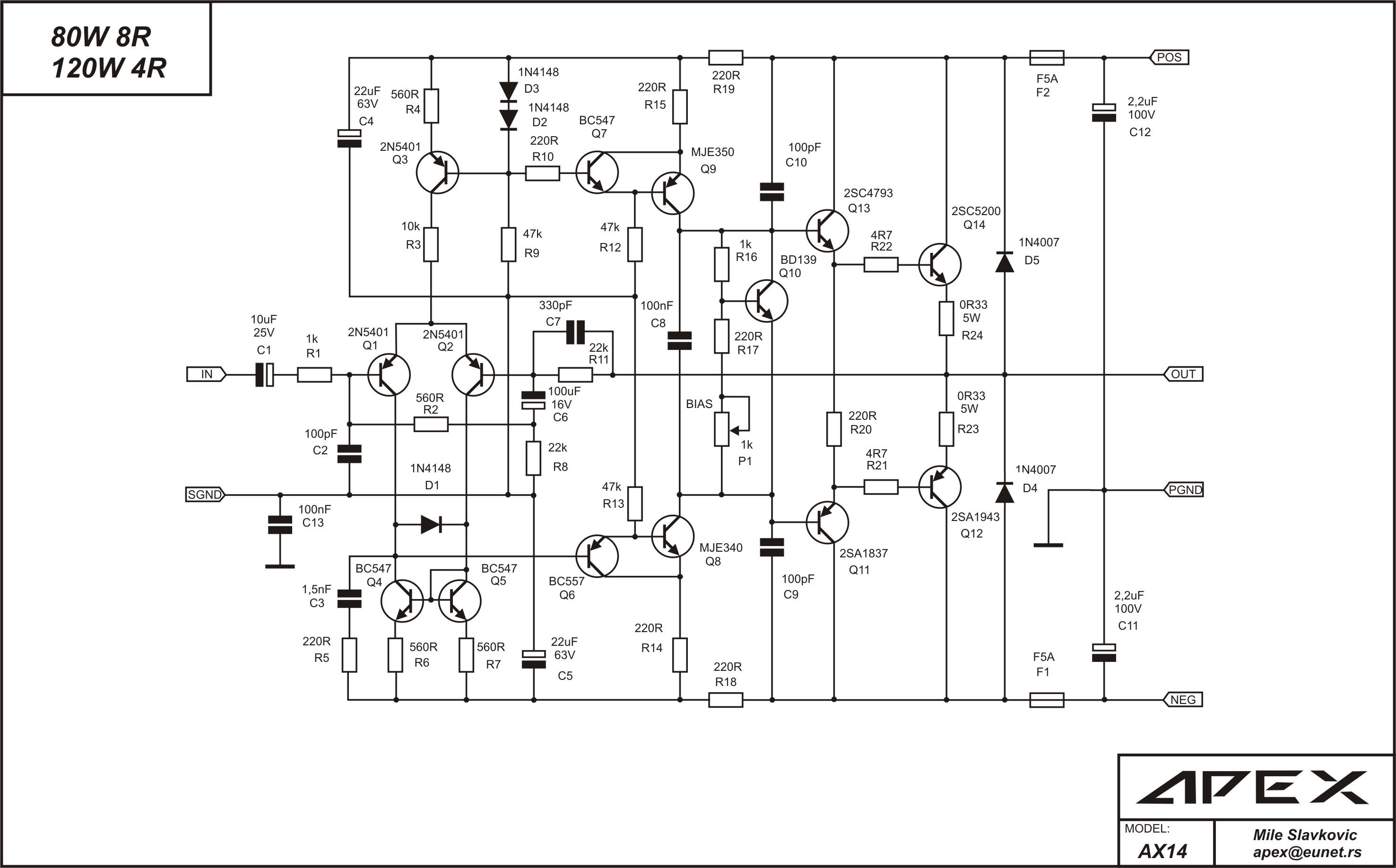

Hi
I have assembled one channel and tested it with a center-tapped transformer rectified to DC at approximately +32V/0V/-32V
Both 5 amps fuses blows the second I power it up. What could be the problem? I've attached a couple of pictues of my PCB.
i can't see heatsink.... you tried this without heatsink?
Was the idle current accordingly adjusted
Put resistors 10-20R instead of fuses .
put a lamp (normal lamp 100w)in series with transformers primary side.ATTENTION HIGH VOLTAGE. DANGER
This lamp must glow when amplifier switched on and go dark after a little.
If this continue glow there is a problem somewhere.
Measure voltage on resistors(instead of fuses ,you must expect a low voltage here(300mV)or something UNDER NORMAL CONTITIONS.
If you find a high voltage here 3....5V or higher you must expect problems and you must check for faults.
It's posible now you have some burned out transistors.
You must check these and replace if these are faults

Wrong polarity diode in negative rail.
Don't forget to connect input ground to psu ground.
I did connect the signal ground to PSU ground when I tested, so that should be OK - I will try reversing the polarity of the 1N4007 diode near te 2SA1943.

I tested this with a a couple of fans blowing right at the power transistors - I thought that should be enough only for a few minutes when testing - am I wrong?
I will try the light-bulb method with resistors instead of the fuses, and measure the voltages over them.
Thanks alot both of you! I will get back to you as soon as I have tried it! 🙂
Corrected schematic/component layout
Ok that's is good!
Post the exactly shematic and pcb used.
Roger that.
Please note that I take no credit whatsoever for the posted schematic/component layout. apexaudio is the author and it his his hard work - the only thing I did was reversing the polarity of the aforementioned 1N4007.
The PCB used is just the original 🙂

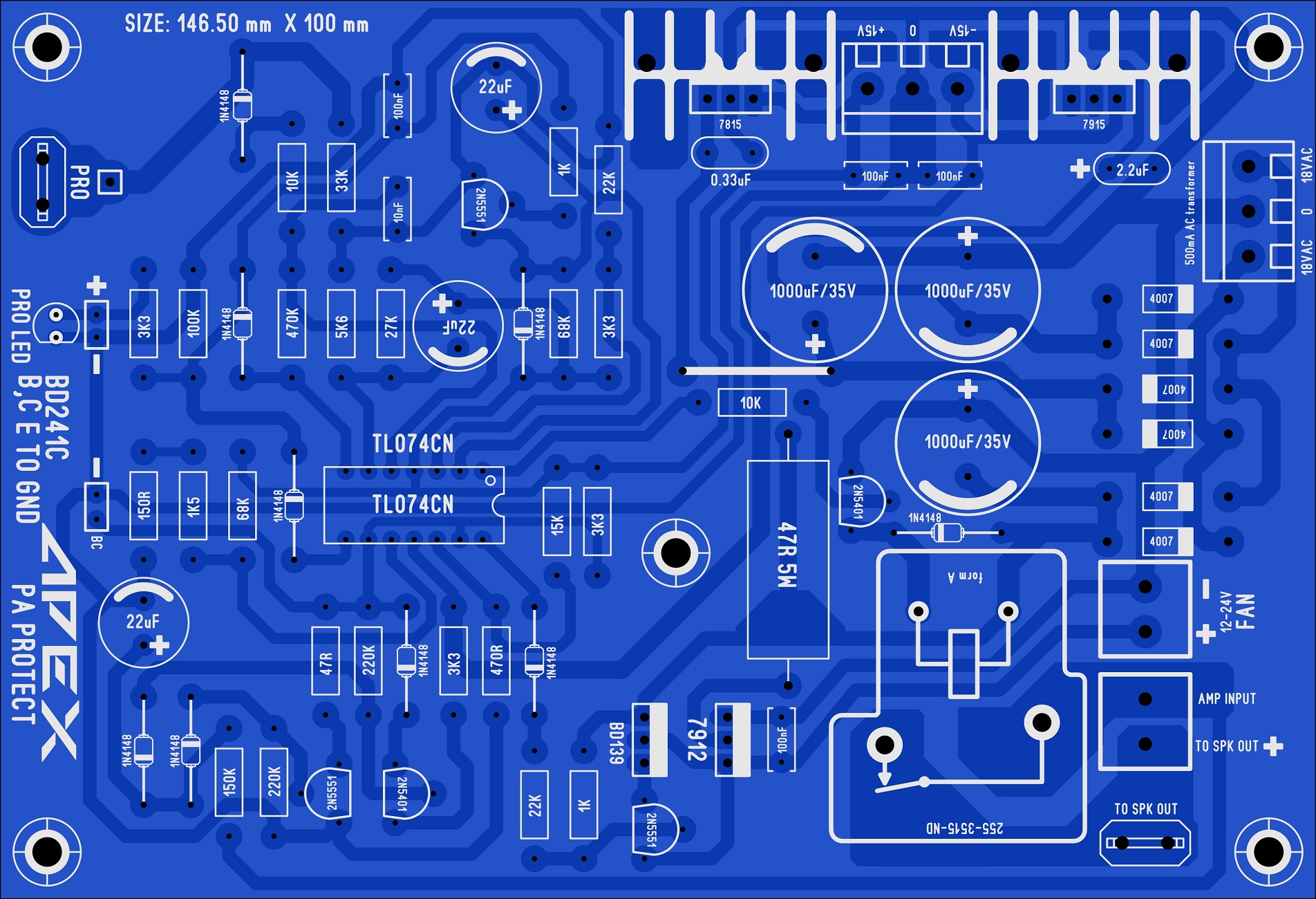

Is normal man, sometimes we don't see errors till we check many times, I keep working with layout and sometimes I made small mistakes it happens that is why I like it and it keep my mind occupied and learning more every day here is an example, I did this layout a few months ago and I still checking for erratas ones I see is all good then I saved it for later. 😉
Juan

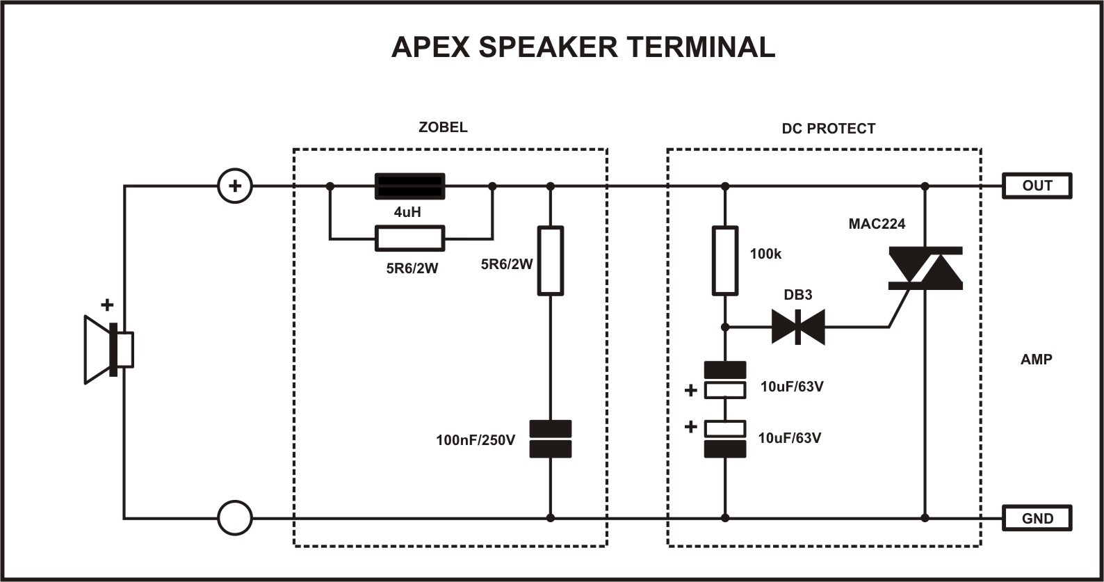

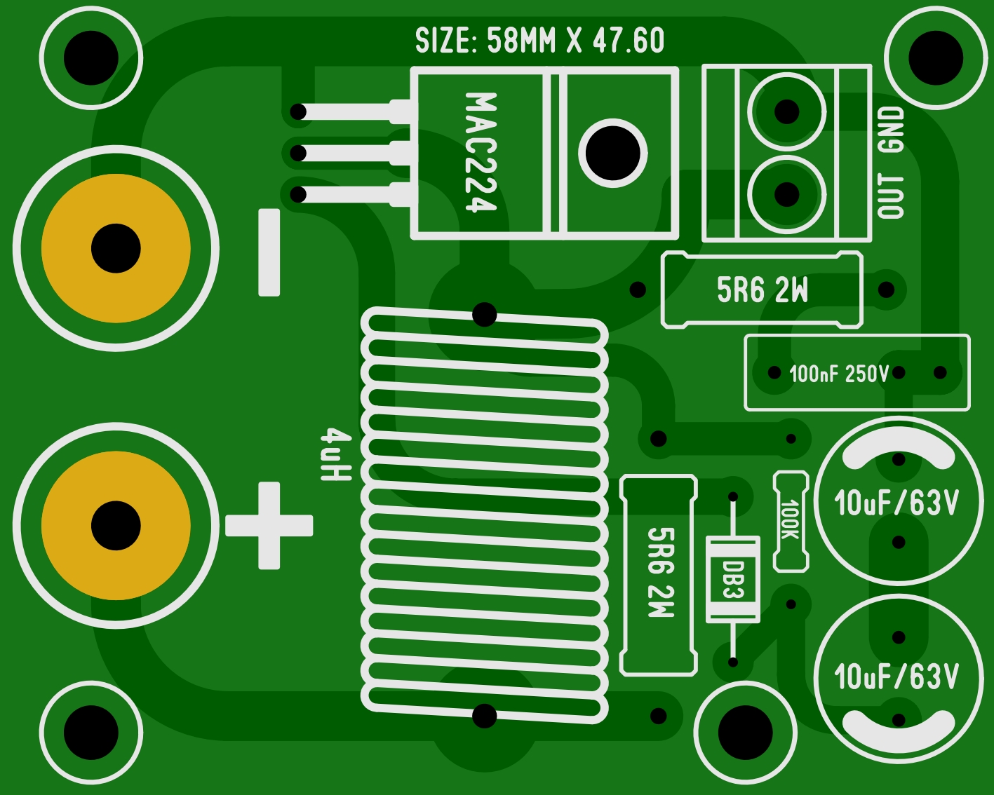

Hello guys 😀
I'm organizing my future projects and I was coping the protect layout with the triac
quick question ...🙂

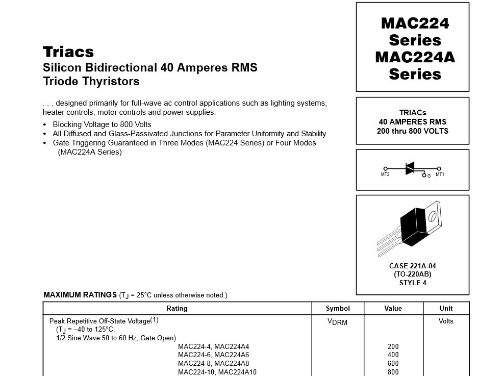

what voltage triac is use on this circuit ? 😕 options are:
200V to 800V
Regards
Juan
