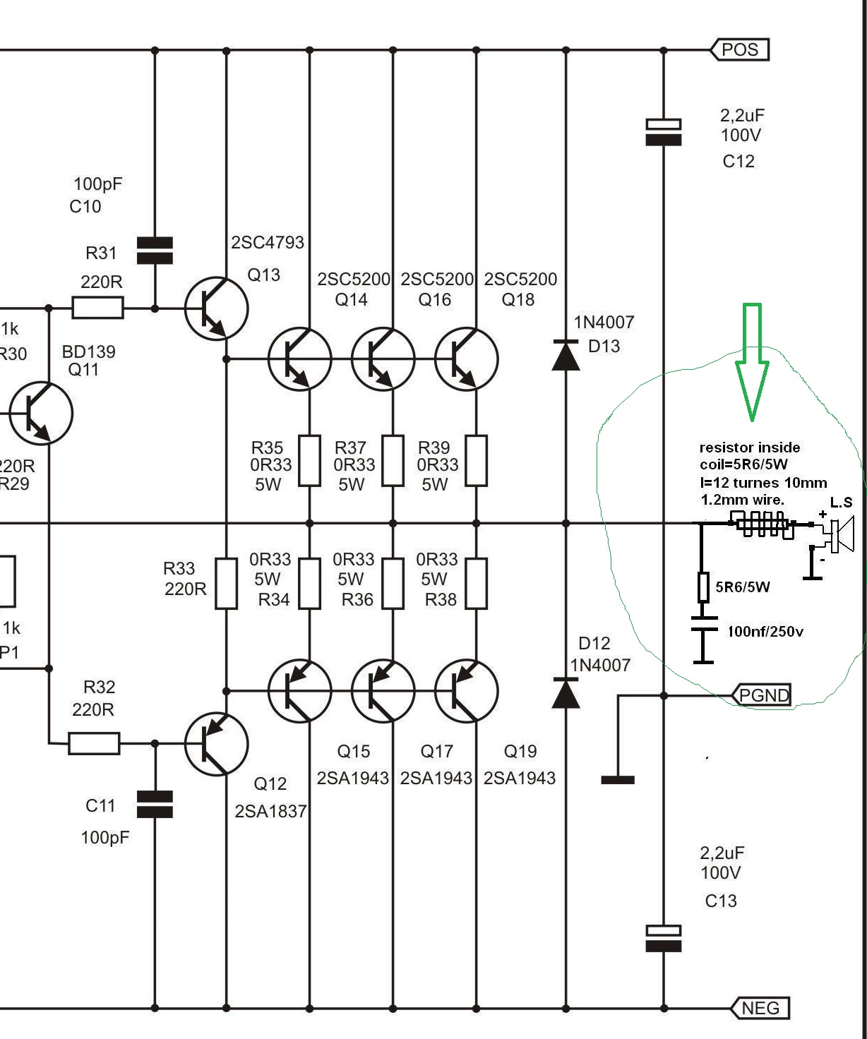

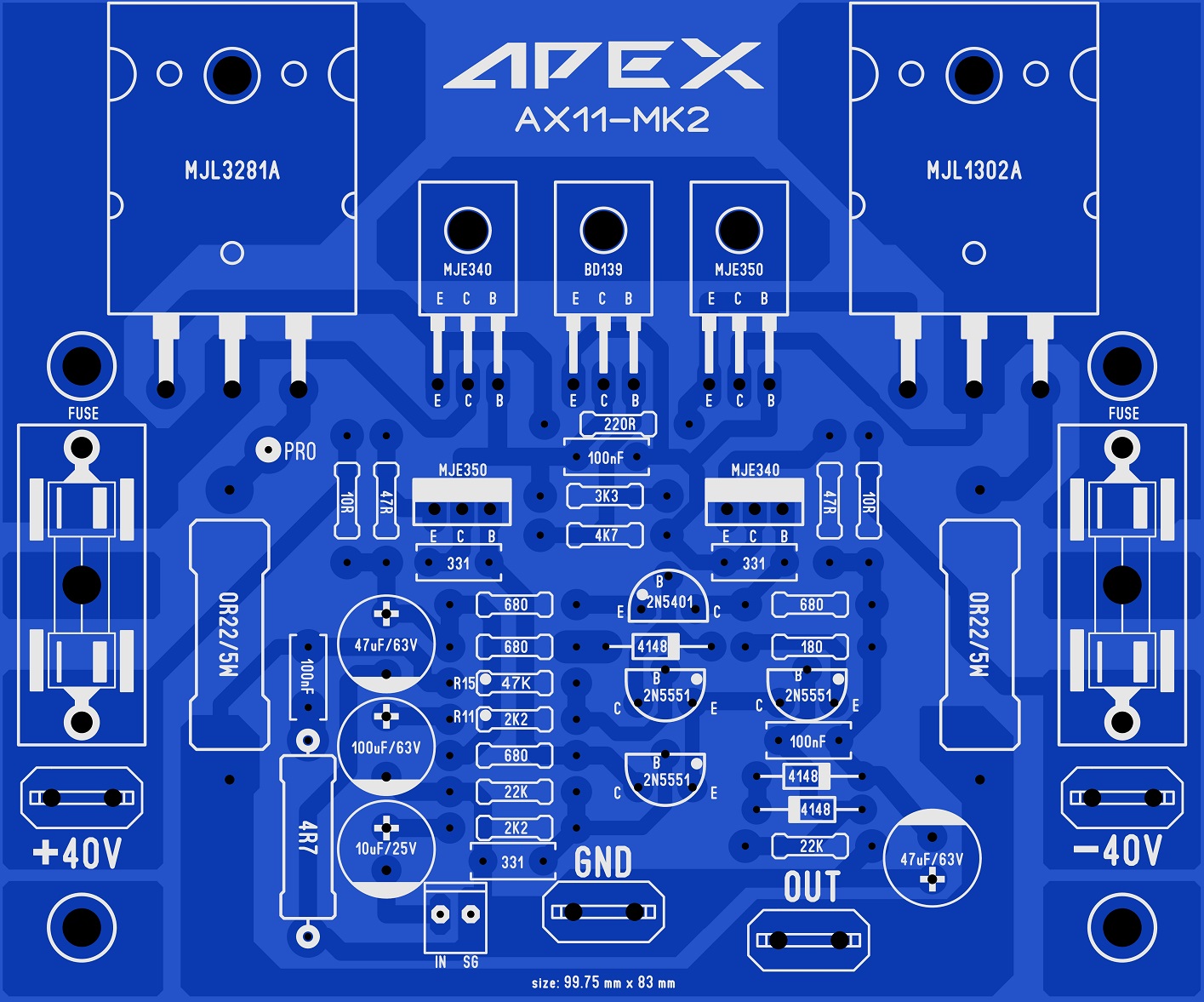

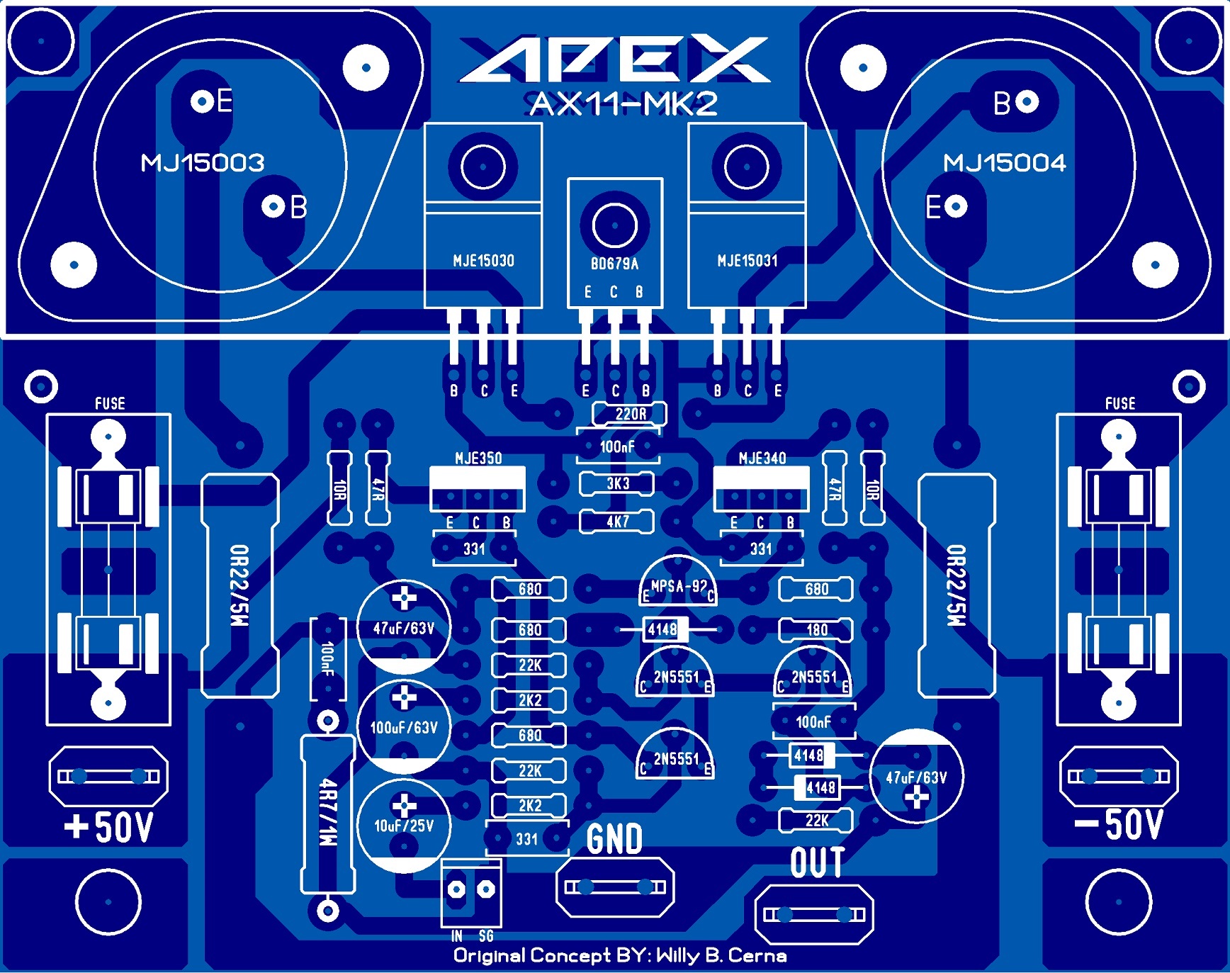

Hi Mr.Mile.
I build ax-11 MK2 and I am very happy with the sound, the bass and middle and high tones to detail, but I got the same problem with vargas Mongos, where the transistors heat up quickly. I use 25-0-25 voltage vac, what should I do so that the transistor does not heat up quickly and be stable?
Hi Mr.Mile.

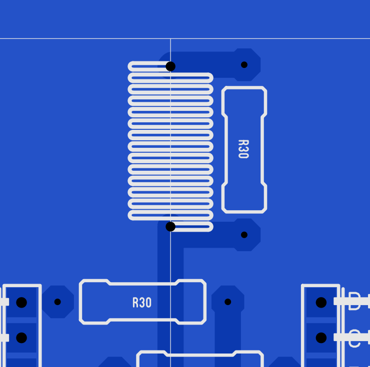

I forgot to mention that I place small heat sink for MJE350/40 and I also add a coil and a 10 ohm 7W wire wound resistors in parallel with the coil 18AWG about 22 turns on a 8 mm diameter cylinder and I notice that the amp stabilize I do not have any scope so I do heat feeling "touch" notice that the heat was lower and stable I did not have a darlington so I just drop a BD139 I mean this is me because I do not have much parts or better test tools I did as test and it works 🙂
Regards
Juan
