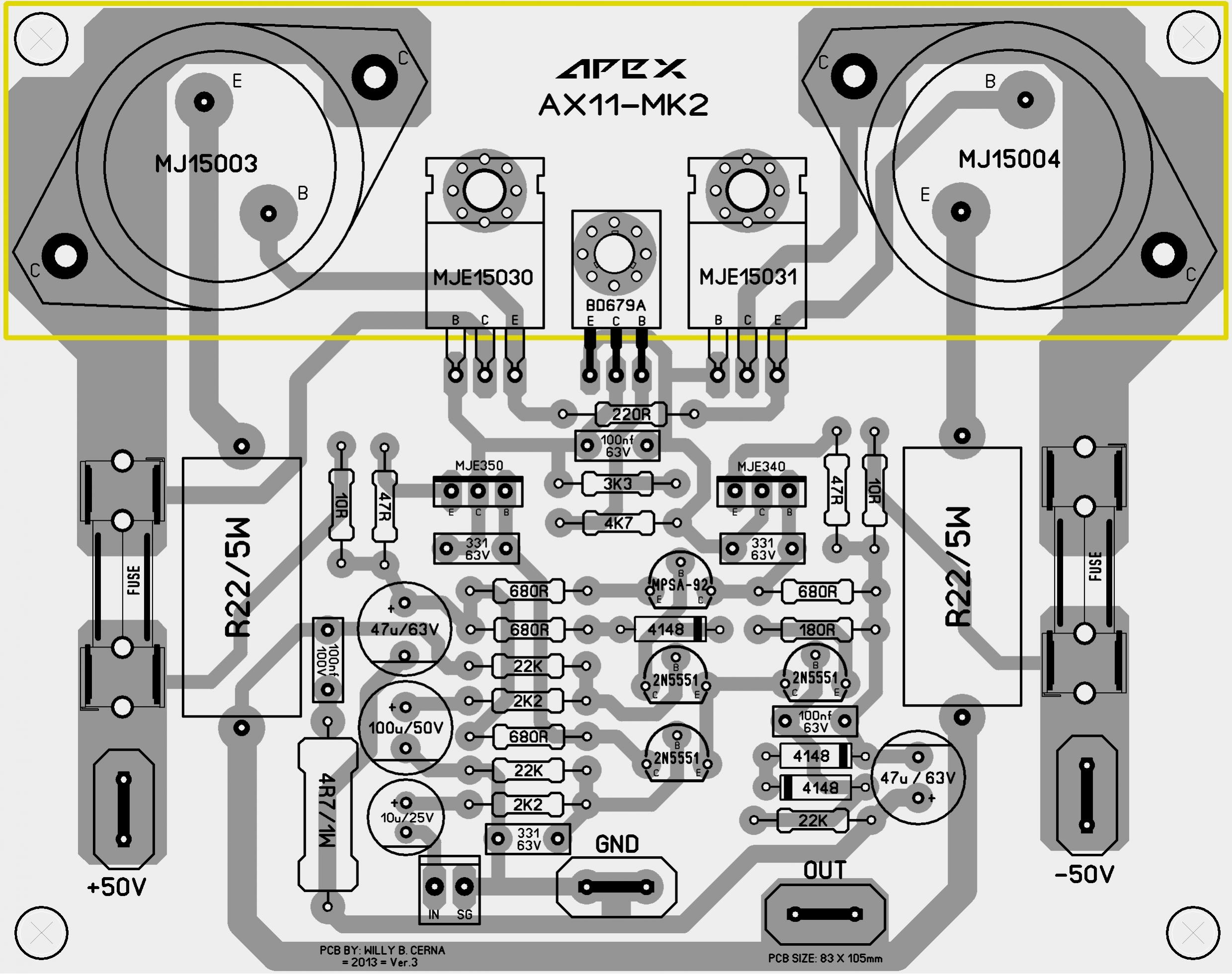

well I use a copy layout from mister Willy because my printer was not getting a correct size, and there are many options from Willy that are really good he did, I also have a few for myself for later here are some images 🙂 I tend to make a collection of my favorite layouts on this diy forums also B500 is one of my favorites too 😀
the layout I use is the one with TO-3 transistors but I have plans for TO-3P or TO-264 packing

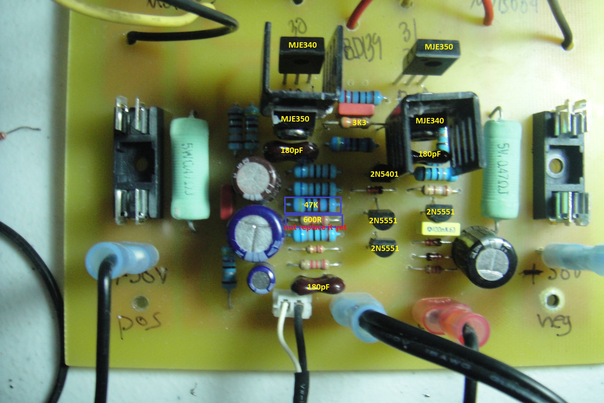

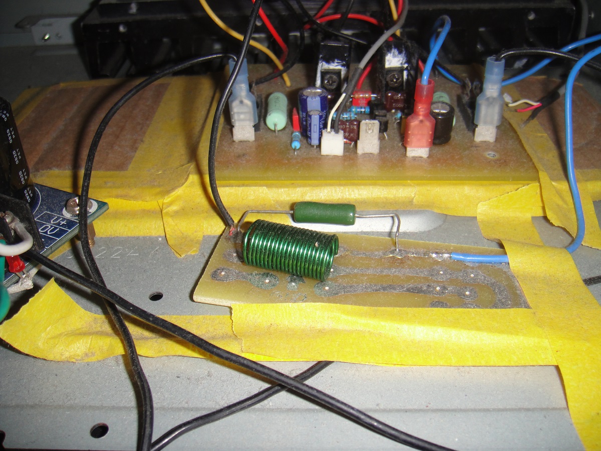

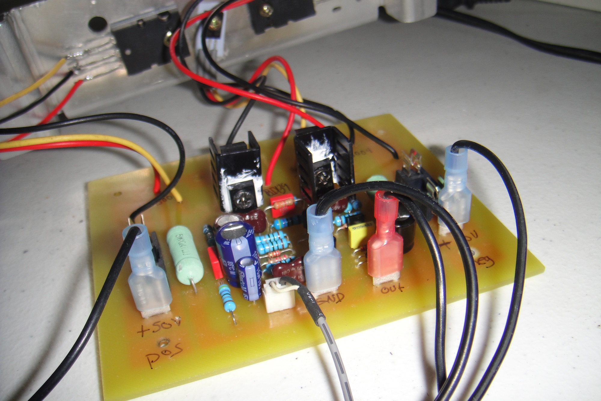

Only the one that mister Willy did, those other versions I have not tested yet but this one test it and all good here is the images, while I was listen to it I notice the main power transistors where getting a bit hotter so I thought because it does not have a zobel network then I add it a coil with a few turns with a 10 ohm 5W watts resistor and now is stable and nice and not and expert but I use what I learn from here 🙂

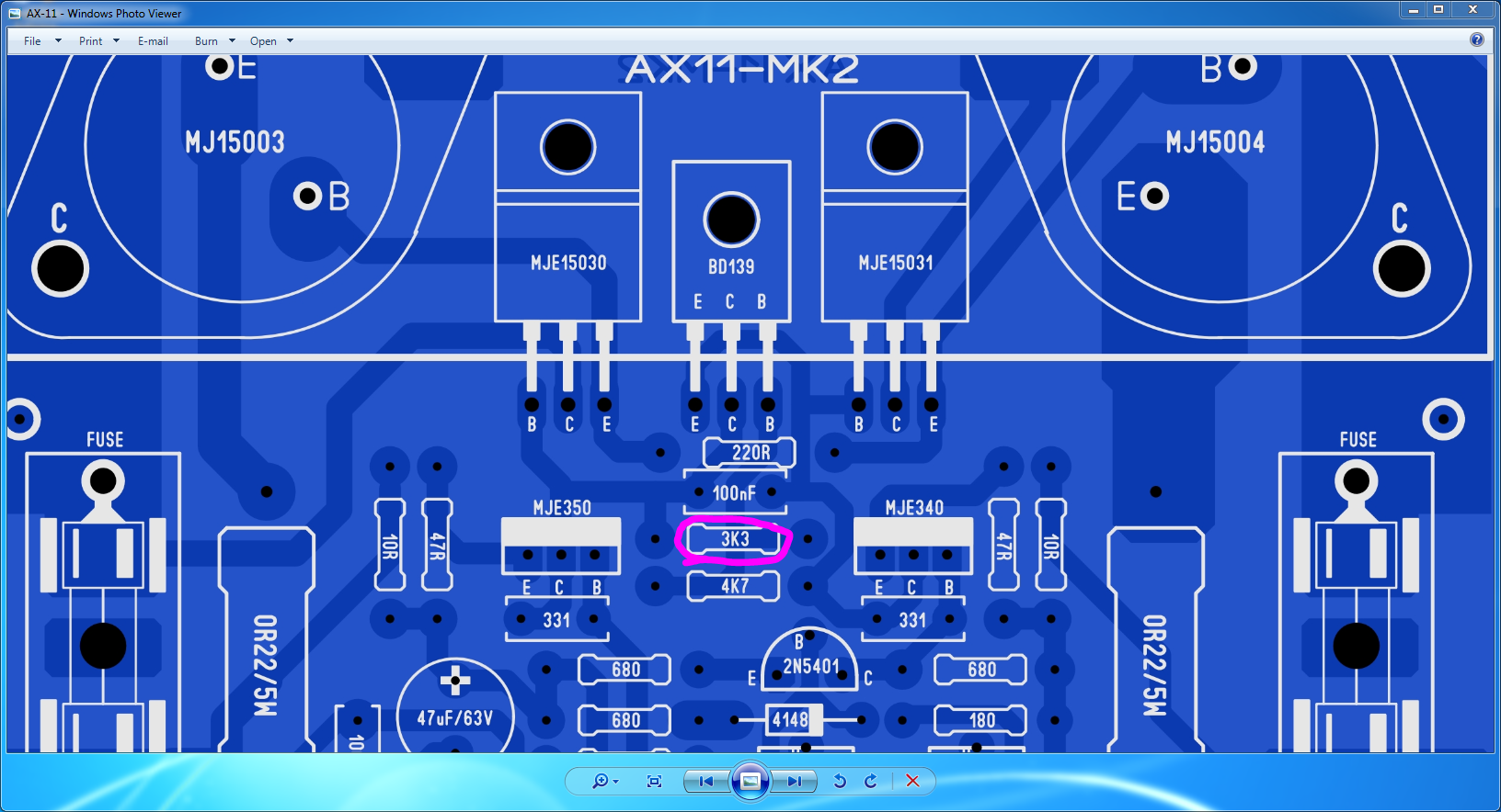

hello i have made this AX-11 but output voltage is too high 190milli volts
what to do?
are those original Toshiba power transistors bro 😕
the voltage is too high ? do you mean offset ? 😕
maybe the bias you got running to hot try increase 3k3 use a 5K pot
temporary until you find the bias you want maybe 30mA I think mister Miles
already mention that 🙂
by the way the boards look nice man 🙂
Regards
Juan

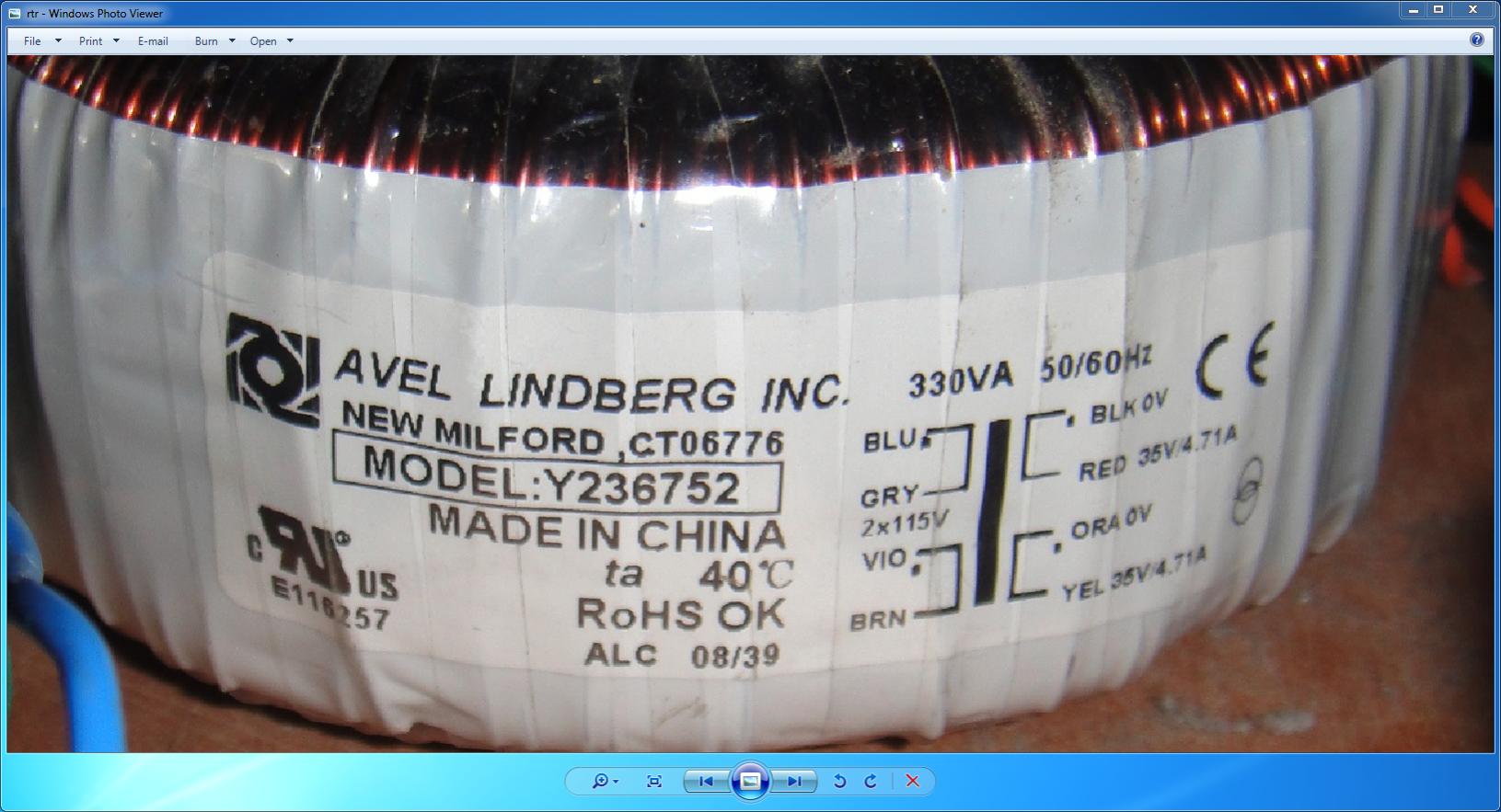

And can i use 35-0-35 vac transformer
Yes they are orginal Toshiba
Yes i am asking about offset voltage
yes it is kind of high 10mV or less is better "if possible"
uhmmm the 35-0-35 can go too high after rec/filter = 52V more or less the toroid I have it give me about 53V
