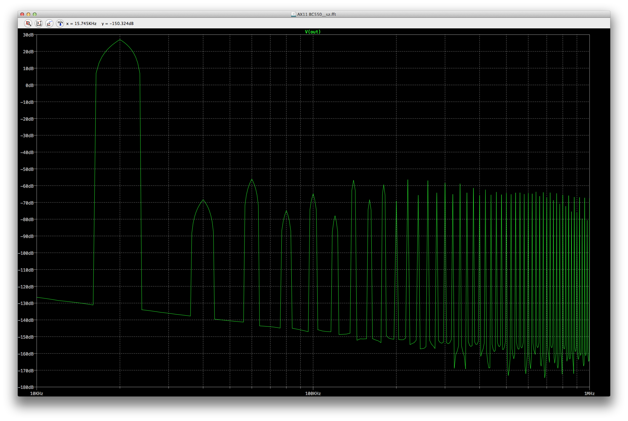

On this last one with the sziklai pair arrangement, here is the FFT plot for 20khz.
I was wondering what are the causes for 3rd order hd ?

1: The drivers are probably working like mad to satisfy the enormous capacitance of the outputs, in addition to the high currents through the nonlinear Cob of the Vas and drivers. These are most likely the cause of 3rd harmonic distortion, if it is more than you would expect normally from loading the outputs.
2: The LTP source impedance imbalance depending on which side is lower can add a 2nd harmonic which may add to or cancel the 2nd harmonic from the proceeding stages. The Sziklai LTP virtually eliminates the load-dependent contribution of Ib to distortion, so it seems there are less distortion mechanisms that would cause H2 altogether.
I've stopped considering THD changes less than at least 6db significant, because less than that and the cause is often simply the stages' individual harmonics canceling in some way. So one or two harmonics are lower but the rest are the same, which the THD meter won't tell you. Often this cancellation only occurs at specific operating conditions and signal levels and device matching so it's a bad idea to depend on it.
The tip35 datasheets that I have don't provide any cob data, but I suspect it's significant. Perhaps adding a speed up cap on the drivers' resistance might be a good idea.
So this would in part explain why that h2 was a little lower than the h3 on that fft at 20k.
I would think a cascode would not bring as big of an improvement on thd as the sziklai pair does, and trying to use both would probably be overkill and may even cause more issues and lower the benefits instead.

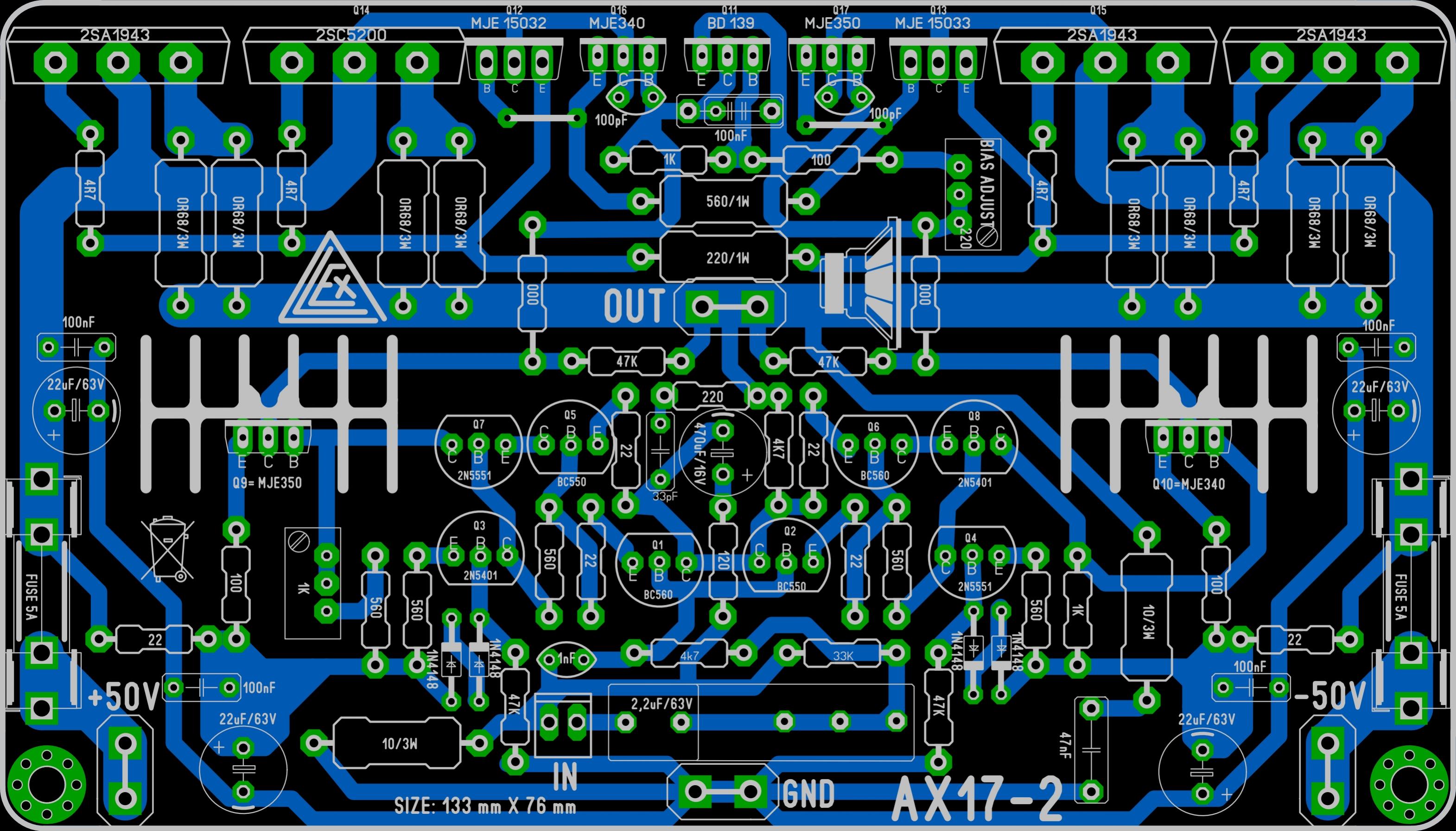

OK, thank you for the reply. I didn't do a very good job at clarifying what I was referring to, but what I meant was that the first Apex schematics in this thread look like they were pulled right from an early MX series Yamaha amplifier. The resemblence is so pronounced, that it's uncanny. In fact, with the exception of some obvious errors in Apex's drawing and the choice of alternate devices, they are the same. What struck me was that the patent for that particular discrete transconductance driver arrangment was owned by Yamaha in the 70's through the 90's. I'm surprised others hadn't taken notice of this, as some of the Japanese company's designs have been cloned by other makers over the years.
Hi kouiky, have you read the whole thread,
The ax14 is similar to Yamaha AX series,
This has been mentioned many times.
But thanks to Apexaudio the rather nice yamaha amp has
Been made DIY for the community.
I have built the AX14 not the AX11 yet and I'm very happy with it.
Regards
The thread is pretty long, so I didn't go page for page. What happened was I browsing and the design popped out like a hammered thumb as one of a kind. I immidiately yanked the early patent, and there it was. Looks like I guessed right. Some of the AX series share similar topologies to the MX separates, and that driver stage was unmistakable as the early Yamaha patented SEPP driver stage. I was aware it had been cloned and used in some higher end amps from some...ahem certain designers. I'm surprised that Apex also used it because it's off the radar, despite being a fantastic design.
