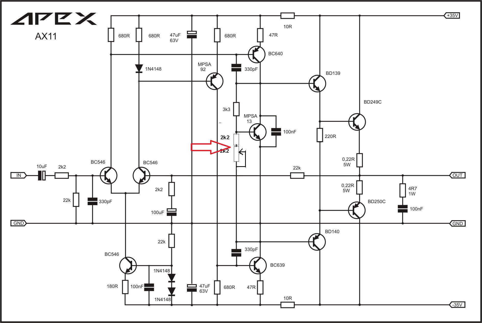

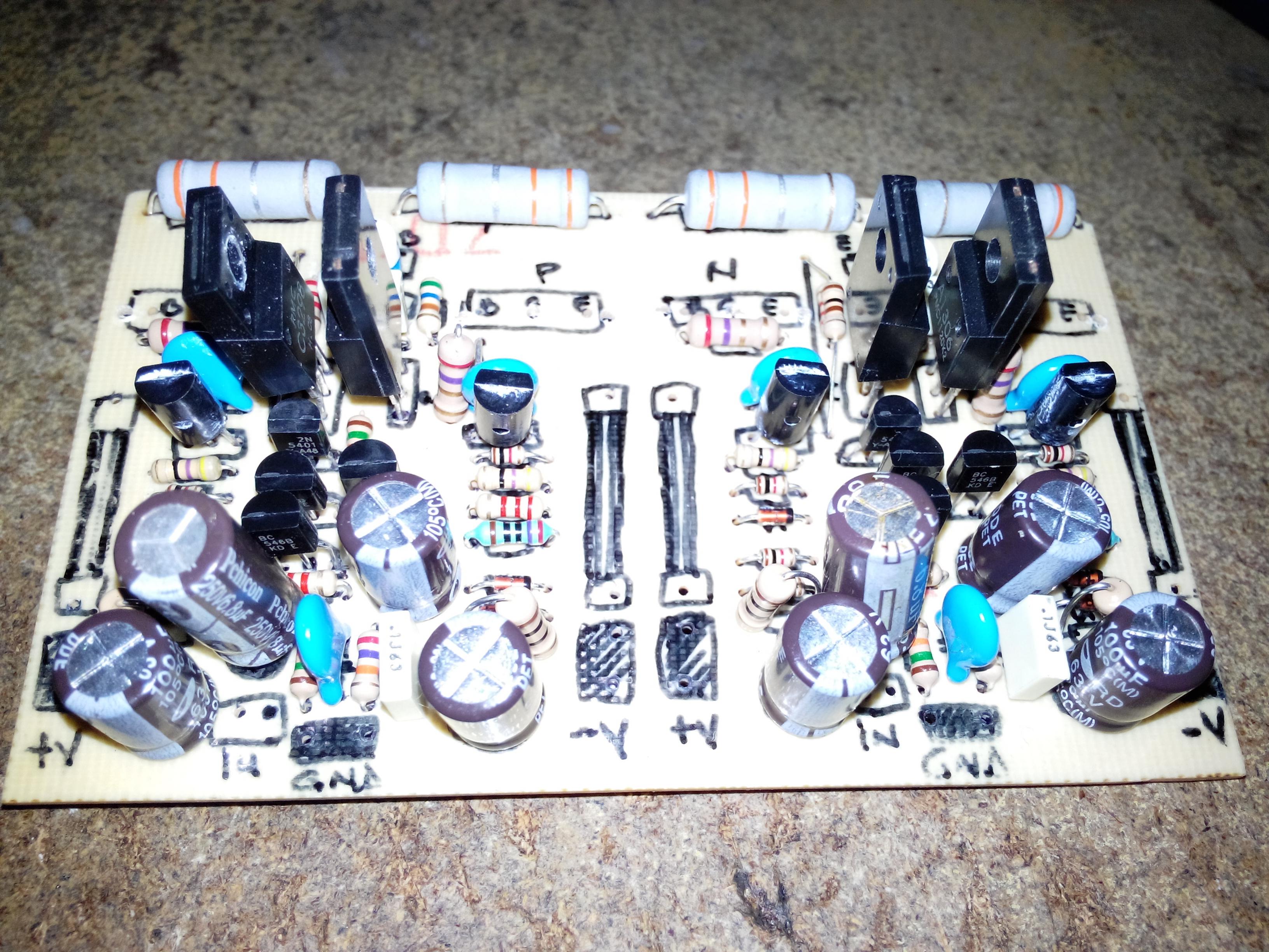

current measurement is 21.9 mV at R0.22. but not constant...the size heatsink is 20cm x 8cm for tes only.
View attachment 420880View attachment 420881View attachment 420882
Bias current is to high over 120mA, set 8mV at 0R22, and use proper heatsink.
Yes, but use 4k7 trimpot instead 2k2.
ok this morning i will try use this scheme and replace 2k2 with 4k7 trimpot..

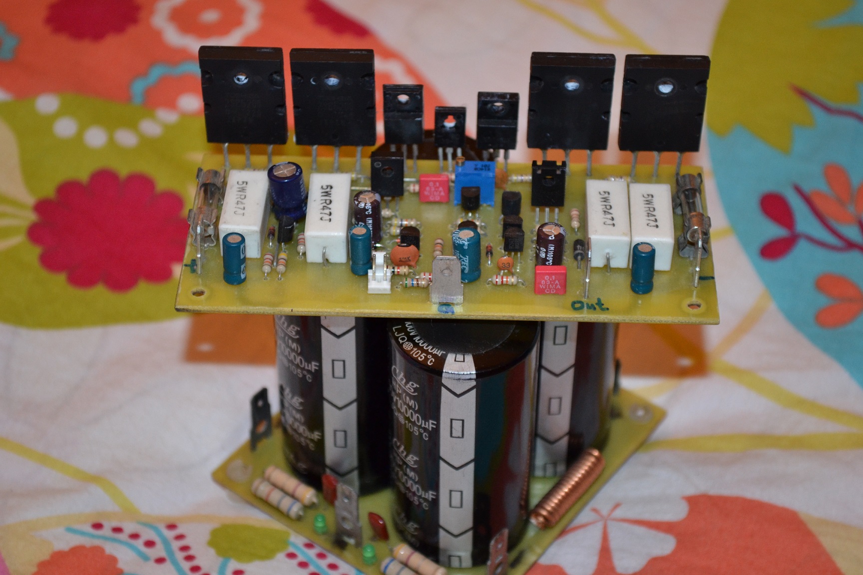

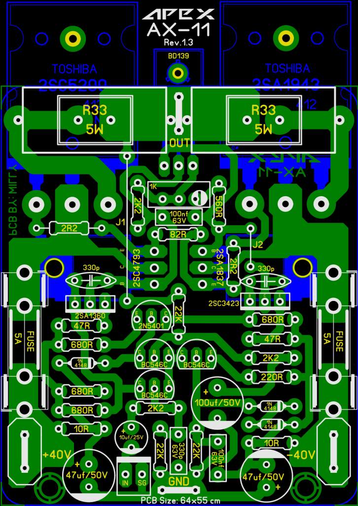

I tried pcb green.(cloned.).You will find it if you search for " apex ax11 " ...ok this morning i will try use this scheme and replace 2k2 with 4k7 trimpot..
thank a lot Mr.Mile

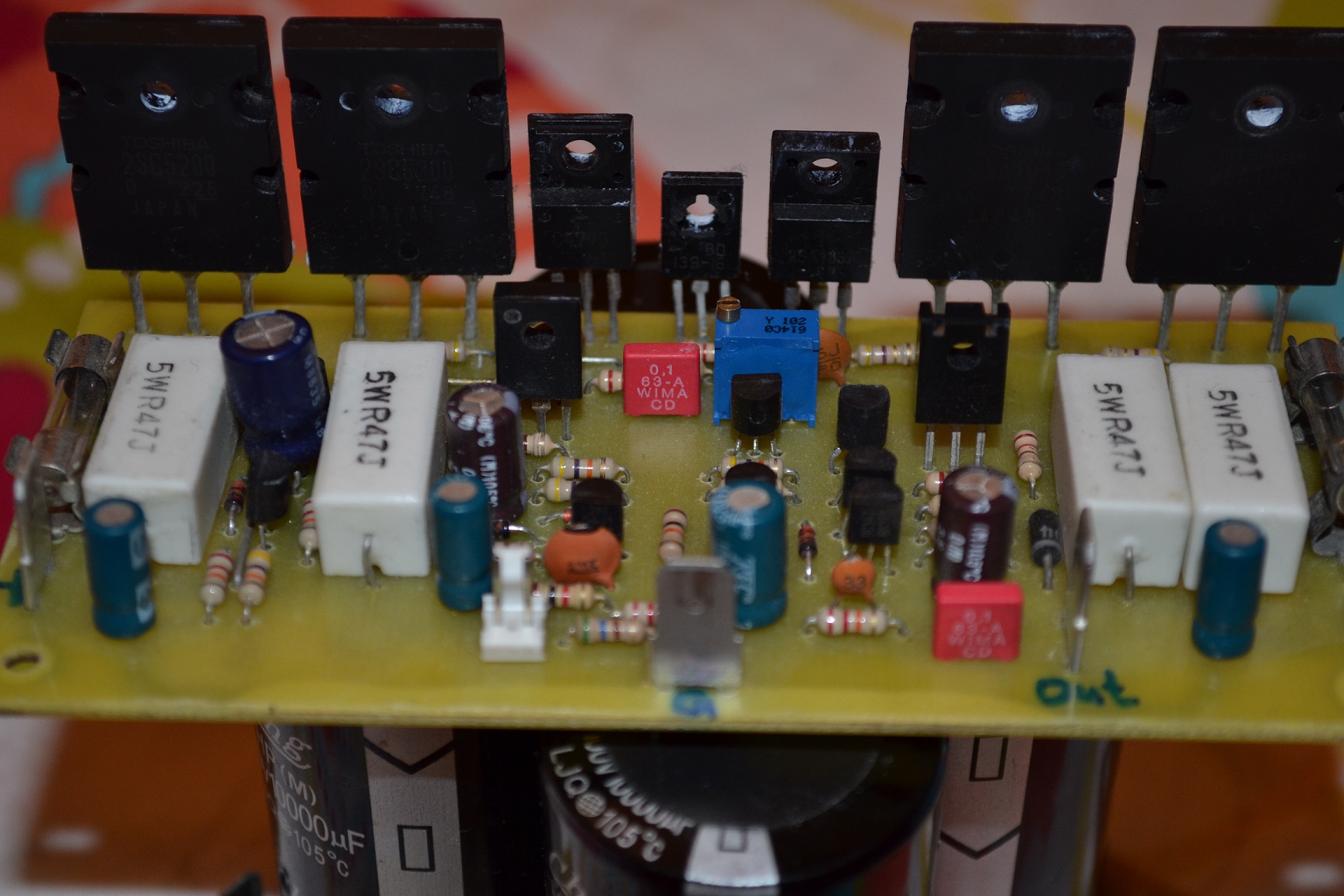

Sound is ok for its simplicity. Mine (pcb-s) are 50X60mm each one.
Pre-finals transistors are only warm -no heatsink on. Just tested it today.🙂

Hi,Mr.MileBias current is to high over 120mA, set 8mV at 0R22, and use proper heatsink.
thanks a lot,i tested to put R 4k7 + 1k trimpot and now i can set bias to 8mV,and now transistor warm only.

What about sound?
I yet havent found out why people print or write on the top layer when you can watch the picture...
What about sound?
this is a nice amp,deep and powerful bass, middle and high detail, I really like this amp.

What quiescent current, trimmer I set?
Especially for impedance 4 and 8 ohm write me, thank you.

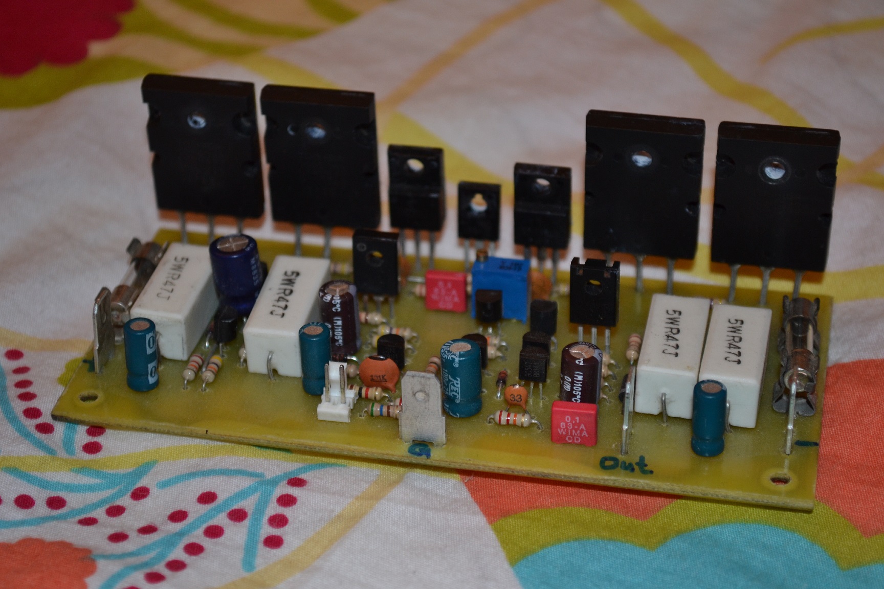

Been burning this amp for how many months but never surrender.... 😀
Very satisfying Amp....😉

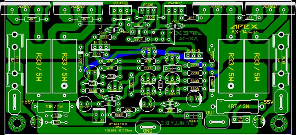

my Question : The AX14 whether or HX11?
Nice PCB
Thanks... above photos are AX-16, But this green PCB is AX-14.

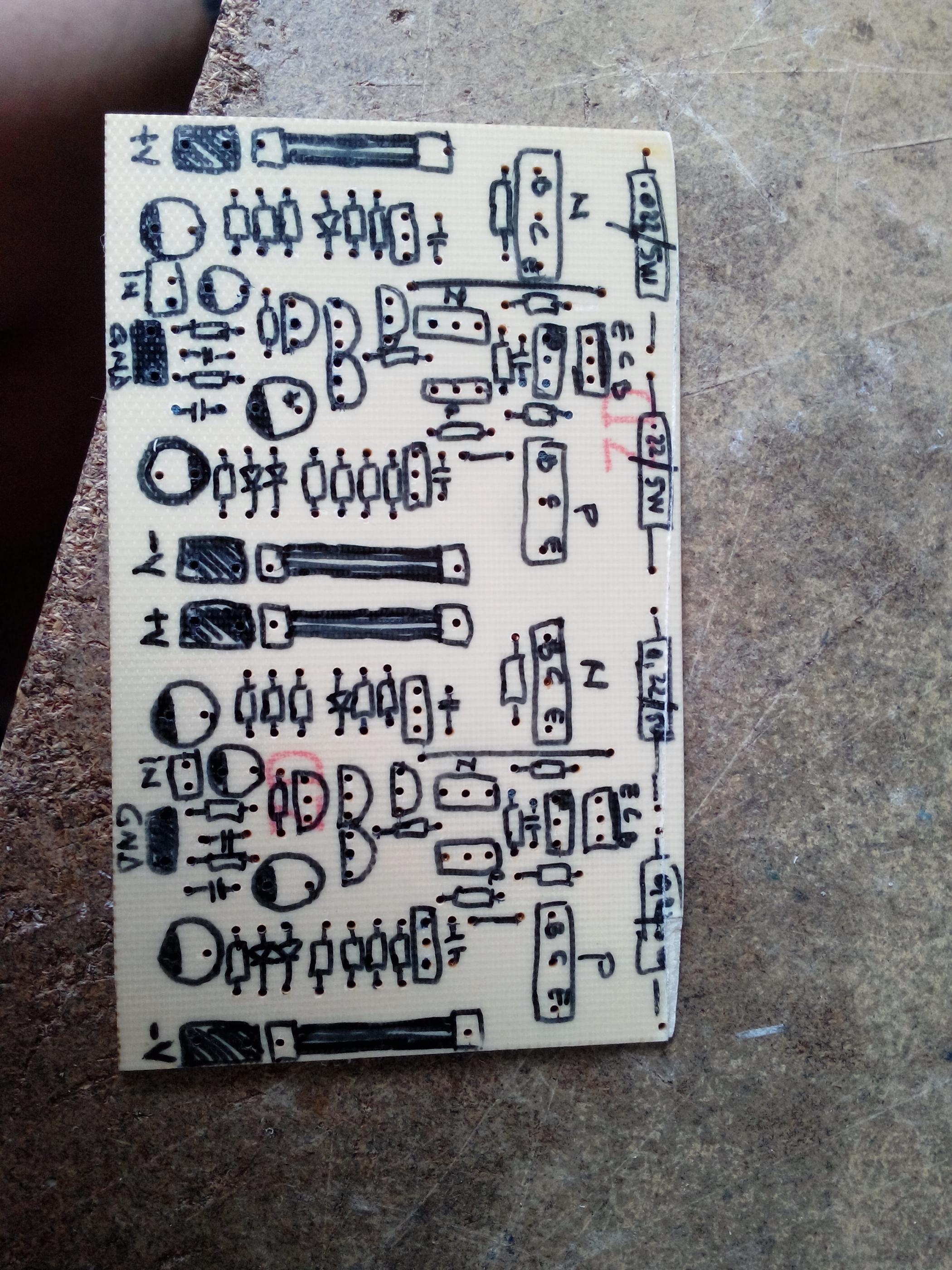

HI Cook77
for PCB layout which software are you used. I am using sprint layout but some component not macing please help me. and how to print exact size on A4 page because my layout output is bit small after print.
HI Cook77
This one is meant to be for tests, so I used a permanent marker. The most of my pcb are made like that. Lately I made some by p&p method. Just measure some transistors size and match it in the picture of the pcb . If it fits, than that is the size of the pcb....

dear apex
i just have build amplifier ax14 plz. tell me how can i prepare psu i only have four capacitor 4700/63volts.
