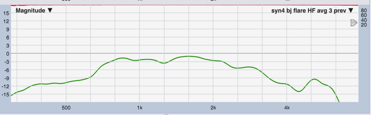

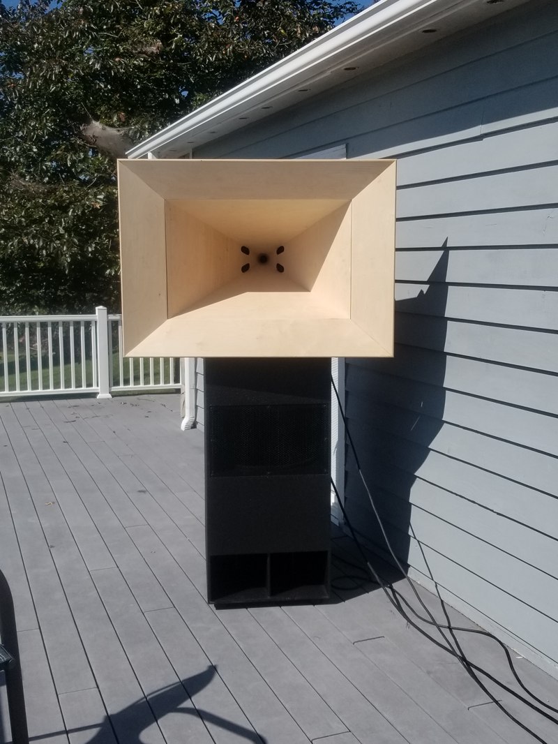

So, the last few days I bit the bullet and built the conical flare section that I'd been hoping to not have to add...simply cause every Danley synergy has the flare, as does BWaslo's speadsheet, I've heard about waistbanding ..and why do i think I can get away without it ?

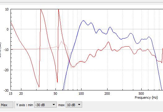

Pict is below...damn thing is getting big .... Anyway, the flare hasn't changed the oscillating polar response all that much.😕 10 degrees off axis still remains the center point around which response bounces around. You can see that in the first trace below, which is the lower section of the dcx464, which I'm wanting to use 650-3000Hz. Raw curves. Blue is 10 deg. Green is OA. Red is 20 deg.

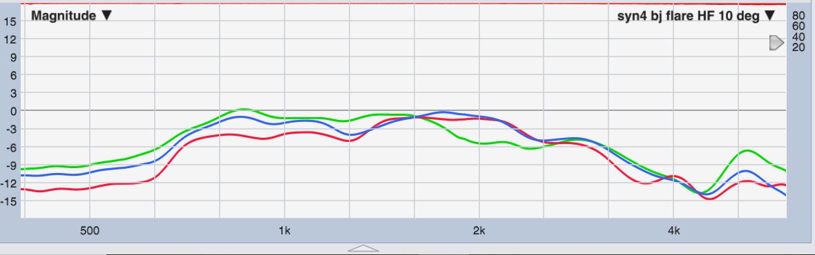

Next trace is the raw curve of those three averaged.
And last trace is processing built off that average trace. Processed curves. Same blue is 10 deg. Green is OA. Red is 20 deg.
Plenty of oscillation still. But it's sounding pretty good. I guess the real question I'm trying to figure out is, does the benefit of acoustic co-location override the issues that come with straight sided conical horns.
That and continued learning on how to improve the port design / driver location to minimize issue...
Oh, one thing that's helped and I have no real idea why other than a guess...I switched back to the bms4594he because the b&c's crossover at 3kHz appeared to be compounding polar oscillations. Man, these synergies are work !

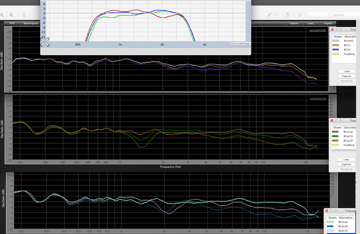

Hi Ken, yes Mabat's work is amazing. And thx for your continued comments
I really don't know how to assess the response anomalies in what the straight sided walls are causing vs what the ports are doing. (to the coax CD response).
I did measure the CD on the 60x60 before putting any ports in, and it had the same flip flop in the 1kHz and 2kHz areas as the 60x40 does with ports.
In fact, that has been one constant with both horns and both CD drivers..... 10 deg off axis is the best center response with patterns oscillating oppositely on either side of 10 deg. Direct on-axis has been hardest to work with.

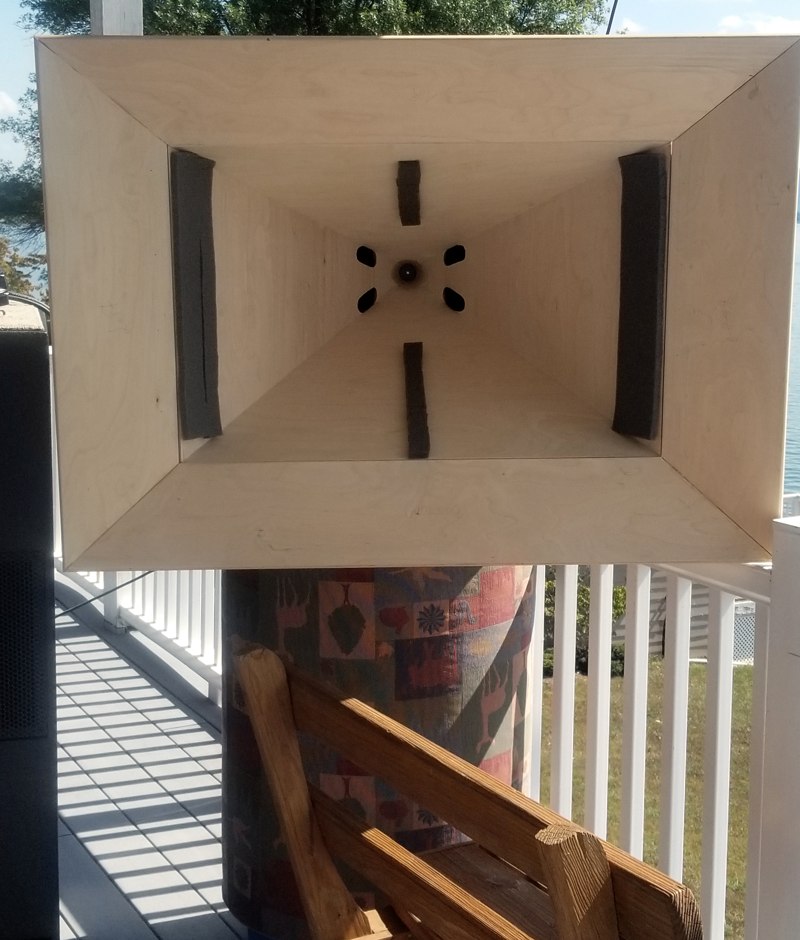

That said, yesterday I revisited foam strips, since I have added the last big unknown factor...the horn flare. I started with the horn flare off and found something I hadn't tried before...vertical strips of foam on the mouth edges to have a major positive impact on on-axis smoothing in the 1-2kHz range. However, horizontal strips on the mouth destroyed response confused: Thin strips running in the center of the horizontal horn section, mouth to throat smoothed 3-4kHz. Then I put the horn flare back on, with the foam strips in place, and response was slight worse. So I re-tuned, and even then response wasn't quite as good with no flare. That is encouraging because I'd love to skip the flare entirely.
Again, most all the trouble has been with on-axis vs everywhere else. So these strips represent bringing on-axis into line without messing up off-axis too much.
Anyway, pic of strips is below. It's given the best polars to date, and I switched back to the dcx464 for a looksee and the foam strips helped it even more than the bms. So I built dcx tunings from averages of OA, 10 deg, and 20 degs .... which worked nicely. Been listening this morning and for first time I'm not fighting tonal balance track by track more than the normal variances expected. Fingers crossed 🙂
Mark,So, the last few days I bit the bullet and built the conical flare section that I'd been hoping to not have to add...simply cause every Danley synergy has the flare, as does BWaslo's speadsheet, I've heard about waistbanding ..and why do i think I can get away without it ?

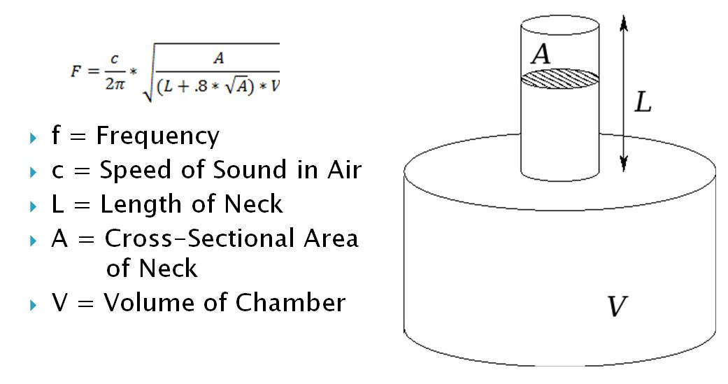

Helmholtz Calculator
may give you something to look for in the Synergy output. (haven't tried it for a single point ...)

Interesting, the Hemholtz CD suckout through the port holes.....
I'm not seeing how to apply the Hemholtz calculator though...any ideas?

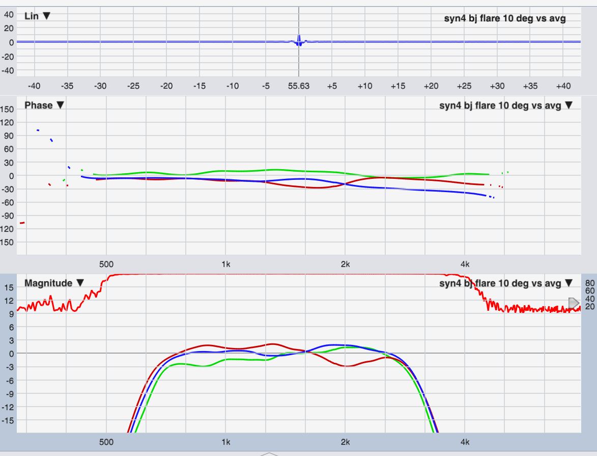

One conclusion I've come to, that I'd appreciate your thoughts on...
(and anybody else too of course)
For determining the notch frequency....
I've concluded it's from the 1/4 wave distance between acoustic origins, not throat-to-port distance. I think the CD origin is all the way to the diaphragm, we've seen this discussion before.
But I also think we have to look past the port all the way to the cone. the cone origin is all the way to cone.
I think 'all the way to the cone' means most likely close to the cone portion adjacent the dust cap.
This obviously gives a longer path than throat-to-port, but this longer path equates to where I keep measuring the notch.
Without moving the port, I watched the notch move down in frequency as I positioned the cone's outer perimeter over the port, and move up in frequency with the port more under the center of the cone. I'm led to believe minimizing port to cone center distance shortens the acoustic path....
Do you see any other factors / explanation for notch moving due to cone-over-port location?
So rightly or wrongly, I've decided I need to think about a synergy's acoustic centers from two different vantages:

Well, I think I was confusing cd to mic path vs mid to mic path with mid direct to mic path vs mid back to cd and then to mic path when I wrote this. Clearly both mid direct and mid reflection paths start out with "mid cone to/thru mid port" sub-path and only then deviate. When you subtract the two path lengths, "mid cone to/thru mid port" sub path drops out.
When you reposition the mid cone over the port, ostensibly moving the cone back away from the port to center the mid over the hole, I would expect the time delay you need for time alignment between the mid and the CD to change but I would not expect the reflection null to move. If it does indeed move, then i would look for another explanation.
Hi guys, thx for thinking this thru with me..
I'm not following "When you subtract the two path lengths, "mid cone to/thru mid port" sub path drops out. "
I've been visualizing that the reflection is a roundtrip from cone, thru port to bounce off CD (wherever it bounces), then back thru port and back into cone. Which causes a half wave cancellation with easy to determine frequency because both paths are identical length. The measured notch appears to match physical distance pretty well afaict as I move cone around over port.
(That's how I came up with thinking cone center is close to junction of cone and dust cap.)
But, the same reflection after bouncing off CD, also goes straight out the horn, with a bit shorter path before it sums with cone output coming thru port and straight out of horn.
So I guess I'm trying to describe the two acoustic-center vantage points again.
One inside the horn, that uses true acoustic origins and causes cancellation at the cone before even leaving the horn.
And the second that uses apparent acoustic centers coming out of the horn, summing to cause cancellation out at the mic.
Two different cancellation frequencies I think, and I'm left wondering out to measure out which is which.
