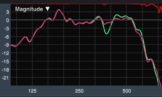

Or to put it more simply,
when the woofer cone is centered on the woofer port, then the acoustic center of the woofer port will be at the center of the woofer port, perhaps some distance in or out from the horn wall but on the central axis of the port.
When the woofer isn't centered on the woofer port then its possible and perhaps likely that the acoustic center of the woofer port is off this central axis.
This could explain the change in reflection null frequency when the woofer was repositioned relative to the center of the woofer port...

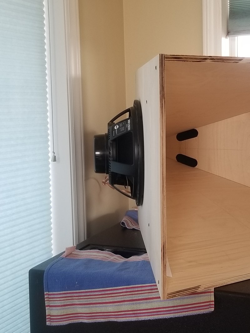

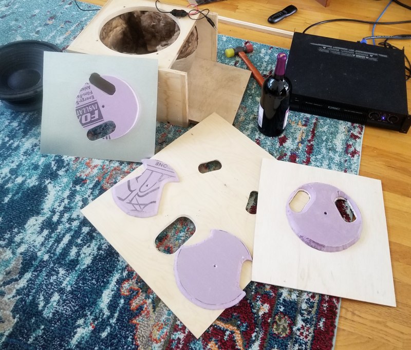

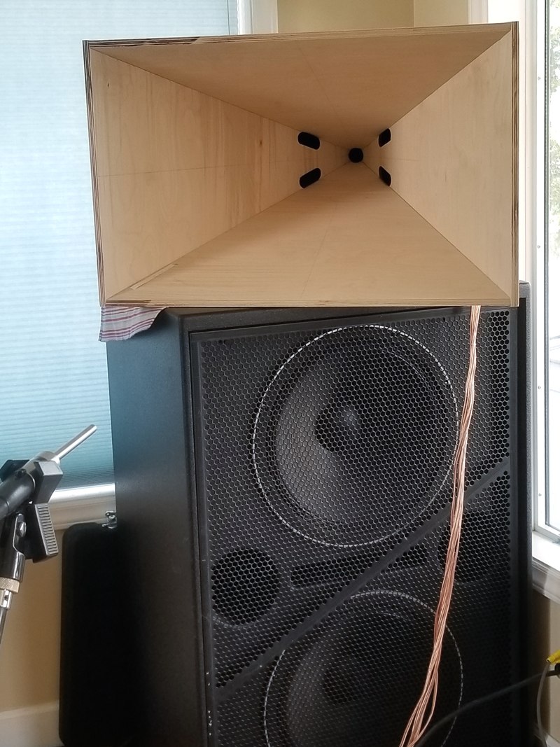

A few construction pics below.
To shed weight, and reduce rear chamber volume of the 12"s, I ditched the one big box enclosure and made separate small accesses as shown. Using foam board to further reduce volume.
The second pict shows the runners on the horn mouth for attaching the secondary flare assy.
The last is pict the detachable flare.
It's about the only way I can move the whole box around easy...having the frame detachable.
Oh, and for relatively easy moving, I also needed to make the CD and its small box removable. Makes CD exchanges easy too.

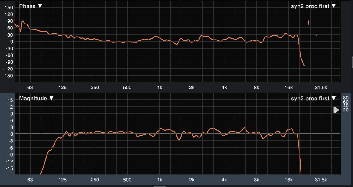

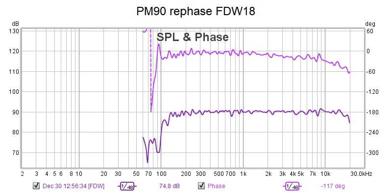

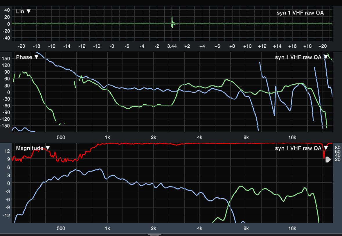

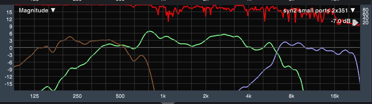

Progress report....
Well, happily, I think I've reached a new personal 'best sound to date'.
Lots more tinkering, trying different tunings, have somehow led to a really nice sound.
Hearing lyrics never caught before, vocal inflections, bass riffs, etc...with all the dynamics I'm so accustomed to.
I think the real breakthrough was just accepting that the straight sided conical horn was not going to give me a way of using the relatively automatic EQ process I've had so much success with on regular multi-ways. (Same thing might be said for what I need to realize regarding my last build attempts before the synergies...the straight and CBT line arrays...need to revisit them too I think).
I really softened the minimum phase EQs I would allow into the tuning, but still kept phase pretty flat.
I'm not talking about not allowing high-Q EQs, or excessive mag adjustments. I've known to avoid those forever.
It has ended up working better to softly 'eyeball average' all the tuning attempts (which were to particular spots or averages of spots), than to tune meticulously to averaged measurements. Hope that made sense.
No real clue why yet....
Another happily...don't think I need to add any bass reflex ports...at least not crossing to sub at 110Hz.
I'll need to get outside and really crank it up, to see if I can lower xover to 100Hz at full volume, which has been the design goal.
It should crank up pretty damn loud !
Rechecked sensitivity outside: all at 2.83v 1m.
mid 105.3dB : HF 110.4dB : VHF 106.6dB
That was with the dcx464 crossed at 3kHz. I've since moved xover to 4kHz just from listening tests...I should rerun HF & VHF sensitivity although I'm sure it won't change much if any. I'm a little surprised the VHF sensitivity is not up with the HF.
Should also add that I'm low-passing the dcx at 17kHz cause I think it's just burning current up there....needs real boost above 16k or so. (especially makes sense to low pass given my old ears 😛.)
Anyway, my biggest problem now is that I like it so much I wanna build another to try out stereo 😀

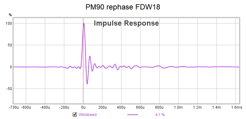

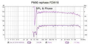

A big change in thinking about measurements and measurement averaging, occurred at a Rational Acoustics training class I recently went to. The class discussed averaging quite a bit, and how nulls can at times inappropriately average down peaks in the summed measurement , peaks we would like to EQ down. I think I saw Gmad talking about this in another current thread.
That's what led me to a psuedo-averaging the on and off axis processing curves made for each location, instead of making a processing curve based off the measurement average of those locations.
The conical just has alot of stuff going on that measurement averaging seemed to be missing.......
I think the good news for a DIY synergy builder, who needs straight sided walls for simplicity, is identify the major trends on and off axis...treat those trends loosely and nothing more. Maybe it's why Danley's relatively simple passives work as well as they do...????
