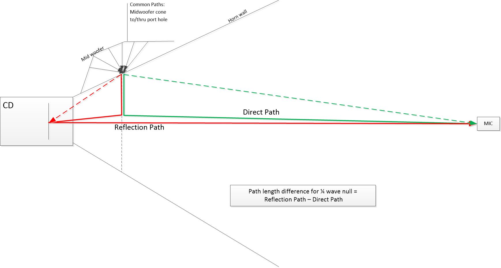

To counter your theory that there is a round trip from woofer cone to reflection point inside CD and back to woofer cone that results in a null that then propagates to the listener, I would point out that not all the reflected energy goes back into the port hole. In fact most of it goes down the horn.
I think you have to take the observer into account. If this were indeed quantum dynamics, there wouldn't even be a null unless a mic were there to measure it :)
If you want to listen for a null at the woofer cone, then what you say is true. The round trip path would then extend back to it and the null frequency would change when you re-position the woofer so that its cone moves towards or away from the port hole.
If you listen for that null anywhere else, the null frequency is independent of the distance from the woofer cone to the far side of the horn wall. The distance from the woofer cone to and through the port is common to both the direct and reflection paths. When you subtract the two, the result is independent of the distance from woofer cone to and throught the port hole. That is what I meant by "the term drops out"
This picture should make this clear:
attachment.php
I'm showing a slanted line from the mid port to the mic and an unslanted line from the CD reflection point to the mic. Thus it seems like the null frequency would be at least slightly sensitive to the listening distance. As you move the observation point out towards infinity (i.e. a few meters) this sensivity decreases, so its usually ignored, if thought of at all.
Perhaps there is some point source summation magic going on in the horn throat immediately adjacent to the mid port holes - perhaps a null forms there and propagates down the horn to the listener and mic. Since we usually count axial distance on the horn, not the distance along the horn wall as in my previous picture, when estimating null frequency, perhaps I should redraw this way:
attachment.php
The dashed lines show the previous point of view.
I'm trying to make the picture more realistic and also show how imprecise it is by way of the visible difference between the two points of view.
I am showing that there isn't just a single distance from woofer cone to the port hole but I haven't nailed it yet. I've drawn the port more as a point than as a hole. My experience is with relatively small holes appropriate for a 4" mid that I used only down to 250 Hz. Mark's holes are for a 12" woofer playing below 100 Hz.
When the ports get so large I can indeed imagine that the "acoustic center of the mid port" moves some distance inside the port hole and that that distance could indeed depend upon the distance from the horn wall to the woofer cone!
Or, more likely, that the acoustic center of the mid port moves along the horn wall, within the confines of the mid port hole, depending again upon the distance to the cone. When the port is aligned with an edge of the cone, most of the sound from the woofer cone comes from the other sides of the hole, those furthest from that nearby cone edge and so the acoustic center of the mid port isn't at the center of the mid port. When the port hole is aligned with the woofers dustcap, the sound comes equally from all sides and the acoustic center of the port is in the center of the hole.
I hope that makes sense and I haven't confused myself again. The lesson to me is to beware of simplistic models.

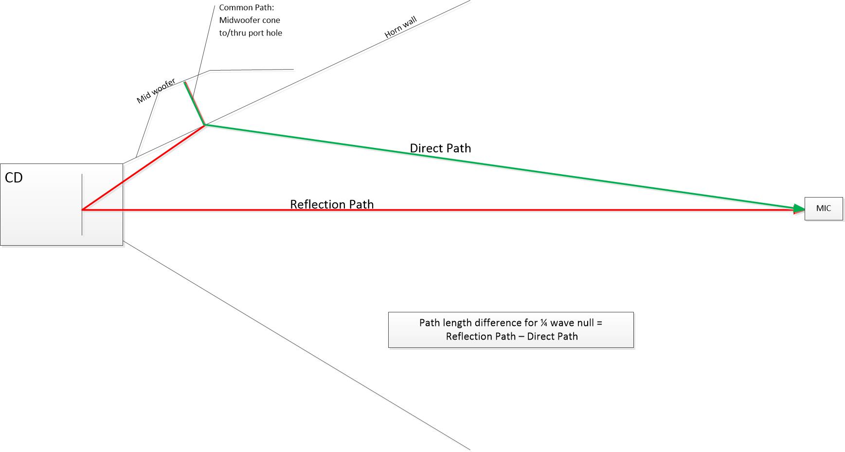

Or to put it more simply,
when the woofer cone is centered on the woofer port, then the acoustic center of the woofer port will be at the center of the woofer port, perhaps some distance in or out from the horn wall but on the central axis of the port.
When the woofer isn't centered on the woofer port then its possible and perhaps likely that the acoustic center of the woofer port is off this central axis.
This could explain the change in reflection null frequency when the woofer was repositioned relative to the center of the woofer port...
Great stuff, many thx. And yes, it did all make sense.

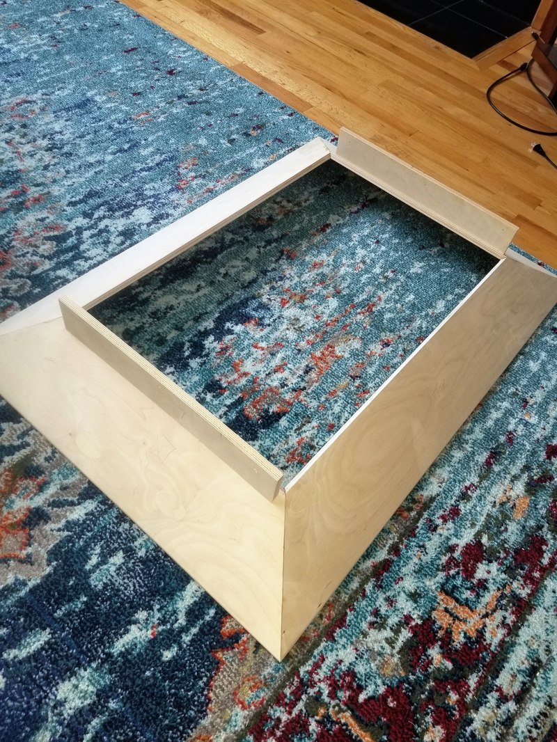

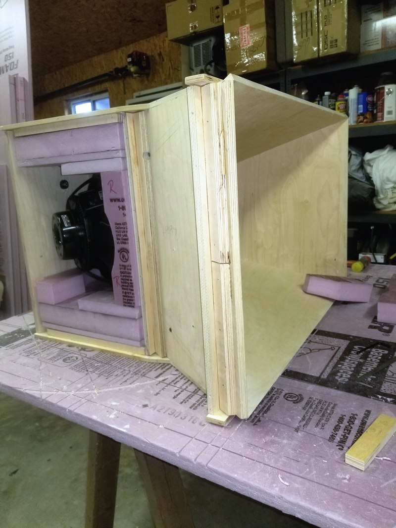

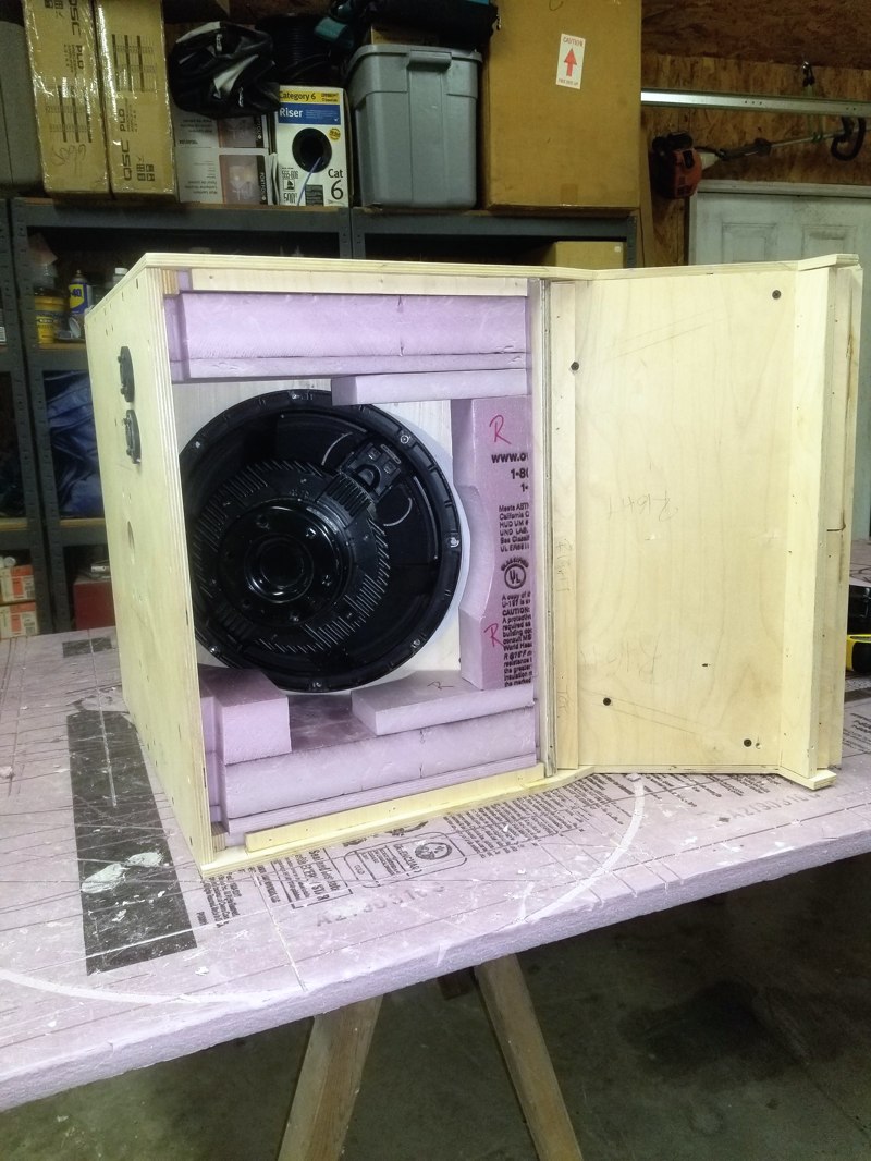

To shed weight, and reduce rear chamber volume of the 12"s, I ditched the one big box enclosure and made separate small accesses as shown. Using foam board to further reduce volume.
The second pict shows the runners on the horn mouth for attaching the secondary flare assy.
The last is pict the detachable flare.
It's about the only way I can move the whole box around easy...having the frame detachable.
Oh, and for relatively easy moving, I also needed to make the CD and its small box removable. Makes CD exchanges easy too.
