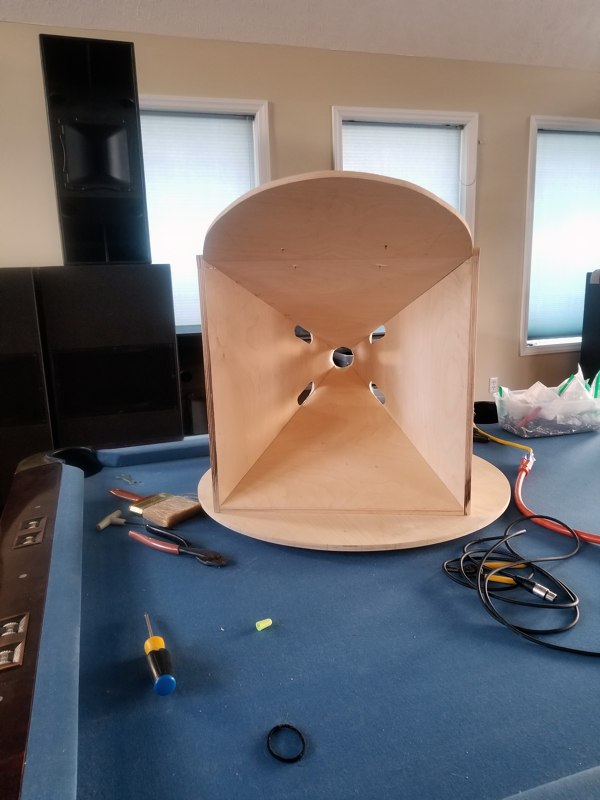

Anyway, maybe the following might help clarify.. The pict is the 60x60 deg with one "petal" as previously described, attached to the horn. (albeit drivers removed) The transfer function graph green trace is that of one petal, as shown in the pict. The brown trace with the deep notch at 2.4kHz, is with the same sized petals attached to both sides of the horn in addition, so three petals total.
I can't see how the notch has anything to do with 1/4 wave reflections. It seems to be completely about mouth termination. I surely need help understanding !!!!

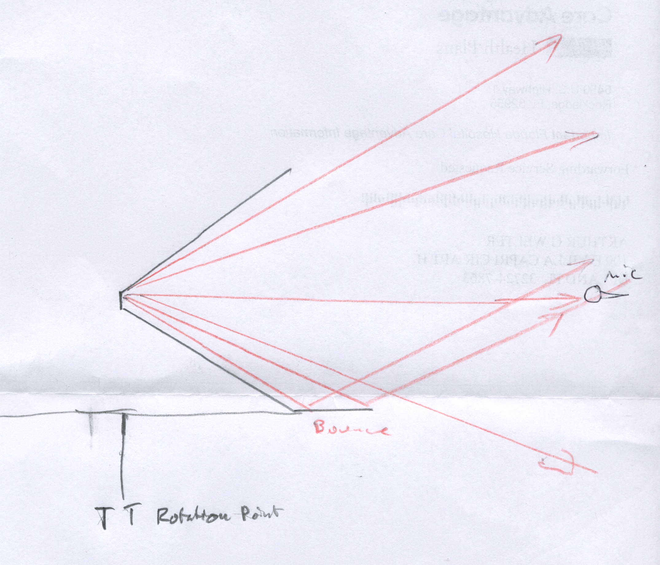

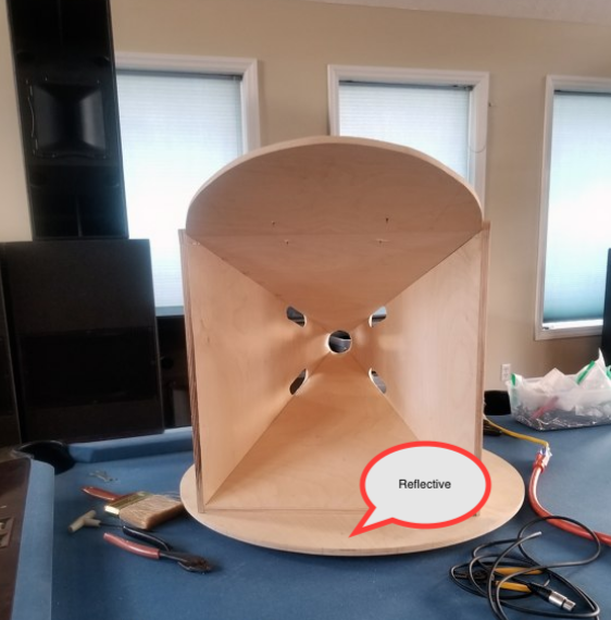

Mark,
From the picture, can't tell the angle of the "petal" to the horn side wall. If the "petals" are at the same angle as the horn wall, they shouldn't affect the horn performance much at all other than controlling dispersion to a lower frequency.
However, the portion of the turntable (and pool table) on the bottom of the horn is reflecting off axis response back across the center of the horn, definitely a bad thing as far as response linearity is concerned.
Unfortunately, the turntable must be rather small to avoid interfering with measurements, requiring a lot of rear weight to counterbalance the horn- below is an example of what happens when a gust of wind came up while checking out the prototype for the secondary expansion on the SynTripP. Later tests used a lot of bar clamps...
Art

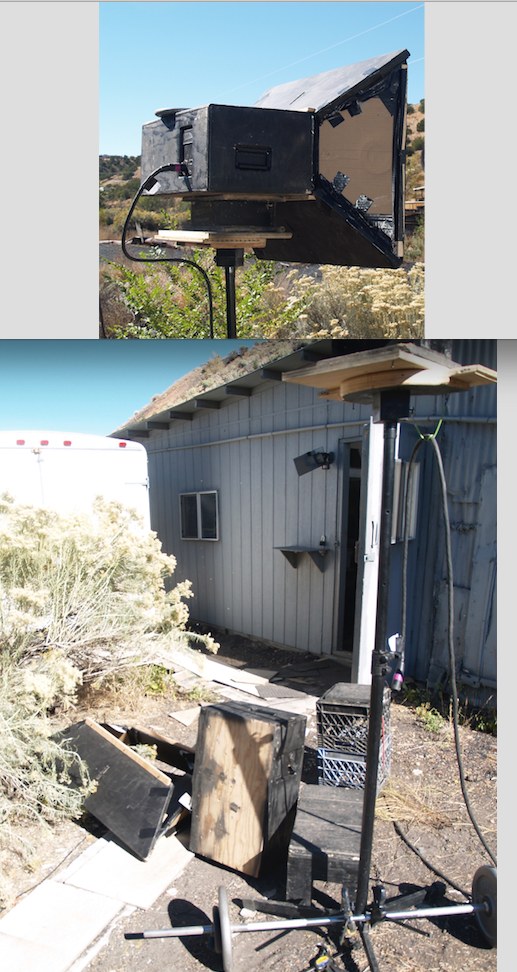

The 'petals' had the same angle as the 60x60 horn. So it's really just a 60x60 with 3 sides having the rounded mouth. That's why I don't understand the deep 2.4kHz notch.

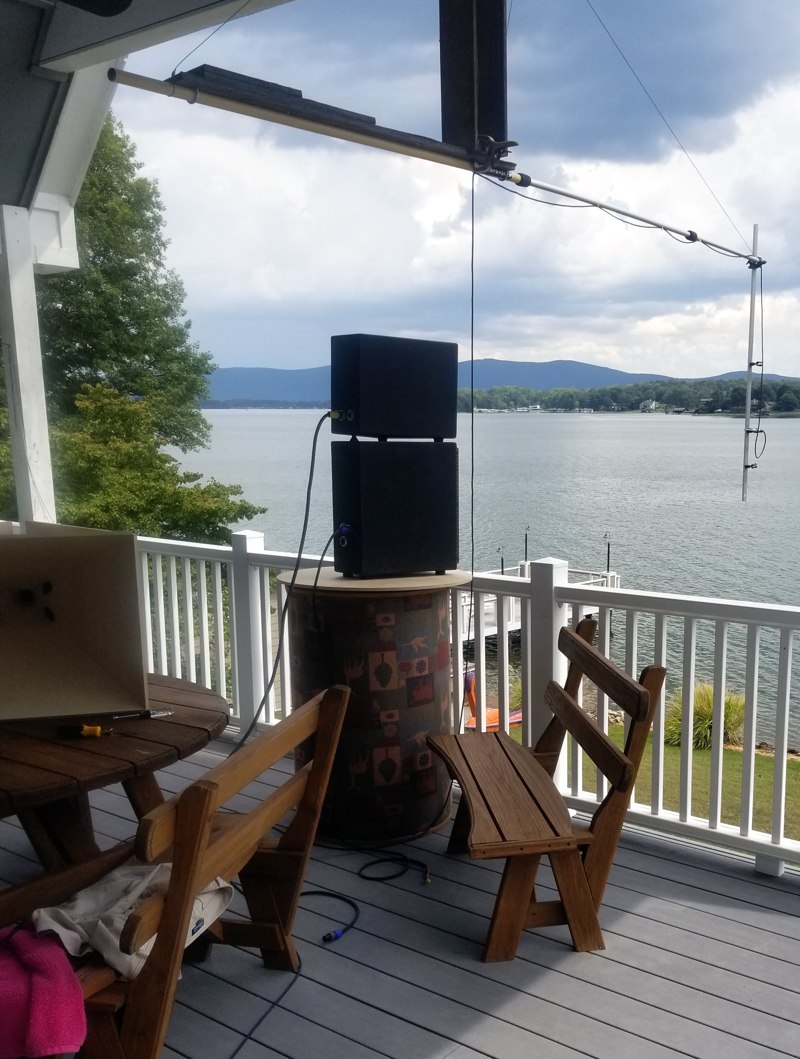

The pict on the pool table was just to show a petal. I'd never measure like that. The attached pict shows where/how I've been measuring, both for this thread and the dcx464 thread. The modular 12"/ dcx464/xt1464 rig is on the turntable, with the CD's acoustic center on top of turntable center. When I put either of the synergy protos on the table, with the CD's center over turntable center, the mouths extend over the fence rail. Fortunately the synergies are heavily rear weighted enough to allow this.
Thx Art 🙂
The almost too easy speaker correction available using FirDesigner led me to the test setup.
After correcting waay too many reflections waay too many times, it became obvious I had to find a quicker way to make at least half decent measurements.

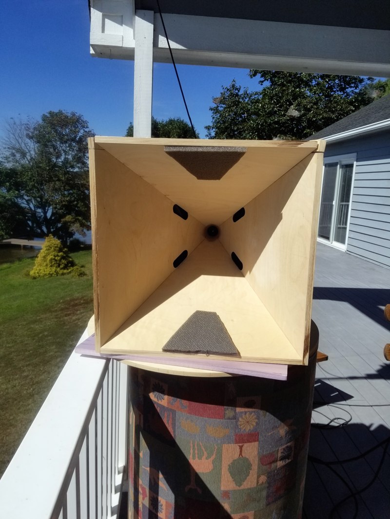

Ok, a bit of a breakthrough in making sense of measurements.
On the 60x60, using a dcx464 CD, I finally started noticing loopback timing descrepancies between the two CD sections.
On a xt1464, the lower dcx section (I'll call HF) lags the higher section (VHF) by about .08ms on-axis. And this lag stays the same going off axis. This is the same for the bms 4594he btw.
On the 60x60 synergy, the HF section lags the VHF by .40ms on-axis !!
This can't be !!
It appears to be caused by 4 summed reflections off the horn walls overpowering direct from throat signal.
Putting a small pad of acoustic foam in the center of any two horn panels changes the delay back to .08ms. By center I mean running from throat to mouth. Pad only has to be about 1.5" wide and about 4" long, at the mouth. Trapezoid doesn't work any better, but looks better. More than two sides messes up off-axis a little more than just two.
Part, but not all, of the on-axis vs off axis pattern oscillation I've been having trouble with, appears to be due to stitching together measurement based on the reflecting timing.
I've gone to rephase where every adjustment is manual to help sort things out. Polars are slowly improving 🙂 And so is the sound 😀
That is a really nice location!! Not only for measuring loudspeakers!😀
That is something to make note of! Luckily I didn't encounter these issues with the 850ND's, but they have other issues 🙄 (don't play as low as the coax drivers for example)
Do you think an OS waveguide like the SEOS30 would generate summed reflections off the horn walls overpowering direct from throat signal?
No, I don't. I think it's peculiar to straight sided conical horns, and maybe only pattern symmetric ones (eg 60x60). Any maybe only my beginner horn attempts 😕
Looking forward to checking out the 60x40 to see if the timing phenomenon occurs. I bet not because it only took putting foam on any two 60x60 horn walls to change timing to usual.
But really, I am no horn expert at all...at all !
The handful of horns I've played with, xt1464, xr1464, xr1469, and hf950 have all measured fine without any unusual pattern or time anomalies.
Once I found the measurement timing problem I was having, and made more trustworthy measurements with foam in place,

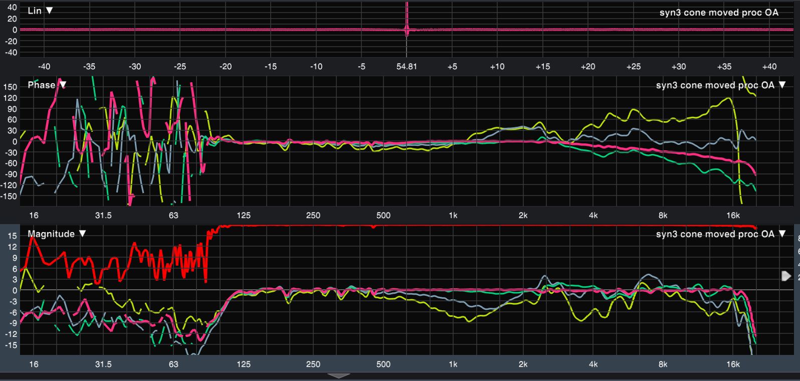

After getting raw responses looking a little better, I tried my old standby proceedure ...try to get near perfect tuning on axis...then see how it holds up off...
Measurement below: red =OA, green 10, blue 20, yellow 30 deg
This is the first time that anything I've done with the synergy attempts sounds more right,...... than "why I am having to fight tonal balance so much, track by track?"..

This is intriguing and reminiscent of problems I saw with a conical MEH about a decade ago. I gave up - and gave up MEHs, as more compex shapes were beyond my skills and budget at that time.
It's intriguing that with the XT1464, the coupling of HF and MF sections to the horn works out as it "should", but when coupled to the conical horn, it appears that the MF section ends up exiting a higher order mode (HOM) of the coupled system so strongly as to dominate the response (if I understand your measurements).
If I intepret post #71 correctly the same HOM appers with both coax CDs. If so, it points to a problem with the horn, perhaps not very different to the one I had long ago, before I'd read Earl Geddes' work on the subject.
The "fundamental mode" time delay should not distinguish the two acoustic sources within the CDs (since they work as expected on the XT1464), so the delay may be assoicated with an HOM in the conical horn (+CD assembly).
That you see an extra ~10cm of path length for the MF section, and the large coupling factor suggests a relatively low-order HOM. On the other hand, the frequency response "wiggles" in the 2-3kHz range, taking all your plots in the thread into account, are less than I (perhaps incorrectly) would expect from such a strong HOM.
It's also interesting (and a bit surprising) to see how even a small volume of foam pushes the HOM down enough such that it is no longer dominant in your measurement.
