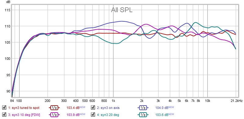

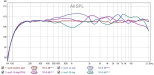

Yes, that was a result of using averaged measurements at 0,10,&20 degrees for tuning, and then measuring the tuning result based on the averages at 10 degree.
Below is an All-Spl graph that shows that previous trace along with measurements at on-axis and 20 degrees.
See all the crazy waffling around 1k ?
The orange-ish trace that is nice and flat, is a tuning to 10 deg using only the 10 deg measurement. But that tuning makes the pattern wobble even worse at on-axis and 20 deg.
Completely agree that the trouble is.."with conical horns we can build" .....

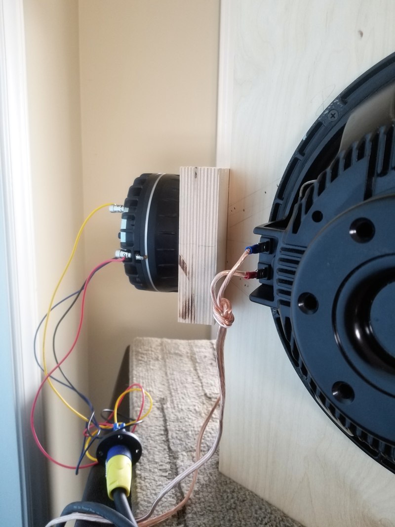

I started by just measuring the 4594he all by itself, no horn.....like Art suggested earlier.
and damn, looked very much like when on the 60x60 and 60x40 horns...not much difference...not good !!!
I'm like yikes, better check this on the XT1464. Which checks out very nicely, just like I'm accustomed to measuring.
So I'm getting really suspect of the simple conical horn hookup with the CD.

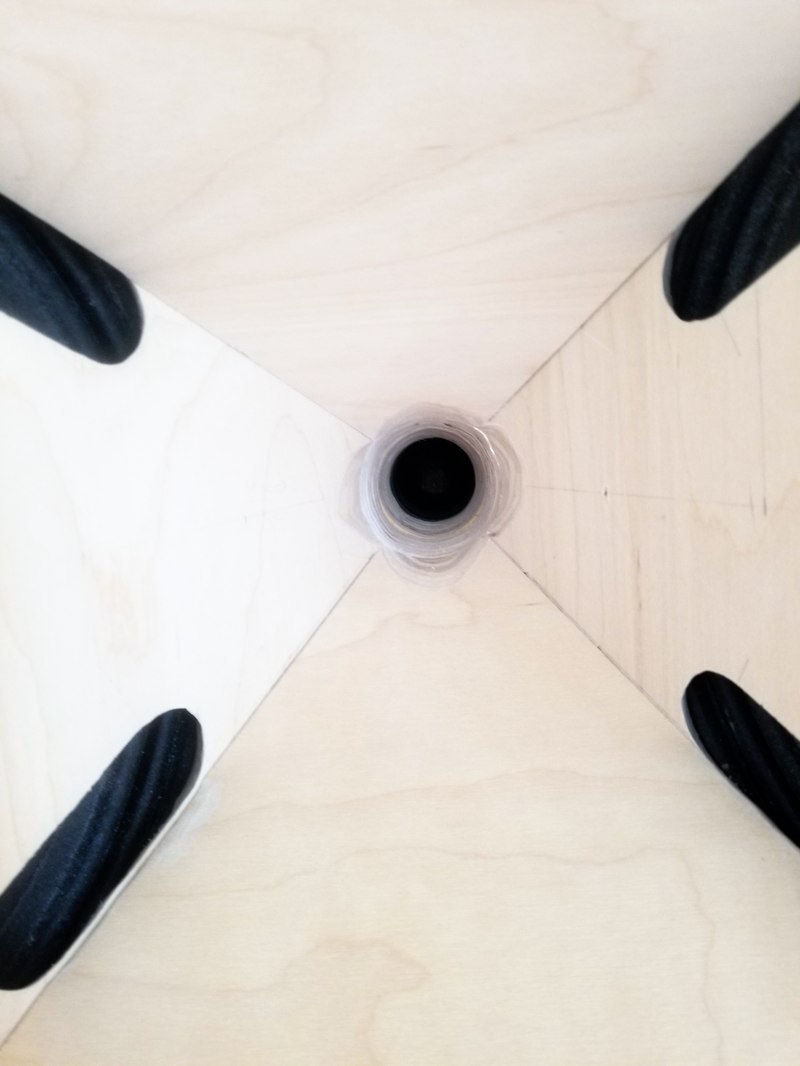

Decide to try to replicate the xt1464 for the first inch and half, and try to mate that to the 60x60 horn.

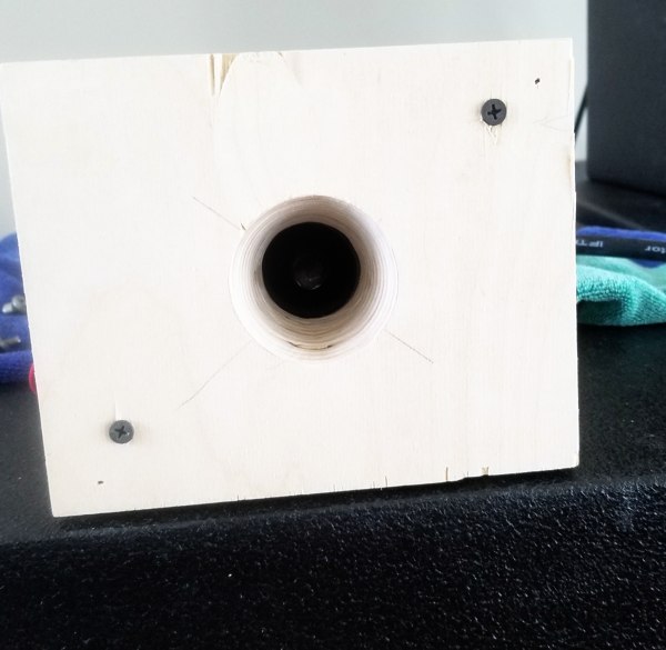

Took two 3/4" pieces of BB and contoured them to match the xt1464 as best I could.
Made transition plates so to speak.
Had to cut the apex of the horn down..BWaslo's killer spreadsheet told me how much to chop off when I changed the square opening size to match 1464 with room to round out corners.

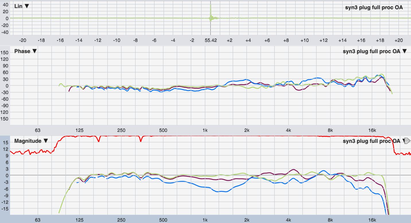

It works, no more pattern flip flop. No more wtf is wrong with what I'm hearing...
It was only a quickie attempt, more careful matching has to help. I'd like to go to maybe 2.25 inches of matching the 1464, but the horn walls using 12mm BB are probably too thin to allow roundover matching.
Here's one place going straight to 12"s at 500Hz helps...gives room for the transition plates.

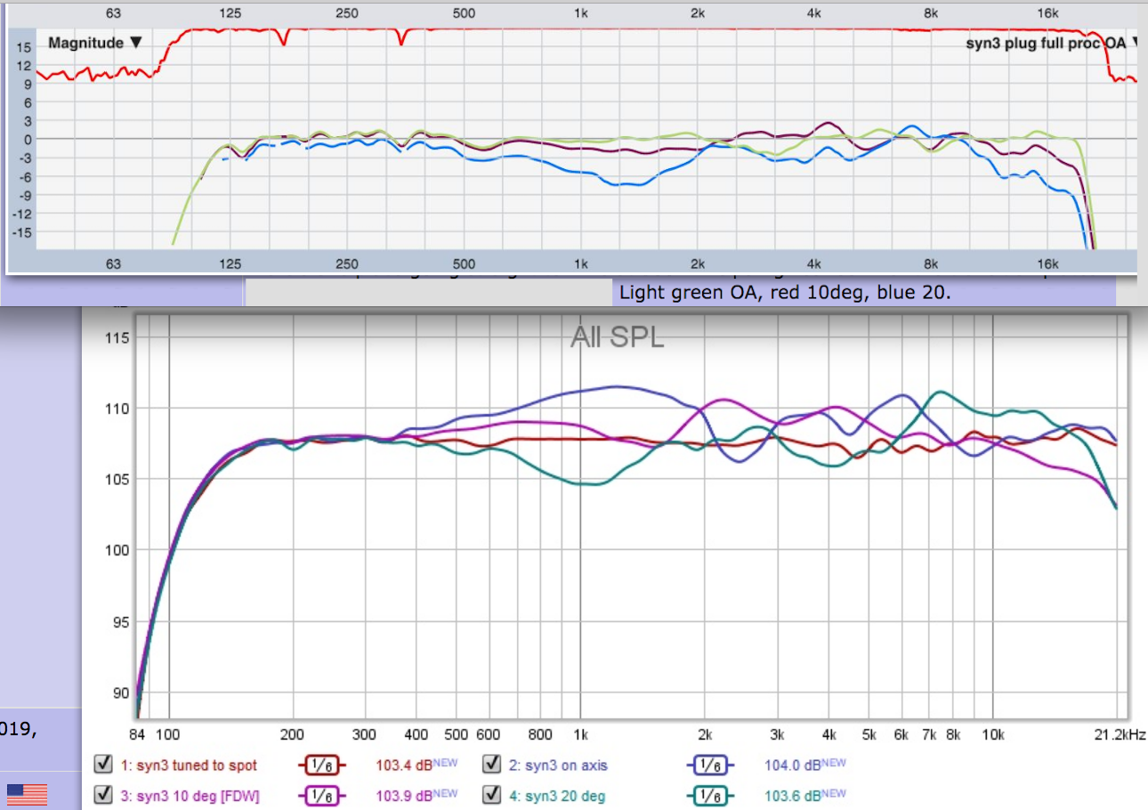

Anyway, picts and a quick meas below. Light green OA, red 10deg, blue 20.

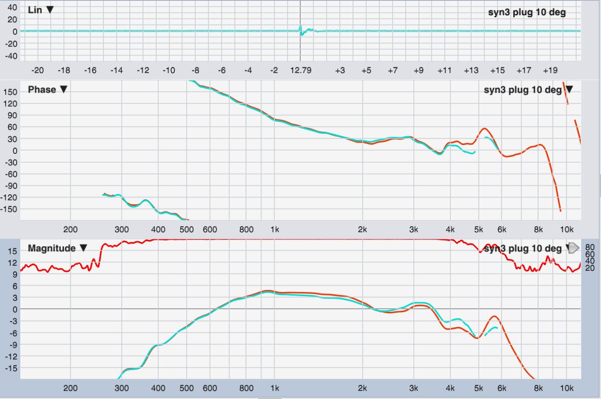

It appears to me that your change of vertical resolution and from log to octave has done more to reduce "pattern flip flop" than the transition plates ;^).
The transition plate measurements still show as much as +3 dB at 10 degree off between 2.5 to 5kHz compared to on axis, if anything, a bit worse. It's possible adding a secondary horn break will help the 1.25kHz "waist banding" seen in both the before and after throat plate transitions. Speaking of which, the XT1464 horn profile on their spec sheet looks to reduce the throat to only about 1/2 of the driver entrance, while yours seems nearly 1.4" wide throughout- what do you measure each restriction to be?
It is much easier to look for polar response problems if the on axis response is equalised flat- then one simply looks for deviations in off-axis reduction at each interval, ideally being uniformly -6dB at the initial conical wall angle.
Also, 5 degree increments are helpful, a lot of junk can hide at -5 and -15, and measuring to at least 5 degrees outside the nominal pattern yields important information.

Hey Art, decade, octave, 1/3rd octave.... they're all log, eh? ;) Just a bit different log scaling, one of the hazards with going back and forth between REW and Smaart I guess...
I'm still in the proto-exploratory stage, will get to 5 deg work (and verticals) when I move back to the larger horn and do careful transition matching.
Maybe the bit of measurement I showed doesn't look like much of an improvement to you, but it was a nice step forward to both my eyes and ears. The measurements were just a quick on-axis optimization to see how some polars look.... something i couldn't even attempt to do before using OA as the optimazation base...
Lot's of work left to do with better transition matching and processing tradeoffs.

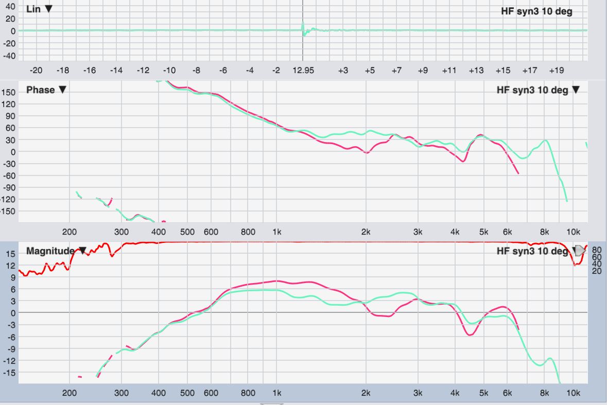

Below is a set of raw HF traces before the transition plate, and second after. Red = OA Aqua = 10 deg
With the plate, measurements between +/- 10 degs are essentially the same as OA. And the dip above 2kHz definitely reduced. To me,it was a nice improvement.

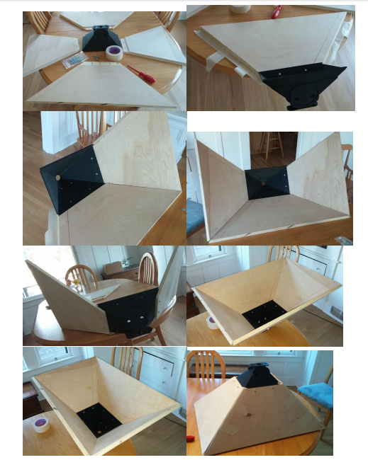

An early assembly test -- I got the edge-meeting angles wrong on the wood panels (dumb math error), but the idea still works.
This is the final version (two printed, never tested, still sitting on a shelf in the basement)

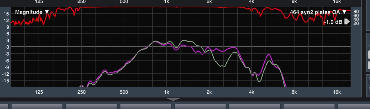

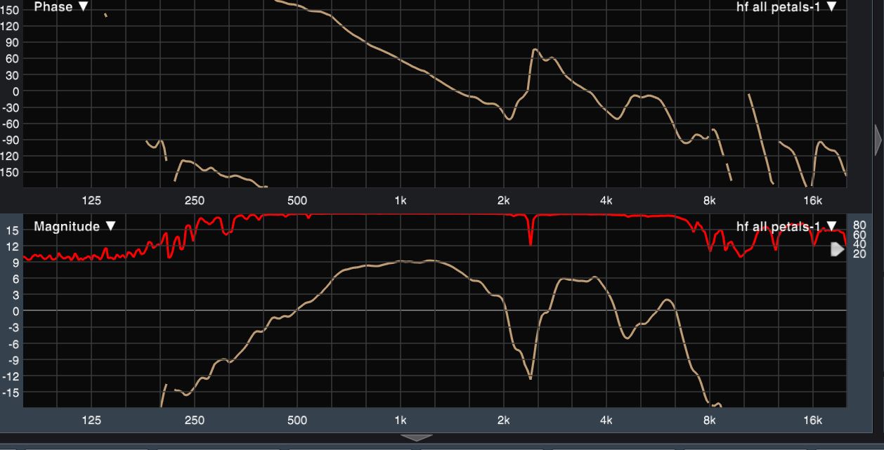

For example, the first yellow/orange trace below is with circular petals attached to the mouth of the 60x60, at the same flare as the horn. Look at the crazy dip at 2.4kHz. I was just spit-balling stuff.
I took the 60x40 apart, cutting back the apex, and fitting it with CD exit transition plates that worked well for the 60x60.
The plates didn't work nearly as well for the 60x40. So I tried the foam triangles/trapeziums. (Thx again freddi and billcowan, any further info appreciated...)
Anyway, the foam out at the mouth helps. But only on the vertical walls. They hurt placed anywhere on the horizontal walls.
Second trace is the dcx464 CD on the 60x40. yellow is without foam, and then with foam is purple. Learning, but damn these synergies are touchy beasts...
