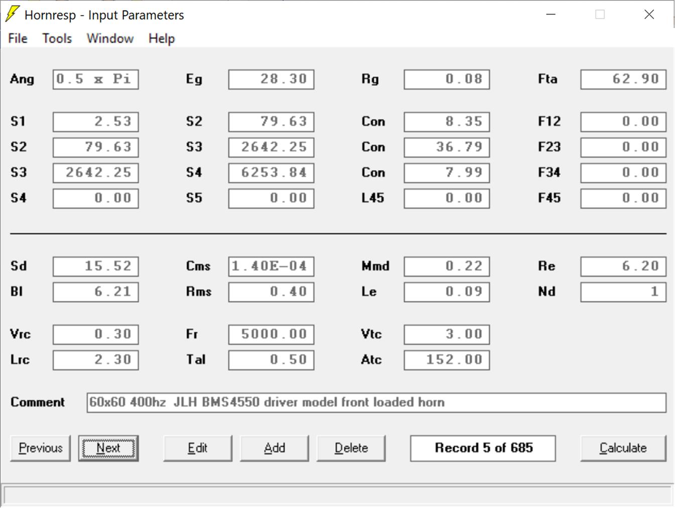

One question about modeling directivity for a single section conical Nd, what kind of driver/parameters should be used? Or maybe, what do folks use for a compression driver. I've read TS parameters don't really apply, so I'm guessing there is a set of plug-in guesstimates folks use?
I just change the "OD" to "ND" and then look at the Polar Map normalized. If I want to look at the other charts I use HR's equalizer to get a flat response. You don't care about the driver's response in this sim, you just want to see the directivity.
Well TS params do apply for CDs; they are just hard to get. I pulled these out of an Akabak script posted by JLH back in the early days of DIY synergy.

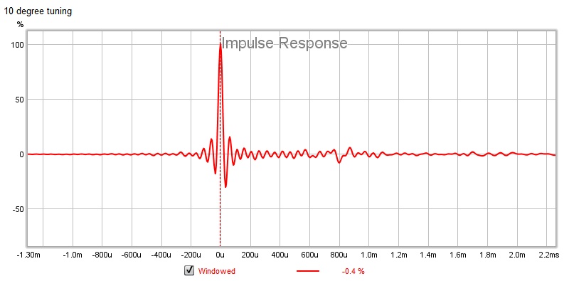

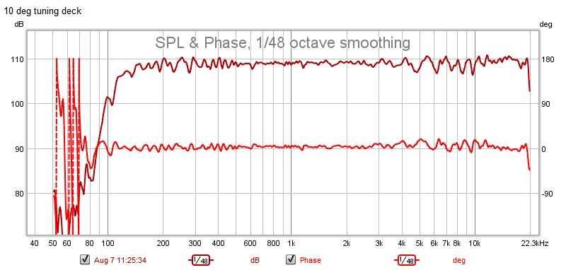

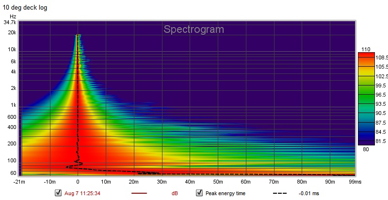

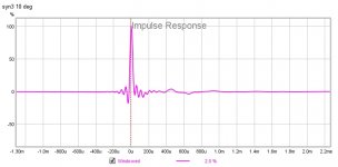

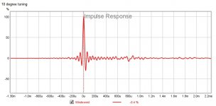

update:
Decided to go with best port configuration found to date, and build a box around the drivers that have been open so far. Trying to get ready for adding BR ports to 12"s.
It's been a very different process trying to dial in tuning than previous multi-way experiences.
Normally, I try to nail on-axis perfectly, and then watch degradation occur more and more as off-axis increases angle, degradation that is usually fairly uniform. Fix as necessary....
Not so with this synergy attempt. Off axis degrades more erratically.
I've found it best to use 10 degree off-axis as the center measurement, and then make sacrifice adjustments to help on-ax and way-off-axis.
Different divergence directions from 10 degrees off, heading towards on-axis, than further off.
Every design is diff, huh? 🙂

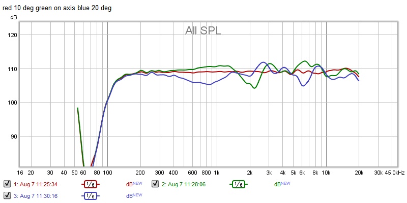

Anyway, below are the 10 degree tuning spot measurements, spl, impulse, and spectro.
Followed by a a horizontal quickie plot : 10 deg, on-ax, 20 deg, ....to show the divergent tuning dilemma.
Feel like I'm getting there, slow but sure . The sound is remarkable, especially given the early state of development. Newly heard details and clarity.
Still alot to figure out with HF weirdness though...

I don't think that is so much a tuning dilemma as a horn issue. I think you made a good choice in that 10 degrees off axis should work well as the center of a listening window. There would be little to complain about in the primary seat even if you didn't keep your head still.
Try a shroud slipping over the front of the horn to implement a secondary flare, as Art Welter did on SynTripP, and things should get better, at least at 1 khz and below. Or try other kinds of mouth treatments. A naked single flare horn mouth, not even baffled, is worst case as I found out to my chagrin.

Mark,
Conical horns do have some drawbacks, but your on axis vs off axis uniformity issues could be due to the conditions of measurement.
What distance from the horn mouth are you measuring at, and what is the axis of rotation?

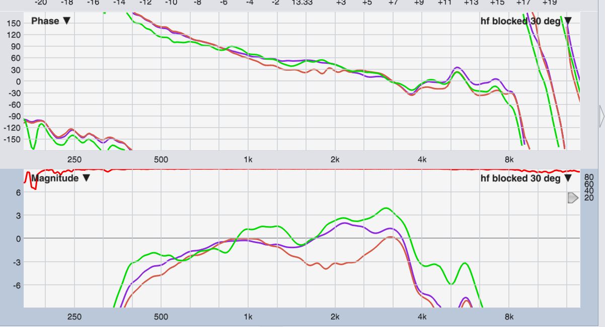

Hi Art, thanks for replying.
So far, all my measurements have been in the 1.5 to 3.5 meters from mouth camp.
1.5 indoors and 3.5 outdoors cause that's how far my mic boom extends past the deck.
At either of these distances, on-axis HF has a big dip at around 2kHz compared to 10-25 degrees off axis.
The only time on axis looks good is with mic in the horn.
Oh, and I should say this is with all ports blocked on the inside of the horn, with 22 gauge sheet steel.
Below is the HF coax section OA red, 15 blue , and 30 deg green: about 4ft from mouth.
What's the best way to measure here? I even built a spinorama for this puzzler 🙂

Best way would be using a crane to suspend the cabinet far from any worldly influence...
It does not sound like your measurements are in the far-field, and your description of your "spinorama" does not explain much.
Regarding your "spinorama"- the location of the horn's apex should be at the location of the turntable (or boom) rotation. That requirement makes turntables difficult, as the horn apex is near the back of the cabinet.
In regard to full range frequency measurements, Pat Brown wrote :
A working “rule-of-thumb” for determining the boundary between near-field and far-field is to make the minimum measurement distance the longest dimension of the loudspeaker multiplied by 3.
He then writes:
It is often thought that a remote measurement position is necessary for low frequencies since their wavelengths are long. Actually the opposite is true. It is more difficult to get into the far-field of a device at high frequencies, since the shorter wavelengths make the criteria in Item 4 more difficult to satisfy.
Item 4:
4. The distance from the source where the path length difference for wave arrivals from points on the device on the surface plane perpendicular to the point of observation are within one-quarter wavelength at the highest frequency of interest (Figure 2).
This is an important distinction between high frequency and low frequency measurement, criteria #4 can be satisfied at 95 Hz for a subwoofer of one square meter measured at one meter, but to satisfy the same criterion for a one meter mid/high horn to 16 kHz would require a very long distance.
All that said, your chosen horn wall angles may be problematic.
Although the 90x40 SynTripP polars for the most part are not as good as Peter Morris' DIY, they don't exhibit off-axis response louder than on-axis as your test unit appears to be doing.
This discussion may be interesting to re-read, now that you are "in the game" ;^):

The near field / far field discussion seems spot on. That's really all i have left to try with this prototype. I'll go out in the driveway, both box and mic on the ground, 8m, like I usually do for subs or larger mains.
I think Pat Brown's point #4, and reflections off the horn walls are in play...hope truly far field solves them.
regarding the spinorama...I anticipated the need for apex at center and built a pretty big one...although I have to add a counterweight to spinning disc's *** to keep it balanced with the horn so far forward
Your memory and ability to recall threads and documents is awesome. Mine sucks. I recalled the SH96HO thread you linked, once I started reading it again. Hell, I even had a minor post in it..
At the time of the thread, I was really new to proaudio and DIY...I was just happy that the PM90 was being compared to the SH96's.
I chose 60x40 because I like 60 degrees keeping stuff off the walls, and I've read Tom Danley say to keep the aspect ratio, vertical vs horizontal, below 1.6x to avoid pattern flip.
So 40 seemed safe at 1.5x
If I leave the 60x40, it will probably be for a 60x60....

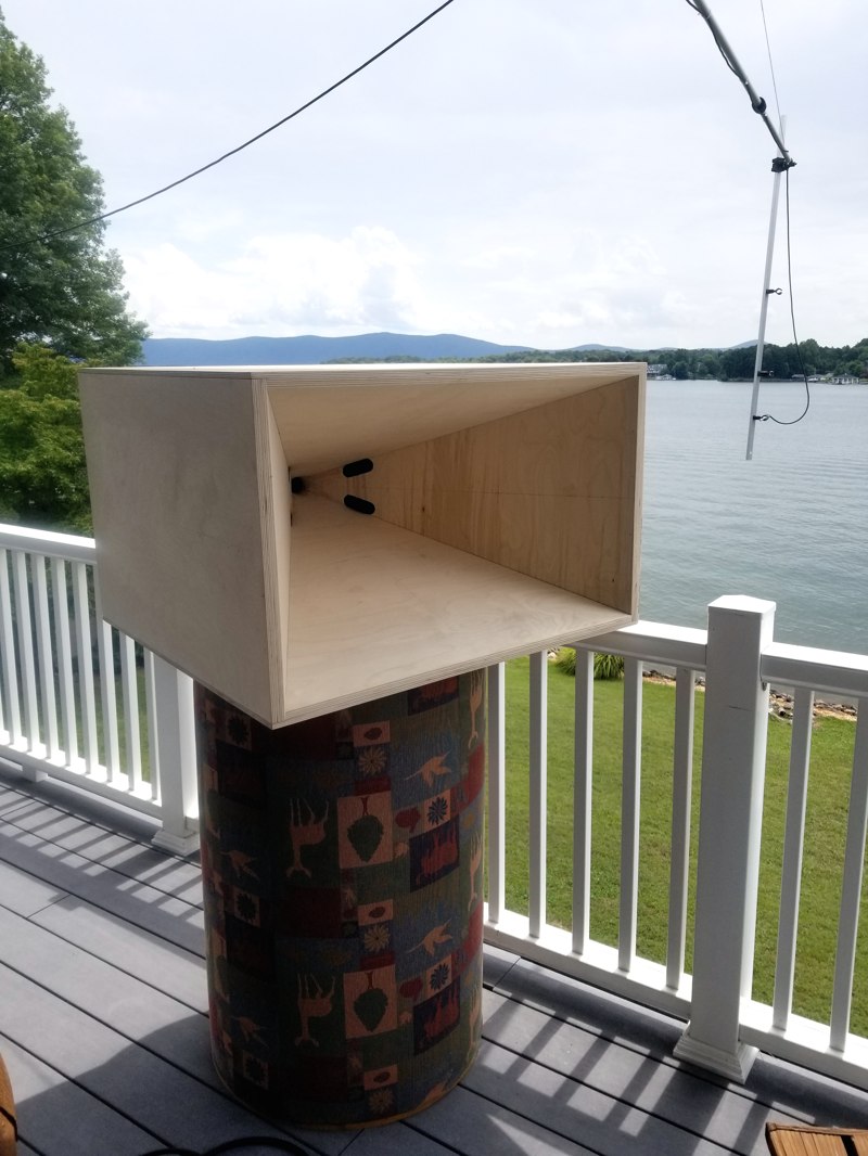

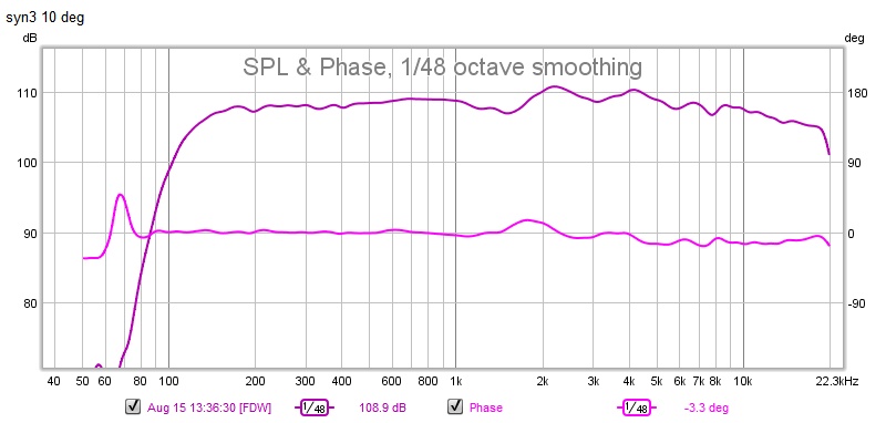

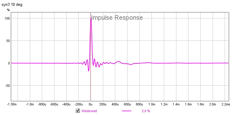

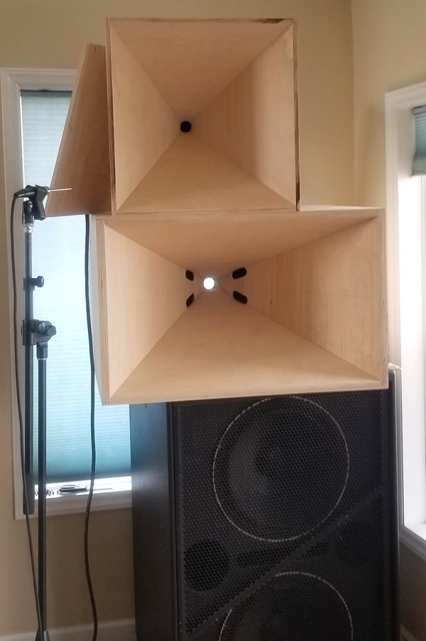

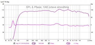

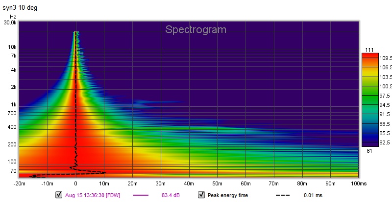

On to prototype #3 ! Pictured below without ports, on top of proto #2.
It's a small 60x60, using the same drivers as before. 4594he, and 2 mb12n351's.
I got proto2 sounding and measuring pretty good, but was troubled by the on-axis hole at around 2kHz, and also by horizontal pattern wavering as shown in post#29.
So I built the 60x60 with no ports, figuring any HF issues with no ports would be due to either:
bad CD exit matching,
mouth termination,
or the plain nature of square sided conical horns.
The hole at around 2kHz remains and so do the pattern issues.
I very carefully matching the CD's round exit to the square throat, so I think I can scratch that from the list of possible causes.
I can't rule out mouth termination, especially given the straight flares without any secondary flare, but i did attach some extra wings that didn't have much effect other than creating even more issues.
So I dunno...does anybody think a different CD would change things? All I have are the bms..
Anyway, I added the same mid port layout to proto3, and went on to tune the box by making measurement averages at 0,10, and 20 degrees horiz, for each section mid, hf, and vhf. Fairly reflection free off outdoor deck at 3m.
Then measured the tuning results at same degrees.
The best looking measurement occured at 10 deg, shown below.
0 and 20 degrees are a lit worse, but still close.
I thought the outdoor measurements looked pretty good, and set up to listen outdoors with high expectations....
Rolled off the high end a little, like on all designs and then listened...
Sounds like dog poo 😡😛
Honky. Wrong. Even after knocking down the bump at 1.8-2kHz.
Oh well, back to it, sigh....
1) The hole at around 2kHz remains and so do the pattern issues.
2) I very carefully matching the CD's round exit to the square throat, so I think I can scratch that from the list of possible causes.
3) I can't rule out mouth termination, especially given the straight flares without any secondary flare, but i did attach some extra wings that didn't have much effect other than creating even more issues.
4) So I dunno...does anybody think a different CD would change things? All I have are the bms..
5) The best looking measurement occured at 10 deg, shown below.
1) Surprised to find the two horn geometries would have the same frequency "hole".
2) Agreed, throat anomalies would likely be higher frequency problems.
3) The secondary horn break will reduce "waist banding", which coupled with the 2kHz problems you are complaining about could make for a better overall impression.
4) Good question, it would be interesting to see what your BMS co-ax dispersion looks like with no horn.
5) Hard to tell what you did compared to what was shown at 10 degrees, but that shows a couple upper 3 dB "honks" relative to the downward trend starting at 1kHz.
Oh well- you might be finding out first hand why Keele went from a career in horns to the CBT array ;^).
Art
Oh so that is a result of equalizing to averaged measurements, 0, 10, 20 degrees? My own results with a similar horn tell me that 40 degrees is too wide a span to expect good performance. My own goals were less ambitious. I got good performance over 3 adjacent seats on a couch and declared victory. That was likely just a 10 or 12 degree span.
The trouble is that the conical horns we can build don't control directivity very well and the ones that do, like the SEOS family, are either too small or too expensive.
