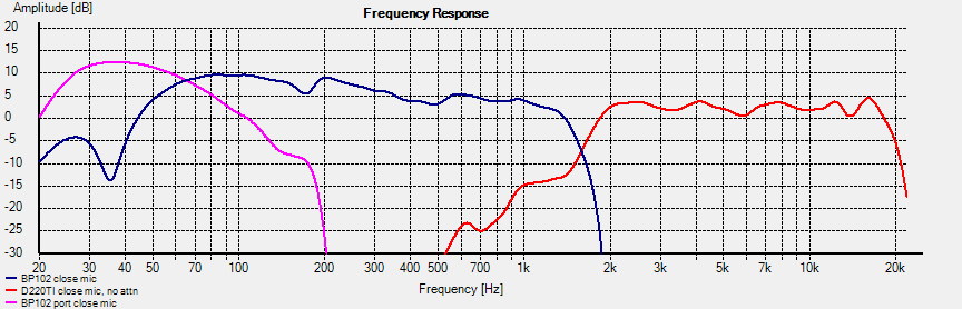

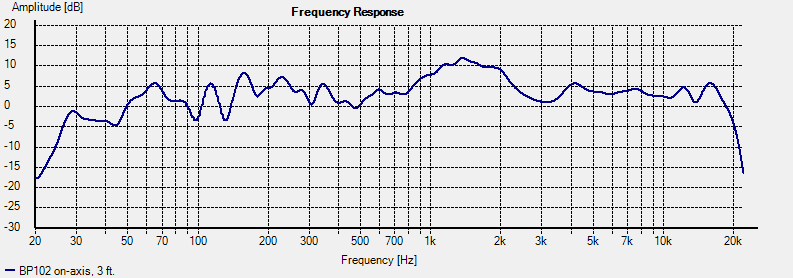

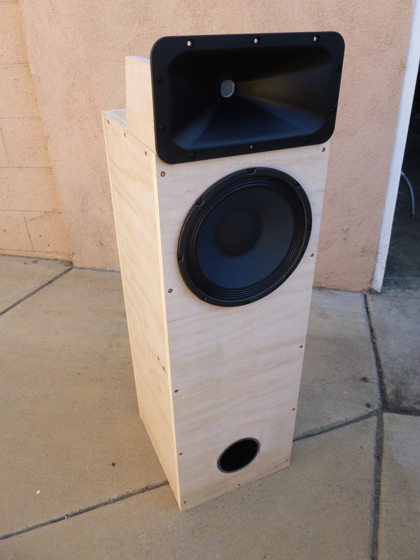

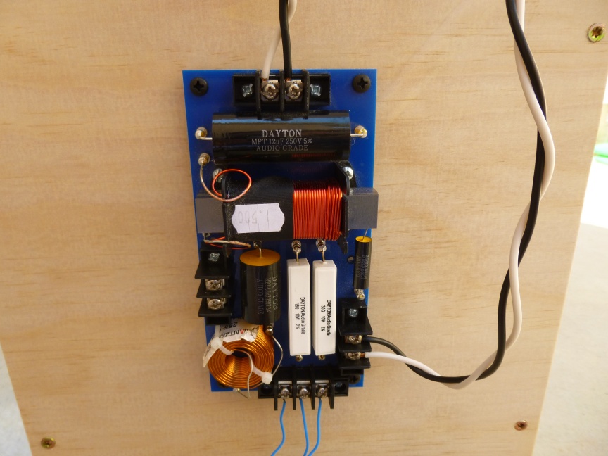

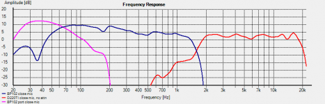

In the mean time, I slapped together a pair of towers with a BP102 and a D220TI driver and Pyle waveguide (JBL clone). Hooked it up to the Zilch/JackGiff low sensitivity generic X/O. Cabinet is 12"(W) X 13"(D) X 34"(H) about 2.3 c.f. with a 4" X 7" port. It sounds better than I expected. It will need some tweaking of course.
kec - that's impressive - what's your compression driver? (- is that the 612 1 3/8" threaded waveguide?)

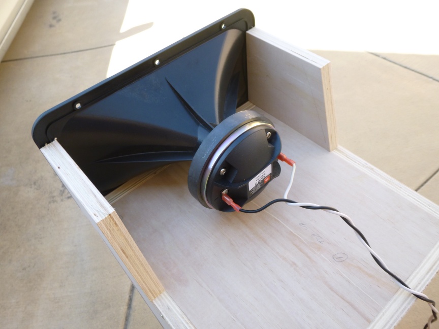

Driver is the Selenium D220TI and yes, the waveguide is the Pyle PH612. I also have the PRV QSC 152i clone I will try.

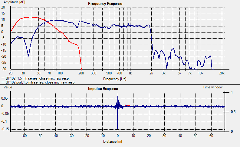

The BP102 is an excellent hi fi woofer candidate that is often overlooked.
It does every thing the Seas does and better at half the price. All you need to do is add a series 1.2 - 1.5 mh series inductor and you have a perfect 18 db/octave roll off starting at 2K. And the BP is DEAD flat below 2K and near zero break up above 2K.

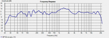

Boy John, you were right on about this. I just tried it with a 1.5 mh inductor in series. Here's what I get...
lookin' good & very promising - and enough lows to give some underpinning to organ, and room ambiance weight (if any in the recording)
Will you build in the waveguides or leave them mostly open kec? The speakers look seriously fun. Would closing them in would help or hinder?
