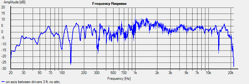

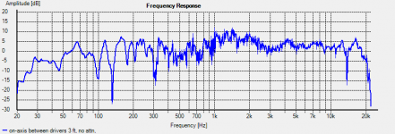

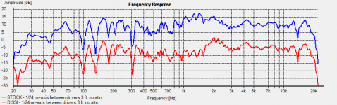

Here's my measurements on-axis 3 ft. from mic. No attenuation on tweeter.
Years ago I measured a stock A25 in an anechoic chamber with a B&K mic and
a swept frequency to a chart recorder. The response was otherwise good, but
there was a deep null on the tweeter axis at the crossover frequency.
Do you get a null if there's no averaging?

Here's the raw response...

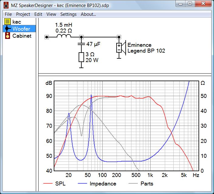

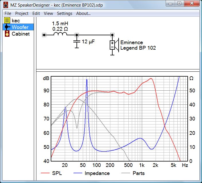

Hi kec,
It's great you are doing a project with the Eminence Legend BP102. Cabinet and port dimensions are excellent, now you only need to get the crossover right and then the fun begins.
According to my simulation, the shunt capacitor of 12 uF in the woofer filter is responsible for the big hump at 1.5 kHz. A series resistor is urgently needed to damp that resonance. I get the best result with a shunt RC in the magnitude of 47 uF in series with 3 ohms.
Just to share my theoretical findings... 🙂

Kec... nice work! Good to see some interest in this much overlooked woofer!
As for your mid band hump.... you can to keep it simple with a Zobel and the inductor, or do the full 2nd order as suggested, or you can get cute and do a B/W spread frequency. I would start with a +/- 15% spread centered on the peak of your midrange hump and see if that sums well. It too may require a Zobel. If that doesn't do the trick, a full +/- 30% spread may be required. Have not modeled it, so just guessing. Funny thing about frequency spreads is in some cases you need to switch polarities. This is usually driven by the woofer - tweeted horizontal offset distance. Will play with that angle once the toys arrive later this week.

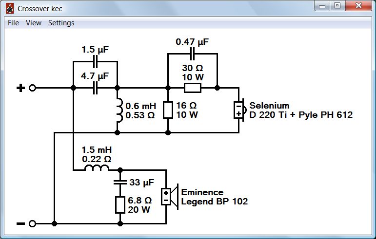

How does the tweeter filter look? Any tweaks needed there?
In my previous post I only addressed the woofer since I didn't model the tweeter section. Of course, the proposed filter modification only works properly if the tweeter response adds accordingly. 😀

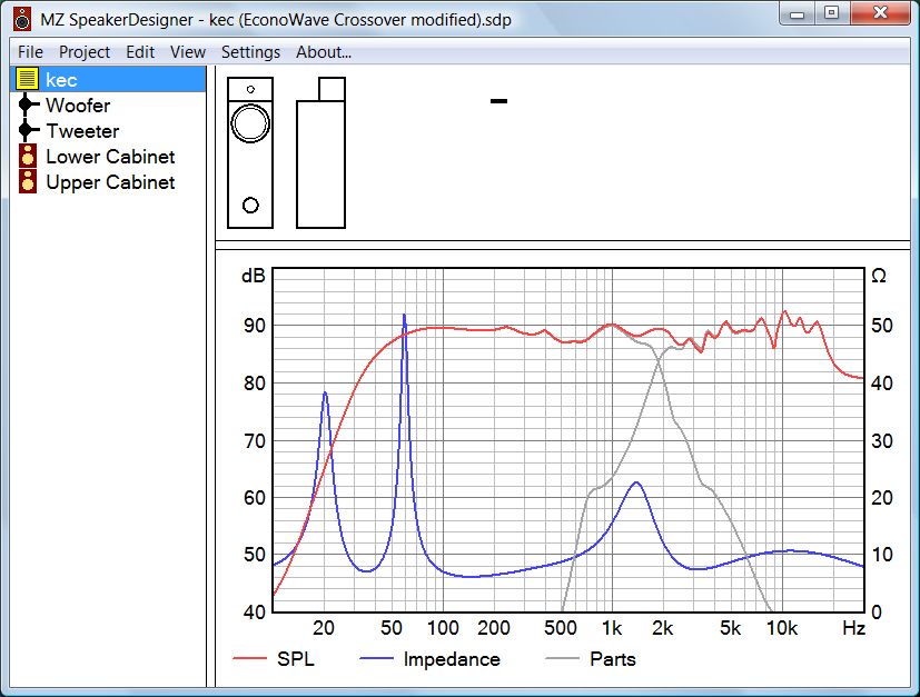

In the meantime I did a search for the D220Ti and PH612 and found measurements published by Gainphile and Ampslab. Unfortunately, the curves differ significantly in low and top end and leave an uncertainty. The modeling of horn loaded compression drivers is also error-prone. So please do not overrate the results presented below. It's just a hint.
Anyway, modelling the complete speaker showed quickly that my first proposal creates a dip in the crossover range because the tweeter response falls too steeply and phase does not match either. Therefore, the shunt RC had to be adjusted and is now 33 uF in series with 6.8 ohms. Interestingly, these values are exactly those of a zobel, what John Busch has proposed as possibility.
In the tweeter section there's only the option to increase the capacitor. The value mainly affects the level at 3 kHz. With 4.7 uF I get a dip of 3 dB there.
Hope that helps and good luck. 🙂
