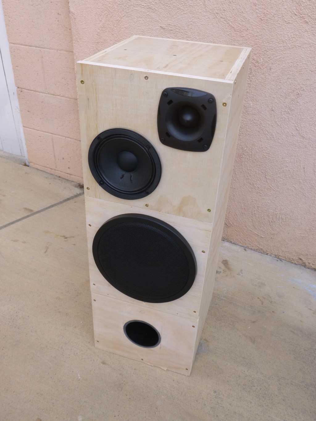

After enjoying the BP102 with the Dayton D250P/Pyle PH612 waveguide for a while, I decided to modify the mid/high end of the speaker. I read Adason's post on the Faital 6FE200 + Selenium ST200 and I decided to try it.
Adason's post is here: 6fe200 + ST200
And my post: http://www.diyaudio.com/forums/multi-way/282141-6fe200-st200-4.html#post5310845

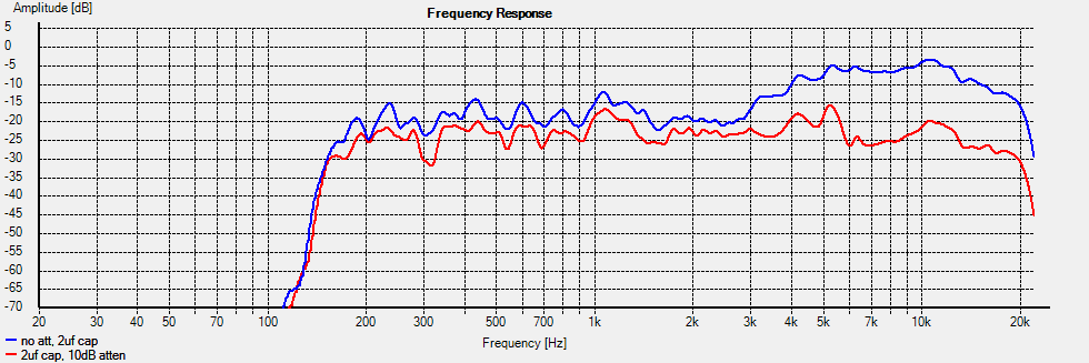

Here's my take on Adason's design. About the same volume as Adason's in a sealed sub-enclosure in a vented enclosure. Paired with my favorite 10" woofer - Eminence BP102.
The 6FE200 is an excellent sounding midrange. The ST200 adds a nice amount of sparkle, even though the sensitivity is much higher than the Faital. I've played around with the attenuation of the tweeter and do like it better toned down a bit. I have an L-pad on the ST200. Measurements attached.
