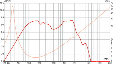

. And it does have a nasty 6 db break up around 5K that is only 6 db down from the drivers native 89.5 db/watt out put below about 2K.
the A26 issues are centered at 4khz, not 5khz.
I think the A26 woofer needs to be listened NOT on axis. The A26 without LP needs to be seen like a fullrange driver and listened off axis. That way, 5khz is 15 db down from 2khz, 20db down at 6khz compared to 2khz.
but even on axis, I dont understand how you reached that 6db down figure at 5khz vs 2khz. my measurements (and those from seas) shows that on axis, 5 khz is 12db down vs 2khz.
the issue on axis arise at 4khz, where on axis at 4khz we are barely -6db from 2khz, so 1st order roll off. however, off axis of about 25/30 degree, this easily tame the 4khz break up and its down 10db at 4khz vs 2khz.
Not sure what you’re talking about here.......that bump at 3.8khz is barely a blip on a radar relative to the fundamental and hardly constitutes calling it a breakup. Listening off axis won’t make a difference......at that point the tweeter is near Omni and a summed response and the phase wrap is minimal.
