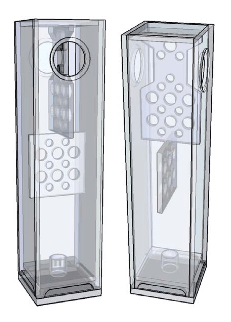

Virtually all the stress is vertical, so a ~ 56*0.707 = ~40" x 1x 3-4 board mounted on edge vertically and offset both vertically, horizontally using one of the ratios on the sides, back suffices. The top should have either a same-same board brace or double panel like on the bottom. A front/back brace tied to the top, rear brace, bottom plate and scalloped such as to allow preloading the woofers finishes it off plus doesn't reduce the cab's net Vb as much as typical 'holey' braces, not to mention much lighter too. 👍

Picture pinched from the microTower planset, you can see the 2 braces. The boxes are small (7x7x30 external) so we get away with this scheme.
The braces run the same direction as the line. The holes are not necesarry from the TL part of the box but they complicate things for shorter frequencies that you would like to spend more time in the damping.
This also means they will follow the criteria of the subBrace having a higher aspect ratio than the panel it braces. And you want to avoid subPanels with equivalent sizes , sio first brace off centre.

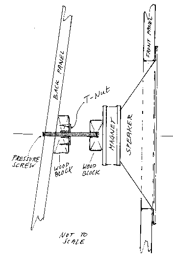

Your big box will likely benefit from full-height braces. I like to brace thedrivers to the back of the box. This creates an i-beam like structure, greatly strengthening the baffle and distrubting energy that would light up a resonance to much more material. (i have a ton of drawings, and likely some better visualizations)
This is not a TL but it could be if it 2-3x taller, the braces would extend, would not impeded the TL flow, terminal at the bottom. Perhaps a bit overkill on this one (they are making it out of RichLite).
This seems to be an accepted practice. Two panels equals twice the mass but much more than twice the stiffness, so the resonance goes up in frequency.

In bracing the drivers to the back of the box are we looking to straight wood on magnet, or some sort of buffer between like 1/4” butyl rubber? I’m assuming the tension shouldn‘t be much more than a static fit?

With that small contact patch seems to me it would turn the back panel into a passive radiator of sorts?

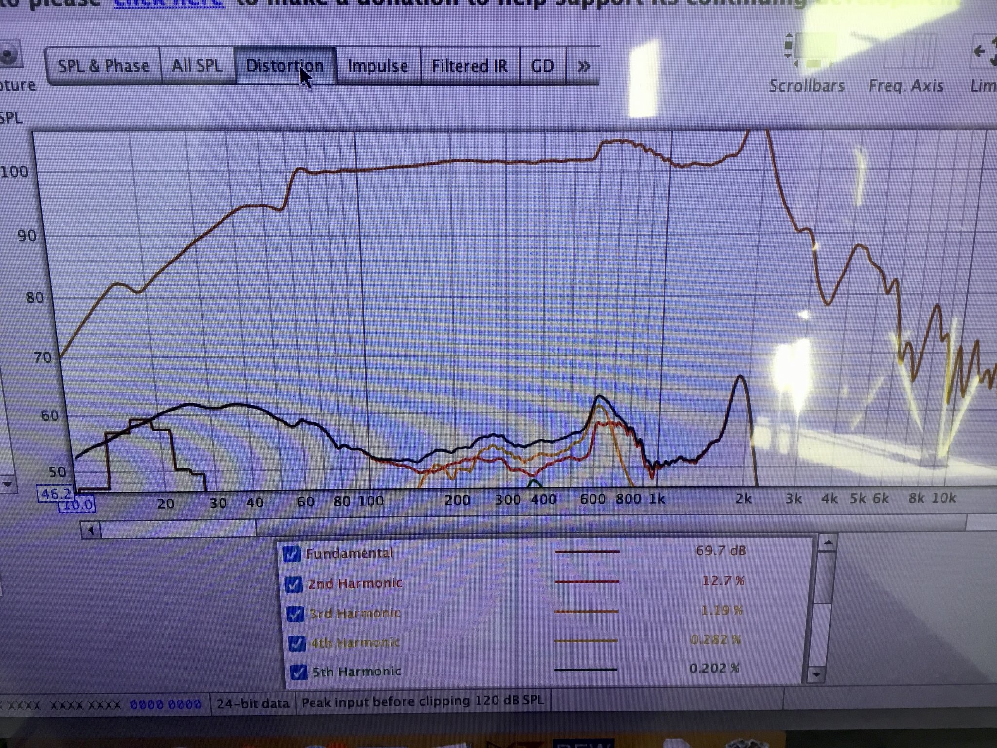

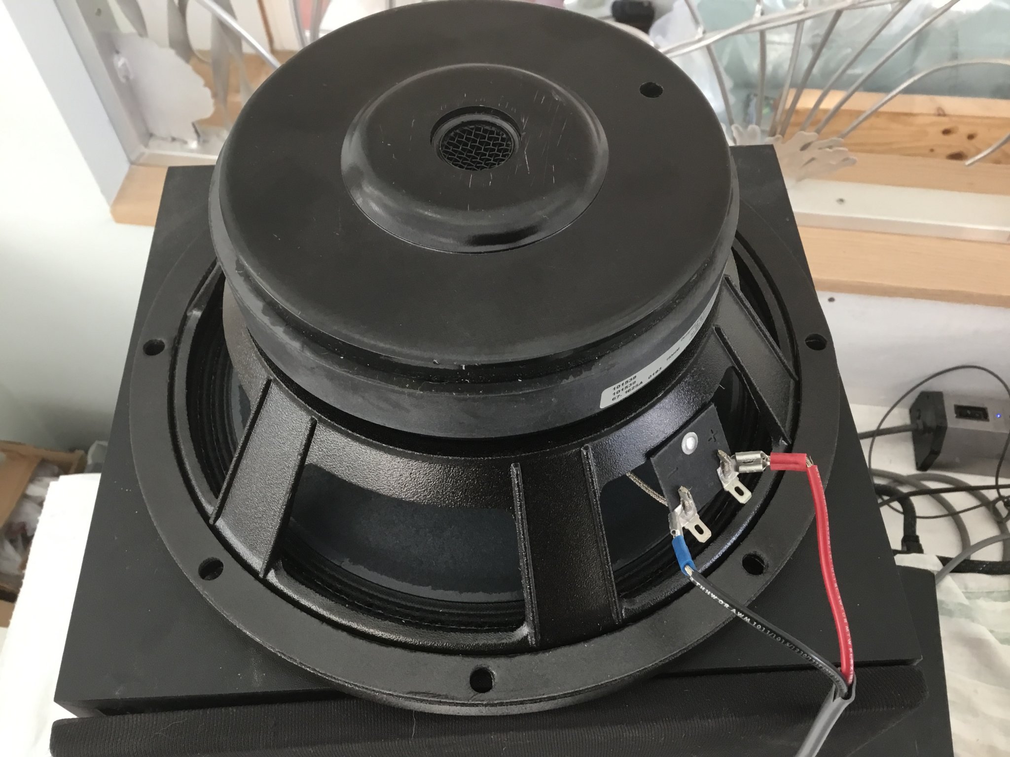

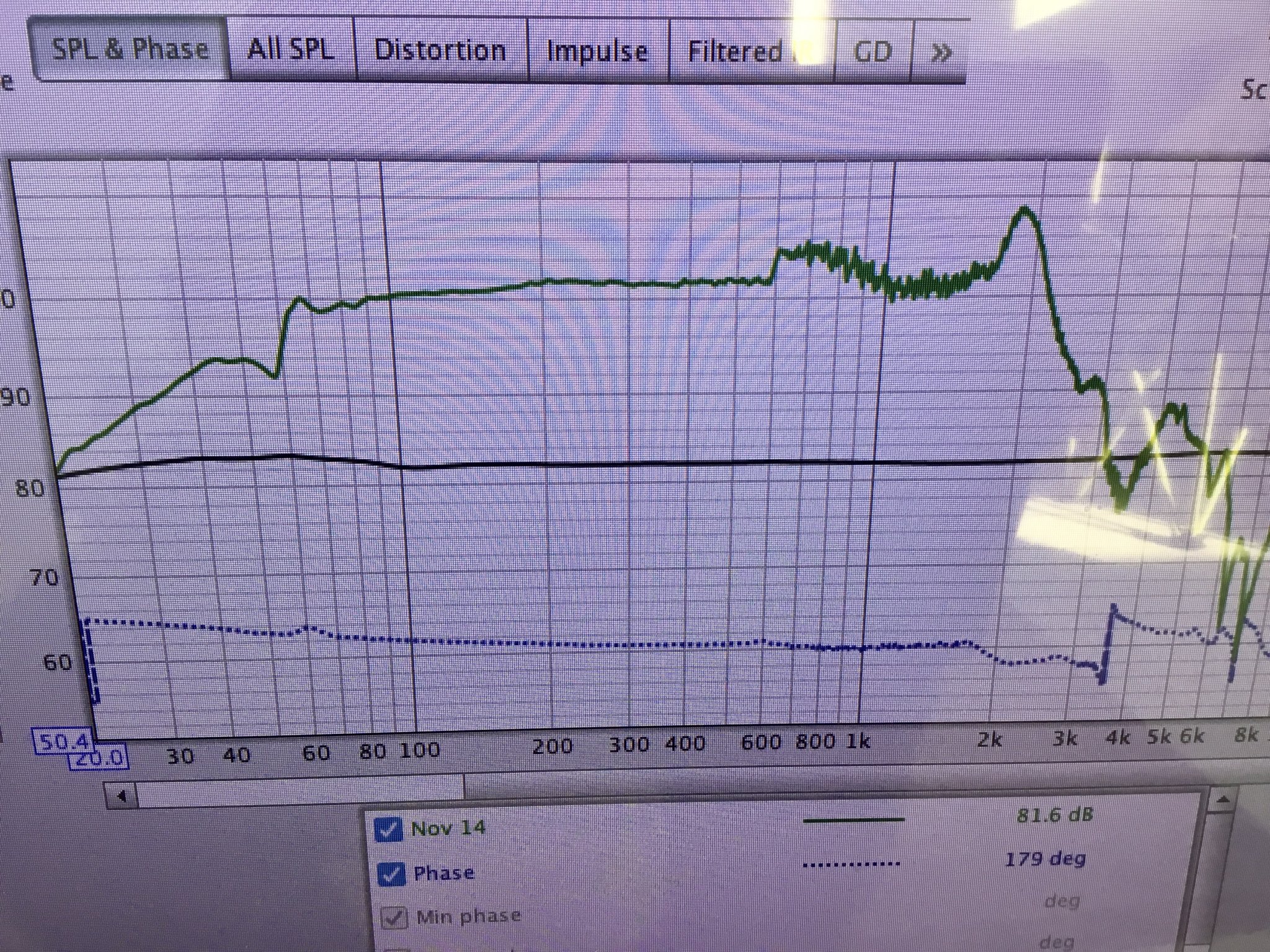

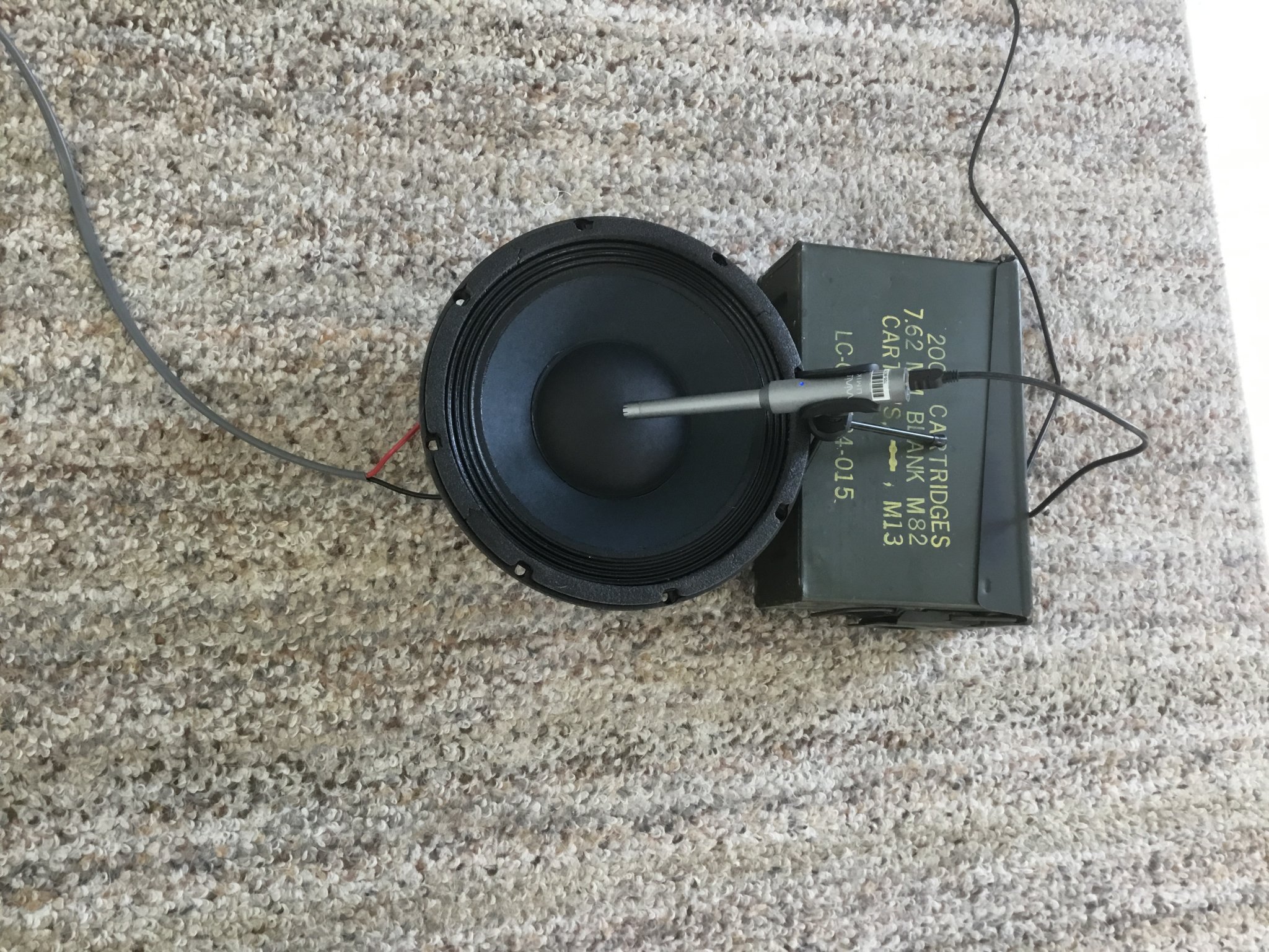

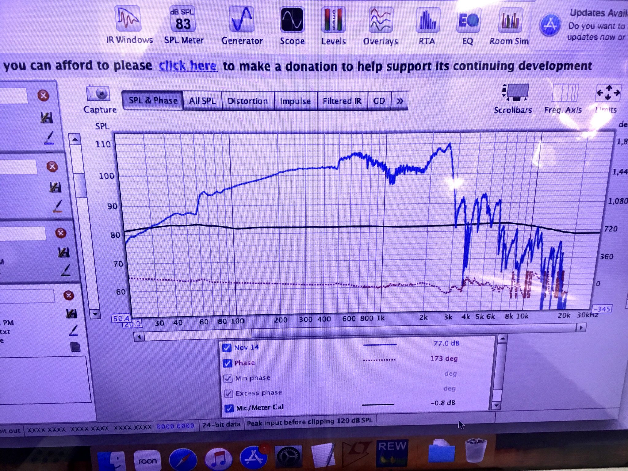

Heres the driver in question, there seems to be a 6db void between 50-60hz, ive included a pic of the measurement set up (its the best i could do with what i had, i‘ll get a better tripod soon) measured 3 times and it overlays the same.
Is this going to be a problem for the MLTL ?
and also is that hash above 600 going to be a issue, i planned on crossing at around 1.2k ?
