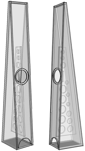

I’ll ask again…….is there anyone who can please help me come up with a box that might allow me to get into the f3 of 30/low 30’s range (giving some semblance of quality) with two of these 10” drivers per box?
GM mentioned expanding taper line would be best but size prohibitive……..is this the style mentioned ? (screenshot is from troels website, i dont guess it’s copyrighted?)
or if this is not going to work with these drivers and not a good idea, please say so……no hurt feelings here i’ll just use them sealed w/sub
Depends on the driver's specs.
Yes, that's a parabolic (expanding) horn.
I posted based on the delta 10b specs and just assumed the custom's specs wouldn't 'swing' it back enough to be a different flare type.
Any driver can work in a TL, though may not meet all your performance goals, so being a custom driver, please post specs.

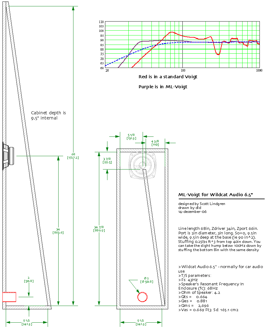

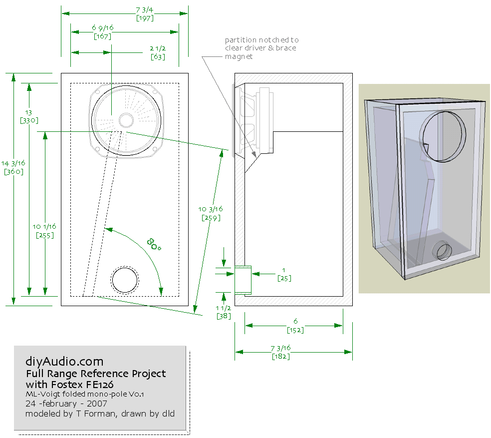

That is a common way of doing that. Also:

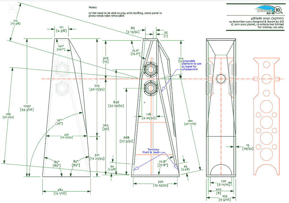

ML=Voigt in the back, aperiodic midTL up front:
Metronome
I am sure wilder configurations could be conceived.

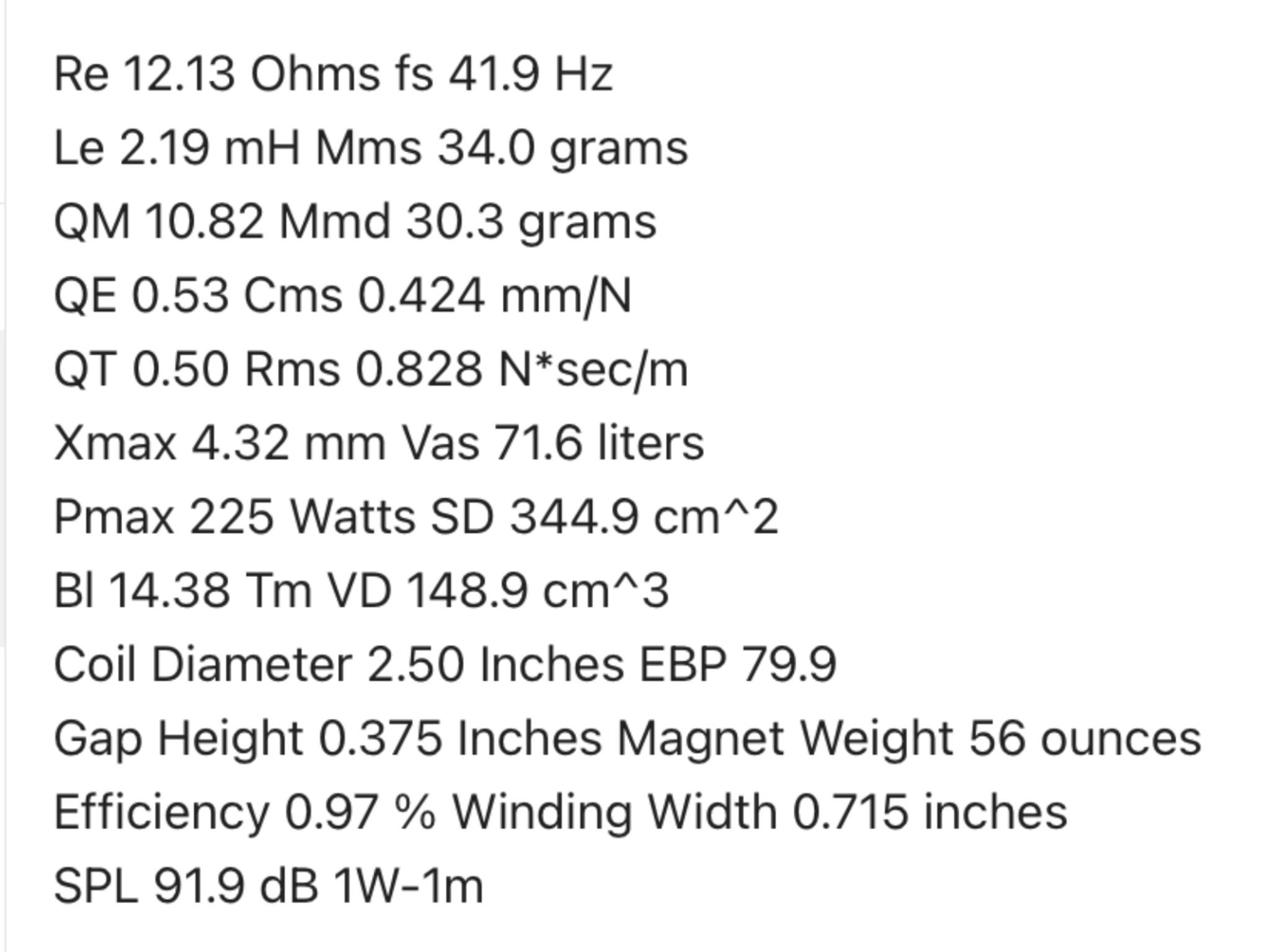

Thanks GM, specs were in the first post, and yes I believe they are different enough to change things……see pic below.

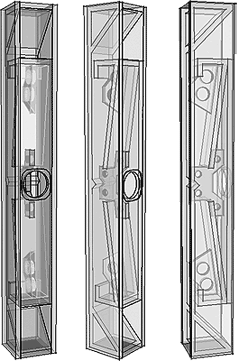

Thanks Dave, going for the simplest shape possible……exterior dimensions 14”w x 16”d x 55” h +/- (mtm horn centered on 38” height) these dimensions can vary except for exterior width (for 12” wide horn) and the 38” horn center height.

Brain 'fade' :headbash: Those are the ones I used to ~ calculate size.

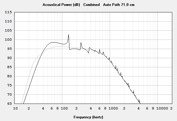

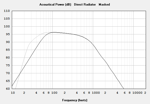

OK, a ~32 Hz Fb max flat MLTL (no fold) power limited to ~15 W below ~90 Hz with 38"/floor = 58.25" o.d./56" i.d. tall based on 0.75" panel thickness, width x depth = ~408.5"^2 i.d. = 18" i.d. square, so way too big at ~376.4 L net.
Shrunk to your max 14" x 20" o.d., Fb = Fs, power limited to 35 W, ~213 L net, vent = 8" dia. x 1" long and instead of a flat response, it sims a 'toe tapping' party speaker with a ~50 - 150 Hz +3 - 4 dB boost shelf.

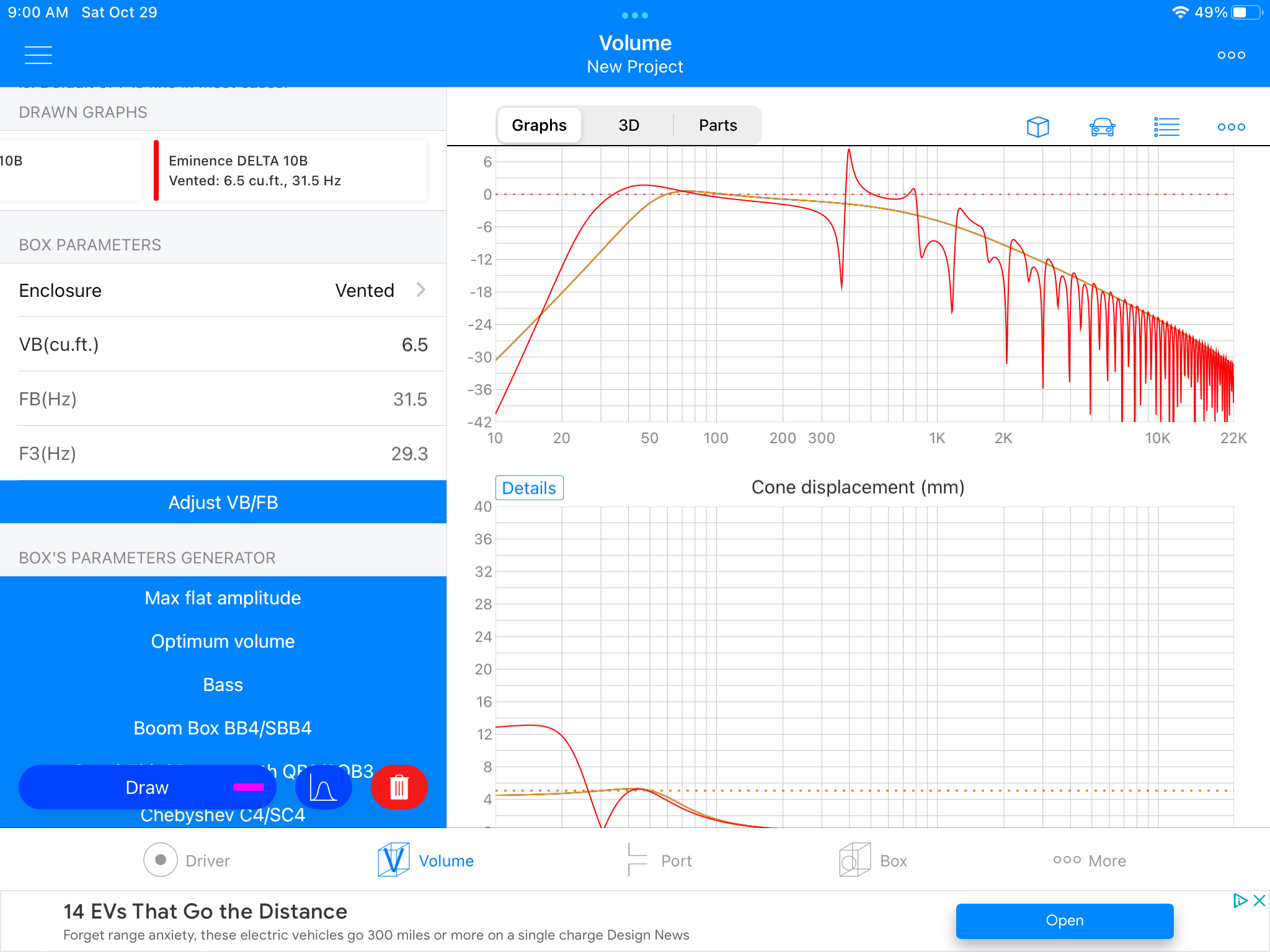

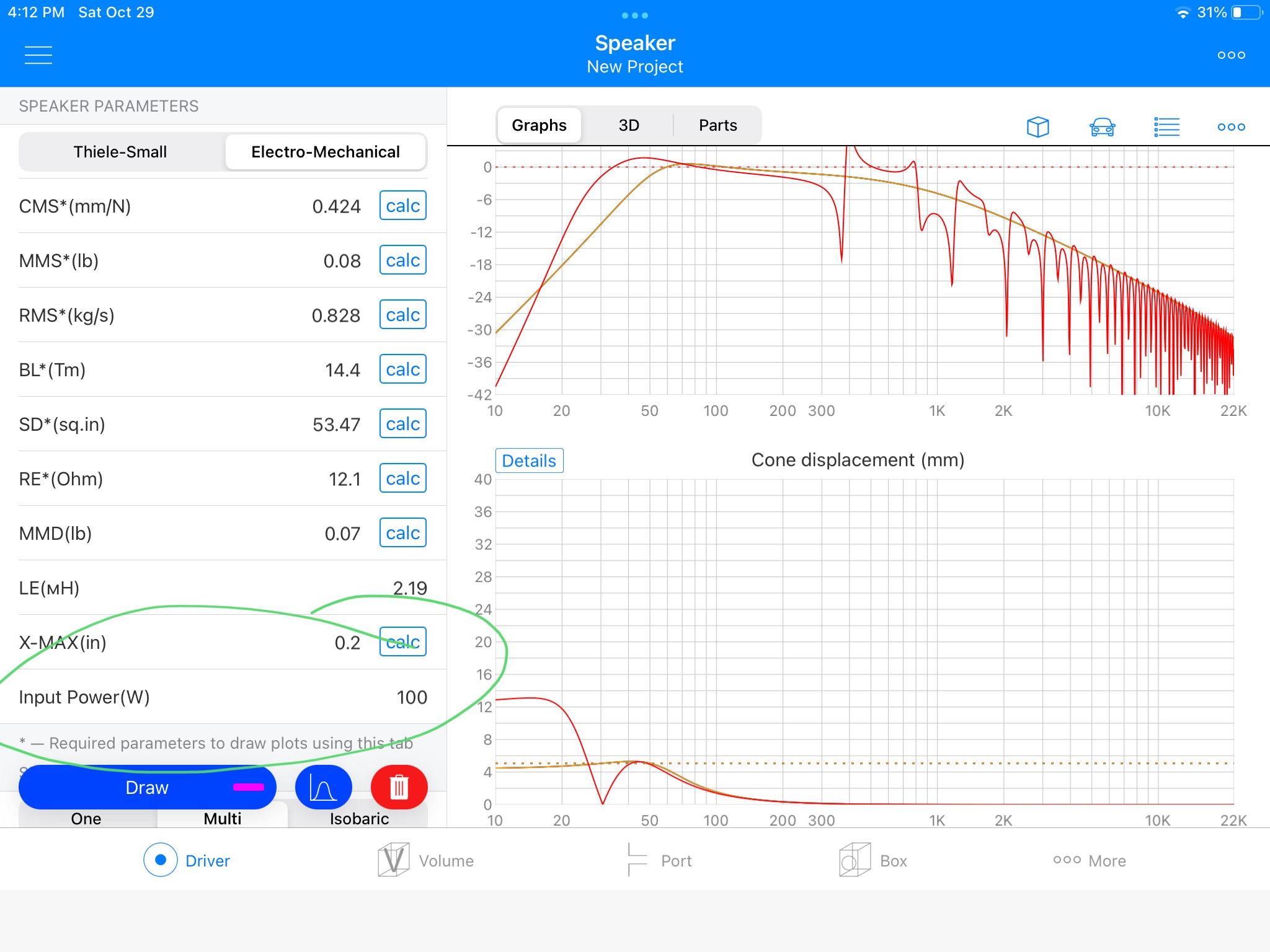

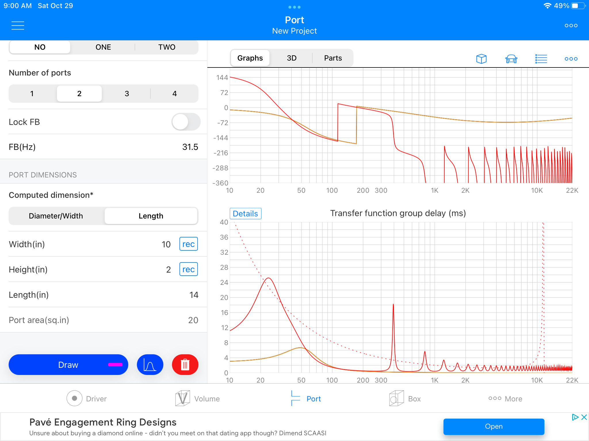

So no beuno on the TL, heres what i come up with in ‘speaker box lite’ for these 2x10” @ 100w in a 2.8 cf sealed (yellow) and 6.5 cf slot ported x2 (red)……these are the best alignments I could come up with, am I in the ballpark?

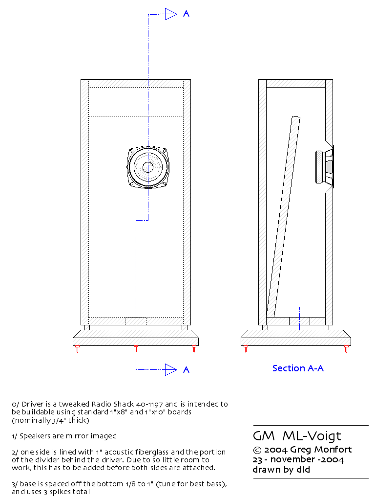

edit; Just curious, is the GM ML-Voight plan that Dave posted above yours GM?

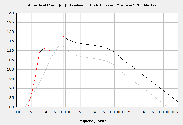

No way these are at 100 W! The sealed is ~7 W and the vented is the same as the MLTL, ~35 W; can't fool Mother Nature, so not many 'free lunches' in speaker design.
'in the ballpark' in what way? I mean there's nothing intrinsically wrong with them if they meet the needs of the app, otherwise both are too under damped for HIFI for most folks.
Yes, that's my ML-Voigt/MLhorn prototype I cobbled together for one of the long gone Atlanta DIY Meets that local (still active) member Woody took home and IIRC the driver was 'stitched' by Dave. It caused a bit of a stir overall as I don't think anybody that didn't know me believed it was an 'el cheapo' RS driver nor full of internal EQ frequency shaping filters due to its smooth, yet uncharacteristically 'fullness' down in the mid bass as at the time nearly all the attendees were Peeee Eeeee forum members with little/no exposure to MJK's TL docs yet.

GM there‘s no input for driver height on that calculator l know its not exactly pro status but i was under the impression speaker box lite was fairly accurate? 100w was entered (see circled area in pic)

I'm not familiar with the program, just know what you posted is misleading at best.

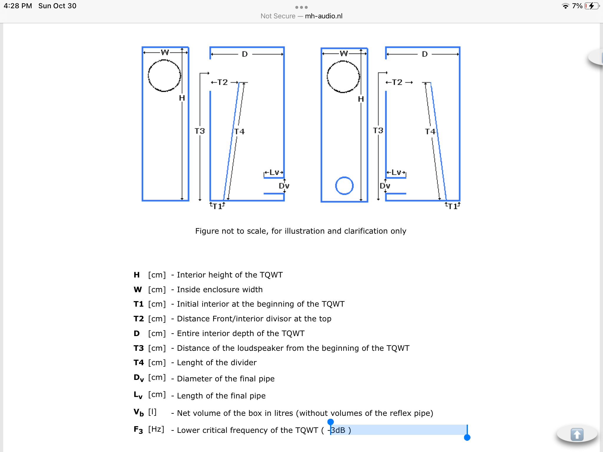

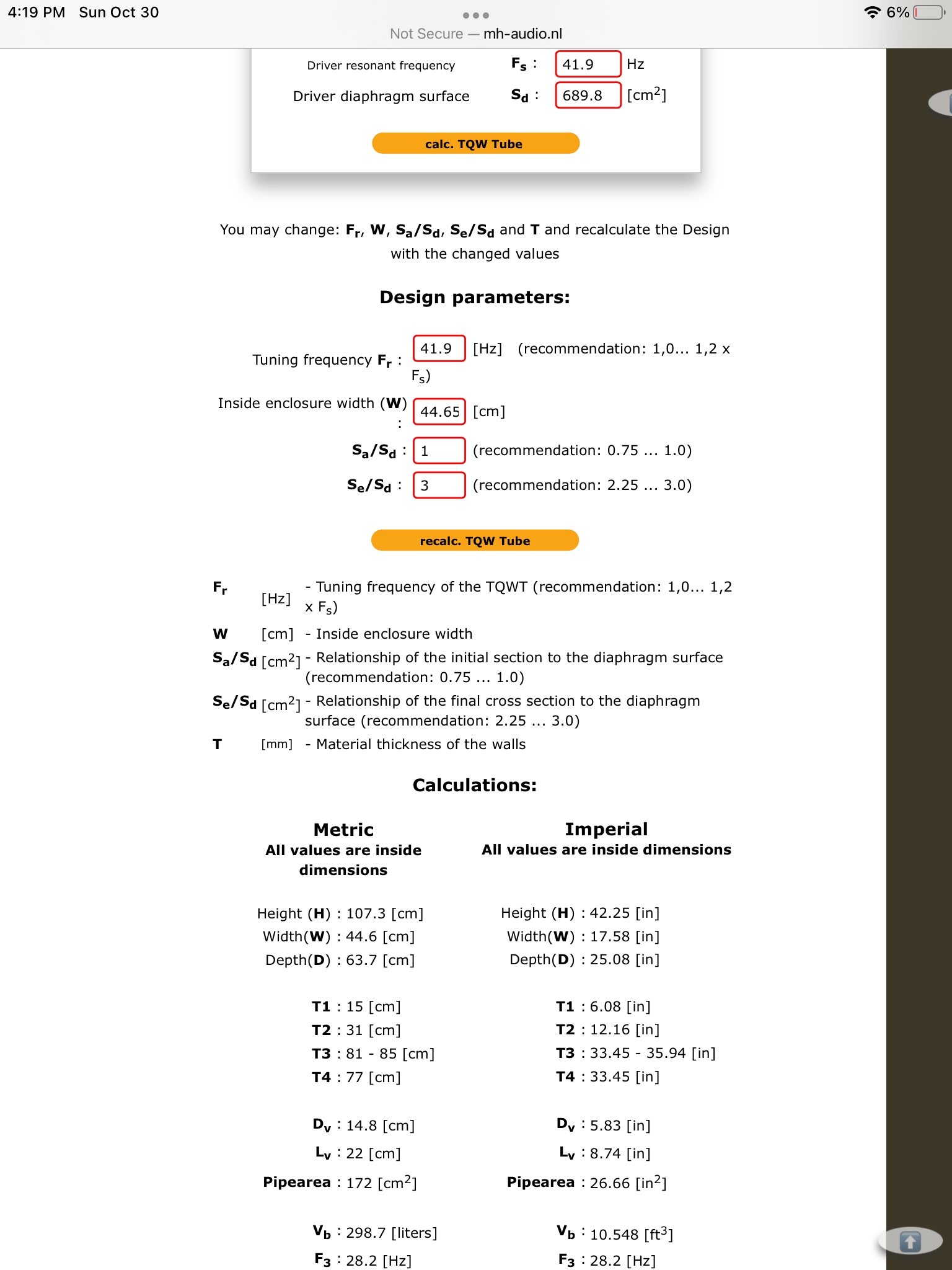

OK, so I found this calculator which is from the same site you linked to a few posts back, I’m assuming its a reputable site? http://www.mh-audio.nl/Calculators/TQWT.asp?c=y#ready
Heres a screen shot from it, i entered double Sd for the two drivers but not sure how to deal with driver placement as its only set up for one? Is this closer to what i need to be looking at? Had to cut off a little because i couldnt fit it on the screen, but the pertinent info is there…….it doesnt seem that large at all.

Upon further digging, it seems (according to scottmoose in another thread…..if i understand correctly) to incorporate two drivers into this scenario one needs to use the center between the two in the same place the single driver was centered and all should fall back into equilibrium? It will fit that way (barely) and to get my proper tweeter/ear height i’ll have to build up a base a few inch’s (unless internal dimensions are commensurate, as in taller but less deep?
GM, upon mocking up the size of the above speaker i see it is rather large after all, but do-able.
the vent size it requires is exactly the i.d. of schedule 80 pvc pipe so thats no problem. I did see you make mention in another thread of less port length the better on down to baffle thickness?

So out of curiosity is my doubling of the Sd in the above mh-audio calculator (post #33) not appropriate for modeling the two drivers of a mtm? Is that model just plain wrong or is it me?

No, you're right.
OK, well thanks again for putting up with my ignorance, so i should forget about that mh-audio calculator all together or can anything useful be gleaned from it? I really like that configuration (even if its wrong!)

Well, the calculator is riddled with enough 'cautions' to help guide folks that except for the grossly wrong port design it works better than the traditional DIY way (pre MJK) unless using horn theory as I do and if you were to adjust dims to put the 'tweeter' at the 38" o.d. height (H), which lengthens the acoustic path-length (T4) to a larger depth (D), base area (Se/Sd) you would come closer to what I calc'd volume (Vb), area wise (WxD).

kindly sure I’m following you, keep everything the same lengthen t4 (from the lower/wider point) so that tweeter height is 36 (i remeasured and i can do 36”) then increase depth to keep t1 the same.
So do i raise the upper driver to center it on the same spot where the single (as drawn) was centered or put the horn and second driver beneath the single? Then just have to figure out a better port, i’d guess a slot port at the bottom would be easier and more attractive……would a aperiodic type of port be an option?
