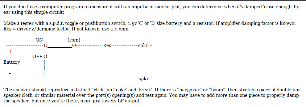

Yes, and if wanting to roll off and/or 'tighten' up its transient response, recommend critically damping the vent with the click test first as it usually is all the tweak that's needed IME (barring certain types of EQ, room mode issues) and at the very least you'll have the best of both vented and sealed with a 'heart attack fast' transient response in the lower octaves up to its upper mass corner (Fhm = 2*Fs/Qts') where T/S theory peters out with the driver design setting its higher BW performance.
[Qts']: [Qts] + any added series resistance [Rs]: http://www.mh-audio.nl/Calculators/newqts.html
Thanks, I view this as a respite from reality and being a type 'A' personality, enjoy educating (some say 'preaching').

I’d heard of the ‘click test’ and will definitely implement it here…..thanks for the excerpt.

4) For critically damping the vent……is barrier over inside or outside better (or doesn’t matter)?

Any vent can be critically damped/whatever on the outside, though never tried on the inside other general light stuffing the cab, but guessing it would work also.
