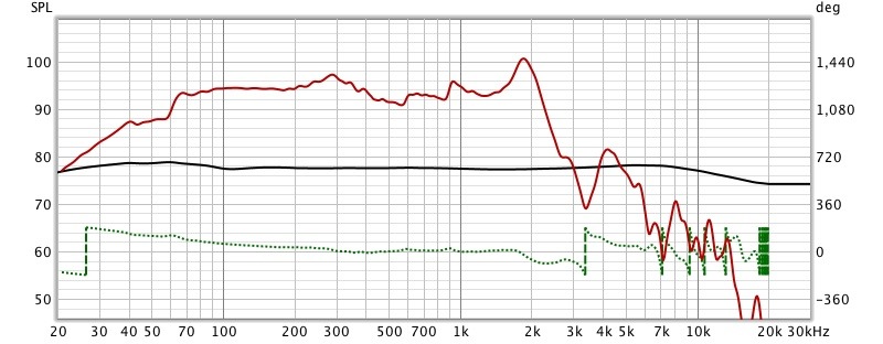

Any frequency below the floor/ceiling mode (8 ft = ~70.5 Hz) is normally a room mode and the other is likely due to the huge dustcap since it shows up on the factory measurement.

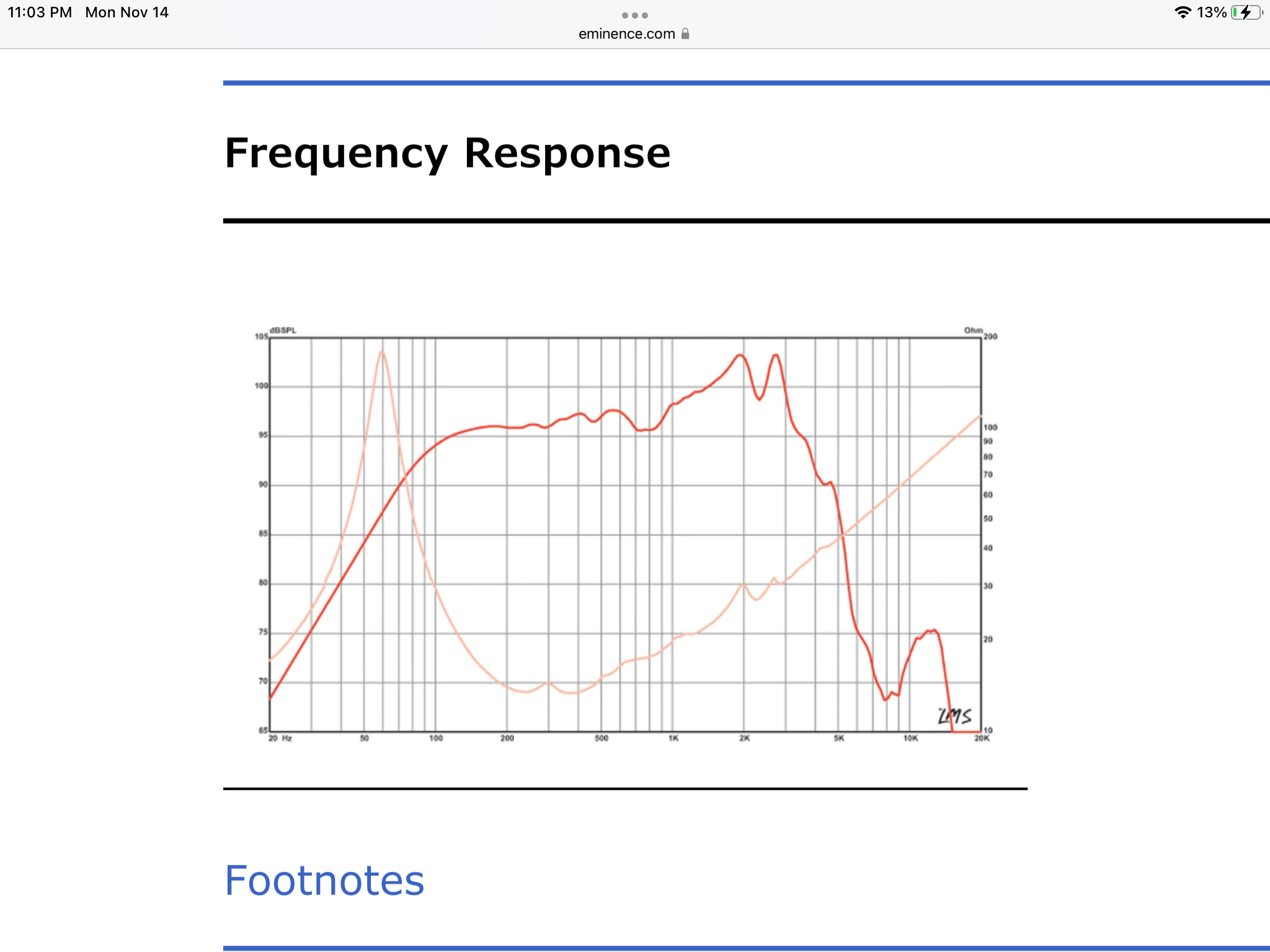

according to the eminence factory measurement for the stock delta 10b has the impedence spike right at 60hz, that might have something to do with it also?
They use a 2’x2’ baffle (according to the footnotes) so that would be the bass slope difference.

It was the only way I had to get the rew from the computer usb to the receiver………like i said, first time i ever used it.

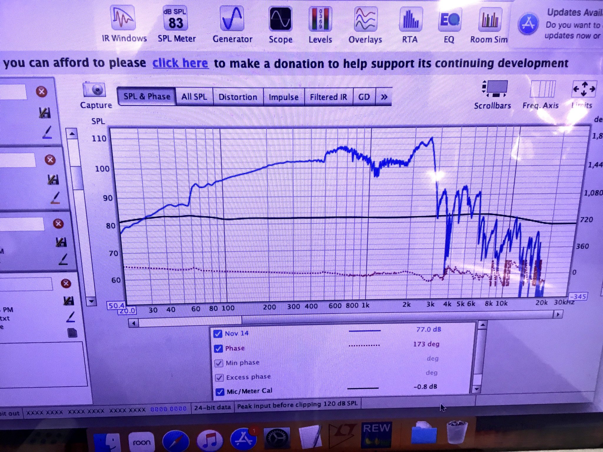

Ok, looks like a little of both, noise from the vizeo and baffle step combined.
red is original measurement yesterday through the vizeo tv
blue (next line up from bottom) is same setup directly on floor but wired from headphone out mac mini direct to receiver
green (top) is in a 2’ baffle with headphone out and improved mic stand
issue @ 60hz is still there but much improved…….things got a little wonky in the midrange with the baffle though?

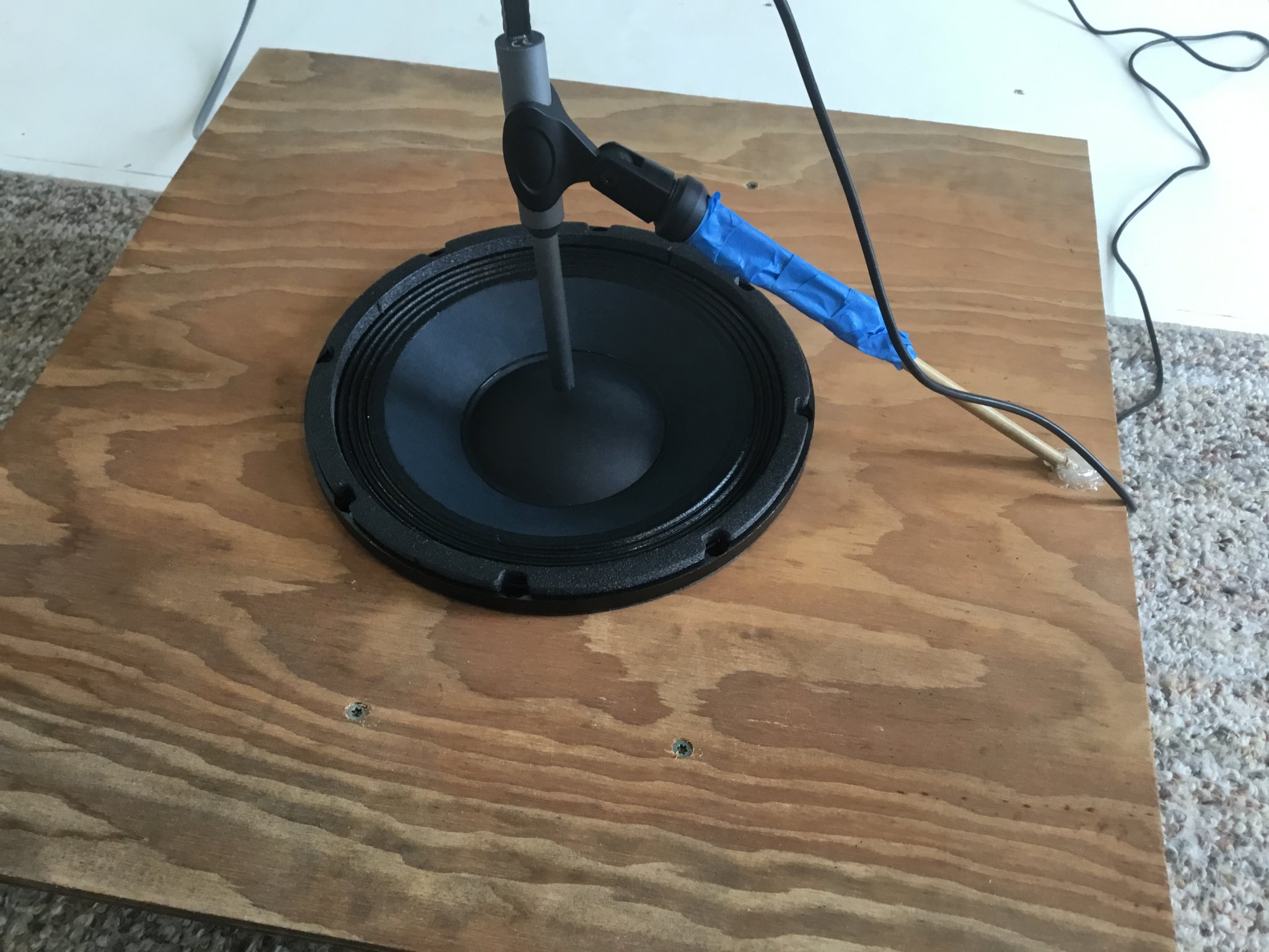

edit…… could the midrange disturbance be from vibration due to the stick being tied into baffle?
edit 2…… to answer the last question, i removed the stand mount from the baffle and measured again getting exactly the same result.

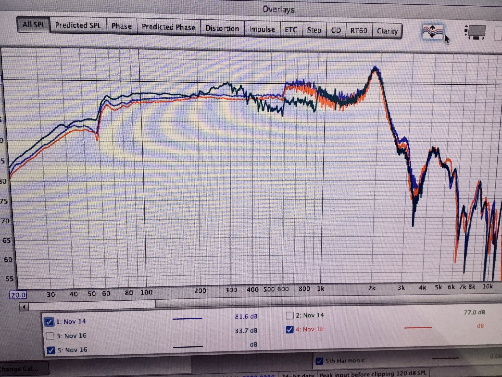

after trying to figure out things a little more, I matched levels better and smoothed to 1/12.......looks a little better?
oh, and figured out how to screenshot the Mac mini !
edit…….all criticisms are welcome, if anyone sees anything i’m doing wrong with this please speak up because fumbling in the dark doesn’t even begin to describe whats going on here! 😉

Yes, gating and phase are the next things to fine tune……..actually the impulse response didn’t show a whole lot but,I reckon once playtime is over and it comes down to it i’ll have to dial in a consistent measurement protocol.
