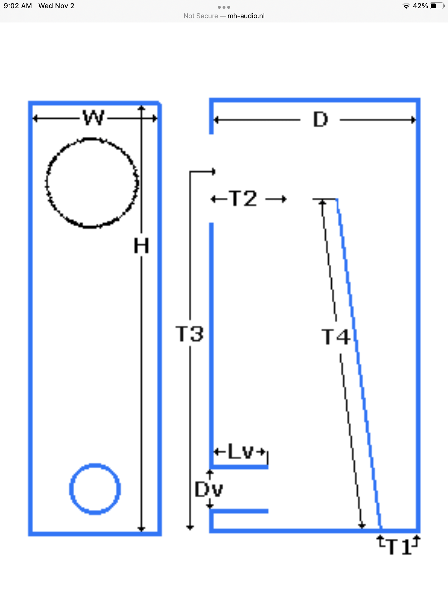

OK, heres the changes i come up with (based on your 56”H i.d.)using the original calculation and expanding every parameter to equal a 38”H tweeter center (ended up as a 33% increase)
new specs: 38” tweeter/12x6 horn centered….10” mtm
All dimensions I.D.
h- 56.00”
w- 23.38”
d- 33.36”
t1- 8.09”
t2- 16.17”
t3- 46.88” +/- 2.33”
t4- 44.49”
LL- 109.52”
believe it or not this size is actually do-able if I make it as a semi-built in for my entertainment center (either side of a 60“ plasma tv) this would also allow me to use my two lab 15 as a third and fourth sub down to 20hz
crazy right? Just have to figure out porting………would aperiodic be on the table?

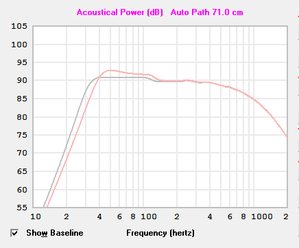

OK, as I presumed from experience it required a huge (2xSd) baffle thickness vent just to tune it in the high 20s and by increasing taper (T1 = 0.00)/reducing (Vb = 18.822 vs 23.667 ft^3) only shifted it up to the high 30s, which increased ~2.5 - 3 dB 30 - 100 Hz with the downside that neither can handle > ~3 - 4 W/Xmax and once the larger cab's spikes are damped, basically fractional watts (all 2pi/half space), so room position is critical unless ~78 dB/stereo average down to 40 Hz is sufficient.
Shrinking it to ~Fs tuning = ~8.292 ft^3, increasing power to ~14 W/106 dB/40 Hz/2pi/stereo average.
Notes:
All Vbs = i.d. net, so need to factor in the driver, slant baffle, bracing losses.
Damping is standard BR, sealed QL = 7, so basically lined or lightly stuffed down to just above the vent.
In short, if one doesn't already know the basics of TL/horn design, best to assume that much vent, damping tweaking will be required with this calculator, which in turn will normally require a larger cab than predicted unless the horn's throat (T1) = ~0.000.
So, which one of these or the MLTLs, if any, do you want to build?

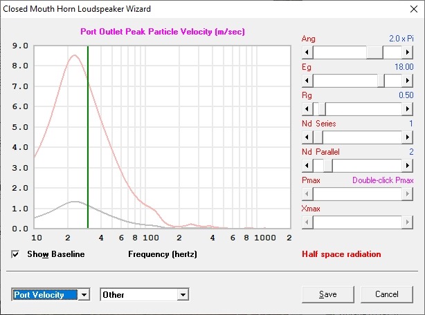

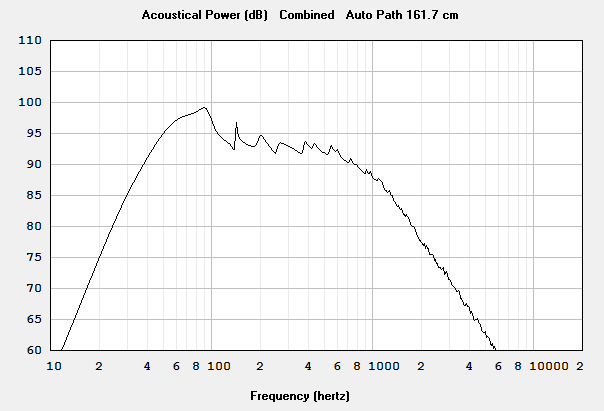

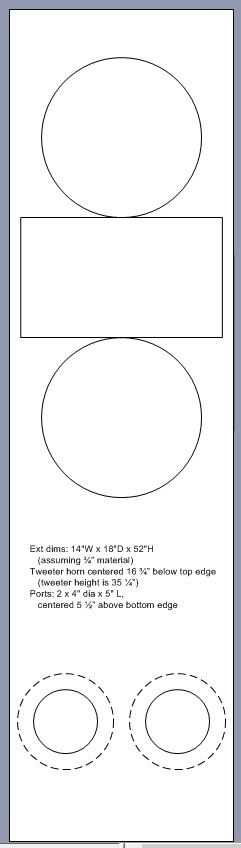

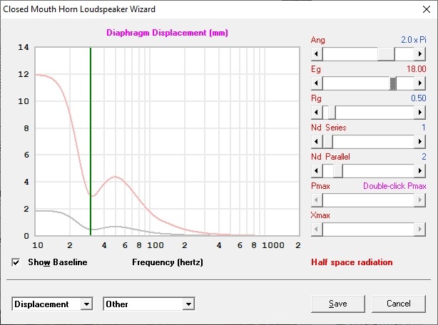

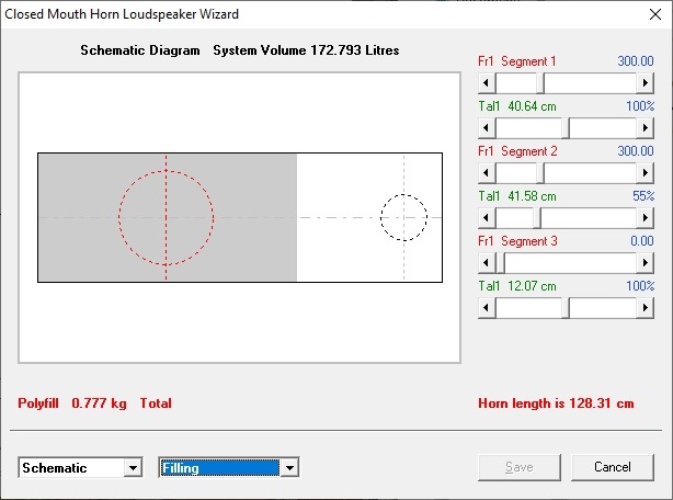

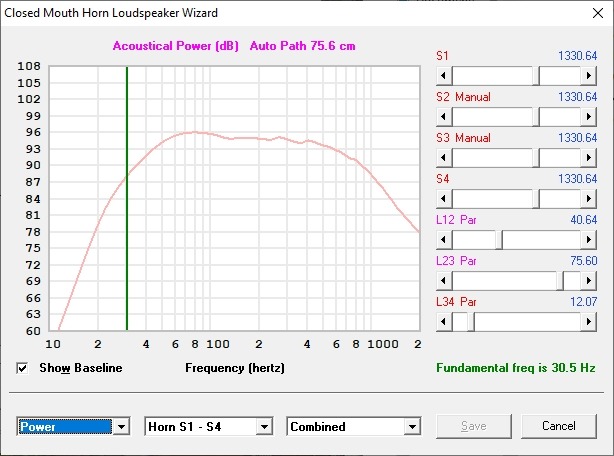

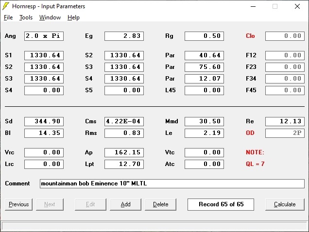

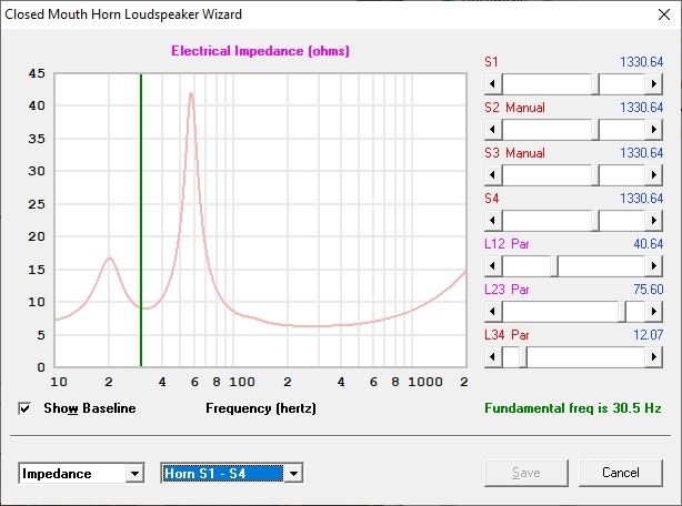

I'm by no means an authority, but I gave it a try modelling as a straight MLTL.
Key dimensions (all internal) are:
  • 12.5" W x 16.5" D x 50.5" H,
  • midpoint of two drivers (& horn) centered 16" from inside-top,
  • ports (2x 4" dia x 5" length), centered 4 3/4" from bottom,
  • stuffing 1.7 lbs of polyfill in top 2/3 of cabinet.
The response looks pretty good to my eye. Fb with stuffing is ~30.5 Hz, Xmax hit at ~40W (18V into 8 ohms nominal), while making about 111 dB. Included the hornresp .txt file so you can play with it.

That looks quite do able, thanks very much Matt…….some kind of legs would get the tweeter to ear level perfectly. 😎
those dimensions are great and look is quite nice also.
would pass off to to the subs @ around 40-50hz quite well……..subs are those diysg buy out lab 15‘s in 4 cf sealed boxes, powered by crown xls 2002

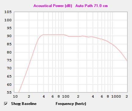

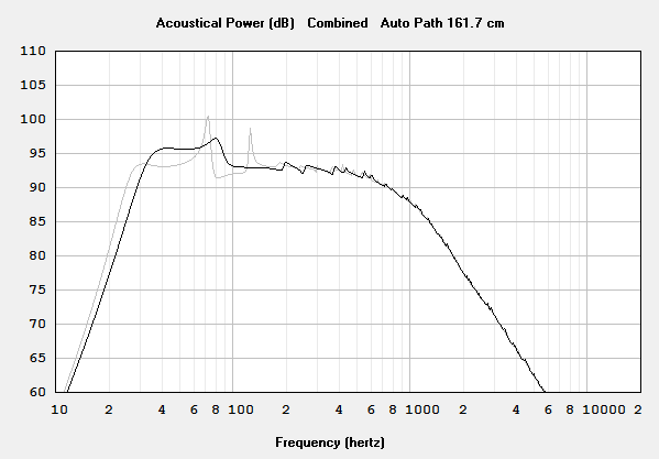

FYI/FWIW, I intentionally didn't do hardly any damping on the max flat MLTL, MLTQWTs I posted to highlight the differences, so for the record, here's the 'finished' ~213 L net MLTL I posted earlier.
Apologies, I must have missed this one among all the iterations being discussed. That response looks very nice.
Shrunk to your max 14" x 20" o.d., Fb = Fs, power limited to 35 W, ~213 L net, vent = 8" dia. x 1" long and instead of a flat response, it sims a 'toe tapping' party speaker with a ~50 - 150 Hz +3 - 4 dB boost shelf.
Reactions: GM

Actually, the original sim with the boost I posted is what I would build due to knowing that HR (dramatically in some cases ) exaggerates its high Q spikes down to a sufficient in room smoothness with modest damping plus I'd rather have the extra acoustical mid-bass efficiency and EQ down if required for those recordings with powerful drum, bass guitar, etc., solos; but your liking the smoothness of a sim I changed it to a comparable one, forcing a lower ~32 Hz tuning, so leave it at 8" (red) or 5" for max flat.
