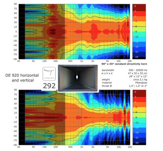

The 90° x 45° Limmer Horns 292 is available with 1.4, 1.5 and 2" throats, response with a B&C DE920 (1.4" throat, 3" dome diaphragm) is ~-5dB at 400Hz:
Like a scaled up version of the early 1980s JBL 2380 bi-radial.

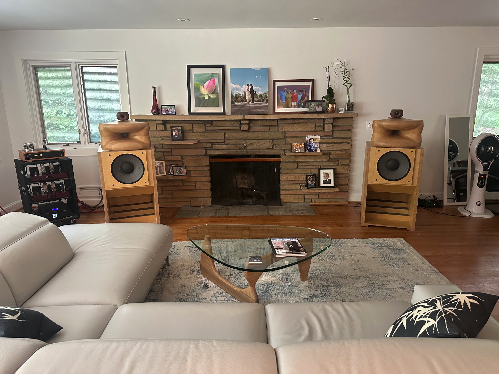

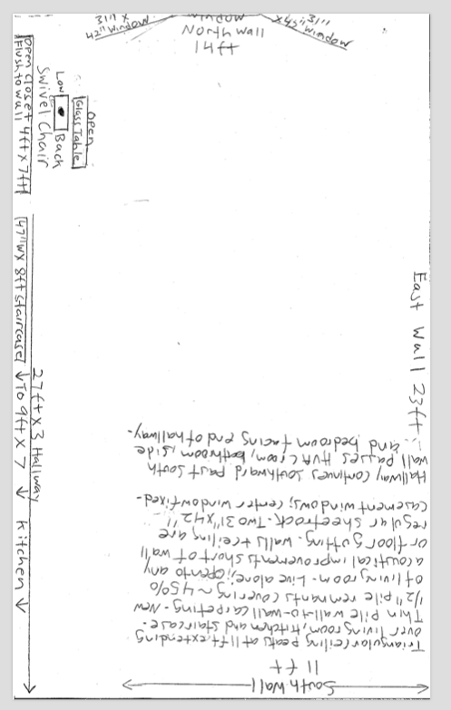

If you draw a full floor plan with all the structural details, window, doors, hallways, etc., I could suggest the best compromise for speaker and listening position for optimal imaging.

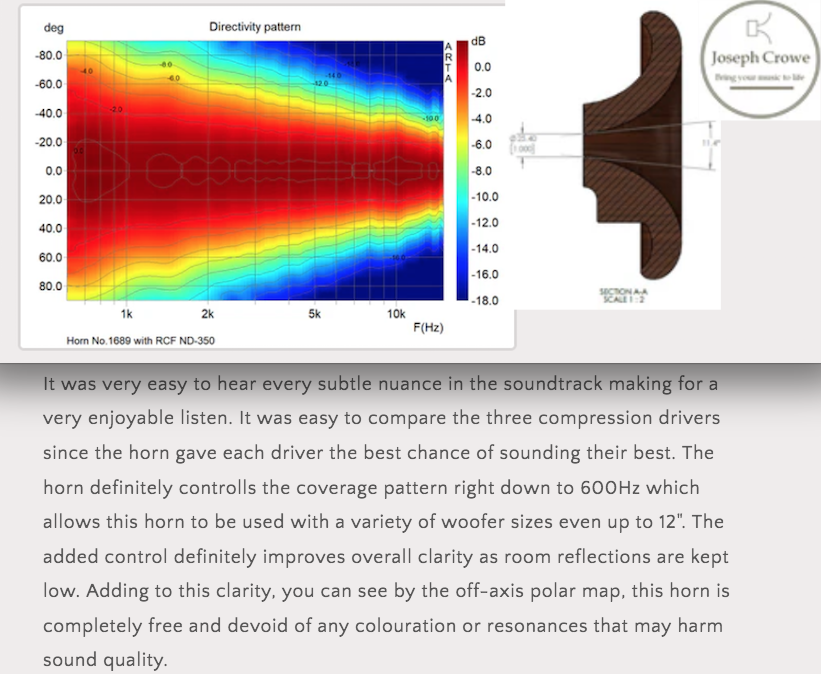

How are round horns https://josephcrowe.com/collections/circular-horns different from JMLC horns? Presumably, they are very different, performance wise.
To presume horns with very similar expansion profiles to be very different in performance demonstrates your continued lack of understanding.
Some of Crowe's round horns are far more similar than different from JMLC profiles:
As you can (and should) see in the very similar polar charts of horns like your AH425, they are just as "completely free and devoid of any coloration or resonances that may harm sound quality."
The larger AH425 has control of it's coverage pattern to a lower frequency than Crowe's horn #1689.

I don't understand where the wall is on the west side of your room any better than your last sketch
I thought it was all pretty obvious: the South wall is only 11 ft wide. And at that wall's westward edge and moving across to the north wall is no west wall; instead, it's all open to the kitchen and north of that to the staircase. Then northward past the staircase there is a small west wall, but that is mostly comprised of the 7 ft high x 4 ft open closet. I sit in my upholstered low back swivel rocking Drexel chair in front of the closet.

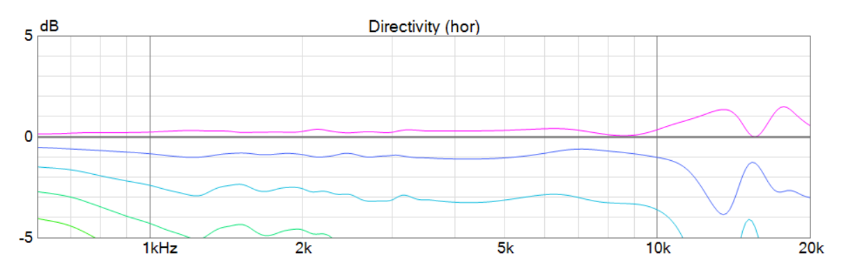

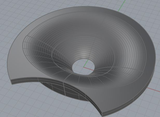

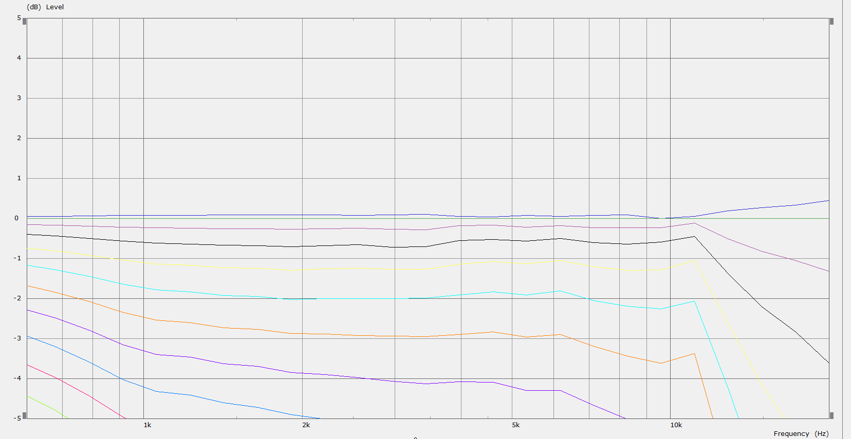

Yeah any issues would accumulate on a round / symmetric design, but one can use a profile without issues as well! Actually best response I've seen, with least issues on 0-axis, is from round axi-symmetric devices. Mabat sims and measurements are quite exceptional, see ath thread or his website.
Here is my custom axi-symmetric 3d printed freestanding waveguide measured response. It's unfinished so there is a chance the response gets bit better after sanding (seams) and painting. Measured response +-20deg is within 1.5db between ~1k and 10k, it's 1.4" throat so above is due to what ever the driver makes. Difference between 0 and 10 deg is within 0.5db. 20deg and even 30deg out has undulation that stays within ~0.5db within itself, it just gets attenuated. The response is normalized to 10deg, visible lines are 0, 10, 20 and 30 deg
simulated response 5deg steps:

As you can (and should) see in the very similar polar charts of horns like your AH425, they are just as "completely free and devoid of any coloration or resonances that may harm sound quality." The larger AH425 has control of it's coverage pattern to a lower frequency than Crowe's horn #1689.

And that's one big reason why I sent you that sketch of my room; so that I might learn how my room might react to Nico B's CD horns, or those CD you might recommend.
