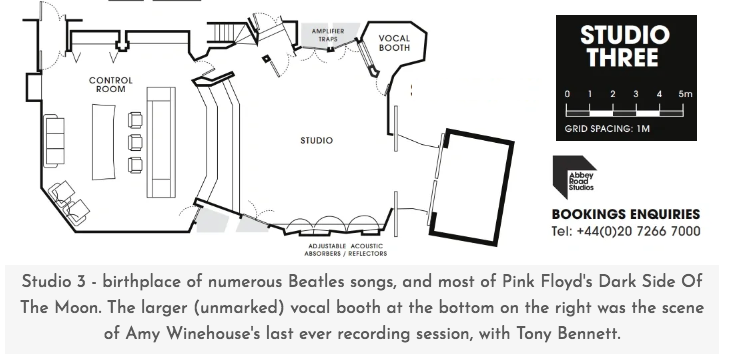

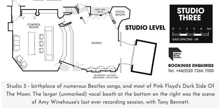

Your "miserably undersized" room length is longer than many control rooms used to mix and master recordings for thousands of hit records.In my miserably undersized room here on Schiit Island, I'd hate sitting on the short wall.
Abbey Road's Studio 3 control room is under 20 feet front to back:
In any room size or dimension, I'd prefer at least half it's space behind the equilateral listening triangle.

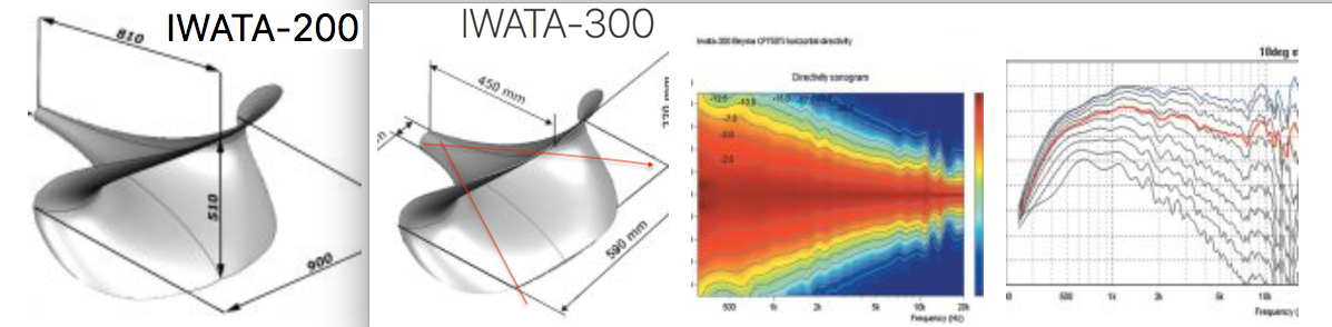

You misinterpret much of what you read that has any technical aspect.However, Arnaud Le Gac said that except for these 1-pouce, all of his horns are non-beamy constant directivity horns, like the one you had recommended. pavillon-iwata

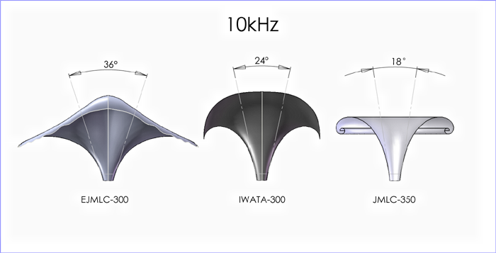

The ALG sectoral throat bi-radial Pavillion ARIA A-290 could be (kinda sorta) considered "constant directivity", but the ALG Iwata 2 is definitely not. It's HF -6dB beamwidth would be about what the red lines would indicate:

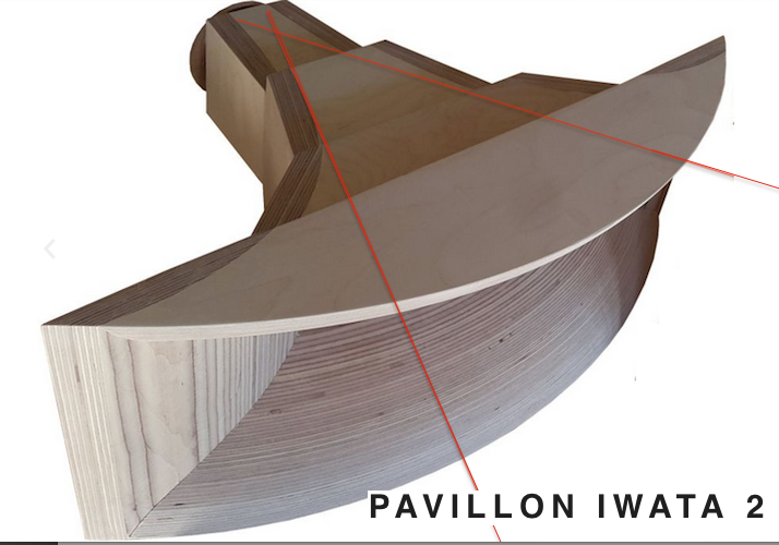

If you can't see at least one side of the throat in this type of horn expansion from the listening position, you are not going to hear much direct high end.
The ALG Pavillion Iwata 2 may be slightly less beamy than the IWATA-300 (a lot less than the IWATA-200) but still not much different than your AH425.

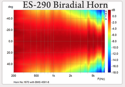

Go with Troy's ES290 horns. You've already made the choice to select him as your builder, and he has your woofers and cabinets. He makes those horns himself (so he will not object to them), they're good products, and they can be made to match with a number of compression drivers (Troy understands the importance of throat angle matching, so he won't recommend a poor match).

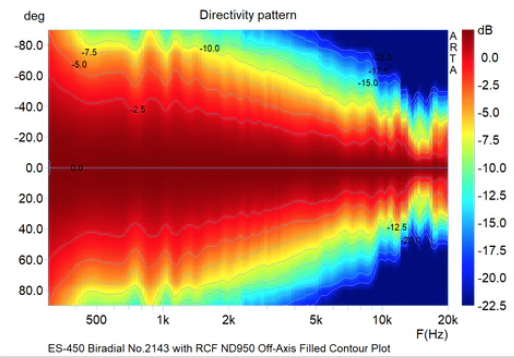

My own personal recommendation for a compression driver would still be the JBL 2450 plus Be diaphragms...
I agree, I think he should use the horns he has already, Very smooth off axis transition is the very important whether constant directivity or a beaming horn.
Wider dispersion increases the coverage area, but won't improve imaging, hence my reluctance to recommend any constant directivity horn over your beamy (but very smooth) AH425s, considering you are the primary listener.
Okay, should now come the time for compromise? If any constant directivity horn (e.g NicoB's , Cirare PR614, B&C M90) would really be detrimental to imaging (in my not very good room), rather than going to beamy exrtremes with the AH425, why not the ES450?

Would not both be a perfect match for the JBL2450J + Bes? And the ES290 in particular working best with the Altec midwoofers?
A good low diffraction constant directivity horn is not detrimental to imaging, but won't provide any better imaging than your AH425s at a single listening position.Okay, should now come the time for compromise? If any constant directivity horn (e.g NicoB's , Cirare PR614, B&C M90) would really be detrimental to imaging (in my not very good room), rather than going to beamy exrtremes with the AH425, why not the ES450?
Another pair of beamy horns.....why not the ES450 Or ES290, like Marco recommends?
Your midwoofer's response will be the same regardless of the horn choice.And the ES290 in particular working best with the Altec midwoofers?

FWIW, I don’t see anything “technical” here; do you?The ALG sectoral throat bi-radial Pavillion ARIA A-290 could be (kinda sorta) considered "constant directivity", but the ALG Iwata 2 is definitely not. The ALG Pavillion Iwata 2 may be slightly less beamy than the IWATA-300 (a lot less than the IWATA-200) but still not much different than your AH425.
https://alg-audiodesign.com/pavillon-iwata-2/
But with regard to this issue, Arnaud’s did say I'm not sure I understood the expressions "You Are There" and "They Are Here" [okay, LOL] but ………to answer your question, most of the horns on the site are constant directivity except for certain models and of course circular horns.
Well, I think Marco would have a valid reason for recommending it, and it's certainly less beamy then the ES450-and no doubt WAY less beamy than the A425. Speaking of which, as Lynn's thread is like the genesis of the 425 has anyone ever seen a Geddes plots of that horn there? In fact, I can't recall seeing any such plots on any thread on this forum.
AND what about the Geddes plots of all those other JMLC-like horns you said you've heard?

And the choice of driver can also impact directivity, such as https://croweaudio.blogspot.com/2020/03/es-290-biradial-with-jbl-2446h.htmlMy own personal recommendation for a compression driver would still be the JBL 2450 plus Be diaphragms
Hoping a pair of restored JBL2450J + Bes will look at least a bit better than those Geddes plots.

TO demonstrate the connection of visuals of the throat and what you hear.
Wow that's getting a bit tight. How's the Iwata in the vertical? To head in vise for me, don't like speakers that beamy.

@AllenB Why didnt you tell me I use the word bandwidth incorrectly... I don't feel bad other then for causing confusion, beam+width=Angle????.... Hey how wide is that beam? 24 degrees? ok thanks....Senseless but not my invention... Arch length is the correct term, Ty @docali other wise I would be confused still...
@Robh3606 at 1m, ±12° is 0.42m (16.5"); at 2m, 0.84m (33") who has a head that would fit in a vice that is 16" wide 😂
As the listening distance grows, so does the sweetspot.o head in vise for me, don't like speakers that beamy.
beamwidth not bandwidth lol@AllenB Why didnt you tell me I use the word bandwidth incorrectly
