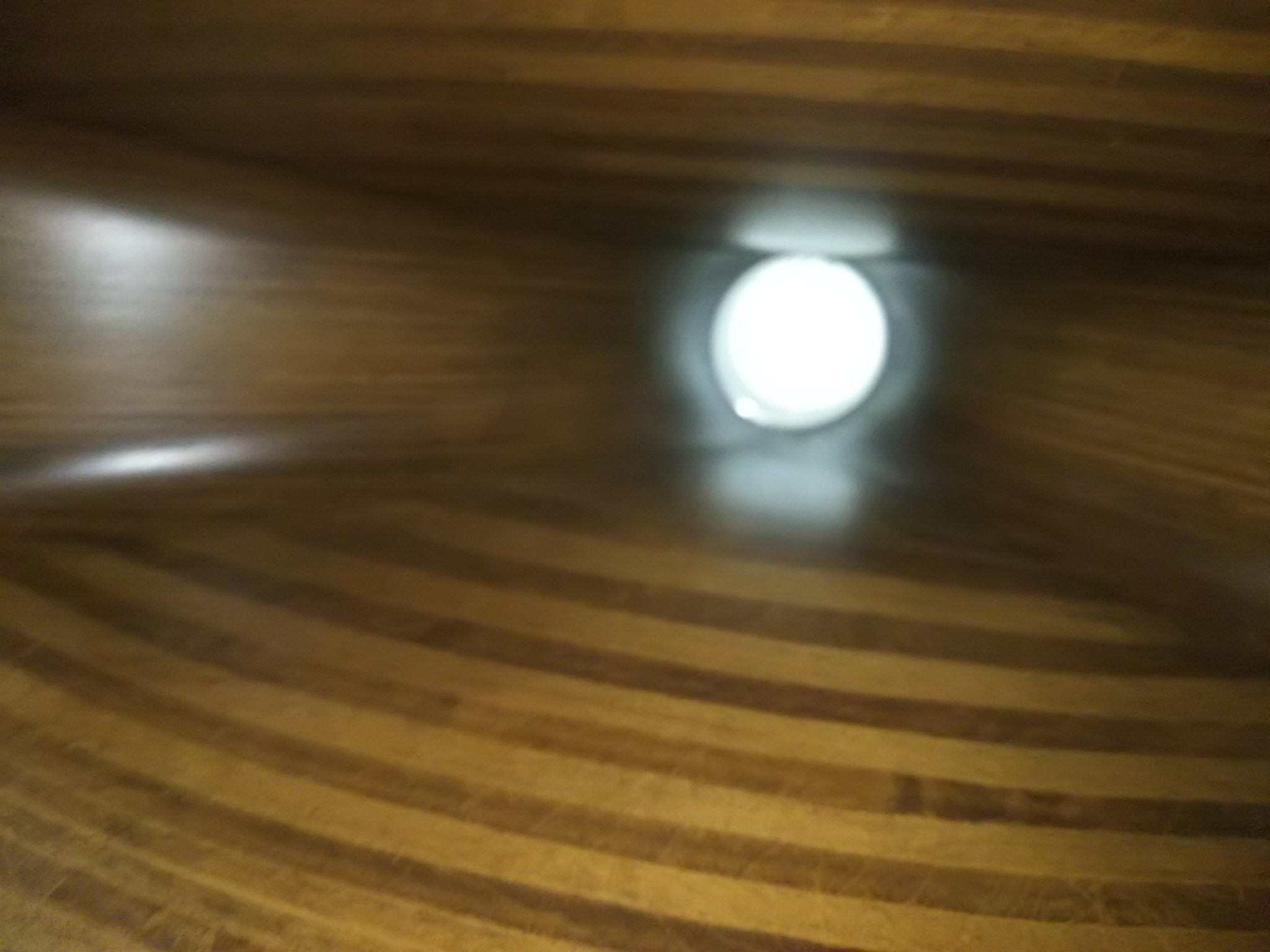

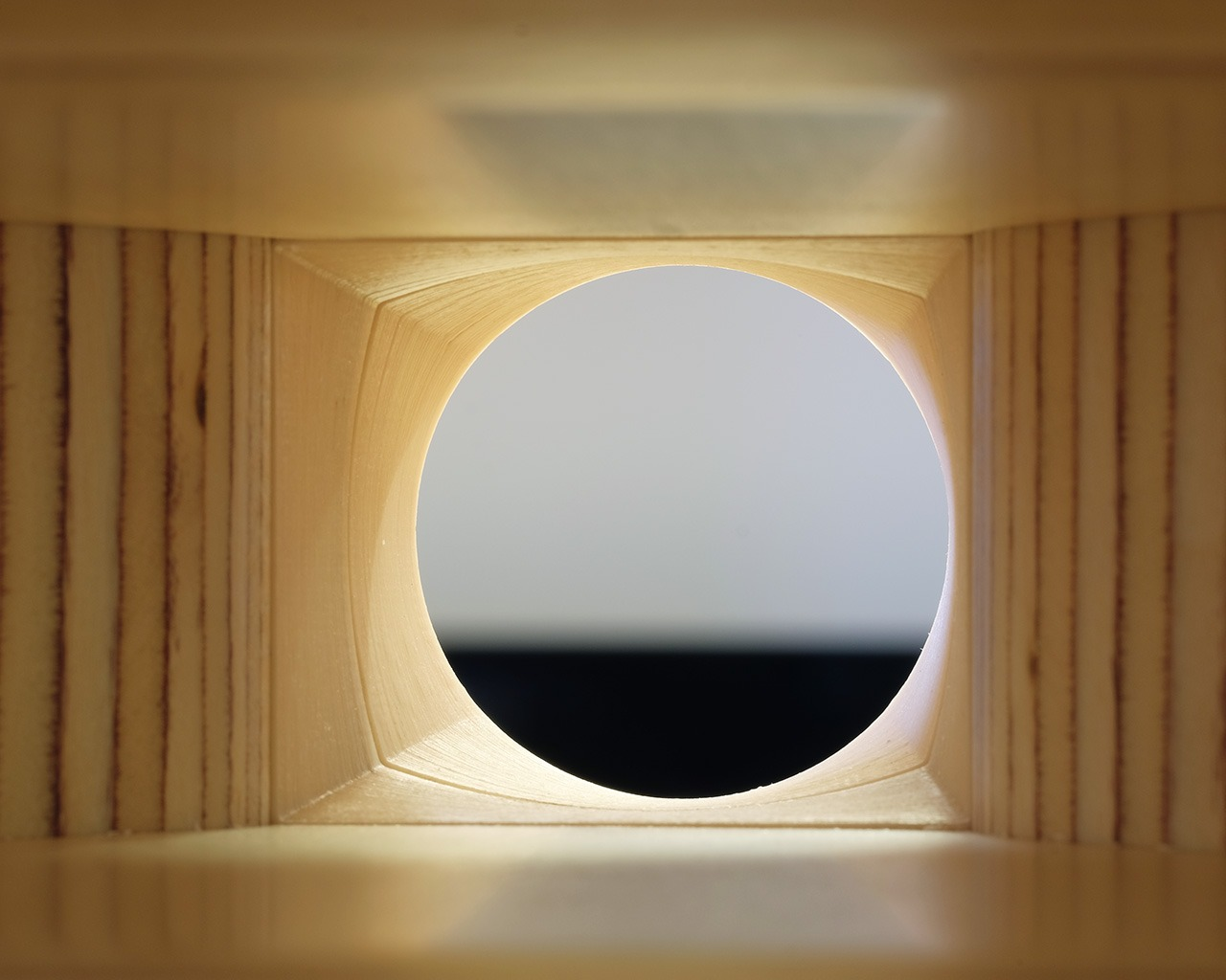

Ideally, the adapter should be matched to the exit angle and - in the pursuit of perfection - also to the phase plug, taking into accountThank you. If only I had this 2" instead of my 1.4" Radian 745Be, since using adapters is apparently an undesirable compromise. https://www.usspeaker.com/radian 760neoBepb-1.htm
the path length from the diaphragm to the horn mouth. Constrictions and irregularities prevent a smooth expansion of the wavefront and are a (potential) source of (audible) aberration.
While this may suffice (ALG):
This is better:

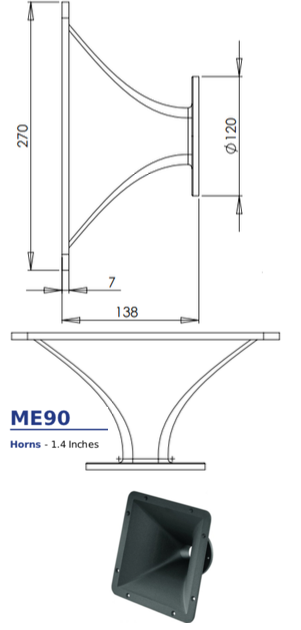

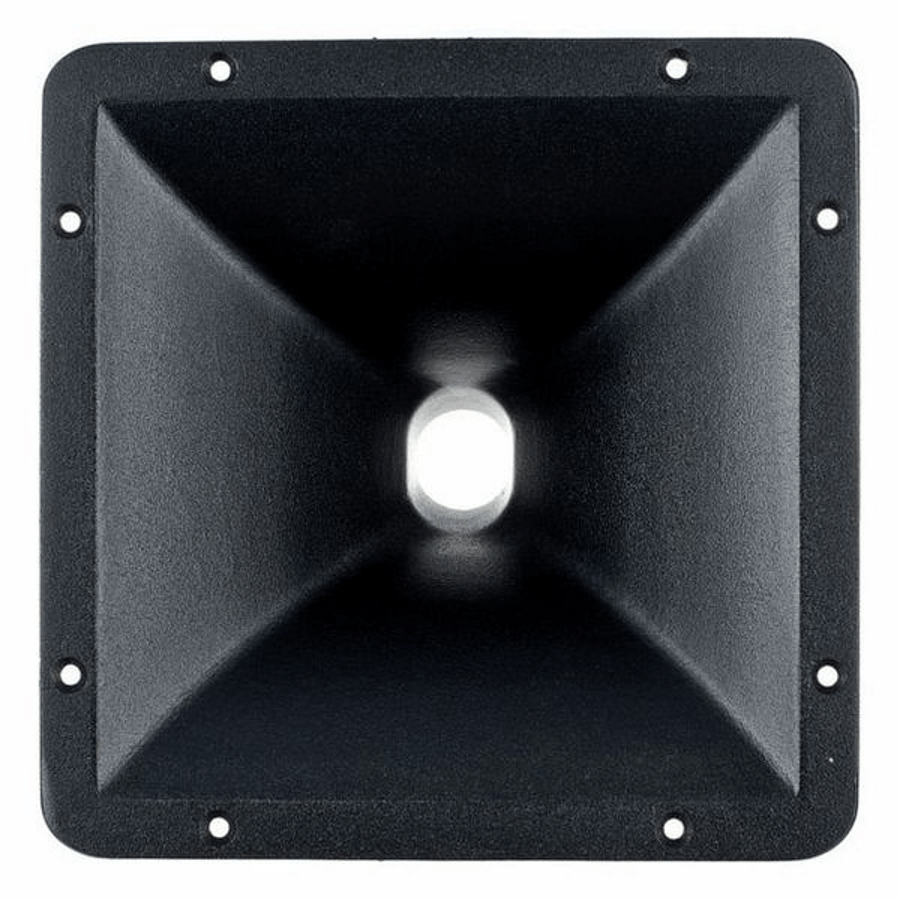

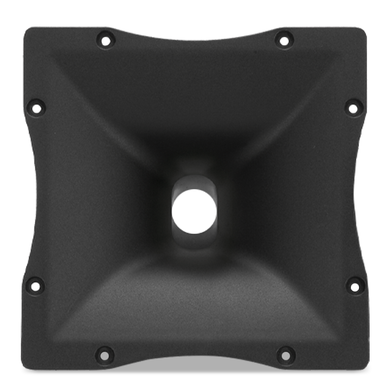

You must be thinking of another horn, the B&C ME90 horn throat is not slotted:The directivity of the ME90 is the result of a tiny slot, which, combined with the less than perfectly matched throat angle, may affect the listening experience.

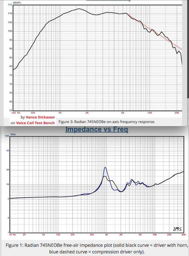

The Radian 750NEOBe on the ME90 response has a smooth (+/-2dB) falling response from 5-20kHz, and it's free air impedance with or without the horn is nearly identical in that range:
If the horn throat angle match was a problem, it would show as sharp upper discontinuities in the frequency and impedance response.
If by "better" you mean less boundary reflections, which mask location cues present in recordings, the more narrow dispersion horn is.I can't tell from the vert and hor directivity plots of both horns which one might perform better.
If by "better", you mean which has a larger coverage area at a given distance, the wider dispersion horn is.
